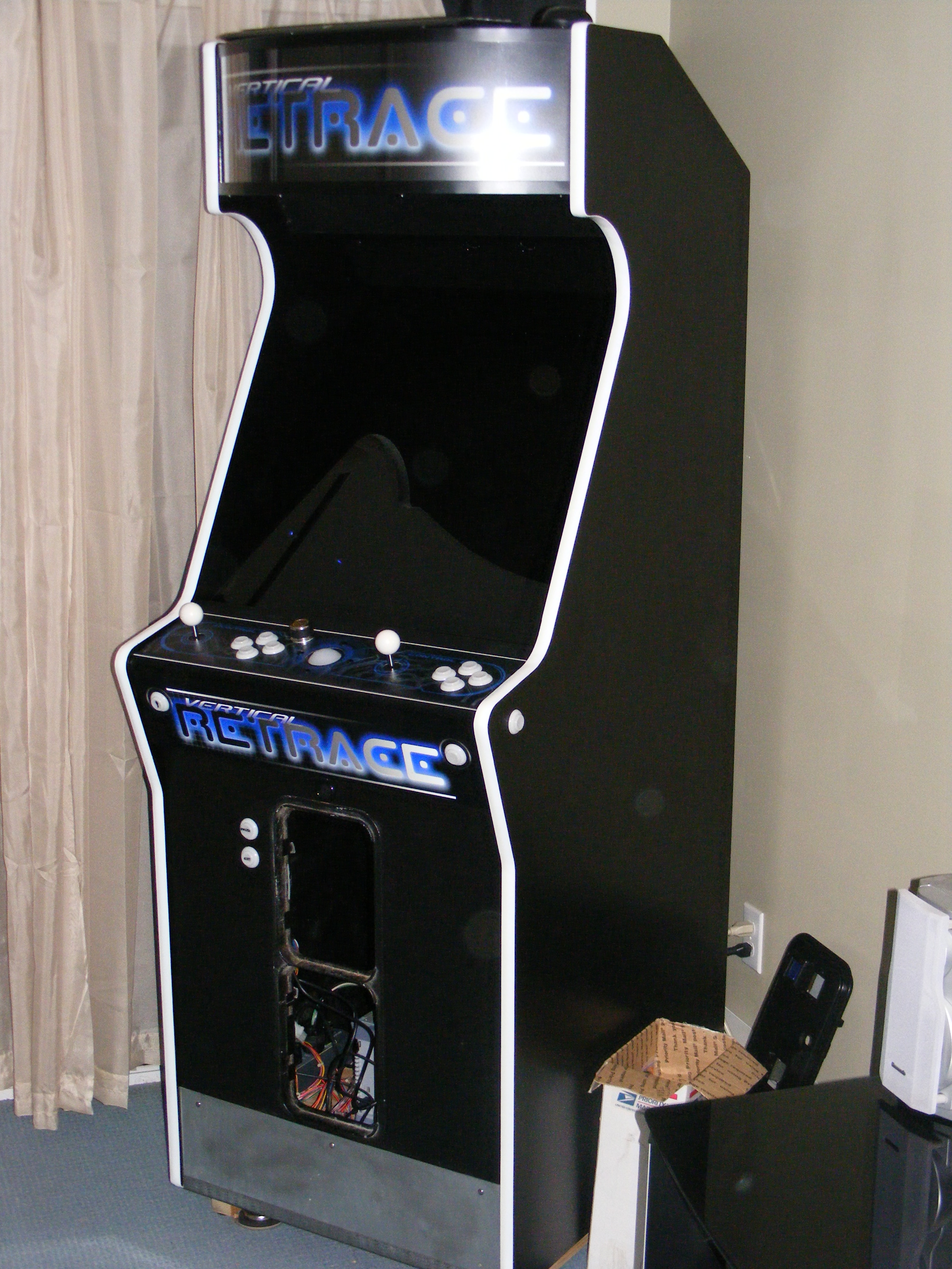

I've finally got the cabinet out of the basement.
Its now up on my back stoop where I will finish up a couple of small steps. I shot the rear of the cabinet with some flat black to clean it up.
Tha cab is sitting tipped forward because I have the front leg levelers all the way in right now.
I will soon put on the white t-molding and I got the email today from Gameongrafix that says both my cpo and marquee are on their way.... man I can't wait to see how they come out.

Update,
I finally found some time to post an update with some pics.
Work has been busy. I've currently got a school I'm working on with a dead fire alarm system that I'm in the middle of switching out, I've gotta swing by a costomers house and swap out  a monitor in a Misille Cammand, I have a Ms Pacman from the same customer that is currently waiting for me to work on and on top of it, I'm working in a roller rink trying to make his sound system not suck, but the owner won't spend money on new sub woofers and fixing his games as they periodically die. :banghead:
any way, enough complaining.
I've got the cabinet up in the room where it will be staying and the t-molding on.
My artwork arrived on Saturday and it looks great. I'll be working on getting it on soon.
I have a few coin control coin doors but I wanted a Happ one because I prefer the coin reject buttons and I can get them in blue. when I was at the rollerrink this week, I went in the back to get something and saw a couple of happ coin doors. I asked the owner if I could swap a coin controls one for a happ one and he said yes, so now I've got a nice coin door to pop in, after I refinish it of course.
soon I'll be working on getting the monitor in it.

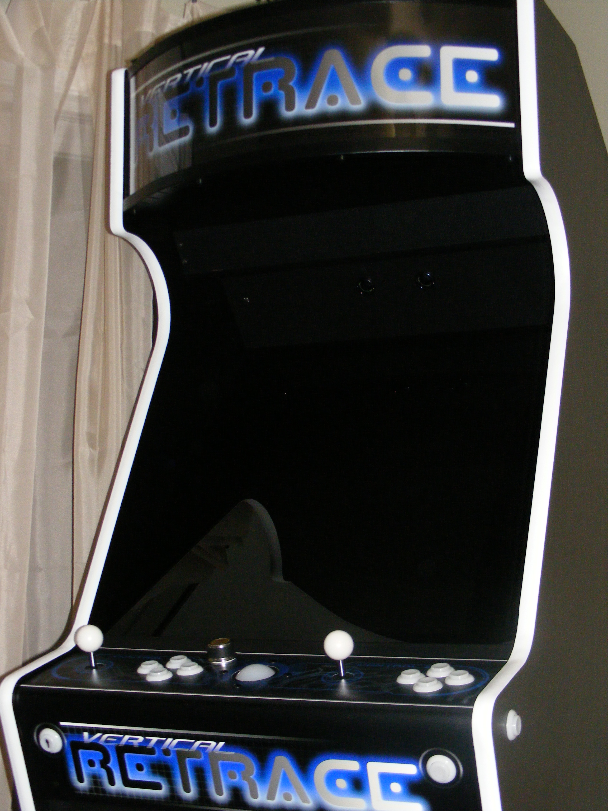

« Reply #55 on: October 14, 2011, 12:36:41 am »
I've made a lot of progress. It's still going slow but its much closer.
I have my monitor in and functioning, my artwork installed and controls mounted.
due to the monitor size, I had to remake the inner speaker shelf part above the monitor. I'm very happy with the way it came out.
I modified a grill from a Narc machine. I added two small ports for the subwoofer.
Here are a few pics of the installed marquee and control panel art.
I'm currently waiting on a new 2.25" iceball and a token top spinner. I also have an order into Tap plastics for the monitor plexi.

try it in person? of course, why not. thats what its for. Stamford? I used to work down there all the time, now I do just once in a while.
I just got the smoked plexi from Tap Plastics yesterday, wow!! I like it
The smoked plexi really gives it a great finish and I think the picture on the monitor looks much better with it.

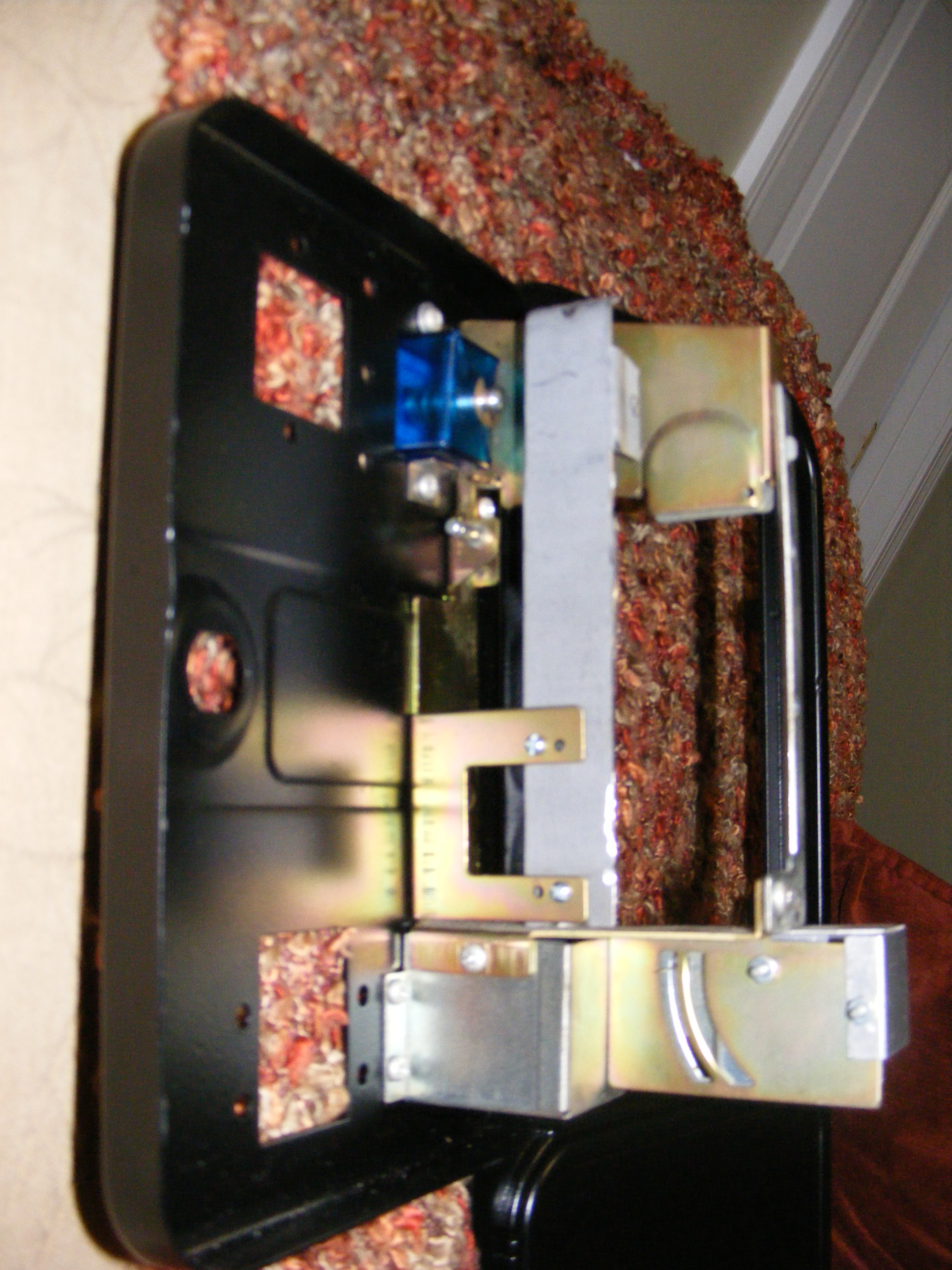

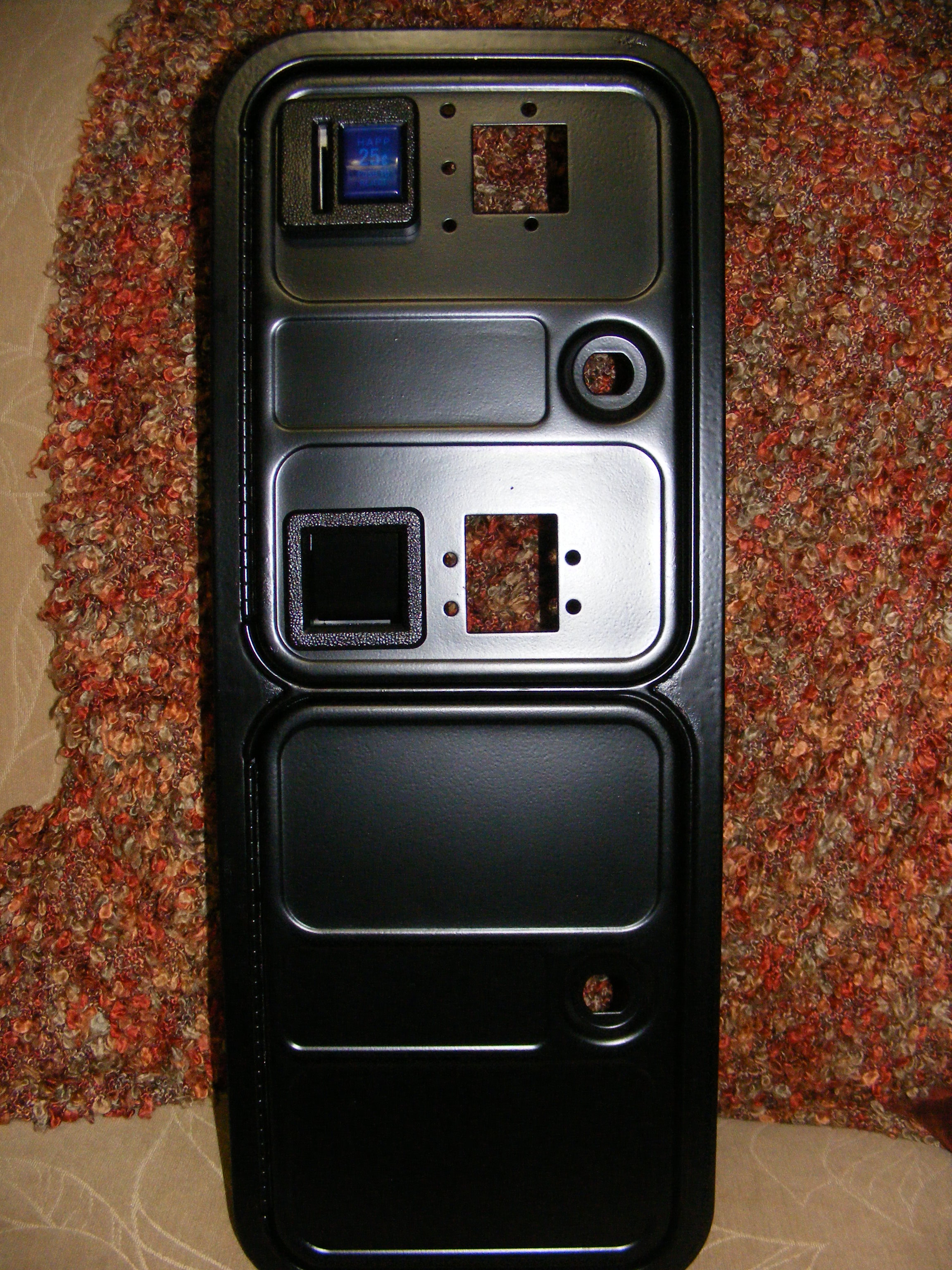

I'll be updating some photos soon. I'm also currently in the progress of painting my coin door, rebuilding my Happ trackball and my spinner is out for repair  :banghead:

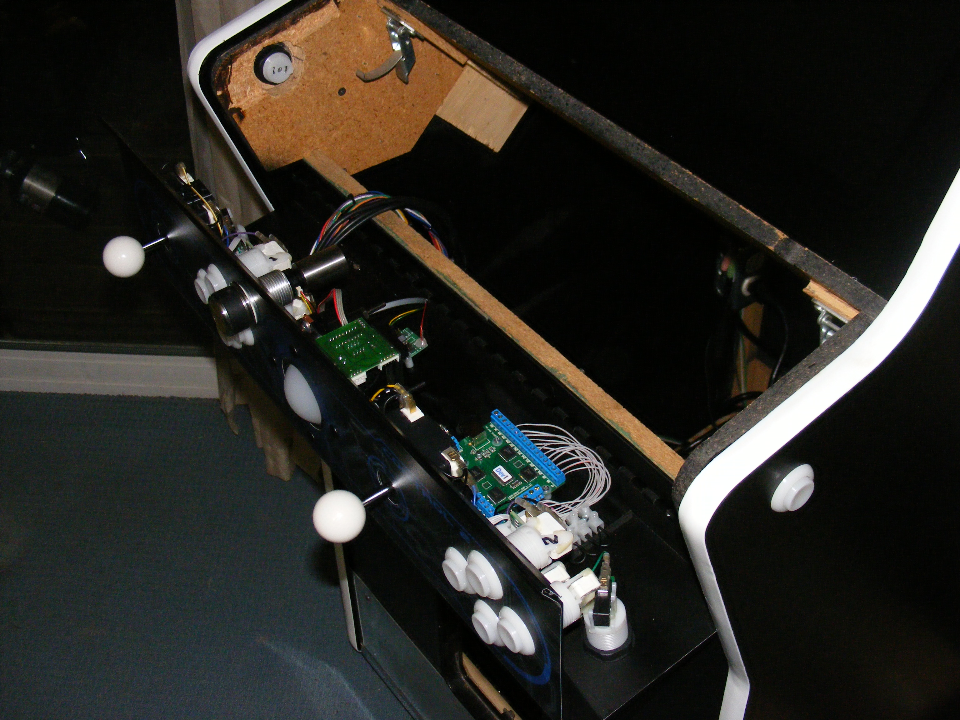

The control panel is all wired up for control and lights. I still need to do the strict settings stuff of lighting the proper leds for each game.
Lately I've been doing a lot of work on the resolutions using the mamewah mame resolution tool. (very handy)
Here are some progress pics

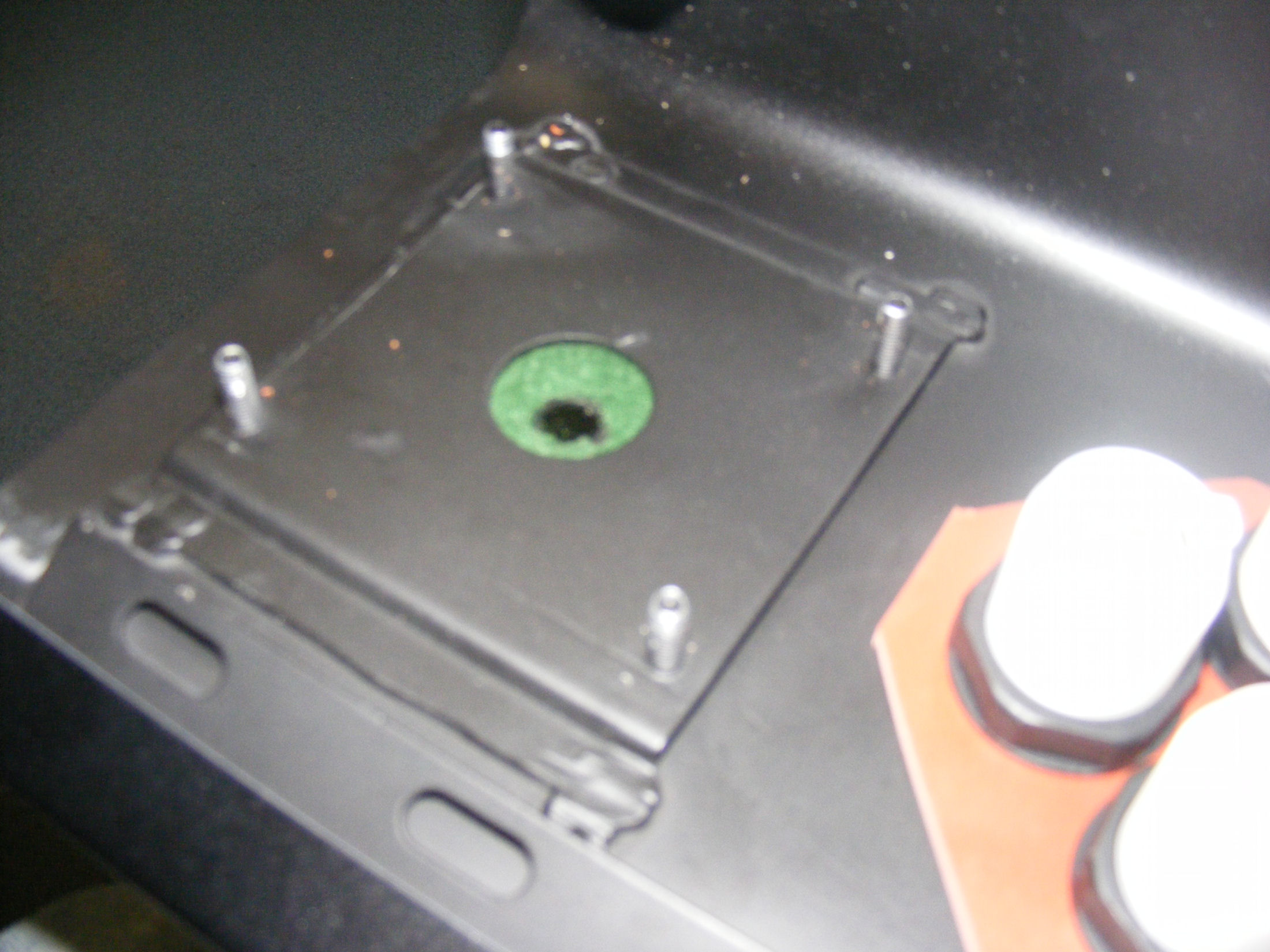

I cut up some pacman joystick mounts and had them welded in, to avoid having bolts showing up top
There is a void between the mount and the metal cp that fits the dust washer fine except I just had to put some thin felt on the dustwashers so it sits perfect.
It's a pretty tight little package but I think it's pretty neat. I also used 12 terminal connectors like real arcade machines, so I can unplug the controls from the ipac if I need to remove the Cp.
I have to finish my coin door and redo the player 2 start vinyl
I'm off tomorrow, so I will be able to wire up my coin door and get it installed.
I am mounting switches behind the coin reject buttons and  restricting them so you only need a slight push for credits. The metal strip will both hold the switch and restrict the button. I will also be using coin mechs so coins can be used but probably won't be.

Also, I finally got the coin door mounted along with the switches for coining up. I just need to wire it up.
Soon, I have to get started with configuring ledblinky (which is awesome by the way) and all that.

I actually used the Robocop control panel for this project.
I still have some other parts from it.
The only problem I see with fitting a comp in it is that the welded studs used for mounting the joystick is kinda angled so the stick wouldn't be going straight
