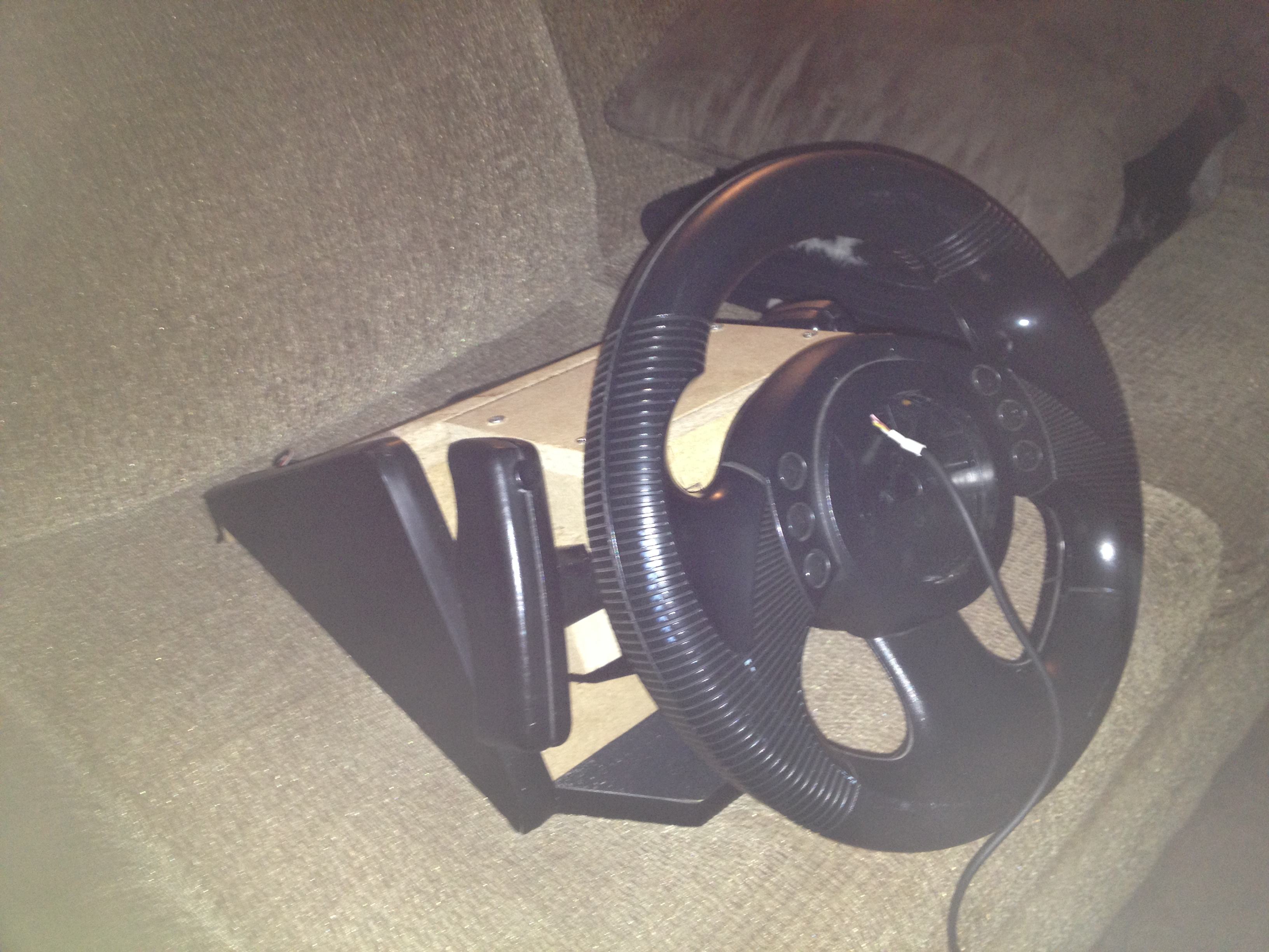

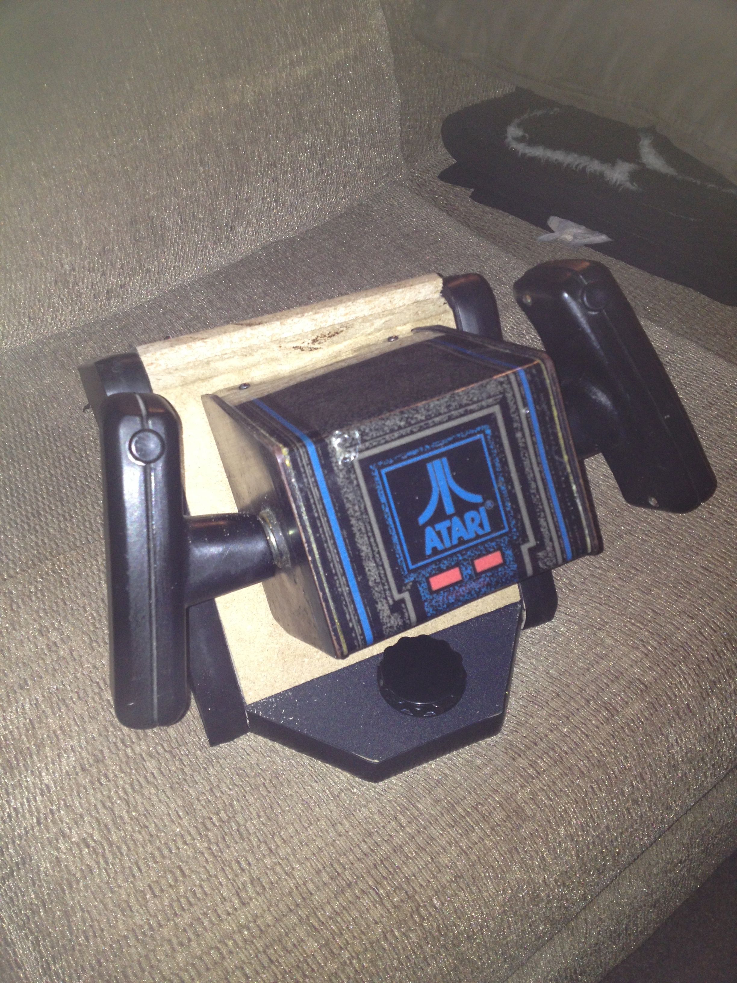

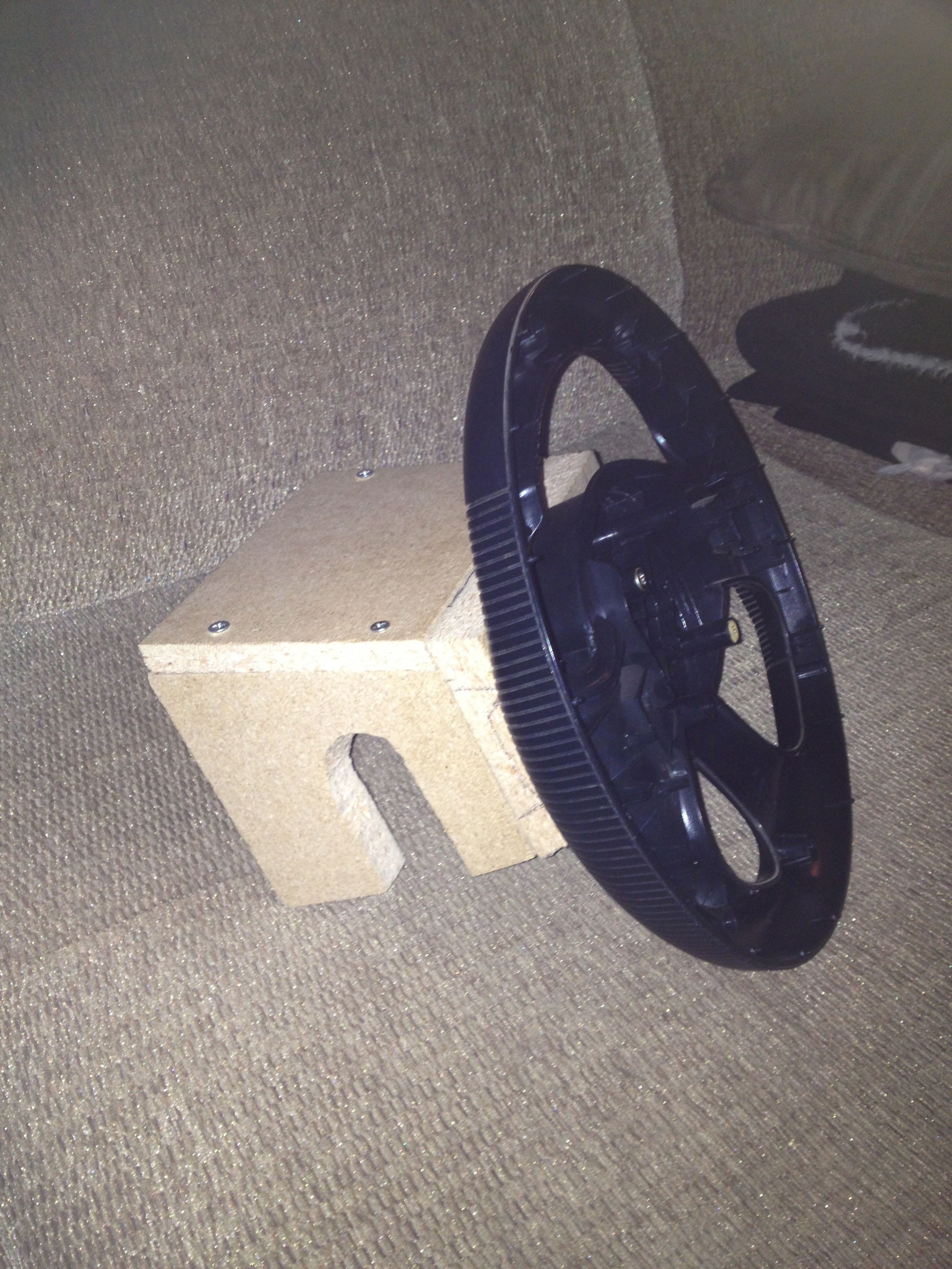

« Reply #57 on: August 31, 2013, 03:02:44 am »
ok, this one came to me in a dream, seriously.
i have the pop out 360 wheel but what about those 270 degree games?  i thought of making another add on like my star wars and hang on, but in a dream, this made so much sense to me so away we go with...
an add on to my add on!  the below is simply a proof of concept build to make sure it is sturdy enough.
first pic, my original star wars add on
second pic, my steering wheel add on
third pic, my steering wheel add on making sweet add on love to my star wars add on
basically, this slips right over the hub of the star wars yoke.  i have on order some strong earth magnets that i plan to counter sink into the inside of the steering wheel add on along the top and the front.  these magnets have 20 lbs of strength so they should hold rather well.  it is pretty snug and sturdy already but i want a bit more strength to hold it in play should a game session get overly aggressive.
the steering wheel is a microsoft precision wheel (not force feedback) that i took apart and gutted.  in addition to just the wheel, i am going to be wiring the 6 face buttons and two paddles that are behind the wheel up to the star wars yoke base that i built.
basically, the top of the base that i built, i'll be installing a vga connector that passes wires from the star wars add on wiring up to the top of the case.  when you slip the wheel on, you plug it into the aforementioned vga sitting on top of the star wars base.
more pics coming soon as i work on this this weekend.

« Reply #58 on: August 31, 2013, 06:22:32 pm »
couple of quick pics for an update.
here is the star wars add on attached to the cab.
and here is the wheel add on attached to the star wars yoke.  i think i'm going to cancel my magnet order, this thing slips on and is rock solid.  i still need to do the wiring for the buttons but had to do a bit of play "testing" first :)
as is, i can do 4 buttons on the wheel easily but want to get all 8 wired up so  have some figuring to do...
