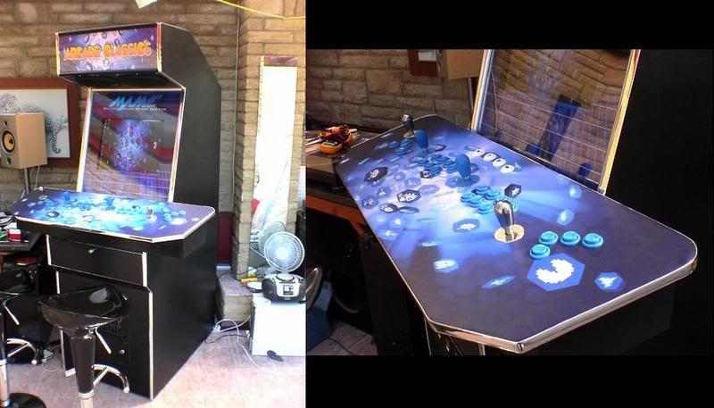

I built a cab a couple of years ago for a college project (theres a couple of pics below) but I had to move to a place where I cannot fit my full size cab and I had it in storage collecting dust for ages. Ive decided to build a cocktail cab as I have room for one and so decided to part out my cab and sold some of the parts on ebay and I am going to recycle some of the parts. My once beautiful cab is now just a shell of happy memories  :'(
I have a few ideas so far but as of now im thinking of building a cab with two player head to head vertical controls (Joy and three buttons each probably) and also having two  players side by side on one of the horizontal sides (Joy and six buttons each).

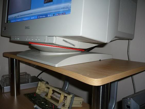

I think i am going to have to go down the CRT monitor route, I already have a 22" CRT that I had in my cab so I will probably use that.

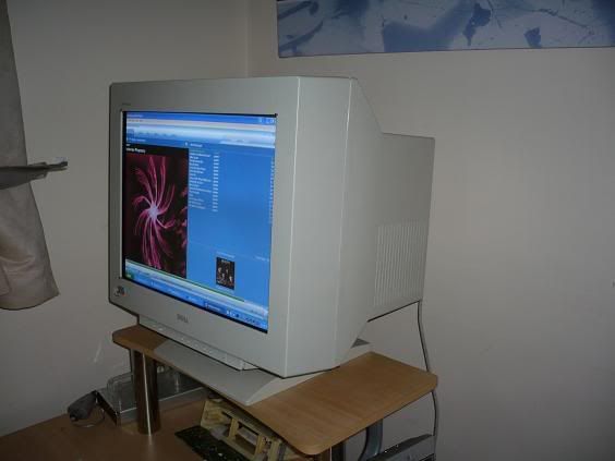

I started designing the table in CAD last night. 3 hours into it it decided to crash on me and I lost all my work up to that point, that will teach me not to save regually! However a little help from my good friend Grolsch calmed me down and I got back to work again.  :cheers:  I was hoping to post some images last night but I didnt get enough done but im going to carry on tonght and Ill get something up for you guys to look at rather than posts and posts of words!

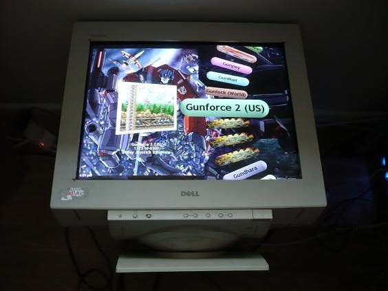

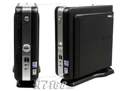

I have had a litte luck in the way of a PC to run things. I have been offered a Dell SX270 for £75 delivered to me. Its a 2.8ghz, 512mb ram small form factor PC which I think would be ideal for my project as I would be able to use it inside the cab without having to decase it. The only thing I am slightly concerned about is that they are known to run hot and pop capacitors. I was planning on having at least two fans sucking air in at the bottom and a couple sucking air out at the top and I think that this may keep the PC even cooler than it would be when used normally in an open space. Any thoughts on this?
EDIT: This is a picture of the PC in question.
My old company had a number of 270s in the small form chassis; they did run hot and, on occasion, fry a cap. The fans are a good idea...
Kaytrim
  • I'm too nice a guy
  • Posts: 2095
Re: 2nd Project - Its cocktail time!
« Reply #9 on: October 12, 2007, 10:49:12 am »
I would at least open the case once you put it in the cab.  That way the heat will be able to dissipate better.

Thanks for the advice too. Ive decided against the 270, I dont want to run the risk of overheating plus it will be hard to upgrade in regards to video etc. Not to worry though, the same guy has offered me a 3.1Ghz Dimension 4600 with 2GB DDR for the same price! (£75)  :D  It means I will have to decase but that isnt a problem.

Be mindful of airflow, whether you decase or not. In most modern cases, airflow is designed to pass over heat-sensitive devices. Decasing and randomly placed fans do not, by themselves, guarantee heat dissipation; make sure airflow actually passes over your components...

This has been taken in mind. The original motherboard has a 90 degree bend tunnel which draws air directly onto the CPU. I cannot easily recreate such direct airflow towards the CPU/motherboard but my plan is to posistion the fans so that they provide as much airflow as possible towards the CPU/motherboard.
Im still undecided whether to have four fans pulling in air around the CPU/monitor and have enough ventilation at the top of the enclosure to release the air or should I have two fans pulling air in around the CPU etc (at the bottom) and then have two fans to expel the air at the top. Any thoughts?

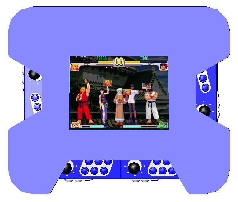

« Reply #14 on: October 13, 2007, 05:05:43 pm »

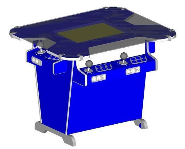

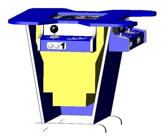

Thanks for your post Green Giant. You will see from the models below that space is going to be at a premium so I dont think I will have enough room for ducting. Im pretty sure of what I am going to do cooling wise which I will post at a later date.
I have started to make a CAD model of the type of thing im looking to make. Ignore the colour scheme, im thinking of doing the whole thing in black vinyl (possibly textured) with chrome t-moulding and stainless other parts, I am quite liking the blue/chrome though! Ive diplayed it in blue as it is hard to make out alot of the image with black panels.
These are a couple of views of my design so far:
I have decided to have quite a chunky top on the cab. I quite like the profile as it looks almost space invader'ish. There will be chrome t-moulding around the top but I have not added it to the drawing so far. Also note I havent added the glass as yet (ive modeled it but it seems to mask the raster SF2 image).

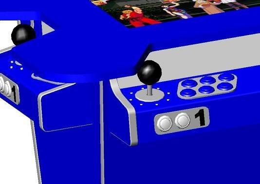

This is a close up of the CP areas:

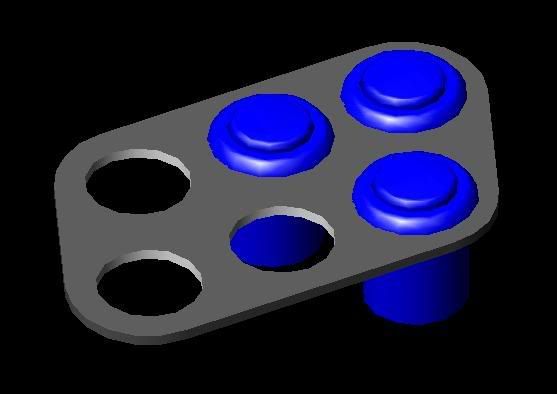

Im going to make some button bezels out of stainless steel to surround the control buttons as well as the buttons on the front of the CPs (Player start and credit). Im also going to make some stainless dustwashers to match.
The eight white dots around each joystick are going to be short cylinders of perspex laid into the CP with a LED mounted from the rear side to light them (thanks for some inspiration on that one theCoder!)
The CP buttons are all going to be clear with LEDs controlled by a LED WIZ and Mala.
Im also going to make some heavy duty stainless steel feet to raise the cab off the floor. Im going to turn some wheels and mount them in on of the legs so that one end of the cab can be lifted slightly to whell the cab around.
Im going to use a 22" flatscreen CRT monitor in the cab. I made a rough model of the monitor and based the cab around it. You can see from the picture below that there isnt going to be much spare space but this was planned as I want to have a large screen to cab size ratio.
The white/grey areas behind each CP are going to be made from some UV reactive perspex that I have and are going to be backlit with UV LEDs.
Please ignore the 1 and 2 on the front of the CPs, im going to have some 1 and 2 player 'man' images instead.
I think that there is plenty more that I have forgotten to post but im quite tired due to the amount of time I have soent on CAD this weekend. Ill update the thread tomorrow when I have remembered anything and when I have updtaed the models.
Any thoughts/suggestions etc so far?

« Reply #15 on: October 13, 2007, 11:13:12 pm »
Are the joystick balltops to scale? they appear much bigger than I would think they'd be.
Looks great though!
I like the slopped shape.
It seems that the top panel may get "in the way" when moving the sticks and playing... what do you think?

No, you are right the ball tops are not to scale. I didnt have any dimentions to hand when I modelled them and just guessed them and they do look on the large side. Ill get some propper dimentions today and update it.
You are also right about the top looking as though it will 'get in the way. Im going to lower the CP height and I may also make the CP deeper to give a little more room inside. Ill model the internals of the buttons and the joystick bases to see exactly what room I need.

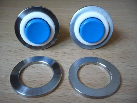

I have made some more progress, mainly with the modelling but I have actually done some physical work too  :)
This is the stage im at with the design/model:
As you can see I have added the glass, t-mouding around the top and the glass clips. I have also lowered the horizontal CP by 50mm to give a little more vertical hand clearance. I have left the vertical CPs how they were (although they will be the same height as the horizontal one) so you can see the difference.

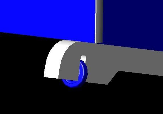

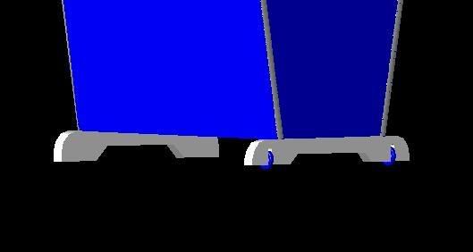

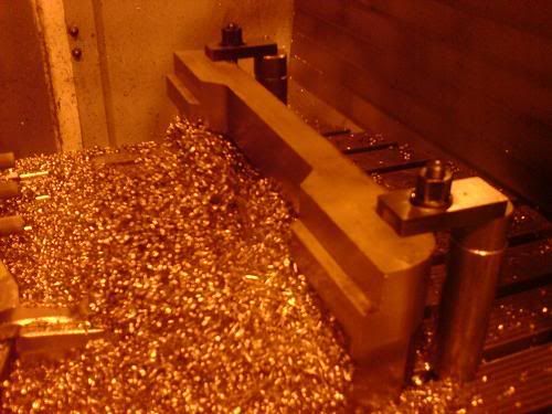

This is a picture off one of the button bezels that I am going to mill out of 3mm stainless steel plate:

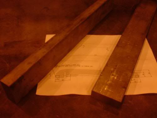

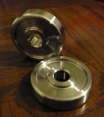

I have also modelled the feet which I am going to CNC mill from solid stainless steel bar:
Im going to mill two 12mm slots in one of the feet and mount two wheels on spindels to allow the cab to be lifted up at one end wheeled around. This is a closer view of the foot with the wheels in:
I had a little free time at work this evening so I produced the two wheels on a CNC lathe:

This is the monitor that I am going to me using:
Its a Dell 21" flatscreen CRT that i used in my old project. Its a bit on the large size and is freaking heavy but its also free :) I would like to use a LCD but you cant seem to get one over 19" or so thats 4:3.
Ive tried it on its back and it seems to work fine. I didnt want to get down the road after I had built the cab and find out that it didnt like being on its back. I wanted to test it on its back for a while but i was just a bit worried about it getting hot in the case on its back with no ventilation so I just gave it a ten minute test. The finished cocktail will have plenty of ventilation.
I dont really want to decase the monitor if I can help it as I have heard stories of the breaking so im going to try and keep it intact if possible. It does have rather a large stand/foot though which is going to have to come off for it to fit in the case. Im thinking that at least the section below the line will have to come off:
I was originally planning on having a black cocktail with chrome t-moulding and accents but I have been using blue for the panels as I have been modelling it as it is easier to see what is going on and the blue realy has grown on me so I think im going to go for blue with white t-moulding and stainless accents.
Im going to add some pinball buttons to the cocktail for Pinmame etc and I remembered that I had blue buttons with a white plastic bezel on my old cab and I thought these would compliment the colour scheme nicely. The buttons on the main CPs are going to have CNC lazer cut bezels around them so I thought I would make some mini bezels for these single buttons to match:
The ones on the left came off the machine with a polished turned finish and the ones on the right I used some 320 grit emery to give a brushed finsh. Im not sure which I am going to use yet.

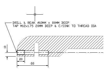

Ive just finished the dimensioned drawing for the feet and Im going to take them to work later to get programmed ready to be CNC milled.

SithMaster
  • Posts: 1781
Re: Franco's Custom Cocktail (UPDATE: Few bits & Stainless button bezels)
« Reply #19 on: October 31, 2007, 02:46:14 pm »
So will Optimus be in your cocktail front end?

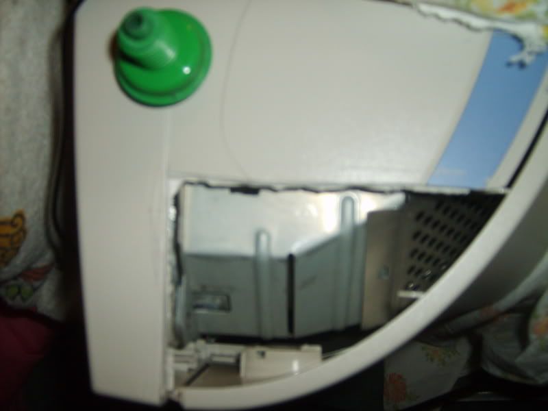

For my 21inch monitor i cut part of the case so i can drive a bolt through the mounting tabs but the other end screws into the back case.  This way its protected and securely fastened.  Not sure if it makes a difference but mine was for a galaxian setup (which i should work on).

Wow, I like those rings.  You wouldn't be willing to sell a few like the ones on the left wouldya? :)
He he, im not sure what im doing yet graphics wise, that Transformers background is what I had on my old cab. I think im going to go for some kind of Spacies theme (got a few good ideas) so ill proably have some kind of Spacies FE theme too.
I do like your idea for the monitor mounting. This has been one of the aspects that has been troubling me. Do all monitors have mounting tabs? What part of the casing did you cut away? Is there any way you could take a picture for me?
I dont see why not. I cant make millions of them as I dont have much bar stock but I dont mind making a few for you. How many are you after?

I can try and get a pic or two taken tonight of the monitor.  I used a hack saw to cut the case (after i removed it first) and cut the corners where the tabs are.  As far as i know all monitors have these tabs.

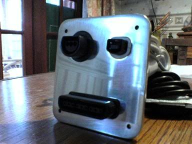

I made these console adapter plates (controller extesion to USB) a while a go which I would have liked to use but I cant see me playing many games using control pads due to the angle of the screen. This is one of the reasons I wanted to be able to flip the monitor up. Oh well, maybe for the next project...

I started making the stainless steel feet for the cocktail today.
I extracted the dimensions of the feet from my CAD model and got some stainless bar cut off to the right length.
The two sections were placed on top of each other and CNC milled. One was milled 10mm shorter than the other to give clearance for the wheels. The added height of the wheels when in place will make the table level.
Tomorrow I am going to mill the 12mm slots to house the wheels I turned and I also need to drill, ream and tap the hole that will hold the spindle which the wheels will run on. I am tapping the end of the hole as I have made some M12 grub screws to  hold the spindle in place.

I checked my monitor and I now remember that i wasnt going to use the rear case since mine had a metal cage around it.  I still can if i use a harness or something to hold it onto the supports.
since your making a cocktail then you can just cut away the case from the metal tabs and have them rest on wooden supports.  the case can then remain around the monitor but it wont be attached and the monitor wont be resting on it for support.
ill try and get my monitor pics up tomorrow and also a paint diagram.

Thanks for the monitor help SithMaster. That seems to make sense. Really I need to get my dremel out and attack my monitor to see what im dealing with but I need to get a replacement monitor first. I should be able to pick up a free/v.cheap smaller CRT of ebay locally hopefully.

The tapping of the holes in the legs didnt go quite so well as I managed to snap the M12 tap in one of the holes so I need to get it spark eroded out and get another tap. To be fair the tap I used was rather ancient and had seen better days but I thought I would try my luck. Oh well....

I'm bummed i didn't find this thread earlier.  my cocktail is very very similar to this (Dave's Not-So Classic Cocktail), down to the K (with the hole) shaped top, and running ultrastyle.
but...  your metal work is really going to put this over the top, and the taper you have in the cabinet looks great, and hopefully will make it more comfortable to sit at.
If you like, here are some things that you might find will make the unit more comfortable to play on:
- lower the monitor about an inch, and open up the hole on top significantly (and make a bezel), to help get better perspective on your screen.  I seriously regret not doing this, and it's too late for me.  The portal effect is much more impressive than the flush.  Trace the sight lines to make sure that nobody ever has to lean over.  The top will always look great as it all just looks black.
- flip your monitor upside down, as the top of the monitor is thinner than the bottom.  this, along with dropping the monitor will make a huge difference when you're playing horizontal games.  any decent video card will be able to flip the image to accomplish this, and mame/daphne/zinc don't know the difference.
- on the horizontal side, i would keep the CP height the same and just manufacture the clearance by using shorter sticks, and opening up the top more.  knee space is important!  :)
- make sure the side CP's are centered on the screen, not the monitor.  my earlier one was centered on the monitor and it just always looked wrong.
-and whenever you can get away with not decasing a monitor...  don't (learned that one the hard way).

Heres a pic of what i did though the angle kinda sucks.  Nice score on the monitor (got mine for 10 dollars and got a ride to pick it up about 5 miles away).  Before cutting open the back and see how everything is placed.
Hi Davie, thanks very much for your input. Have you got a link to your cocktail? I would love to see it.
Im not actually going to be running Ultrastyle (even though I love it), Im going to use Mala for the LED WIZ support.
Hmmm, I like the idea of this, Ill have to have a little play around with it  :)
Im not sure if I am going to have room in my table to install a decent video card due to the height of them and am just planning on using on board video at the moment as im not intending on playing anything too intensive. At the same time though it would be a good idea to flip the monitor as suggested. Im receiving the PC for the build this week and im planning on doing a hardboard mockup so this will give me an idea of the space I have to play with. I would like to be able to get a video card in for future upgrades etc. I dont suppose it is possible to get a female AGP> male AGP 'extension' so that I could mount the video card at 90 degress if I am tight on space?
Yeah this is another thing I am going to sort out with the mock-up, the CP heights are just at a random height that 'looked right' when I modelled it. Im going to machine some joystick shafts for the perfect height required for the panels though, I thought I would have to do this as I am rear mounting the sanwas from under the MDF CP (there is a reason for this rather than sinking them into the top of the CP, Ill get to this later).
Thanks, ill make sure I do that, I dont know if I would have thought of that.
Can you tell me why you dont suggest decasing the monitor? I have heard some people have had problems but I havent heard what.
Thanks again for your input, its gave me some really good points to think about.  :cheers:

De-casing...  ugh.  I got shocked pretty good twice, and ultimately shorted out my first monitor by decasing.  I really had no choice with that particular monitor, the case was a lot of fluff and it got significantly smaller by removing it - - but i know the dell model you have, and it's pretty lean.  you won't save much space, and will always have to be super-careful.  I should have just used a different monitor.  I understand the temptation, especially with your taper, but try not to...  running the monitor upside down should help you get the taper you want, at least on the player's horizontal side.  I'm not opposed to taking off anthing plastic, but at some poing you're going to start having exposed circuitboard and glowing stuff.  that's where i draw the line now.  :)
Im thinking about leaving the case on now. You are right, there isnt much space to be gained by decasing it, I was just struggling with ideas of how to mount it and I thought It way be easier if it was decased but I had a good think last night and I think I have found a good solution.

Ive decided to change the wheels I have made as I think there is going to be too much weight for such thin wheels and they may end up damaging the carpet or marking the laminate floor. The ones I have made already are 10mm wide, im going to make some wider ones at about 40mm wide to spead the load.
