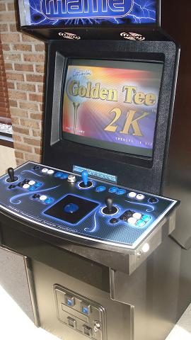

My cab lives downstairs and gets so much play by the kids during parties that the parents (mostly me) don't get a chance to play.  I want to build a small lightweight cab that we can pull out and set on the kitchen counter or that we can throw in the trunk and take to special occasions.  This is my second cab project and first built from scratch.  I plan on formally documenting it at: http://home.comcast.net/~larmead/partybox  but am looking forward to sharing the experience and discussing the progress in this forum.
Below is my original concept sketch (well, it's actually the 5th rev.)  I
