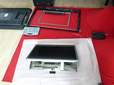

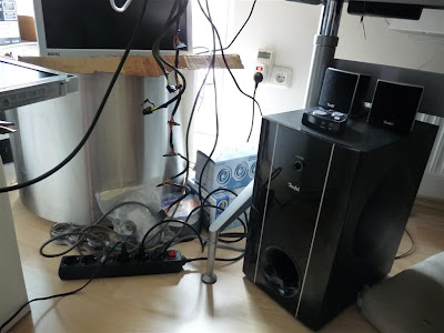

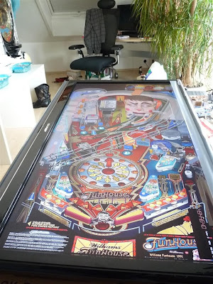

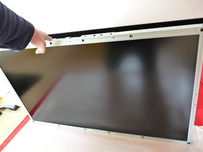

46" is the maximum-size which fits in my star trek : tng cabinet. there is no visible bezel, so it gives a more authentic / realistic feeling at all.
here are some pics of the build
greets
chris

reko, the siderails are simply attached with screws, so you can remove the lcd easily. the dmd-monitor displays all scores from all generations and the full modell number for the lcd is aquos lc-46d65e, i think they are similar.
here are some new pics, question: where is the virtual machine  ;)
greets
chris

i looked for good viewing angles and response time. so i found the sharp screens with its "advanced super view" (asv) lcd-panels. sharp did a very well job, i am absolutely satisfied.
if you choose another brand, look for a very small bezel, otherwise the screen won't fit in a standard widebody cabinet.
here are some mounting pics, there is no space left in the cabinet.
regards
chris
