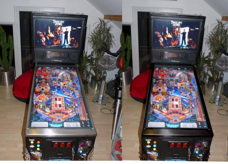

on the mounting-pictures siderails are loose, not yet attached with screws.
there is just a foam-strip (1mm) on the siderails to protect the screen sideways a little bit.
regards
chris

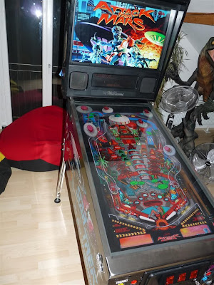

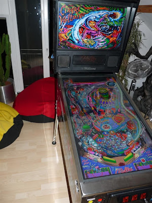

here are some shots of new tables:
circus voltaire
attack from mars
terminator 2
regards
chris

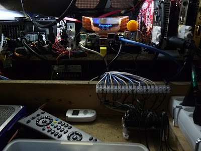

jigenjuke, the 19" lcd is mounted via adjustable mounting angles/brackets.
here are 2 shots of the dmd monitor
unclet, the playfield dimensions of newer bally/williams widebody machines (like my star trek tng) are approximately 108cm x 63cm (outside). The exact model number of the playfield screen is: Sharp Aquos LC-46D65E
regards

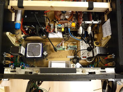

I am not really happy with the nanotech motion/plunger stuff, so I bought this second hand terminator/star trek gun assembly for replacement.
After some paint and restoration it looks like
I think this is a great (and working) enhancement for such gun-games like T2, STTNG (moveable canons), LW3 (gun videomodes) or simply for Indy, cactus canyon, guns n roses..... as well suitable for any other pinball tables (power sensitive ball-shooting possible)
ive got also some solenoids/knockers (force feedback) and 3 tilt-assemblys for nudging. I am curious how it works. more to come soon.
Furthermore I think about a black powder coated lockbar, legs and siderails...
what do you think?

at the moment I am testing 2 industry relays for force feedback. the noise and the feedback is very close to a real flipper. I will make a resistance test.
I have installed 2 tilt-assemblies for nudging, too
here you can see the industry relay.
heres a shot of the STTNG gun. I love that gun! gives a new experience to all gun-games.
everything is connected to an IPAC now. the Nanotech stuff is terminated :D
regards
