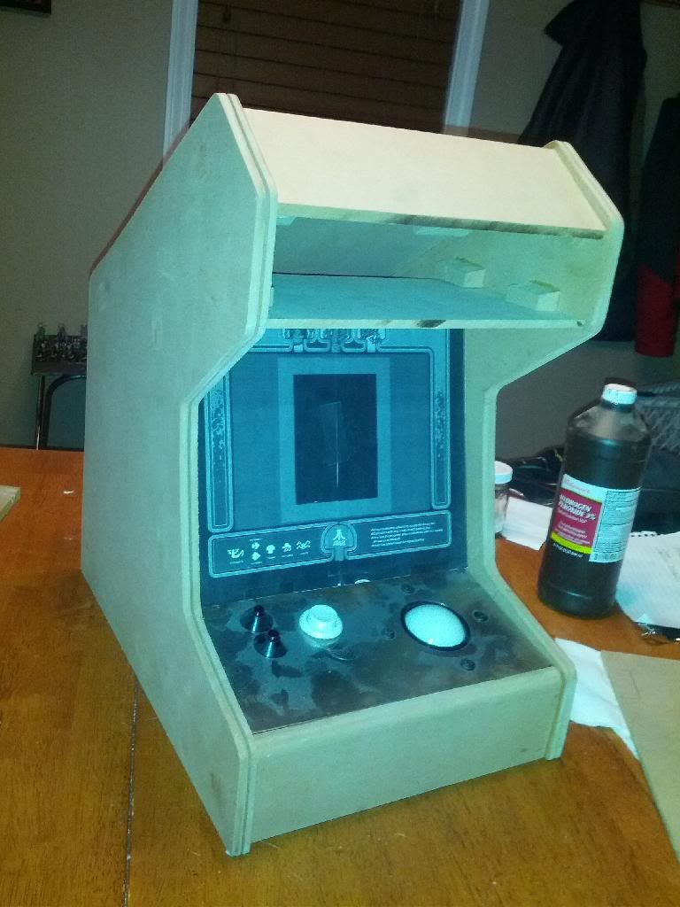

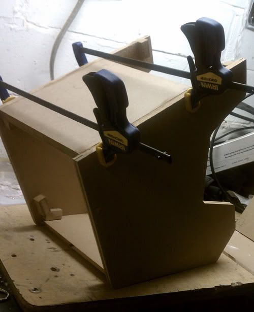

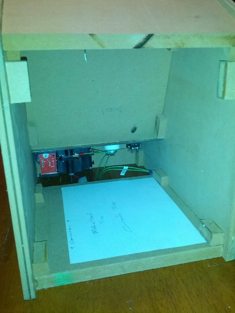

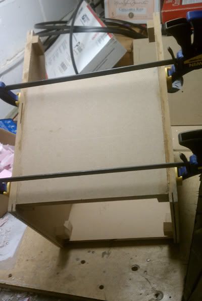

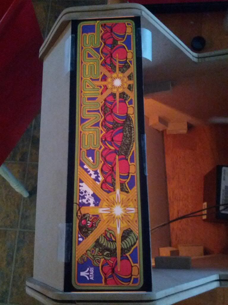

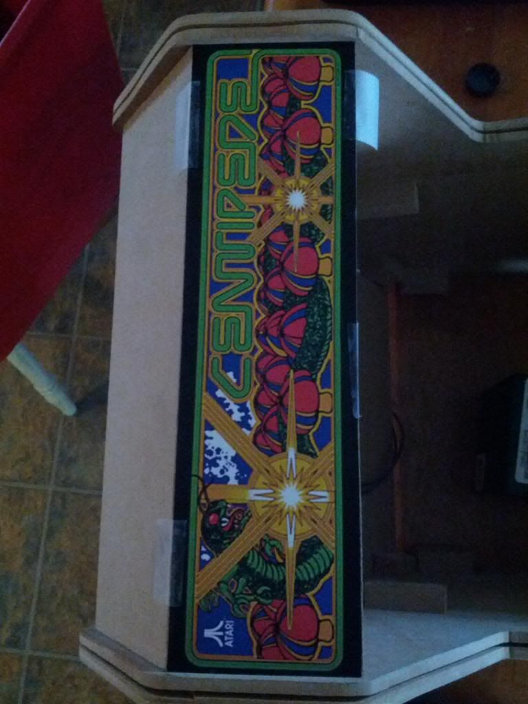

Spent the slow times at work devising a way to safely fix the base problem. Originally I was going to leave it in place and Jigsaw the gap I needed, but instead I got crafty with my pocket knife and a paint can opener. After some gentle persuasion with my pocket knife I was able to slowly pry the two pieces apart with the lid opener and viola! Fixed problem!
That's how it should have been...
and another view.

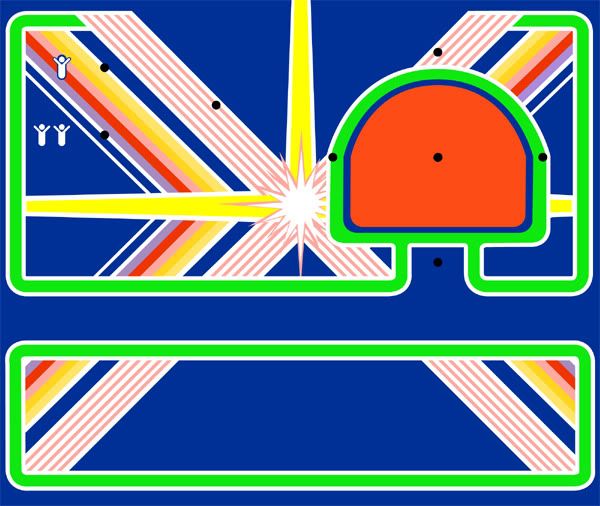

Also, I finished up the Control Panel artwork in Illustrator this afternoon. Now all the spacings are figured out properly and I'll be able to print a copy to use as my hole template for the CP top.
What's this? 3 days of work in a row.... crazyness.  :laugh:
Re: Centipede Bartop: Base problem solved, and Final CP artwork (7-11-11)
« Reply #121 on: July 11, 2011, 10:56:53 pm »
Craziness indeed!
Nice mulligan on the initial gluing. Lucky you were able to get it off before the glue solidified.
The artwork is looking sharp too!
« Reply #122 on: July 11, 2011, 11:13:25 pm »
Oh the glue was quite solid, it sat for a little over a day before I realized I screwed up. It pulled some bits of mdf from the side, but nothing crazy though.  Thanks on the art, I'm still dreading the vector job for the side art....  :cry:

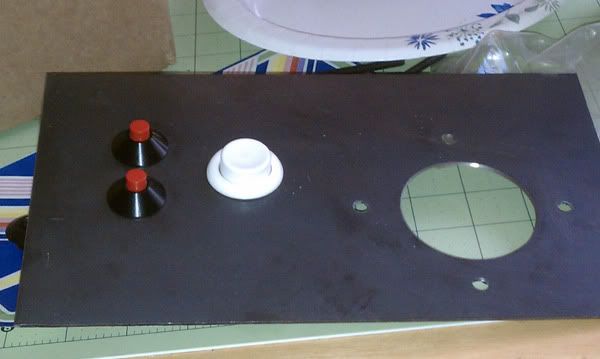

Re: Centipede Bartop: Control Panel Woes (7-19-11)
« Reply #144 on: July 19, 2011, 10:51:08 pm »

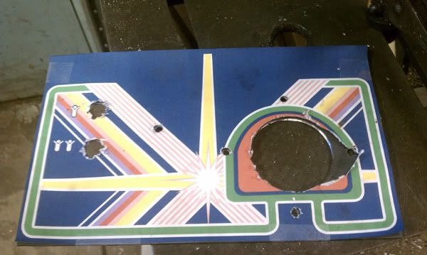

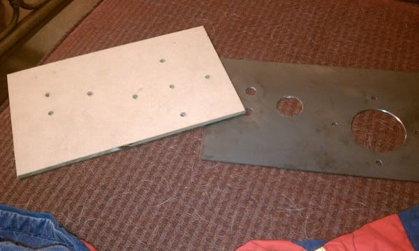

After spending a few days trying, unsuccessfully, to wrap my head around the lit player 1 and 2 buttons.  I may just go the solid light route, or leave them unlit. I finally decided to put it aside for the time being and get back to work on the body itself.
I'm currently working on the control panel area, since I now have the exact measurements figured out, thanks to finishing my artwork. Working with the metal control panel has provided it's own interesting obstacles. All ideas I have come up with up to today have been subpar. All day I was tempted to ditch the idea of the metal control panel top, though I doubt the 1/4" mdf would handle the stress well, especially if routed out to accept the buttons and the trackball.
Tonight while looking over everything I took the piece of wood I had cut earlier and was laying pieces on top of it, testing things. Noticed that there is plenty of space around the edges to allow for 4 carriage bolts in the corners to hold the CP in place, I just need to build up an frame underneath for the CP to sit on and bolt to, simple.
Hopefully I'll have some new progress pics soonish.

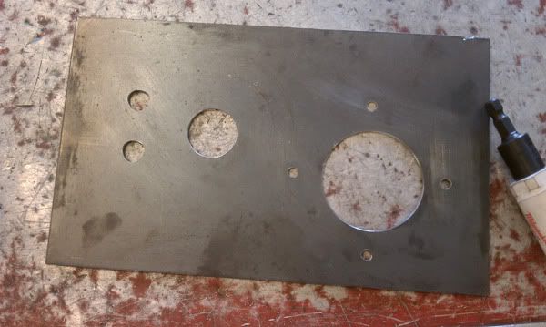

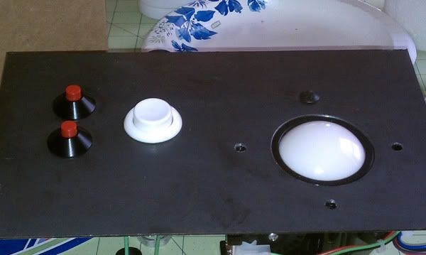

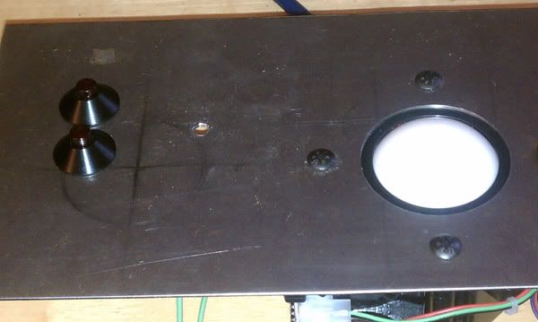

Re: Centipede Bartop: Control Panel Woes Continued (7-27-11)
« Reply #145 on: July 27, 2011, 12:15:22 am »
Kind of a long update ahead.

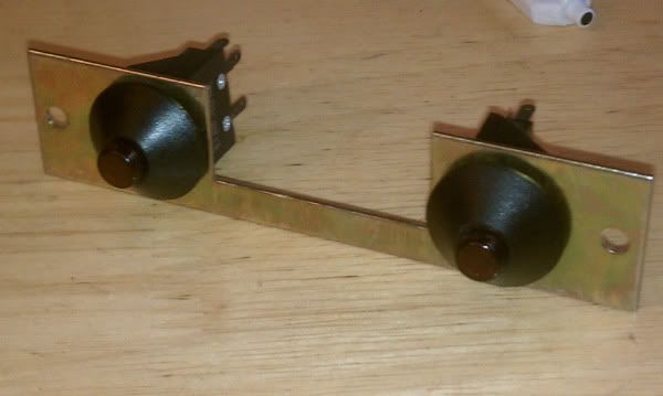

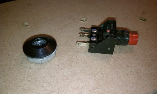

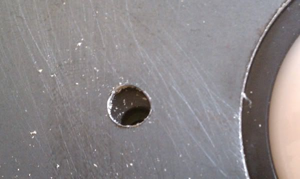

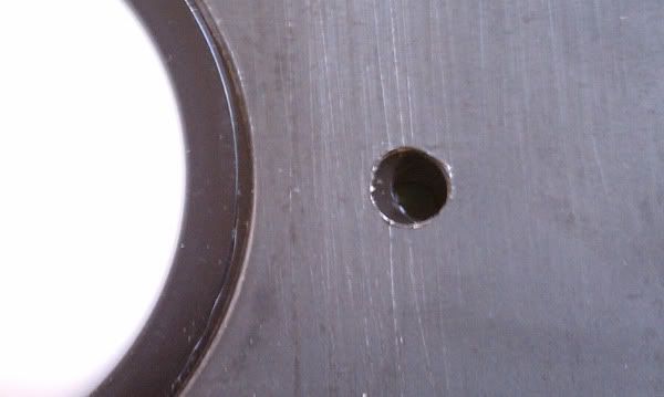

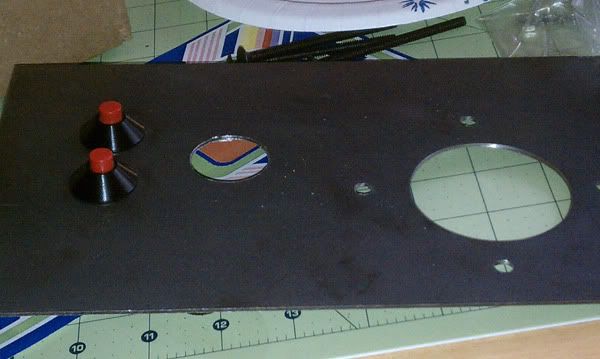

Work continues on the Control Panel. Finally got back to work on it after last week's heat wave, which left me completely drained of energy. Ordered a few buttons on ebay while I was doing planning, though originally I had thought they were lighted buttons... turns out they are just red capped push buttons, with extremely shallow cones. Nice condition for being used stock, I'll save them for something, or maybe sell them off. I have since ordered a set of lighted Atari buttons from a dude on ebay, double checking to make sure they were legit. They were NOS and 1/4 of the price of ordering lighted buttons from RAM.
Red-Capped Non-Lit buttons w/ Shallow cones.
Anyway, today was a metal work day, and I spent it cutting and drilling the  (3rd) piece of scrap metal for the panel. I printed off the CPO and used it as the drill guide. I was able to use all the tools at work to get it all drilled and cut out, except I was missing an 1 1/8" hole saw for the Fire button. Luckily, I was sent on an errand later and was able to pick one up while I waited for a parts order to get filled.
All holes, Except the Fire button are drilled.
Fire Button cut out.
Everything was looking great seemed to be 100% in my favor, until I got home that is. Sadly, I was a work when I did all the drilling and did not have my parts with me to double check everything. As soon as I got home, I set everything on the table and started test fitting parts.
Player Buttons, With the Red Capped push buttons in place of my original black ones.
Fire Button test fit.
Trackball Test fit, notice the single carriage bolt holding it in place.
When it came to this point I realized something was very wrong. The holes for the carriage bolts didn't line up. At first I wasn't sure how this happened and I knew my measurements on the Control Panel Art were correct, they had to be. Originally I was thinking of drilling them out to make them "work", but I'm not half-assing this project. So another (4th) CP will need to be made. Yay for scrap metal in abundance!
I left things set and went out to dinner with some friends and forgot about it for a few hours. After returning, I remembered I had taken the printed CPO and laid it out on top of my MDF test piece, marking the hole locations with a Sharpie. Went to the basement and found it, drilled all the holes in it. These holes in the MDF all line up with the trackball perfectly, unlike the crappy metal CP. So the only thing I can guess, is, the paper warped or moved enough to throw things off while I was drilling, thus giving me issues with my hole locations. Even though it was secured in place.
This MDF Template is right.... the metal one... not-so-much.
So, there we go, tomorrow I will take this piece of MDF to work and make and new-new CP. hopefully from there I can get it test fit into the cab and I can move on to the light box and speaker panel. There are quite a few more things I need to do before I can start painting yet. But, like I said, I'm not going to cut corners just to rush things.

After a day of sickness, I was able to knock out a new control panel at work today. This time I took my MDF test piece and used it as a guide. All cuts were made at work, except the Fire button (forgot my hole saw at home). Afterwards I double checked my measurements against Happ's online templates and everything looked spot on.
When I got home, I had a present waiting in the mail... lighted Atari cones from ebay! So I cracked them open and started test fitting everything again. The cones themselves were plastic, so I'll be using my aluminum cones from RAM Controls in place of them. The trackball fits nicely now that all the measurements are correct. Tomorrow I'll cut the hole for the fire button and clean any sharp edges off of it. Finally I'll paint it black and work on mounting it into the cab.
Lighted buttons
Test fitting the new cones and the Trackball into the panel.
I don't like how high the buttons stand above the cones, so I'm prolly going to toss a few washers underneath them to bring them down a bit. Other than that, I'm pretty happy with the way it's finally come together. I'm hoping this is the last super annoying snag I hit in this build.

The Led buttons can be lit with 5v DC with a resistor in line, otherwise they POP with stright 5v. The 2 connectors that run parallel to the button housing are 5v and ground, the 3 connections that run perpendicular are your button ground, nc and no connections. You could run 5v from your power supply to the jamma board or even hack 5v out of your PC, which will work fine.

Another big move forward is that I finally completed the side artwork. The complex nature of the Centipede's artwork was really really intimidating and as such I had trouble focusing on it. After I got the PC in hand and realized that the board would work for the Bartop, I got hyped and over the course of a couple of nights I was able to knock out the side art. This means that all the artwork should be good to go! The artwork, like the Control Panel and all my other arcade art was done in Illustrator.
So, there we go. I'm hoping that the Centipede can get finished this year, finally. I have another empty upright cabinet sitting in my Shed right now too. But I'm not touching it until I get this one done. I have some cool ideas for that one too.

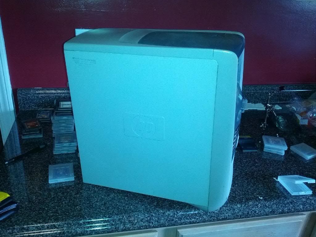

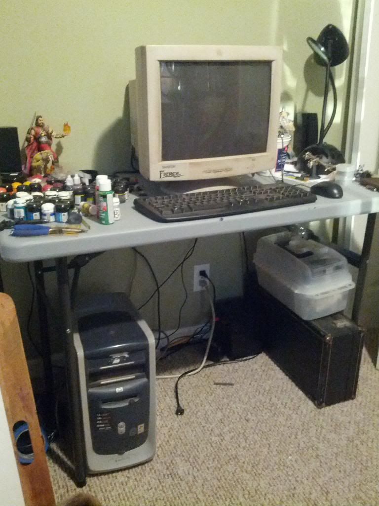

Not really a huge amount of progress happened last night. But at this point, any progress I make is good progress.
Here's the PC, it's an old HP. It's a little on the weak side of things. But I'm hoping that if it's only running something as simple as Centipede, that it should work no problem.

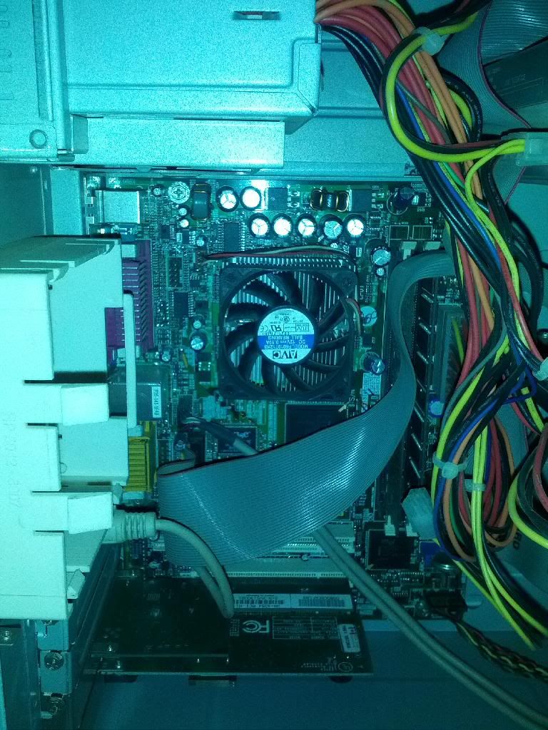

Before I hooked it all up, I cracked the case open to check out the board again. Using a tape measure I reached in and took a couple dimensions from it and found that it came out to be 9" x 7.5". I had done a quick measurement before, but that was months ago... So I grabbed a sheet of paper and cut it down to size for a test fit template.
With the paper in hand, I pulled out the ol' Centipede and put all the parts back into place. So I could see how the inside should look. Having it all sitting there dry fit together totally built up the hype level too. It just screams "finish me"!
After that was all done, I set to work on the PC. I set it up on my painting table in my spare bedroom. That way the whole set up was out of the way and not taking up space in the kitchen/dining room.  But I didn't get very far with it. There was a ton of stuff on it that needed to go and I decided that it really needed a good defrag. So after about an hour of deleting programs and cleaning up the unneeded files. I set it to defrag and let it simmer for the rest of the night.
I had to laugh after it was all set up. Cause it really reminds me of my old bedroom at my folk's house. Covered in PC and painting stuff.
I work until 3pm today and after that I'm going to get back to work on it. The plan for tonight is to finish setting up the PC and toss all my arcade files onto it. Then before I get to work hiding any UIs or anything, I'll do some test runs of MAME and Centipede to make sure that it'll all run nice.
By the end of the weekend, I hope to have the PC all ready to go. Then it's only a matter of wiring up the trackball and finding a screen.

Sunday morning before I started doing family stuff, I loaded the PC back up and looked into the MAME issue. Turns out that the reason the MAME wouldn't load was because my display output is not compatible... Which basically means I need to pick up a video card for this thing.  :angry:
So I'll need to look at the board and see what kind of socket I have in there and start looking for cheap video card solutions. I'm pretty sure it's going to be a old style PCI port, pre-PCI express.
sigh.

The good thing is, older PCI cards with various video outputs such as composite or S-Video are relatively easy to find on eBay. You don't need a powerful card either, as long as it's VGA.

Yeah, or you can have a good buddy like Opt2not tell you he's got an extra PCI card laying around that he'd be willing to donate to my cause! Thanks bud!
Now I just need to check and make sure it's a PCI slot for certain. Possible
setback averted? !
EDIT: It's got PCI slots for certain. Yay!

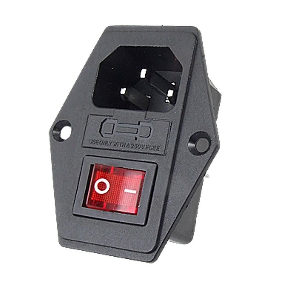

I'm currently at a stand still with the PC. So I started working on the cabinet again. So far this weekend not really done a lot of work. But, I did order a a part and began the work on how I want start filling the cabinet.
The part I ordered was a inlet plug with a power switch. It's a standard PC cable 3 prong job. I'll mount this low on the back panel and run a cord into it. This will keep things nice and clean, by having a removable cord, in case I want to transport it some where. I'm planning on wiring either a 3 way extention cord plug or the smallest surge protector known to man into the back of it. Plus the built in switch will act as a main power switch for the entire cabinet, much like the switch I have mounted on top of the SHMUP to cut power to everything. Next to this, I'll take one of my original Radio Shack black pushbuttons and use that for the power up button for the actual PC.
Power Inlet

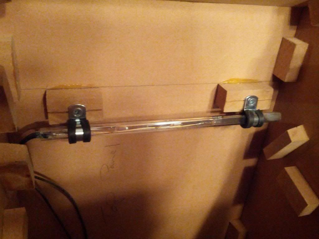

Also, before I left today to hang out with some friends and play board games all night, I mounted a new-ish LED light in the marquee box.  It's actually an LED licence plate light from my work. It's only 3 LEDs, but I'm thinking it should be fine. I want the marquee lit for sure, but I don't want it to be overwhelming either. So I tested it out with a marquee I had printed off on some brochure paper, and it looked pretty solid. I might paint the inside white though to help the light bounce a bit better.
Mounted LED light (the darkness on the right side of the light tube is actually black paint overspray from another project)
Unlit Marquee
Lit Marquee
