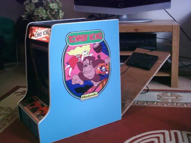

Last couple of build pics here guys.....
Bezel cut out and ready for fitting. CP built up and also ready to be attached.
Sideart being very carefully applied. Went on with no drama. (I was worried about this bit to be honest)  :P
And I can now tell you that this project is now FINISHED!  Well... 99.9% finished. I've just spent the last day or so fettling those little awkward jobs that sometimes get left. Fitting a door stay to the back door, securing the ball top so it doesn't come off while playing, tightening up the plexi areas so that no light seeps through the gaps. Getting the software side of things complete with MaLa shelled and booting right into DK. All that kind of thing. (Still can't seem to hide the MB splash screen though  :dunno)
The only job I have left to do is fit a bezel around the monitor to fit the smaller size of  the game screen. I have a friend coming over tomorrow for the official unveiling (lol!) and he's bringing a decent camera with him for some completed pics. Will post tomorrow.

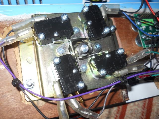

With this new board in there I needed a fan on the back door to help dissipate heat. The Mini ITX produces hardly any heat at all and will be used in my Defender/Stargate bartop I'm working on right now. It's already been tested and works perfectly fine. So here are some updated pics....
This stick is gonna take me a bit of getting used to . It plays fine and the real 4-way gate is nicer than the round restrictor I was using in the U360. But it does have a larger throw than I would have liked. Then again I wanted authenticity, and that's what I've got. So I better get practicing!
With the new CP I also included the dust washer under the panel together with the clear dust washer on top of the panel which came with new DK cabinets. Though they all tended to be removed or junked over time. I'm not happy with the centre hole on this one as it's not very clean. I also went to the trouble of putting in the CP bolts... or in my case round head rivets for that extra touch of authenticity.
Only thing I have to do now is set the software to be a DK dedicated. I might include DK Jr. and DK3 as well. But other games probably won't play too well with this stick, and as I say I can play them all on my other project anyway.
