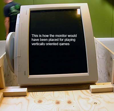

It's a vertical game...that means you got to turn your monitor vertical
