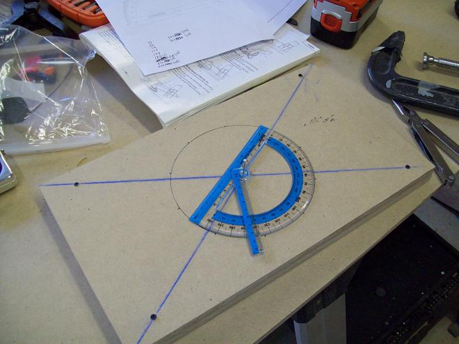

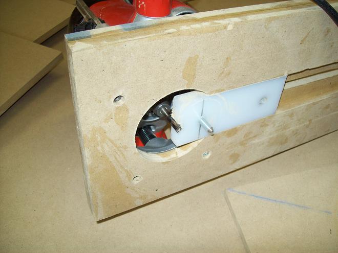

I had already attempted to make the two pieces that will rotate against each other, but I didnt like the way it turned out.
But I will touch on it a bit.
I cut two pieces of 1/2" MDF, one a 1/2" shorter than the other.
I then marked the center with a chalk line to each corner.
I then set up my circle cutter to cut out the center hole.
I had to route out a space for the bit to clear in the nylon block I used.

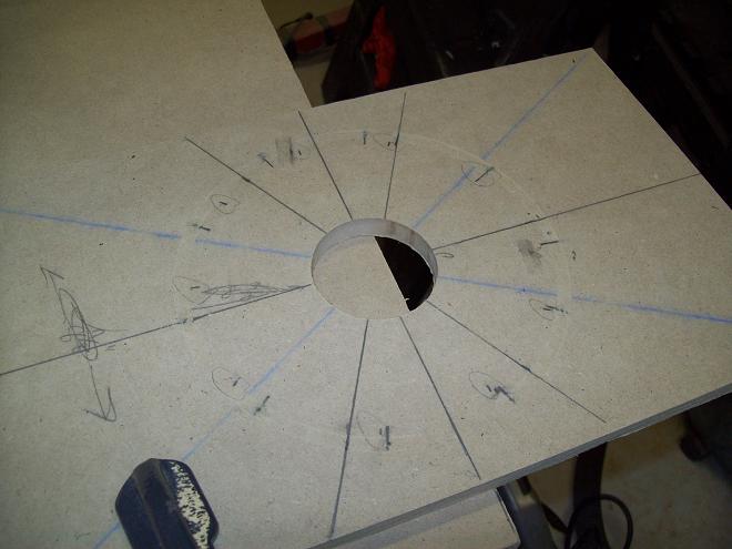

I then attempted to mark the holes for the magnets. I have 10 magnets so there needed to be one at every 36 degrees.
This was very hard since I had already cut out the center hole, and I decided to scrap these two pieces and start over.

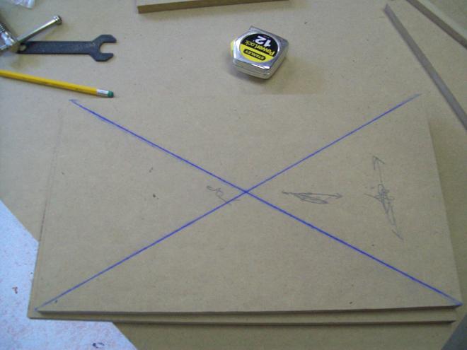

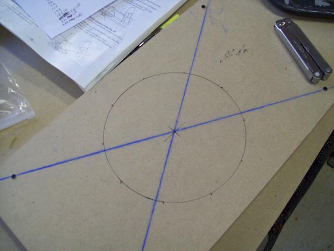

So I cut two more pieces the same size.
I fastened them together with 4 screws. I marked the top piece again with the chalk line.
My chalk line was a little off on one corner, so the center was off. I corrected it.
I then fastened my protractor with a small nail right to the center mark.
I marked every 36 degrees from 0 to 180.
I then twisted the protractor around and lined it up with the 0 and 180 marks, then I marked out the remaining 36 degree marks.
I then traced the round part of the protractor, making a circle, which gives me a good drill mark on each 36 degree.

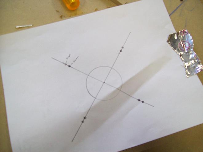

I then removed the protractor
I then laid out the lazy susan bearing on a piece of paper, and marked each mounting hole.
I then lined up each hole with a straight edge and marked the center.
I then punched the nail through the center mark and attached the template I had just made to the center hole of the top board. A little piece of tape helped to hole it still.
I then drilled holes for the lazy susan bearing mounts.
The inside holes went through the bottom board.
I drilled the holes very small, and I circled the ones I will use on the top piece.
I also drilled out the magnet holes.
I then used a hole saw to cut out the very center of both pieces.
I then removed the 4 screws and separated the 2 pieces.

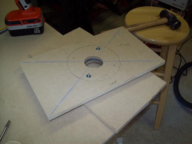

I drilled out the holes in the top piece for T-nuts which will fasten the lazy susan to the the top piece.

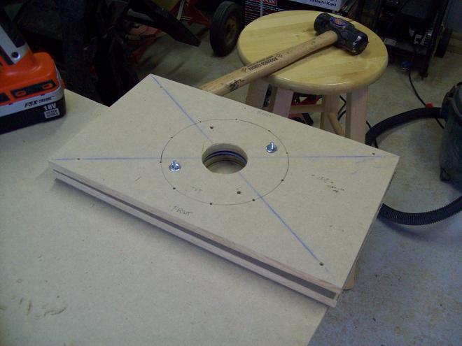

Here are the two pieces with the lazy susan bearing installed for test purposes.
And here it is rotated a little more than 90 degrees.

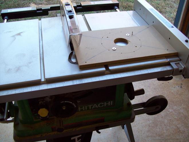

After I was satisfied that the magnet holes still lined up in all positions, I separated the two pieces again.
I cut both pieces 15 1/2" in length. But since the skin will add 1/4" to each side of the top, I needed to cut it down a 1/2"
So I put the top in my table saw and cut 1/4" off each end.

Im also having the same problem Mountain had with his lazy susan bearing. It rocks back and forth slightly. I dont have the tool he used to fix his. I tried vice grips, but maybe I just ran out of patience. I decided to move on to the top part and leave this alone a bit.
I cut the MDF 15" long. it turned out to be 15 1/16", which may be better, because Im worried that 15" might not be wide enough.
I marked the center of the board and another mark down from the top 7 17/32".
I drilled my 1/4" pivot hole.
Then I got out the mighty circle cutter (inspired by Mountain's design), and proceeded to cut in circles. (Correction: half circles.):
I then marked it out, using Nvts' drawing (adjusting measurements for my width).

Got the router guides cut out. They turned out pretty good.
Had a little bad luck while cutting out the speaker guide. The sleeve on the pattern bit that holds the bearing down against the cutting part came loose and allowed the bearing to walk up the shaft of the bit. The bit went wild before I could stop it, cutting a dip out of the guide. Im hoping I can fix this with some well placed wood putty.

Here are some pictures of my routing guides I made.
I plan to insert these guides into the cutouts for the monitor, marquee, and speaker bar after I glue the acrylic on the front.
I will then use these to guide the router bit to cut out the overhang I need in each of the acrylic openings. I can then remove the guides.
First, here are the guides for the marquee and monitor:
And here they are test fitted into their respective cutouts:
And here is the speaker bar guide:
You can plainly see where my pattern bit bearing messed up on me.
And here it is installed. I will have to place it insid eteh speaker box, and extend the bit up far enough to reach it:
