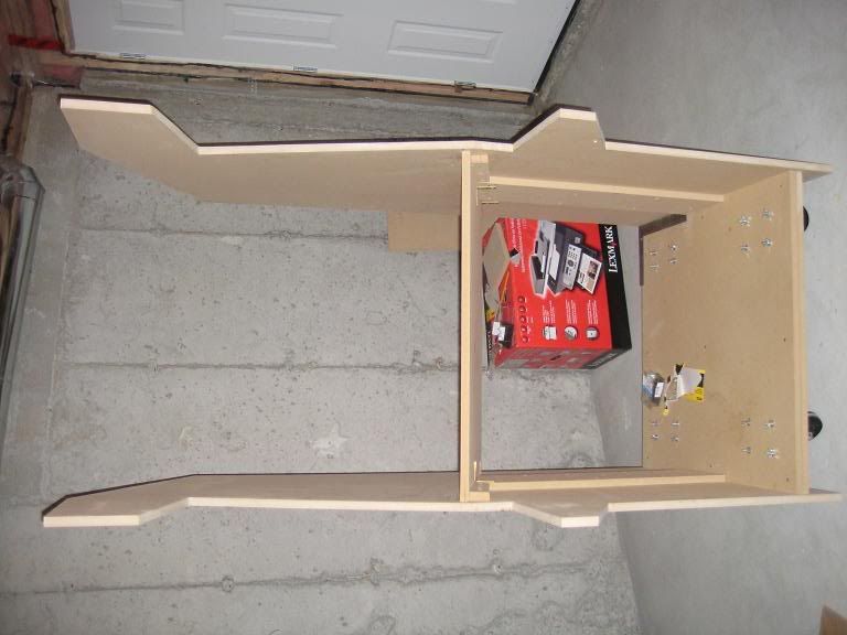

I have finally begun my long dreamed of Mame arcade cabinet. A cabinet that will figure prominently in the "Man Cave's" Home Theater.  First of all a thank you to www.arcadecab.com (Mike Trello) for his excellent cabinet plans on which the "Behemoth" is based.
I should also mention as an IT guy who is very competent with electronics and computers I am a complete neophyte when it comes to handyman projects. This project to me, will be about proving myself in that arena (Ikea furniture assembly doesn't count!).
Here are some basic specs:
Cabinet Height 6'
Cabinet Width 34"
3/4" MDF for sides
5/8" MDF for back/top etc
X-Arcade Tankstick (for now)
27" Sony Wega (Now Wells Gardner D9800)
I should also mention that I now have the utmost respect for the process of building ones of these things...I thought I could bang one off this Canadian long weekend...hehe I was delusional...Here are a few pics of the progress so far:
I will be adding 2x4 back support beams later today.  I will also look at purchasing a router (yes I know I didn't router pre-assembly as I was going to just glue it on by shaving off the T section of the molding...anyone know the part number for the Home Depot 1/16" slot cutter?

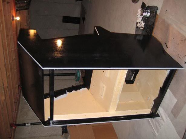

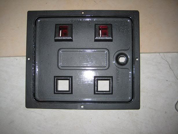

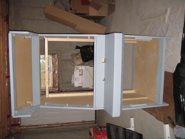

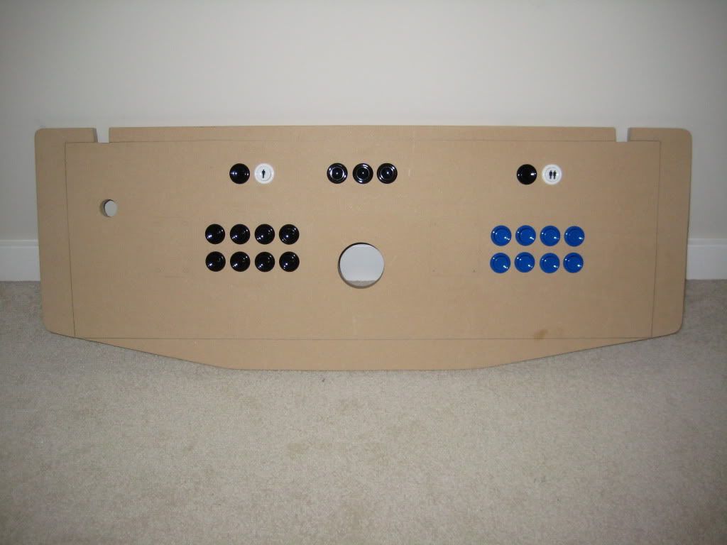

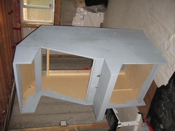

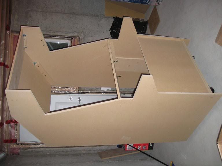

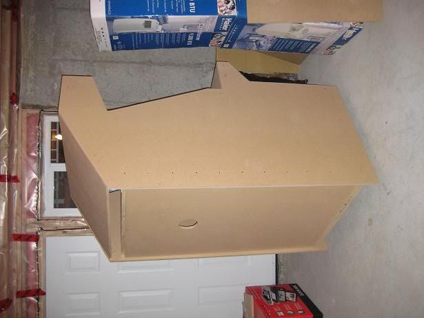

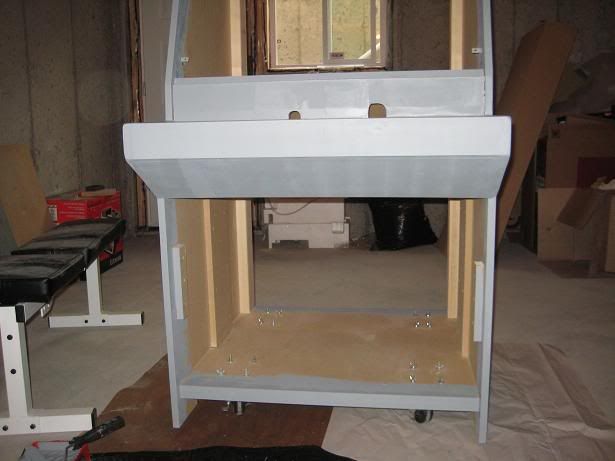

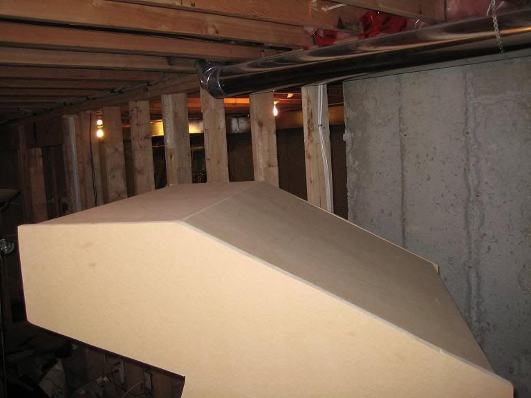

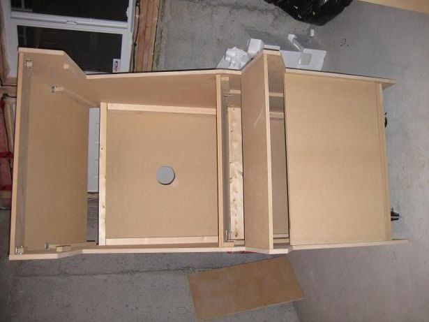

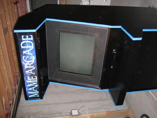

Few updates. Have completed the following:
- Back Panel is ready with hole for variable speed 120mm fan
- Created temporary Marquee being printed at Staples and ready for pickup today (pic below)
- Have several other panels ready to go (Control panel, front coin door
- Added additional interior support structure (2x4s)
- Picked up Plexi for Marquee
- Still contemplating getting laminated glass vs Plexi. My thoughts are to go with plexi initially and then I can always use it as an exact templated for the glass to shop to cut off of. Id hate to have my measurements off on glass whereas on plexi I get 2 chances based on the sheet size im getting.
With luck I will be filling/sanding and priming tonight. So far no deep holes to fill just countersink holes.
Here are a few pics (Yes back panel will have hole for power cords! :)

its a bit wide, that's because you will not strip the tv i think.
i tripped it because size did mater to me
how high is it from the floor down to the control panel? its seems a bit low.
did you try it out without hurting or bending your back?
Epyx
  • Posts: 1961
  • "You're an oddity"
Re: The Behemoth Project Begins (Update Oct 17, 2008)
« Reply #12 on: October 17, 2008, 11:22:52 am »
Correct. The tv will go in unstripped and that way I can always switch to a widescreen if desired...mostly its because my friends and I are large lads and its nice to stand without being elbow to elbow.
The control panel will sit on the ledge you see in the picture so actual height of the controls will be 42" (107cm).
I will put up a picture with me actually standing with controller but im 6' (1.82m) and it feels comfortable based on my height etc.

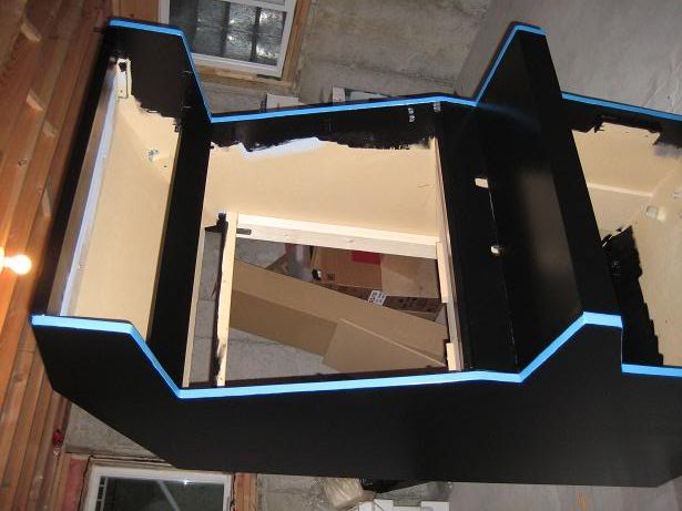

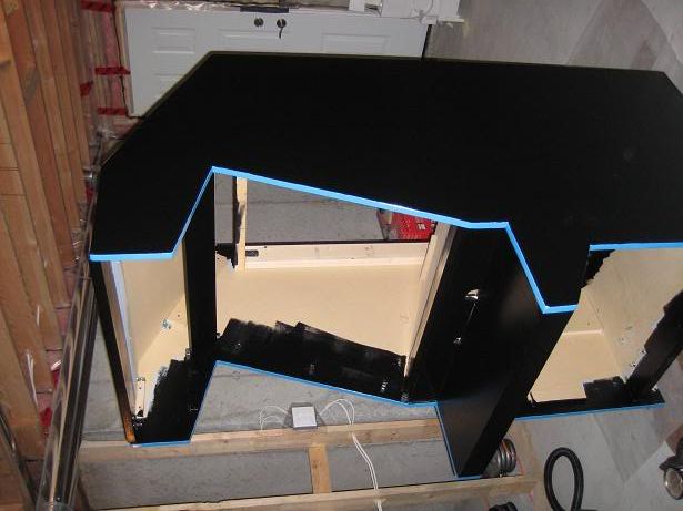

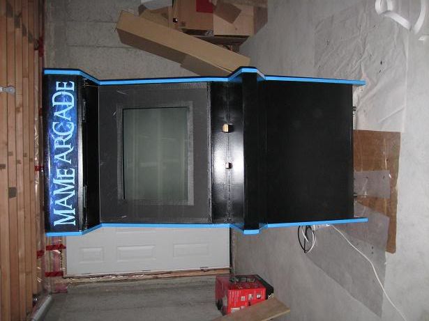

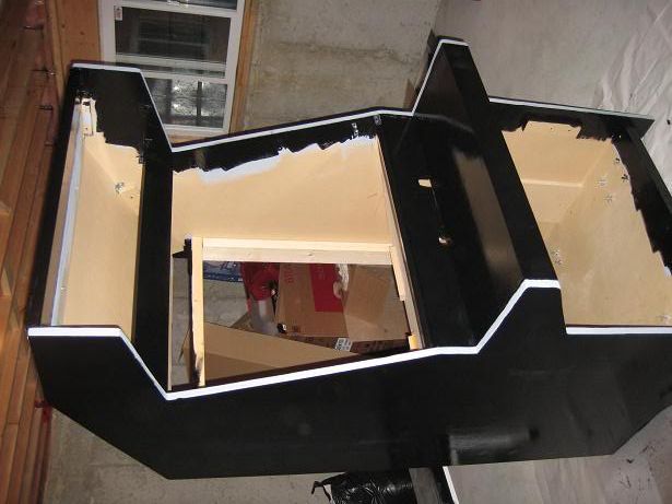

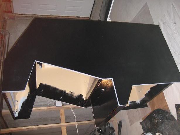

Weekend work summary:
- Cut Plexi for Custom Marquee
- Purchased and test installed 18" marquee light
- Completed screen fittings
- Purchased 32" x 27" laminated glass
- Purchased Matte board from Michaels craft store
- Designed and printed custom Bezel (Staples Photo Poster)
- Purchased paint
- Primed Saturday and painted sunday (Kilz Primer and Tremclad Rust Semi Gloss Black Oil based, Blue Breeze for trim)
Here are some pics:
Tomorrow I will sand and apply a 2nd coat.  I will then if I have enough time apply the trim which should look pretty good.  This paint is pretty sleek stuff.

tomdotcom
  • Posts: 179
  • Last login:March 05, 2014, 11:55:56 pm
Re: The Behemoth Project Begins (Update Oct 19, 2008)
« Reply #18 on: October 20, 2008, 10:19:31 am »
Looking good, lovin the paintjob so far..looks slick

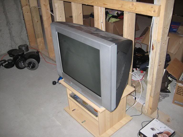

2) I have a 27" Sony Wega going into the beast...would a single 120mm variable speed fan be sufficient to vent out the hot air?

Sanded with 320 grit after 1st coat and applied 2nd coat. Woke up this morning and I must say the finish is smooth and very nice.  Tried out the color I had selected for the trim.  I must say I am pleased. It is going to match the marquee nicely.  Here are some pics:
Tonight I insert the monitor and get the bezel ready before applying final trim paint detailing.

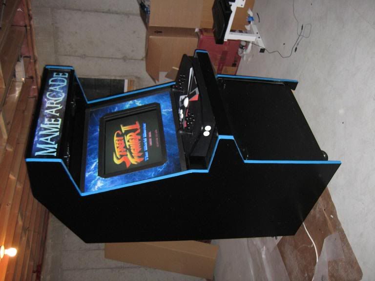

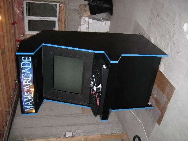

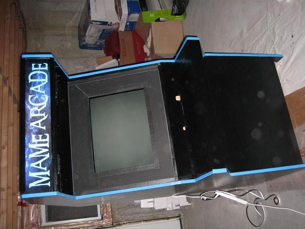

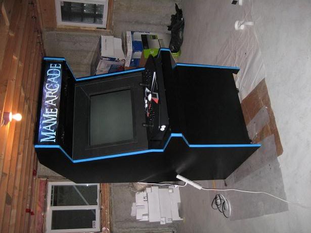

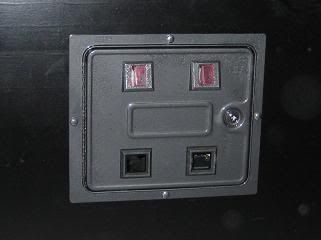

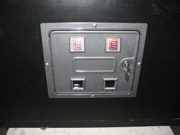

Last night I tested the Marquee and speakers. I also inserted the TV and created a "poor man's" Bezel until I come up with some more permanent. The X Arcade Tankstick is also temporary until I design and build a custom controller. I will then have it printed at Staples/Kinko and insert it.  Tomorrow I put the computer inside and give it a good test run :)
Here are some pics. Please note that the circles are flashes on the paint and not splotches :)
« Last Edit: October 22, 2008, 12:02:42 am by Epyx »

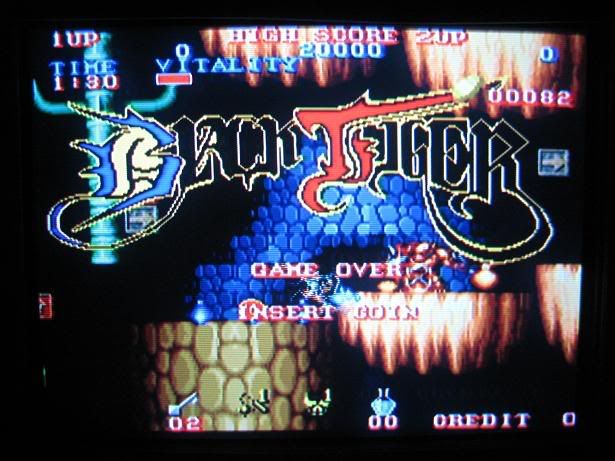

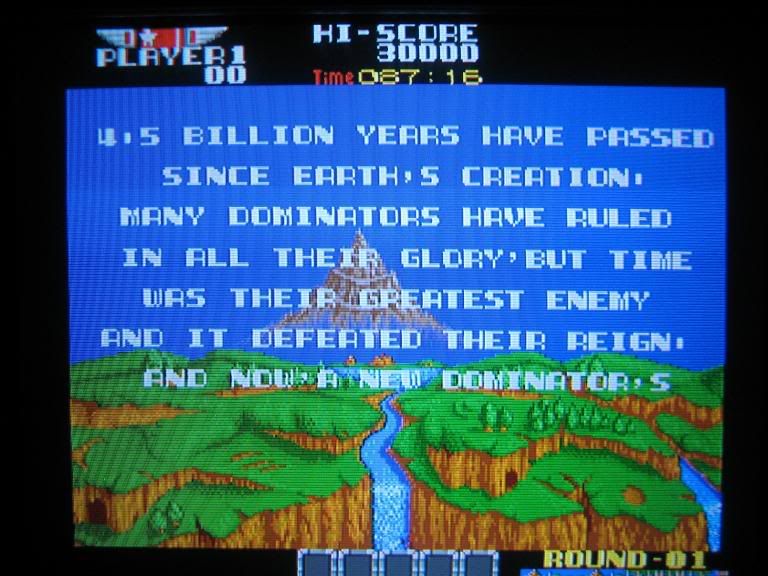

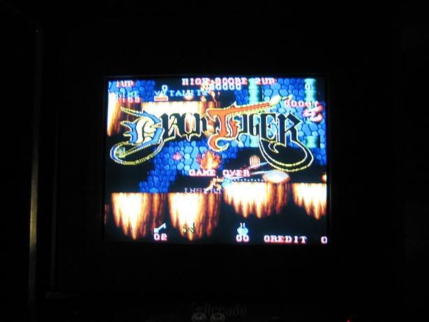

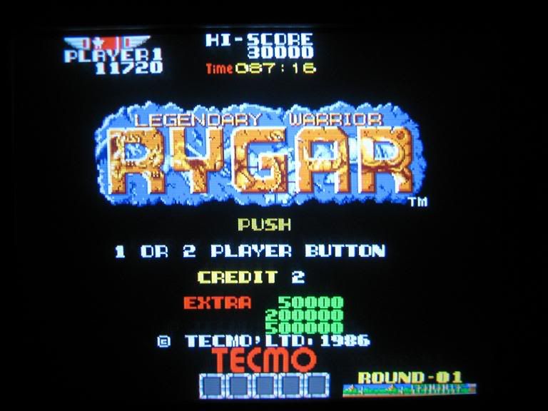

First game pics...what better game to break in the cab than one of my fav...Black Tiger.
Of course I still have some tweaking on the S-Video...if I could get the darn Component working id be happy but no luck so far.

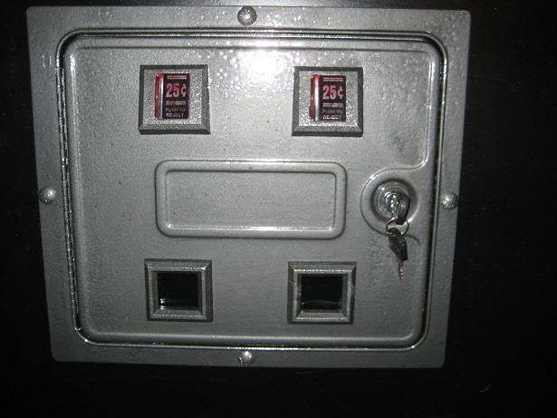

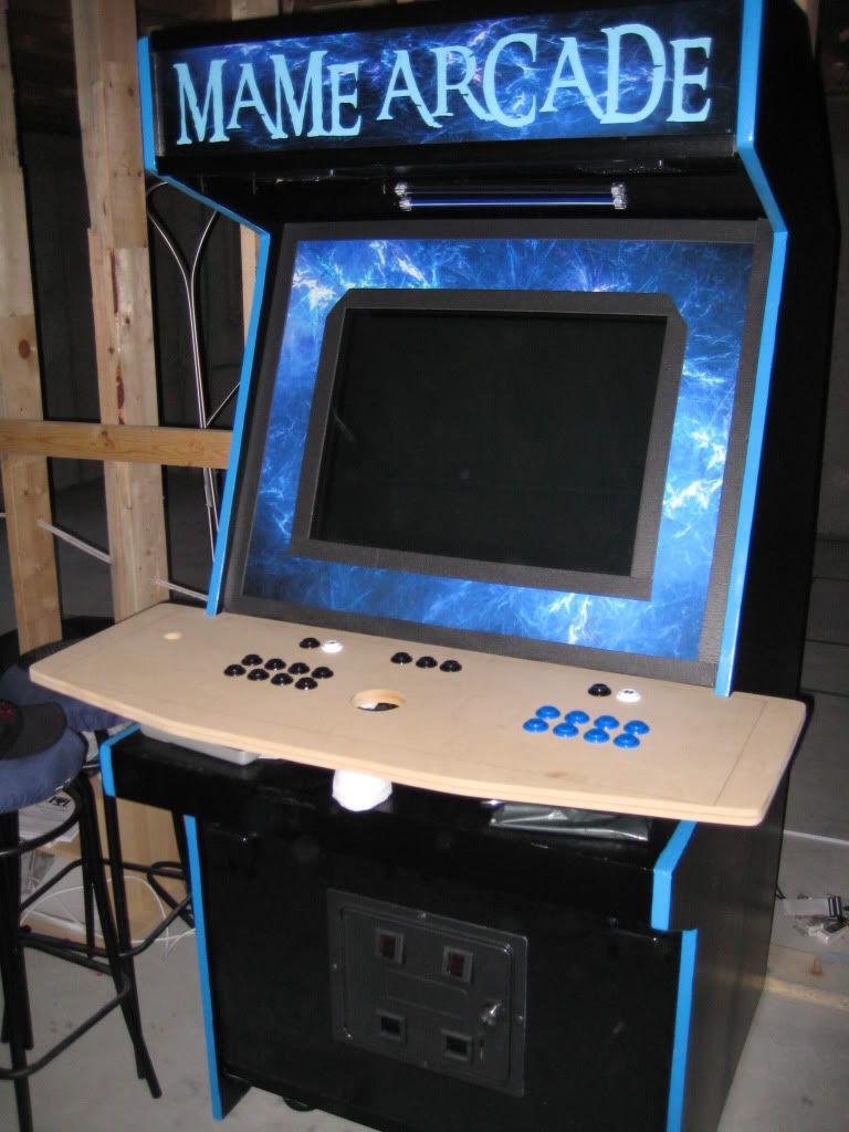

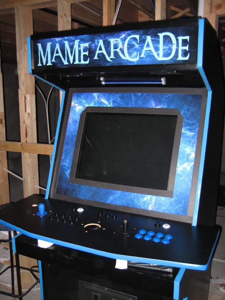

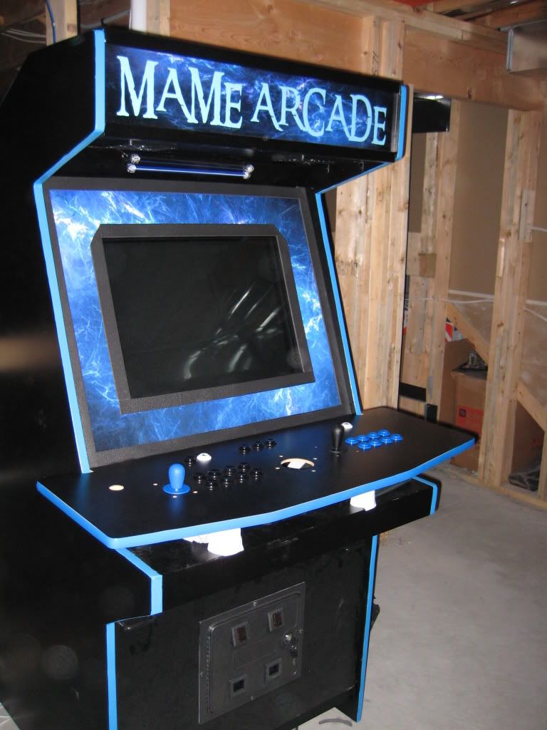

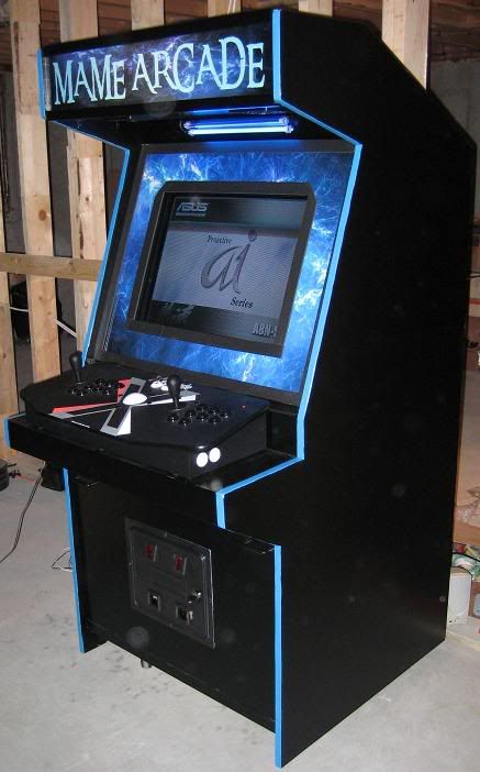

Well got my basic Photoshop bezel installed. Really starting to look like an arcade. The problem is I can't stop playing...I keep sneaking downstairs to work and end up playing game after game.../sigh
Also got my 120mm fan installed on the back. Got both the front and back panel mounted with magnets and installed handles for easy removal. I will be changing out the front door once my coin door arrives so for now the handles can stay :)
I also managed to get component working and WOW...what a difference.  Much better clarity on text and more vibrancy in the colours.  The problem is its my main game computer running it and I have put the old unit in my computer room as an Internet surfing computer....guess I won't be playing any PC games for a while. Oh well with my PS3 and the Mame Arcade I should be okay...

Here is a picture with the bezel installed:

Well my Ebay coin doors arrived:
I have some ideas thanks to the members of this forum on how to restore this. Mark my words this will look killer when it's done. Now mind you after shipping and duty on my $10 Ebay doors (2 doors this is the better of the two) I could have gone with a Starburst in Canada and broken even... oh well I just tell myself this door has seen decades of use/abuse so it will give it that authentic touch.

Here is the same coin door after stripping. Rather than using a stripping liquid I chose to grind the paint off. I used a brass grinder and then a polish piece. The brass grinder made short work of the rust. Very smooth after the polish. Next step painting.
On closer inspection (and cleaning!) the holes in the coin reject button are actually holes for a clip on.

Here is the door after some TLC...just need to buy a camlock and figure out what to do with the coin reject buttons, but I have some ideas.

« Reply #32 on: November 09, 2008, 11:00:08 pm »
Well the cab got some monumental playtime last night...amazing how this hobby of ours can impact others.  One of my buddies now wants a cab of his own...badly...couldn't get him off the cabinet last night.  Raiden III on this thing is a sight to behold and the classics were just as engrossing as decades ago.
A thanks to Peale btw for his excellent write-up on coin door restoration. Many of the tips were invaluable, particularly the hammered spray!
Here is a picture of the cabinet with restored coin door mounted and a closeup.  Next phase...continue on CP (almost have final design) and finalize reject coin button (overlay text and lighting) and finally wire it to insert coin button!

Tweaked the settings some more on my Component connection.  Between the Sony service menu and Nvidia drivers I have what I feel is a darn good Component picture.  The pictures don't completely do the screens justice but I can honestly say this is easily 80 to 90% arcade quality. While it isn't true RGB the component is a huge step up from the S-Video I was using previous.

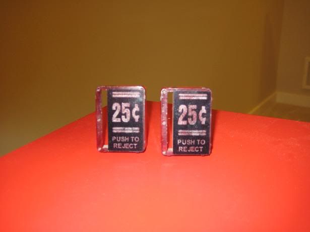

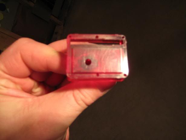

I was thinking of a way to get the coin door look as authentic as possible but with parts no longer available (in particular the coin reject bezel and text) i had to  come up with something different.
I downloaded the "Reject Coin" graphic from Mameroom and printed it out on transparency:
I then applied the tranparency with invisible 2 sided tape to the reject coin button:
I think the end result looks pretty good as it allows the red of the button to show through.  I then mounted the Coin Reject buttons back on the coin door:
And finally lit them using red 12v LED on the coin mechanism:
From rusty and beaten to almost new! :)

Well, given that this hobby has a habit of evoking "scope creep" i had decided to finish the CP and then just build a 2nd cab alongside this one since my "man cave" will have the room.  While I am disappointed with this first project in terms of what I have learned and will do differently with the next one, it is still my first and deserves to be finished.
I have completed the cutting of the top of the CP and drilled the holes. I just need to finish the joystick mounts and wait for the X-Arcade trackball to arrive.  I was going to try either Randy or Andy's trackball but I honestly haven't had any issues with the X-arcade trackball and rather like it on my X-arcade tankstick so just ordered their mounting kit.  In the interest of spreading my investments to others who support this hobby I did place an order with Andy for an ArcadeVga, Spinner with Randy and D9800 with X-Arcade. I also spent some coin on some new pc components as I wanted starblade running 100%...
I ended up getting an E5200 and Asus p5q pro. I have it running overclocked (basically stopped OC'ing when starblade hit 100%...roughly 3.6ghz!)
Here are some preliminary pics of the CP layout.  The empty button hole on the far left is where the Spinner will reside. I like this spot as I prefer a spinner in my left hand.  The joystick mounts will be completed tomorrow and then routing will begin once the trackball arrives. The left joystick is basically a blue Mag Stick Plus...the right 2nd player stick is an Ultimate 8 way.
I also purchased a 4x8 sheet of black Formica from HD which will sit on top of the CP. I will be using a blue trim T Mould for the edge. Ignore the roll of toilet paper propping up the CP in the 2nd pic ;)
« Last Edit: July 04, 2009, 11:17:36 pm by Epyx »

« Reply #43 on: July 04, 2009, 11:49:38 pm »
Looks good!
I used black formica on my cab. Very pleased with the finish. Just be careful with your drill and router. me being the idiot, I didn't tighten a depth stop on my drill enough, it loosened and punched through in one spot, and formica +does not+ like to be punched through like that! a little black furniture crayon fixed it, +kind of+, but I'm still kicking myself.

Managed to get a bit more done today. Man Formica can be a PITA to work with (As Drventure just mentioned, my experience was similar to his)...I thought the router was going to be the trickiest part but as many have mentioned the router makes short work of the trimming and does indeed cut it like "butter"...it was the drilling that was a PITA...I had a few cracks where the Formica top coating splintered off...thankfully most of it is hidden by buttons and the small edges that aren't will just get the black paint touchup...not noticeable but I know its there so eventually ill cut into the rest of the 4x8 sheet I have left and try again for "perfection". At least I learned.
The Forstner bit was giving me the trouble, whereas the 1 1/8" spade/paddle bit cut it no problem. I had the Formica wedged between the CP and another piece of MDF.
Also put the T-Molding on (light blue).  This week I will build the box while I wait for the spinner and trackball to arrive.  Then the wiring fun begins...

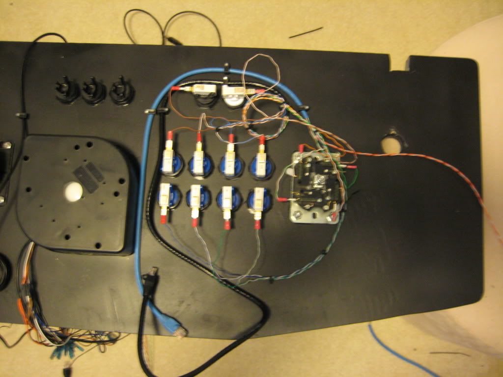

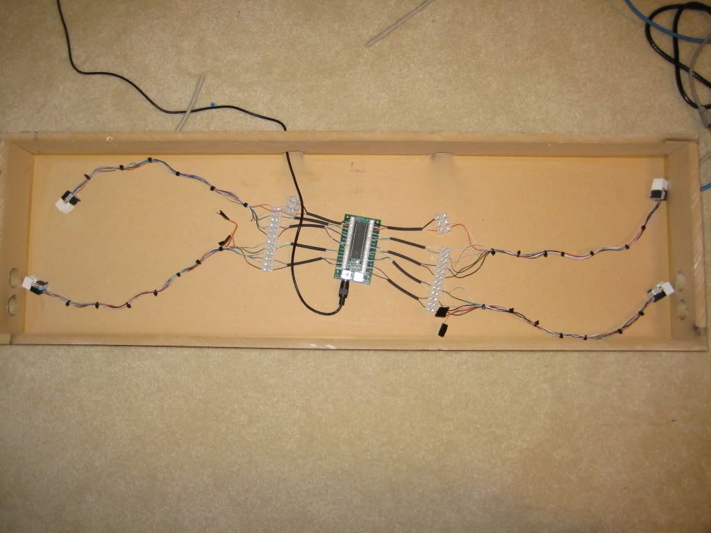

Decided to recut a new Formica overlay as the first had a few chips that were noticeable...finally got a nice clean.  I sandwiched the Formica between the CP and another piece of MDF. Used 1/2 spade bit to drill pilot holes for 1 1/8" button holes and then used Router to trim with flush bit. Drilled carriage bolt holes. I should have done it like this the first time...so easy.

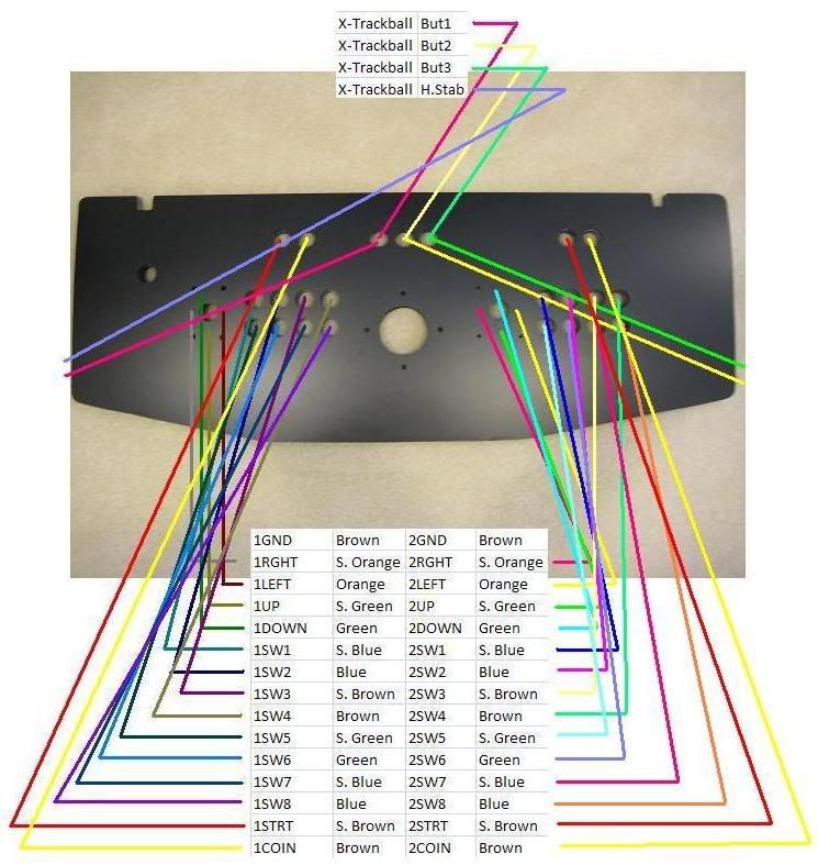

Also began the process of wiring my CP. I want a modular design and after scouring the boards have gone with a Cat5 modular design. Still deciding on a way to mount the IPAC and its wire harness (5 cat 5 plugs 2 for each player and 1 for ground) to the bottom of the CP. Eventually I want a little box for the IP with flush Cat 5 female plugs so whatever I decide for the bottom of the CP will just be temporary.
Completed some of the wiring for player 1 as well. Pictures show the cat 5 plugs.  Eventually the Cat 5 female plugs will sit in a row underneath each player side on the CP for easy plug in...right now ill just plug them in and let the flop ;)  This week TT2 spinner should arrive and I will continue to wire the CP and finish Player 2 and the ground plug.
« Last Edit: July 19, 2009, 11:34:13 pm by Epyx »

Everyone's probably sick of seeing this mediocre cab getting bumped up with updates. However, its my first cab and I've finally finished the control panel.  Now I will just replace the marquee with something more exciting, and get some matching artwork for the bezel and sides. I will keep the CP plain black with laminate as I kind of like it...can (and will) get fancier with the next upright.
Thanks to everyone for their assistance and my many PM questions...it has been appreciated.

I dunno. Looks pretty good to me  :applaud:
I guess now it's time to get back to building that house in the background (ya gotta have priorities, right  :)
