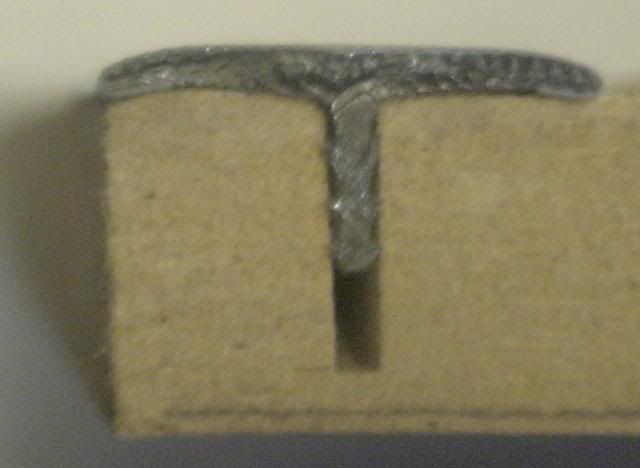

TMolding – tmolding.com - $22

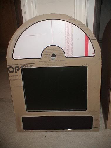

Here is the plan I had.  The extra inch I have under the volume knob looks oddly drawn, but I couldn’t get all the dimensioning stuff to attach to a rectangle with rounded corners, and I didn’t feel like mess with it any longer.  I haven’t cut anything yet, so I’ll take suggestions. I expect a lot of questions when I get to the wiring section unless javeryh keeps up with the steps that Mountain omitted.

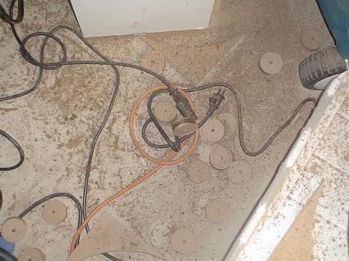

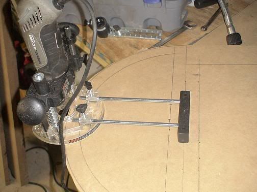

Updates are more for my own blogging so that I can kind of keep track...

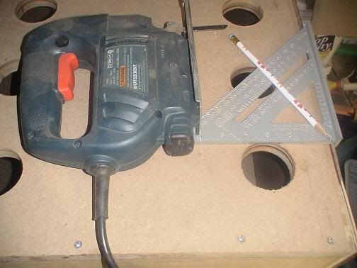

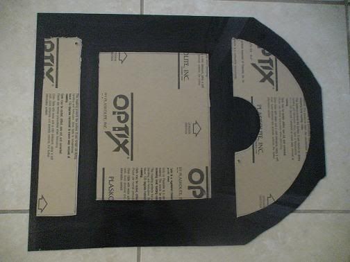

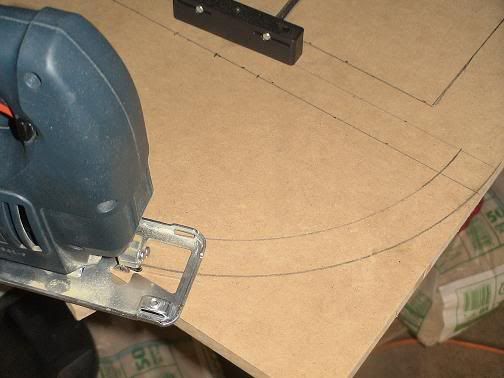

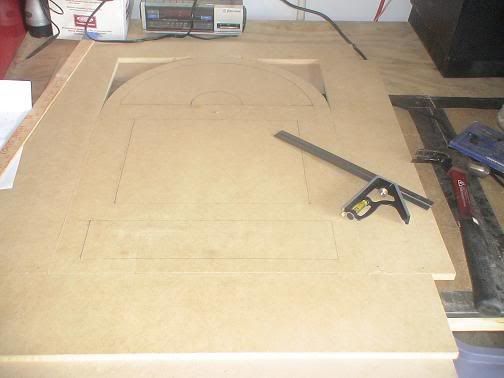

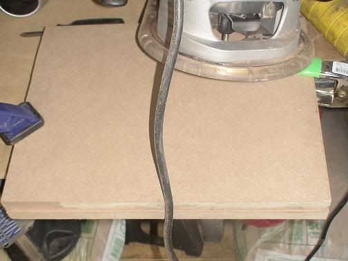

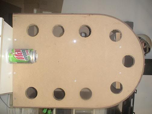

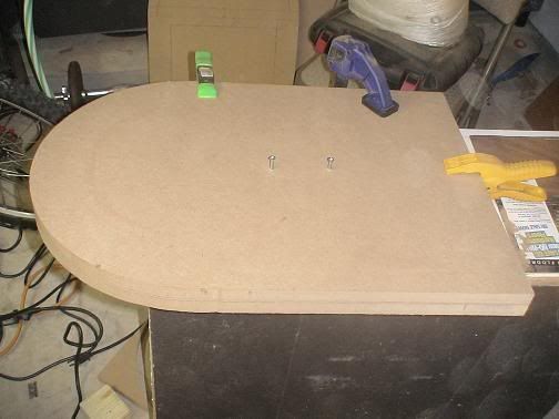

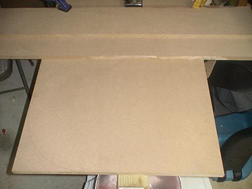

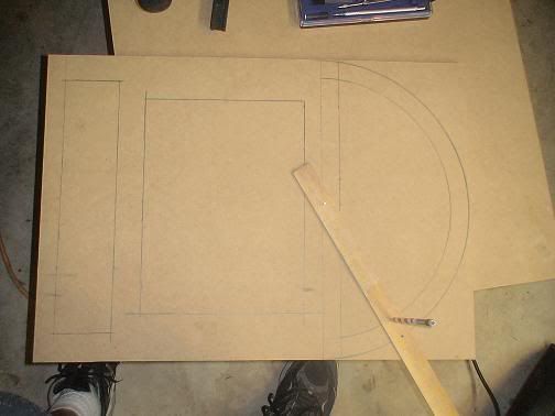

Saturday. Make a sawboard (as seen in the woodworking forum).  and get the template cut
Practicing my drawing skills on the template.  Like my arc maker?  Wooden rulers are great.
Cutting the template out

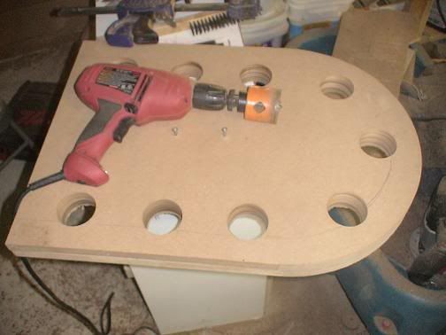

I don’t have a circle jig, but I do have the attachment for my dremmel.  Might as well try it out.  It worked fairly well.

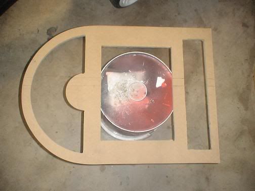

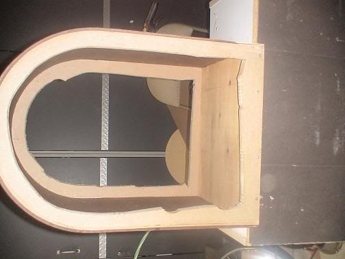

Time to make the frame parts.

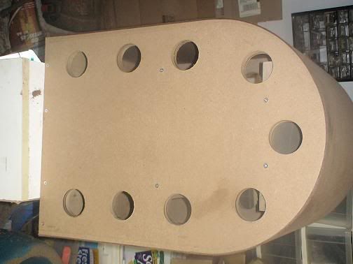

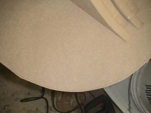

I did the same thing on both the front and back.  I got farther away from my arc cut the farther into it I go, and the scraps show it.
Set up for cleaning the edges.
And away we go.
All done

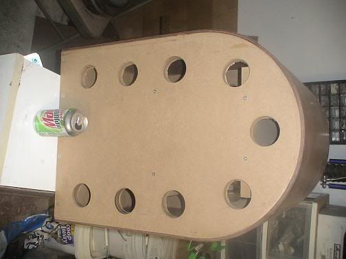

I don’t have foerstner blades, but I do have a hole cutting kit.
They sure make a mess

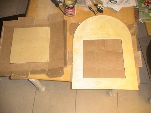

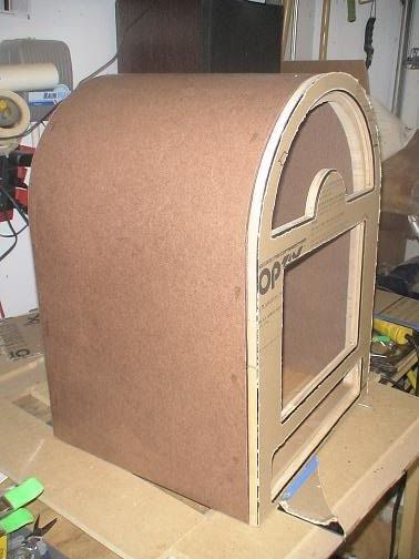

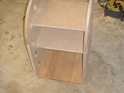

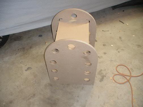

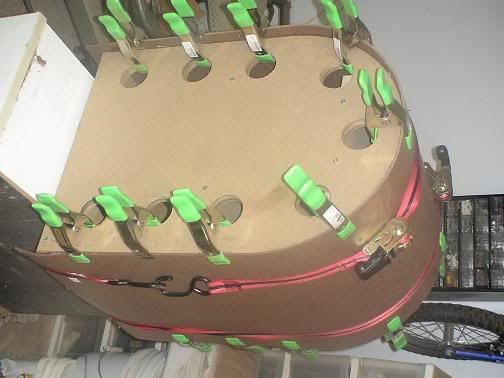

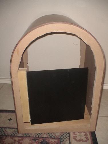

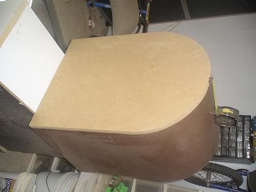

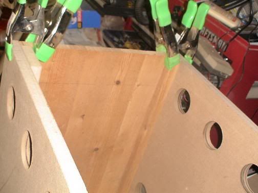

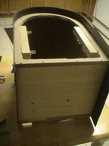

Monday.  Cut a bottom, then make a couple spacers out of the wood I have around.  I would have liked a bit larger pieces, but I use what I have….
Time to put the whole thing together.  Its hard to hold everything alone, ain’t it?
It’s ready.
The first side 1/8 sheet goes on.  Much chaos entails.   I hope it holds.
« Last Edit: October 16, 2008, 09:53:40 am by Nvts »

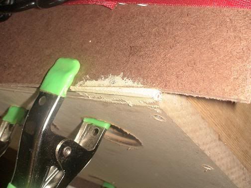

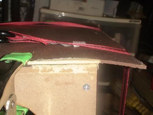

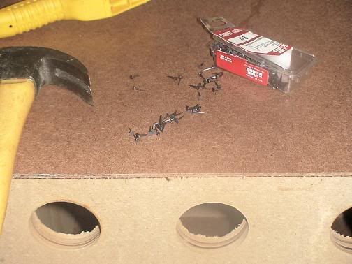

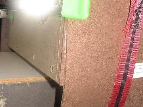

The first layer is done, and seems like it would hold just fine. I have some carpet tacks though, might as well make sure it will hold.
I routered the skin off
Trimmed the edges smooth, sanded the sides.  All ready for the second layer.
I had a bunch of trouble getting all four corners covered this time. Is there a trick to getting the thing lined up straight?  I had troubles on both layers, but more on the second layer. It’s on though.
I ended up having a 1/4 inch space on one corner that I slapped a little wood filler on, though I shouldn't need it.

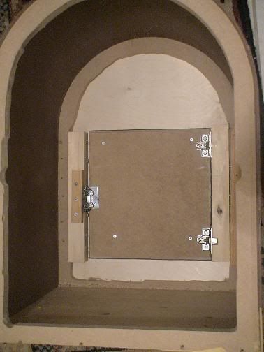

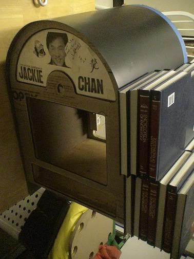

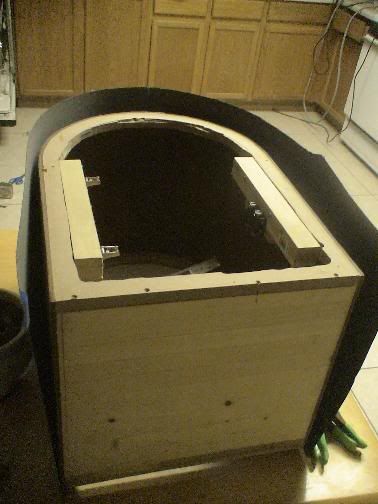

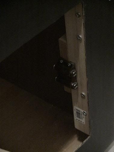

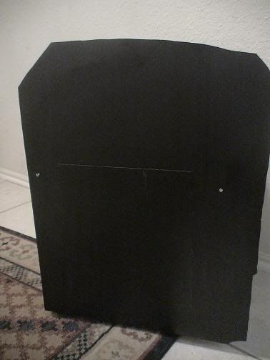

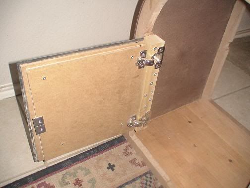

Tonight's work.  Trim off the second side skin to show the finished shell

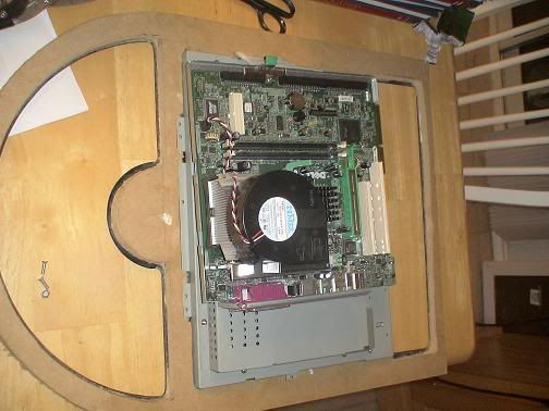

Make the front panel.  (just like making the front and back frames, so no pics)
Used my square to make quick lines and gutted out the frame
rough cut the front and back panels off

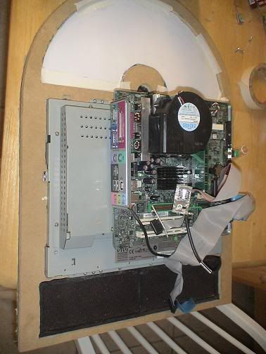

Then I cut a board for the motherboard to mount on to.
Pictures tomorrow.  really. :banghead:  I can't believe I own four computers, and they are all too old to have a dvd drive.

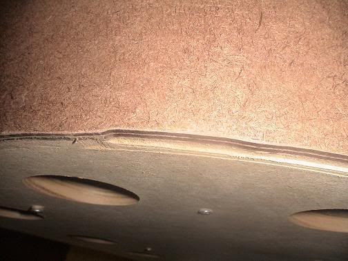

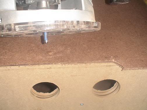

I do have a issue perhaps.  My bit lost the bearing, and chewed a little bit of the edge away.  It looks huge in the picture, but its actually really tiny.  Think it will affect anything?

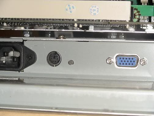

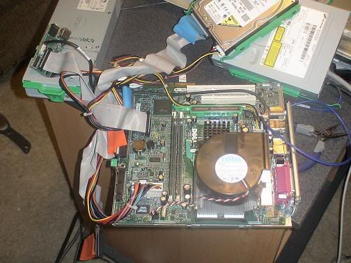

Updated my posts now that I have pics.  Adding in some computer gut shots.

  • Posts: 8001
Finally some pics!  Looks great!  You are moving fast too.  As for the part where the router got away from you, I think some bondo would do the trick.  I'd put some on there and sand it flush with the front and sides.   :cheers:

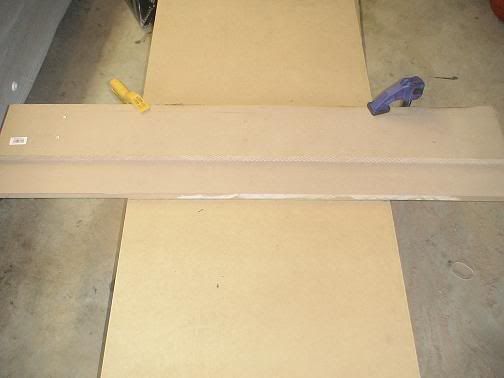

I spent a lot of time trying to get stuff done, but nothing really got done.  <sigh>

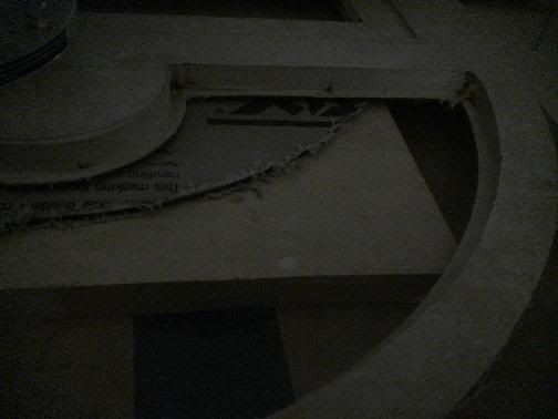

How do you jig up cleaning the inside of the frame straight?
"A common mistake that people make when trying to design something completely foolproof was to underestimate the ingenuity of complete fools."
  • Posts: 8001
I was wondering how you were going to do it myself.  Before removing the material I used my router and circle cutting jig to make the circle part nice.  Now there's nothing to pivot the circle cutting jig on.  You can still do it but you'll have to make a 1/2 circle pattern and use a pattern cutting bit - that's how I did the sides and bottom (using a straight edge as my patten).   :cheers:
Nvts
  • Posts: 76
  • Last login:September 15, 2010, 02:30:14 pm
I'm still having trouble visualizing how to clean the sides off.  You end up just having something the same height as the shell next to it?
  • Posts: 8001
Nope - the attached pictures show how I did it.  You will have to reposition the clamps as you move along the straight edge with the router (and use more than the three I have shown) since the clamps will be in the way as you go.  Hopefully this clears it up.
You can do the same thing for the curved part but you will have to make a template for the router bit to ride against since you can't just use the circle cutter.

that is what I did at first, but it seemed too flimsy and things got messed up a bit.  I ended up doing both, kinda.   I made a surface that was the same height, roughly, and clamped a board on to it, but it didn't get as clean as you guys did.  Good thing no one will ever see it.

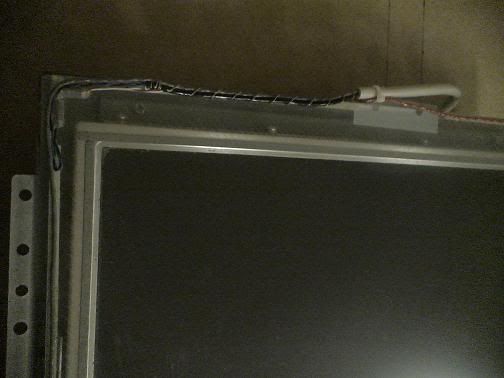

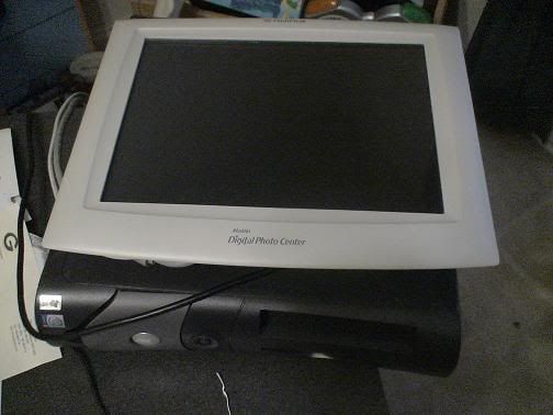

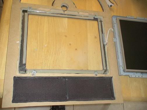

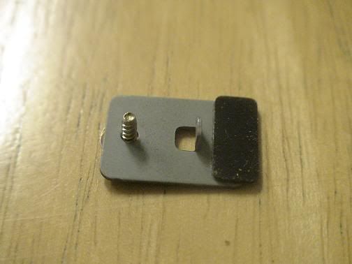

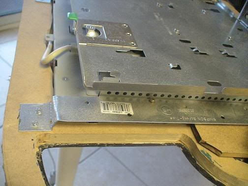

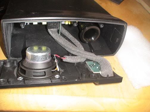

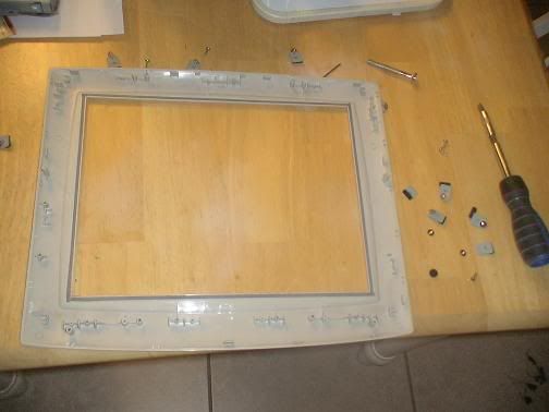

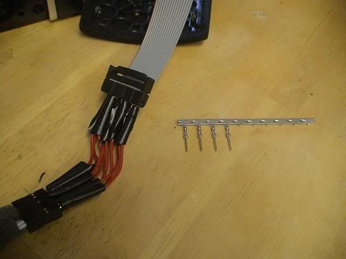

De-cased the monitor
There sure are a lot of these clips.  They don't need to be reused, right?
Methinks that I will not like this wire thingie...

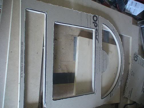

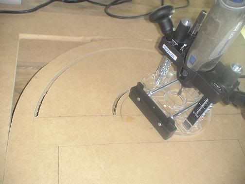

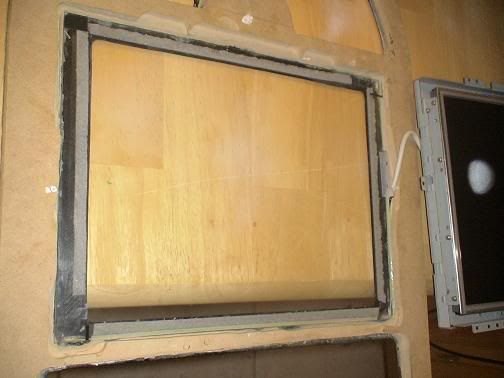

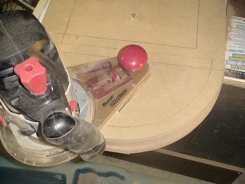

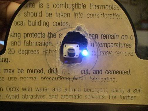

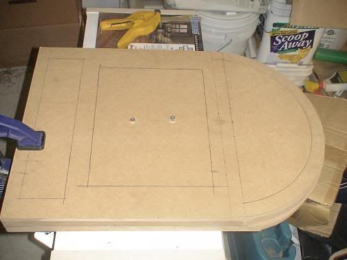

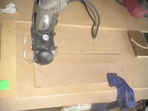

I made my panel jig
and since I have a circle jig for the dremmel, and not the router, I used the dremmel.  I feel much more in control of it then the router.
The dremmel cant quite do a 2 inch radius, so I changed it to it's minimum.

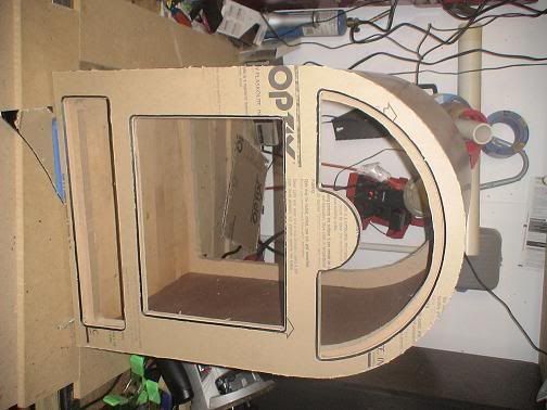

I cut out the speaker hole
and the monitor hole, so now it's all out, and looking great.  I did a once over with the dremmel with a sanding drum to smooth everything down a little, now its time to hand sand everything perfect.

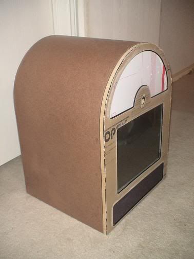

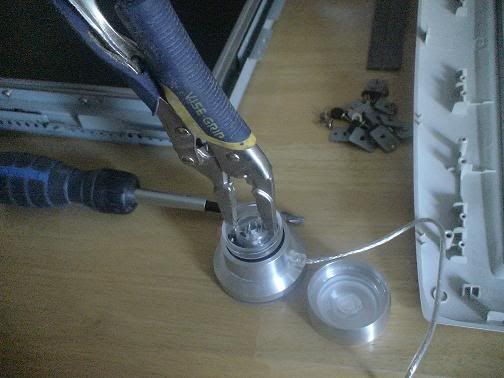

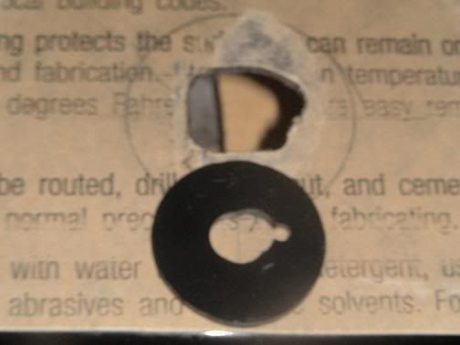

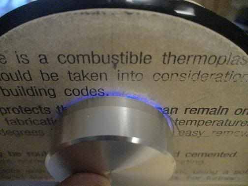

I managed to shorten the shell.

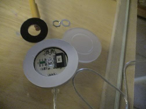

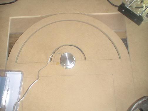

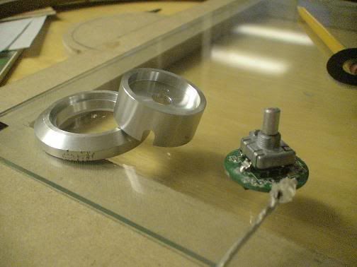

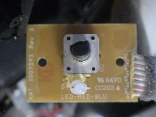

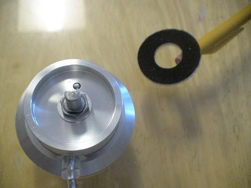

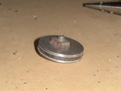

I took apart the volume knob.
The top knob slides off, but has a little bit of glue stuff in there.  I took a vice grips and pulled the plastic spacer off.
there is a felt washer in between and a washer and nut holding the pot to the shell.
I slide a blade between the plastic base and the metal body.
The next bit took some force.  the two halves of the knob are not glued, but are quite snug.  I stuck the smaller part into a vice, and a big plumber wrench on the large part, and managed to get the two parts apart.  The wire then slips out of the grove in the shell.
Traced out the pattern, and cut the backing off the spots, sanded them up, and glued it together.

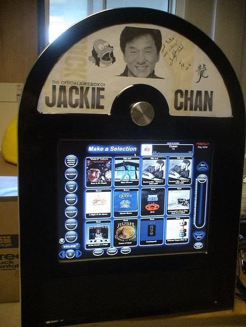

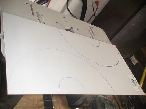

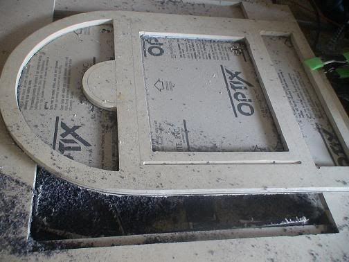

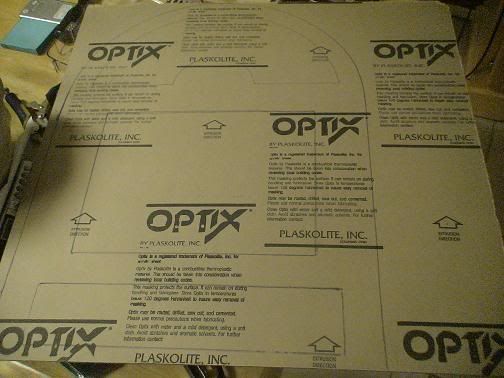

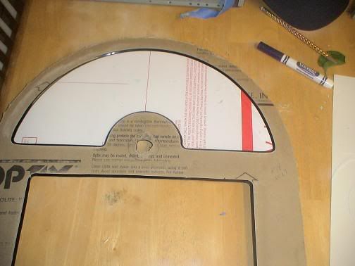

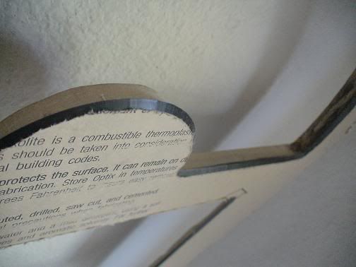

Today's update:

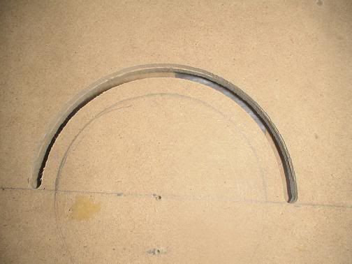

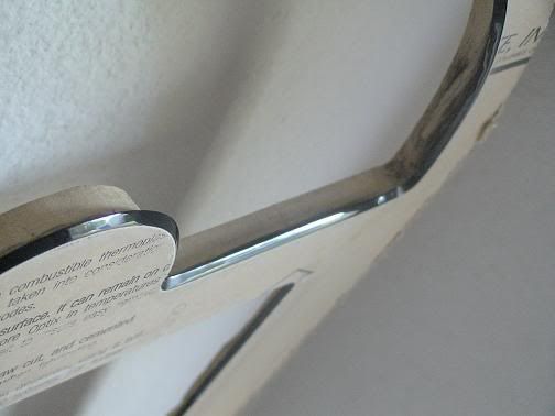

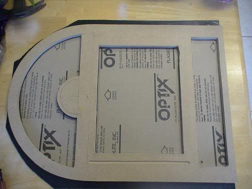

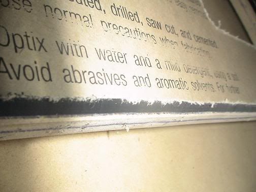

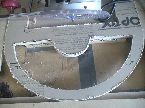

Time to make a mess.  Plexi routering is messing and stinky.
Added in the bevels.  I was worried about routering the plexi, but it was easy, fast, and looks like it worked great.
Got the  bevels done and made the standard pose.
I got about a third done with the routering behind the plexi.  This scares me as I really dont want to mess up here.  I'll get close, and hand sand the rest down, methinks.

Couple days of sanding the plexi, and I'm now on the verge of using the Nexus polish.  The mecromesh Kaytrim posted on javeryh's post worked wonderfully.  Every different grit I used made me think it can't get any better looking, until I started on the next one.
I can't wait to see the polish work, and get some real work done.  All this detail work is annoying.  :P

I finished with the plexi detail work, and it's an amazing difference that pictures cant really show the amount of improvement.  But I can try.
Next up, I was trying to fart around with making the backing of the monitor and the spacing for the touch screen wires.  I decided to not even fart with the spacing, and put a small strip of weatherstripping in as my spacer.  It appears to work great.
I then tried out DaOld Man's trick of putting the motherboard mounted onto the back of the monitor.  I added in some nuts to keep a little space between the two.
Now to read the threads again, and see what the next steps are.  I know I need to router a little room for the monitor on the shell walls, and I need to actually secure the monitor to the panel, but it's a job for tomorrow.

lets see.  this weekend I didn't get to work on it much, but after working on the front panel so long, even little things feel like actual progress.
I made the volume plexi spacer.  I didn't bother gluing a washer to the plexi, I just used two washers. it was a real quick item to make, especially with a dremmel to sand the excess off.
Got rid of the area for the volume guts.  the hole bit (taped off to measure depth) and the dremmel cleared the bit that was left.

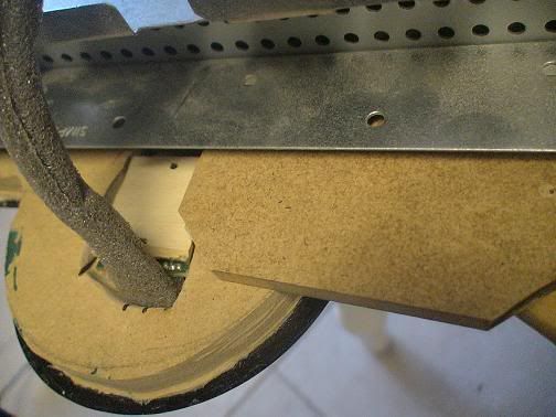

I didn't know that I needed to push the volume guts through the plexi, so I needed to dremmel a little of the plexi out of the way.  I made the cut for the knob on the volume guts.  The spacer is not pretty, but works just fine, and no one will ever see it.
I then dremmel sanded a few areas inside the shell to fit the monitor parts inside the shell.  It's about ready to glue the front panel to the shell.
I then made a template for the marquee plexi.

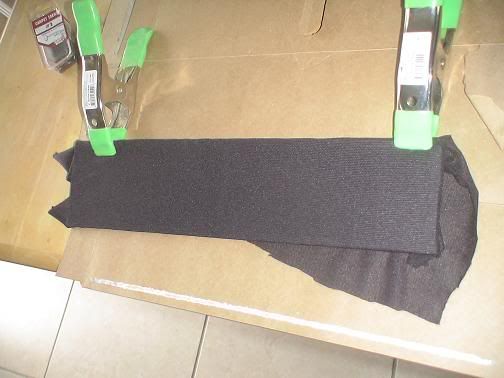

Yesterday I ordered the laminate ($52 <sigh>) and some speaker cloth.  I picked up a piece of clear Lexan Polycarbonate from Home depot to made the marquee holders.  I was able to get the front and back from the same 12x24 sheet. Took a bit longer than I expected, but since this was a part that can be visible, I took my time on it.
I cut out the pieces a bit larger than I needed, and dremmel sanded them down to fit better.  I used a marker to color the edge where I needed to trim, and sanded only till the color was gone.  That allowed me to do very small changes.
It's all in now, and ready for some art. :)

My girlfriend is a big fan of Jackie Chan, the Simpsons, and beer.  I was thinking it would be neat to scan one of her autographed items from Jackie, and perhaps a shot of Homer and Jackie fighting, or one of Jackie strangling homer like Bart or something.

I ended up finding some 1/8th plywood for the back, and I am still working on it, but I have a little more progress finally.

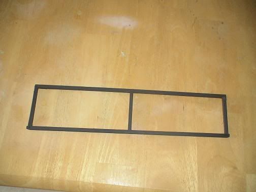

I went with a 1/4 frame for the speaker grill.  I didn't bother with the metal mesh, as I don't like how they look as much as plain speaker cloth.
I used some speaker cloth and some spray adhesive that I had to cover the frame and used a couple carpet tacks to hold it onto the panel a little better, though I doubt it would have moved.
I then mounted the glass
Followed by the rest of the screen, and the motherboard spaced from it as I tested earlier.
I have the front ready to go other than artwork.  Really wish I was better at that stuff so I could have gotten that out of the way as well before assembling it, but oh well.  I'll likely change it once the GF sees it anyway, right? ;)
I do notice that the screen opening is just a little bit too big, and you can see a little of the silver strip along the edges.  ah well.
The money shot.

Make heat vents like drawfull did on his. (wish I had a router template tool like he showed...)

I didnt know the glass would come off the monitor like that.

From what I understand it should be stuck with some sort of double sided tape type stuff.  Mine was never all that stuck, though it has a strip of something between the glass and the screen.

drawfull
  • Posts: 463
The one we used came from rutlands
http://www.rutlands.co.uk/cgi-bin/psProdDet.cgi/VARIJIG

I played around in Gimp and posted a prelim marquee, if anyone has any suggestions.

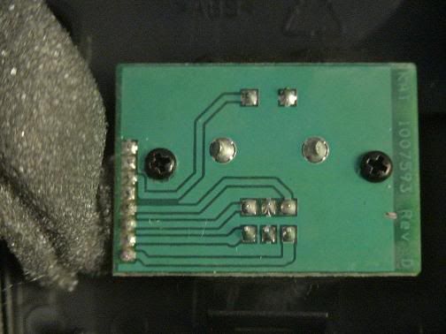

I'm using these klipsch speakers.  (damn, they are on sale for $60 now...)  I have them hooked up to my ipod now, and they sound wonderful.  Goodly amounts of bass for a set without a subwoofer.  When they lose power, they will turn off.  when the power comes back on, you have to push the knob to turn them on.  When they turn on, they are at a very low volume and you have to turn them up.   Oh, and it sounds like a normal crappy 2 inch speaker when the front is pulled off from the body.  :P
 I pulled them apart to take a peek inside, and the volume knob/led are mounted on a tiny circuit board. The other end is hooked up into an 8x2 connector that slides right out (Looks like its a 16-Pin Edge Connector, yes?  didn't see one on the Radio shack site.  Would hate to have to order one )  and extend the whole board up where I expected the powermate board to go.  Unless someone can make a suggestion how to make the powermate work, I think I might just use it on my computer, and find a replacement knob.  Perhaps I can make a plexiglass one.   :-\
You could easily use them and extend the knob and have the volume on the bottom.  the front of the speakers are almost flat up and down ( they curve about 1/4 an inch like this \_____/. I thought they were indeed flat before I put it against the table.) and they have quite the curve side to side, but the volume is in the middle so it wouldn't be an issue at all.  When I find a edge connector thingie, I'll see how easy it is to extend the cable and let you know.

You might extend those wires by cutting them and soldering in an ide cable between the two cut pieces, or since there are eight wires, a cat-5e Ethernet cable may work. That would be a lot neater and take up less space.
Im worried about my powermate too.
I can fall back on a regular pot if need be. But Im quickly running out of time, so for now if it doesnt work, wife will have to cycle juke on and off. May have to install a regular pot after Christmas.
Im looking at that volume board you have, and it looks like it is just a pot with an led.
You might could use just a regular pot too, just measure the resistance on the pot on the board and buy a audio stereo pot the same value. Just a thought.
Nvts
  • Posts: 76
Re: Nvts’s mountain’s Jukebox (12/10 Speaker guts pics)
« Reply #53 on: December 10, 2008, 04:48:55 pm »
I actually think it will be easier than that.  I think all I have to do is get a 16 pin connector and a piece of 10 wire flat ribbon cable and make an extension.  The socket slipped right out of the master board on the other side.
If that connector fits on the other board, it's actually an easy, cheap solution...  I would need to slice a small hole in the bottom of the speaker for the ribbon.
I wouldn't use the powermate, so I would just have to find a big snazzy knob to use instead.  I'll pick up a connector tonight, and try to get it to work tomorrow.   Right now, I am trying to figure out out how to add a SATA drive to my IDE only system.  it's not liking the converter that I have, so it does not recognize the drive.

That sounds like a better idea.
Can you use an IDE cable? You can pull apart all the wires but 10. Just make sure it is the older 40 wire IDE cable, not the newer 80 wire. (40 wire is bigger gauge, I think.)

Nah, I'm going to leave the speakers as they naturally are, other than the volume knob extension.
Picked up some 16 pin edge connectors, and a 16 wire ribbon wire and  a couple packages of D-sub crimp shell contacts male ( ) and went about making the ribbon cable.  I don't have what I assume are proper tools to crimp the ribbon cables together, and I ended up braking one of the edge connectors, so I'll have to pick another one up.  I can't seem to find any male edge connectors, so I made a couple of 2 inch wires with a contact on each side for the gender change.
I'll pick another connector Monday.  If I do get any more time until then, I can keep working on the back panel.
The plan will indeed work though, I'm fairly sure.  I was able to test for continuity between the pins that were working, and the board.

Could you solder those connectors instead of crimping them?
I know they can be a real pain even if you have the proper crimping tool.

eh, no worries, it can wait till Monday till I get a new end.  They are cheap.
Today, I got the rear panel working almost as well as I could want.  I did not want to have visible hinges, so I tried out a hidden hinge.
I cut out the panel and a door from my 1/8 plywood.
I put a 1/4 MDF behind the door, and laminated the whole back panel.  I trimmed the door to 1/4 inch with a dremmel cutoff wheel, a dremmel sander block, and a metal bar.
When I made my mock up with 1/2 inch mdf, it all seemed like it was going to work great, but I ended up needing 3/4 of an inch, so I rigged up a thicker door.  Installed the hinges to a 1 1/2 inch board that was screwed and glued to the frame.
I added another 1 1/2 board (and a extra bit...) to the other side for a double magnet catch.
Door guts:
I temporarily mounted the back panel to do the rough adjustments. It's a little rough, and I'll need to fine tune it once the back is attached the the shell, since the back panel is a bit warped and not cooperating properly.   It almost works great though. almost.
I have a feeling that I will just make a new cleaner looking door once time permits, but I am worried about the deadline.

« Reply #59 on: December 18, 2008, 02:00:30 pm »
I had glued and screwed the front panel to the shell, and found a few things that made me end up ripping the screen and speaker grill out.  Since I didn't keep the inside shell the same width as the front panel shell, this was a whole lot of work.  :p  I was planning to have the screen held down with a metal strap that was screwed between the two parts.  It worked really well, and the screen was much more solid, but it got some dust inside of the screen, and I knew that it would drive me nuts.
I also got the volume knob relocated and working wonderfully.  i used those little pins next to the wires to make the swap over.
Stuck it up where it would go.
The little board next to the volume control slides over and wedges the board into place without having to worry about mounting the control board itself to anything.  the pot does not have a screw on part like a powermate.
I tried to use the powermate knob on it, and the plastic spacer fits over the LED perfectly.  I now can have the glowie effects of the volume control.  it's not as snazzy as the powermate ones, but its still kind of cool.
It seems a waste to get a powermate just for the knob, and not even the guts, so I sent Griffen an email asking if I could buy the knob and plastic spacer, and they said no.  :cry:  Anyone have an extra pair of parts, by chance? :p
Next up, rebuild the speaker grill, and remount the screen and innards.

« Reply #60 on: December 18, 2008, 03:18:24 pm »
Lookin' good  :cheers:
I found a big aluminum knob on ebay that may work for you here.
Martijn
  • Posts: 822
  • Akira!
    • ModMyBox
Re: Nvts’s mountain’s Jukebox (12/18 pics)
« Reply #61 on: December 18, 2008, 04:21:13 pm »
good find mountain, but just not nice enough to replace the powermate.
The little screw hole really does it  :'(
mountain
  • Posts: 1205
    • Mountain Jukeboxes
« Reply #62 on: December 18, 2008, 05:02:02 pm »
Have a look at these then.  ;)
example 1
example 2
example 3
example 4
example 5
example 6

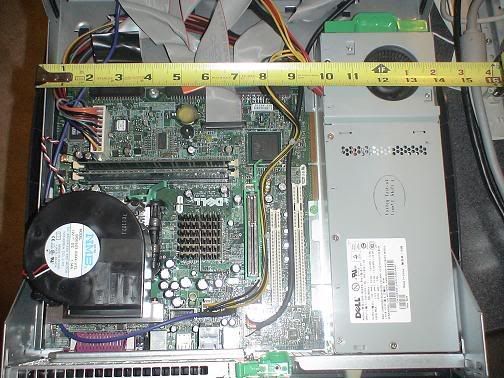

are you going to mount that computer on the back of your monitor? I don't know about the elo units but my krystal units get kinda warm so I would keep a little distance between the two. at the very least use some aluminum spacers and a bit of longer bolts. this would ofcourse give room to mount some sort of cooling system to pull air from between them and maybe add to the other fans on the units effectiveness. just my two cents. I'm going to go back to reading the rest of the thread :D
Nvts
  • Posts: 76
« Reply #64 on: December 18, 2008, 07:23:54 pm »
I have a couple nuts for spacers between the two, so the distance would be about 1/2 an inch.  I will also have a fan underneath, pushing air upwards and out the top.  Would this be enough, or should I add some extra space in there?  Is there anything else that I could do to make sure that it stays cool enough?

Managed to get the laminate on today before I had to pack it up.
I laid the sheet on the ground, and put a piece of painters tape over where the line would be.  I made a line on the tape, then taped a straight edge on it and scored it a few times with a utility blade.  I then used some scissors and cut it like I had been.  However, it worked much better this time.  :p
I had a hell of a time getting the first two layers onto the shell properly, so I knew I wanted to do the laminate better.  I put a spacer under the shell, and glued it up, then pulled both ends around the curved part at the same time towards the bottom, then used the J roller and got it all stuck.  It worked so much better then trying to start at one end and get it straight.
Concept test
Glued
I know I don't need to weight it down, but I cant help it...

You beat me to the idea of the led shining through to the bottom of the volume knob.
I'm trying to do that with the powermate.
I still dont have a warm fuzzy feeling about the powermate.
I sure hope the monitor doesnt run hot, Im mounting my motherboard the same way.
I dont see any vent holes in the very back of the monitor, and there will be a plate between it and the motherboard, so Im sure hoping it will be ok.

I'm setting up to flush trim the laminate and I am apprehensive that I will scratch it with the router.  Is there something I should do special, or would it not be an issue if its smooth?  I'll tape the front panel to try to not get a devastating scratch like javeryh had.  Never mind, I went ahead and cleaned everything off really good, and had no issues at all.
Perhaps try to put a aluminum foil / mirror like surface behind the board and make the hole up to the knob wider so that light can get out.
I stuck a mini dvd into a cup and held the powermate about half an inch above the DVD, and it seemed like it would get a nice glow upwards.  I would imagine making the spacer out of clear plexi would help (mountains pic)
I could make you a nice knob (oo-er  :laugh:) if you like.
Perhaps after the holidays and I can get some feedback. I'll use the powermate one for now, but I would really like to just use it on my desk instead since I dont need the guts anymore.
I have a thought of what might work and look really nice.  Stack a couple layers of clear plexiglass up and drill out the hole and flat edge to hold the pot.  Then mill a knob that fits around that so that you have a lighted center, something like this in concept, but in a volume knob format  :D
The other thought is using that plastic that bends light out to the edge, and using that is the bottom layer, and milling something over that.  that would make a knob that works like a powermate.

  • Posts: 5198
Re: Nvts’s mountain’s Jukebox (12/18 laminate pics)
« Reply #70 on: December 19, 2008, 06:23:58 pm »
I have already cut out some clear plexi for the PM to mount to.
I drilled the hole in a square of plexi and fastened a 3/8" bolt to it.
I then chucked the bolt in a drill and ran it against a belt sander. I had to take it easy and measure a few times until I got the 1-5/8" diameter in the clear plexi.
I drilled my hole wider (1-1/2") than the round circuit board on the PM.
Im planning on putting a mirror behind the PM to reflect the light from the blue led around the PM guts to the front plexi.
Looks like we had the same idea. Great minds think alike.

I'm getting ready to cut the Tmolding slot, and I noticed that Mountain cut his to 1/4, which is the depth of the Tmolding part.  I notice that the set that I got using a bearing that makes a 1/2 cut, which is default, I guess.   I can go halfway across town to get a larger bearing (1-3/8" Outside D x 5/16" Inside D) for $15.  I'm running out of time, and money, so I was expecting to use the router table fence to set the cutting depth.  Is that as easy as it sounds, or would it be wise of me to get the extra bearing?  Is the difference between the default 1/2 cut and the 1/4 cut worth bothering over?  I know on a arcade machine, there is loads of extra wood, but these things are flimsy.
mountain
  • Posts: 1205
Re: Nvts’s mountain’s Jukebox (t molding question)
« Reply #72 on: December 19, 2008, 10:28:07 pm »
Make a mark on you're blade with a Sharpie that represents 1/4". Turn on your router (assuming that it is mounted upside down on a table) The mark will make make a faint circle as it spins. Touch the Sharpie to the mark on the blade, as it is running. Then just eyeball it and take your time. This is what I did.
If you don't do this, the wood may split as you hammer the T-molding in.
  • Posts: 5198
« Reply #73 on: December 20, 2008, 05:29:54 pm »
I used your method of marking the depth on the slot bit and it worked great. Thanks Mountain!!

Here is my preliminary slot location test.  It looks like the molding fits right exactly on the edge, but I want it just a smidgen closer to the edge so that the edge of the tmolding will grab the front and back a tiny bit, right?
That new bit was so sharp that I didn't even feel it cutting into the test board.... :o

I had some issues with my router table not being quite big enough for keeping the shell straight enough.  I kind of messed up a little on the front side, and pulled the router out of the table for the back.  The back went way better.
So I am putting stuff together, and I decide to do a demo test, and the touch screen does not work now.  I'm not sure what happened.  If i touch the metal tabs in the very corner, I can make the pointer jump around, so I don't think it's a connection issue.  How do these things tell where my finger is?
mountain
  • Posts: 1205
Re: Nvts’s mountain’s Jukebox (Screen not working!)
« Reply #76 on: December 21, 2008, 08:08:50 pm »
Make sure nothing is touching the diagonal lines around the edges of the touch overlay. They are SAW (Surface Acousical Wave) technology. Anything touching them will throw it off. I am pretty sure this is your problem if the unit worked before mounting it.
Nvts
  • Posts: 76
« Reply #77 on: December 21, 2008, 09:09:01 pm »
I pulled the monitor back out, and cleaned off the screen and I still get nothing.  I did have some weatherstripping on the glass and removed it, but I still get nothing.  Hope i didn't hose the screen up.  :banghead:
  • Posts: 5198
« Reply #78 on: December 21, 2008, 09:12:56 pm »
I just hooked mine up for a test run and had the same problem.
I had to remove the foam rubber weatherstripping I had put around the edge of the monitor opening in the acrylic.
It was touching the lines Mountain talked about.
I removed the weatherstripping and now it works good.
I wish I could easily remove the acrylic and make another one. I would extend the edge of the acrylic about another 1/2" all the way around the monitor, I think that would allow me to use the weatherstripping. It looks a lot better with the weatherstripping filling the gap between the monitor glass and the acrylic. Plus if I could re-do the acrylic, I could fix that one corner I screwed up.
Oh well..
  • Posts: 5198
« Reply #79 on: December 21, 2008, 09:15:09 pm »
I think I posted about the same time as you.
So nothing is touching the glass and it's still not working?
You had the glass off the monitor, didn't you?
Do you think you might have a plug loose between the glass and the monitor works?
mountain
  • Posts: 1205
« Reply #80 on: December 21, 2008, 09:16:44 pm »
Oh well..
I attached the foam tape to the back side of the acrylic and then mounted the monitor accordingly. I left a gap about 1/32" between the foam tape and the monitor.
  • Posts: 5198
« Reply #81 on: December 21, 2008, 09:23:06 pm »
Ok, I will try that. I had the weather stripping stuck to the back of the acrylic like you said, but it was thick enough to touch the screen. Is it possible to cut that stuff down?
I think it might not have been touching at the top, cause on my screen calibration I could move the cursor on the top half of the screen, but not the bottom.
I noticed that the monitor mounts are a little off from top and bottom, but I thought it would angle the screen back a tad bit, maybe make it better to see, so I didnt try to even it up on the MDF mount.
This may be why the foam wasnt touching the top??

I can tell that the connection is functional, as I can touch between the two contacts in the bottom left corner, and see movement on the screen.  I cleaned the hell out of it, and still cant get a normal touch to work.  <sigh>  I'm starting to think I am hosed.

I gave up on the touch screen, and ordered another one.  It got here last Saturday, and I spent a couple days getting it into shape.
Last night I revealed the Project to the GF, and she really loved it.   I didn't have any of the wiring done, and had the three cords coming out the back door and the back panel was not glued in, and the rear T Molding was not one, and the system still has the old hard drive (with 2000 on it), and the Marquee was still a test print on paper...  and this and that and etc...
But it was truly a huge hit.  Many thanks to Mountain for the original, and everyone else who is working on one or helped out.
I'll still update it as I finish it, but here it was as I pulled the sheet off of it.  Using Freebox as the front end at the moment, but we will check out a few other ones and see what she likes best.
