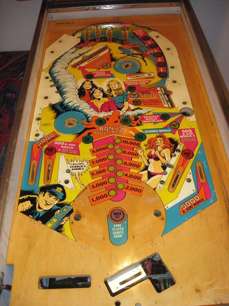

unfortunately, it is a Charlie's Angels. Hey, you gotta start somewhere, right? Especially on my budget. ;D
I won it by accident. I just put a token $1 extra bid in to bump up the highest bidders price. Except that was his high point, and noone else ever bid over the last 2 hours! Judging by the despcription, the pin is most likely suffering from the slam tilt error that Gottelieb Sys. 1's are prone to. As soon as I get it I will be disabling the slam tilts to see what happens. I'll be picking it up either tommorrow or friday.
Anyways, onto the pics.

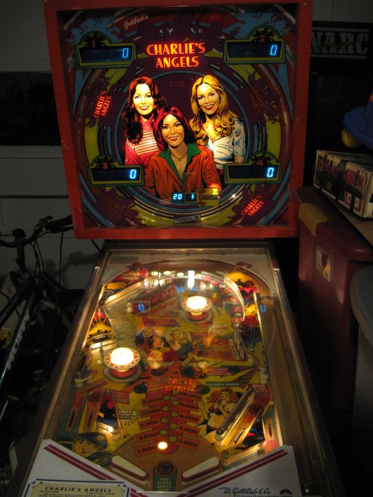

Did some initial testing. First off, here is what the game does when powered on: all of the playfield and backglass lights are on, and the gameover light is flashing. The displays do not show any signs of life. Other than that, nothing.
All the power block fuses are good. I started the initial testing and apparently my power supply is bad, or at least needs some work. The input voltages are present and listed below:
pin1 11.5VAC needed, ~12.6 present
pin2 11.5VAC needed, ~12.6 present
pin3 14VAC needed, ~15 present
pin5 14VAC needed, ~15 present
That is where things start to suck. There are no 5VDC, or -12VDC present at the top connector that supplies the MPU. The -12 pin goes straight to solid 0 on the DMM. The 5 volt pins flutter around .3 volts. I notice that the connector up there was kind of wobbly, so I at least need to take out the power supply and reflow some solder joints. The right side connector that supplies the displays has a 60VDC pin, a 42VDC pin, a 4VDC pin, and an 8VDC pin. All pins show nothing except the 8VDC pin - it shows 16VDC??
In the marvin3m manual, it says that if a -12VDC supply is missing, your MPU is ---fouled up beyond all recognition---. However, since nothing is getting thru I think I am safe there at least.
Oh, and it appears that the trouble large caps on the power supply have been changed at some point. Last thing, yes, the J1 PS connector is installed the right way. ;)
So, is the peanut gallery in aggreement that I have a bad power supply?
Addition: I went ahead and took out the power supply before I even finished this post. ;D Anyways, the problems are QUITE evident after getting to the back of the power supply. Fist off, I didn't have to desolder the Q1 transistor because the bad solder joints kind of just fell off.  :laugh2: I noticed some masking tape here and there adn found out it was a brilliant way of isolating a repaired lifted trace repair. :laugh2: :laugh2: The repaired trace was on one of the 14VAC input lines, so I'm a little worried about MPU damage. Oh and the J1 connector pin header - I think my 6 month old girl could have soldered that better. :laugh2: :laugh2: :laugh2: Cold solder and broken joints galore.
Needless to say, I don't think this power supply is going back in the machine. I'm liking this pin hobby already! There is so much more crap to mess with. ;D I feel like I have already expanded my electrical knowledge by about 10 times.

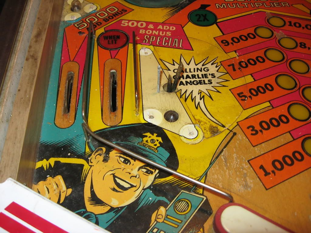

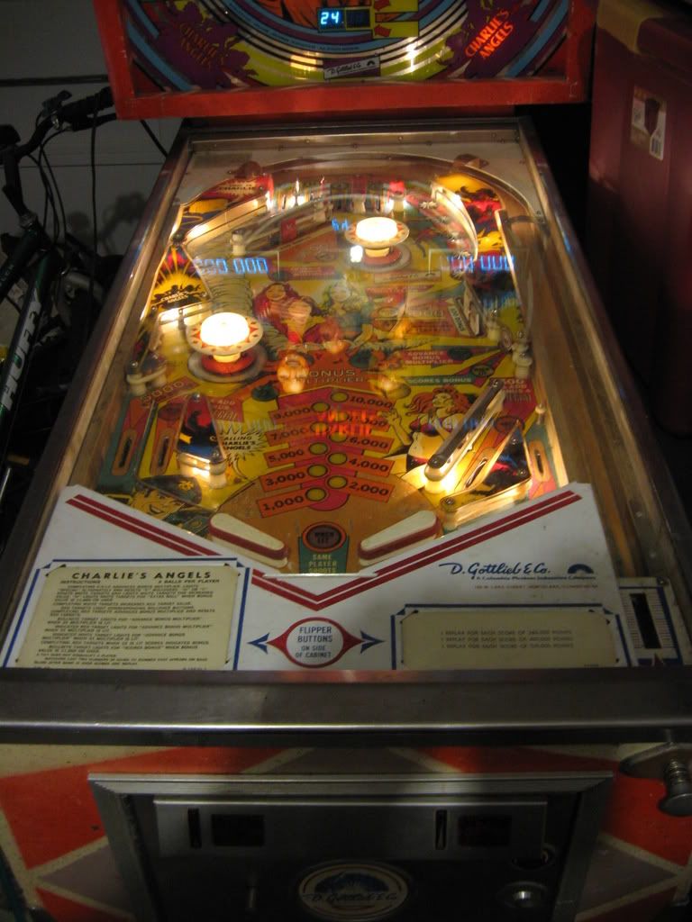

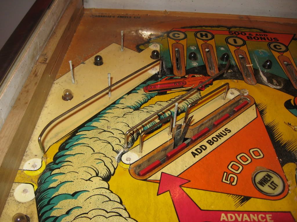

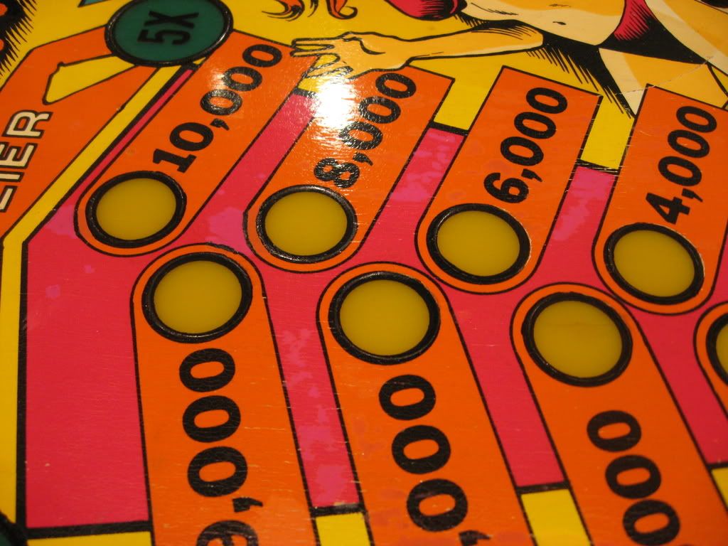

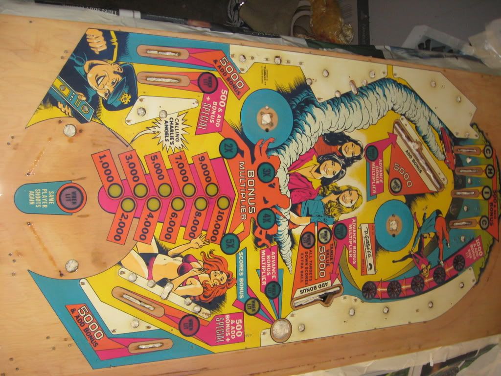

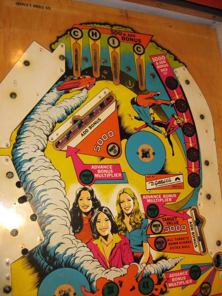

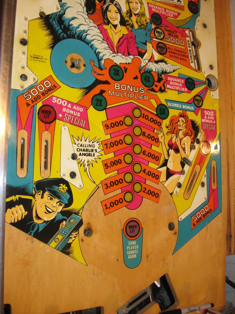

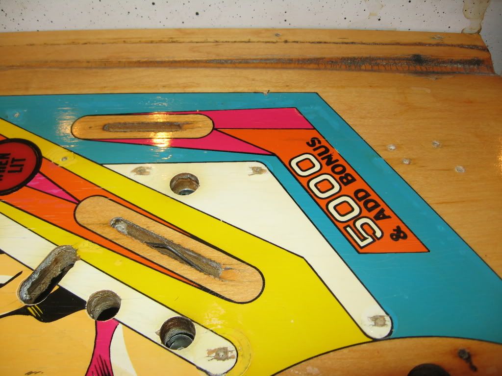

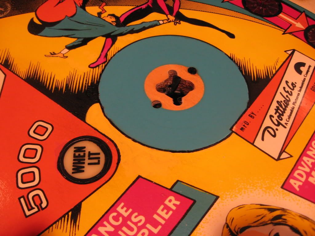

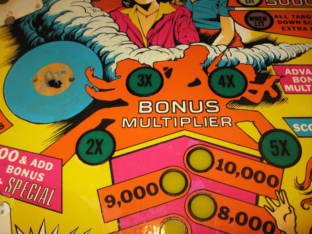

I was showing a buddy the pin this evening, and decided to pull the bottom connectors on the CPU board to check the pins (I hadn't got around to that yet). OH MY! I can see why the Marvin guide is adamant that you change pins. Most of them are broken, and there is the blue-green battery acid corrosion on most of them. I looked closer under light at the CPU, and there is definitely signs of blue-green corrosion on parts here and there such as the resistor leads, and a little here and there on the board. Still, the damage on the board is not significant, but I'll still be pulling it and doing the vinegar bath this weekend hopefully.
I also was at the mall tonight and stopped in Radioshack to see if there were any parts I could pick up now that I could put to immediate use... :laugh2: :laugh2: They don't have crap.

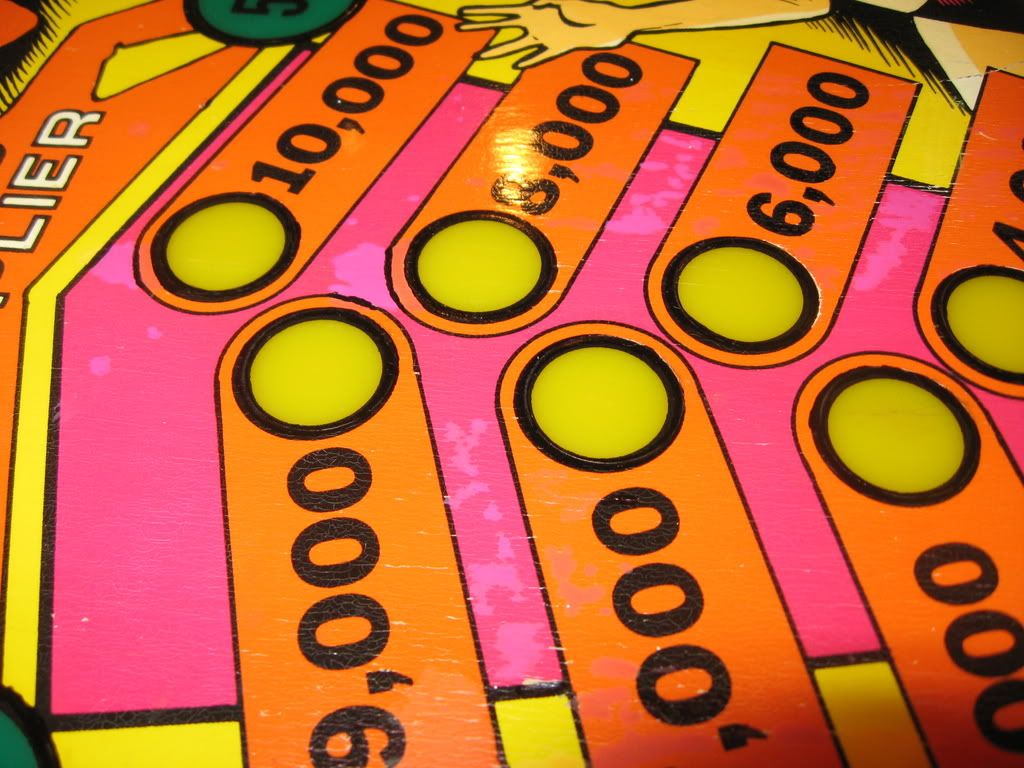

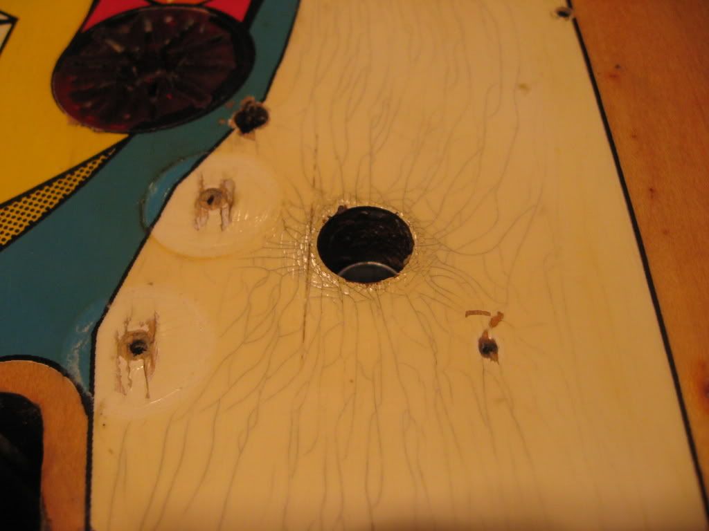

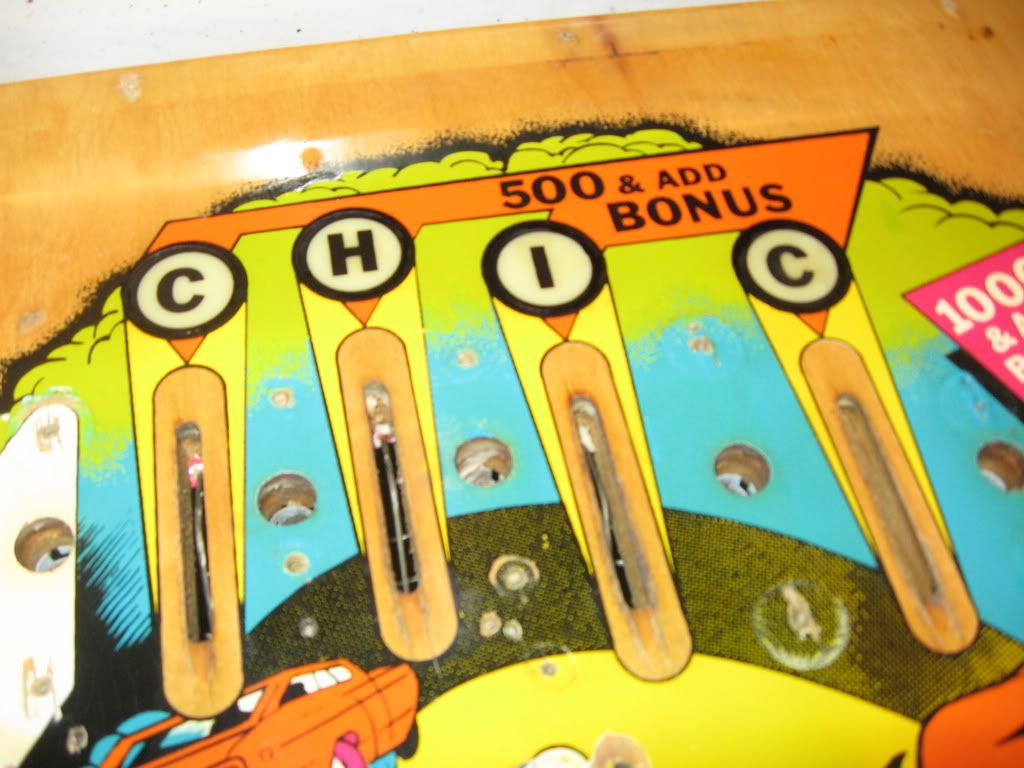

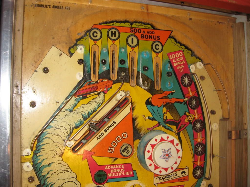

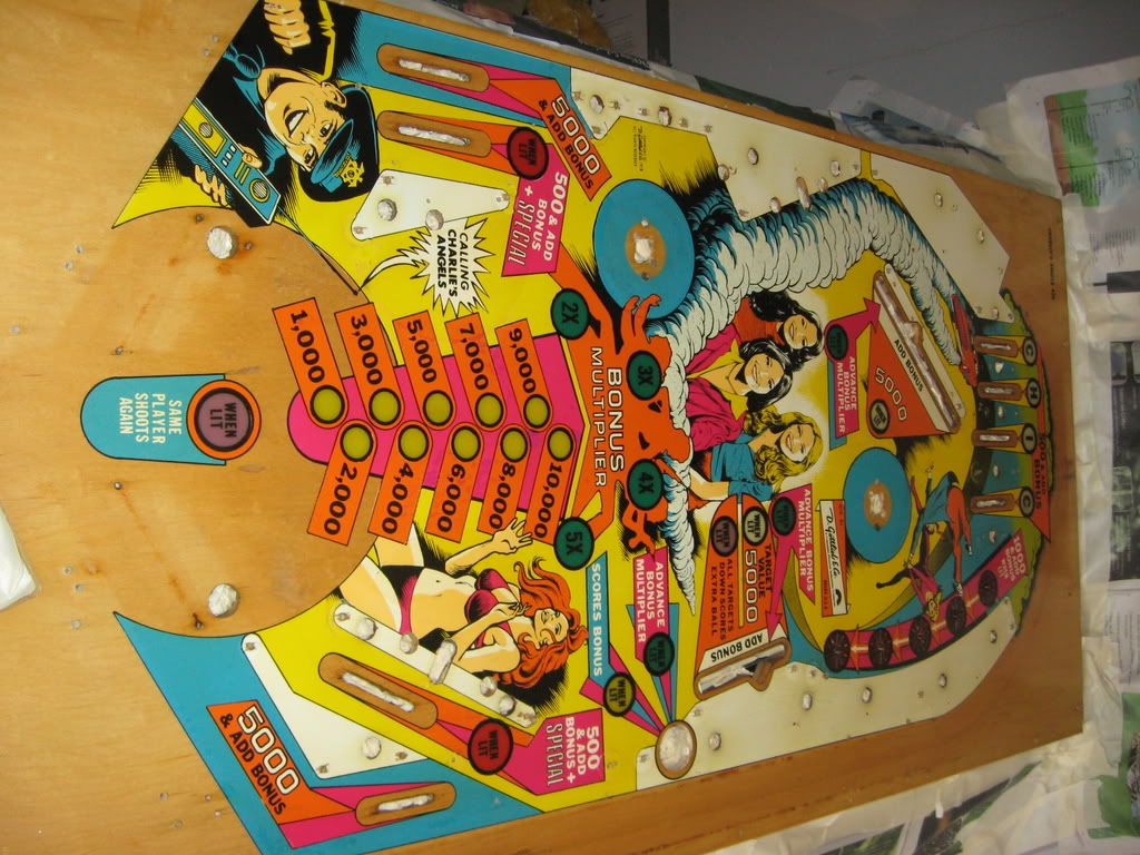

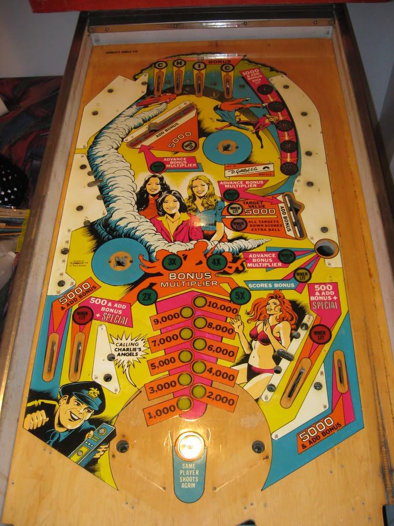

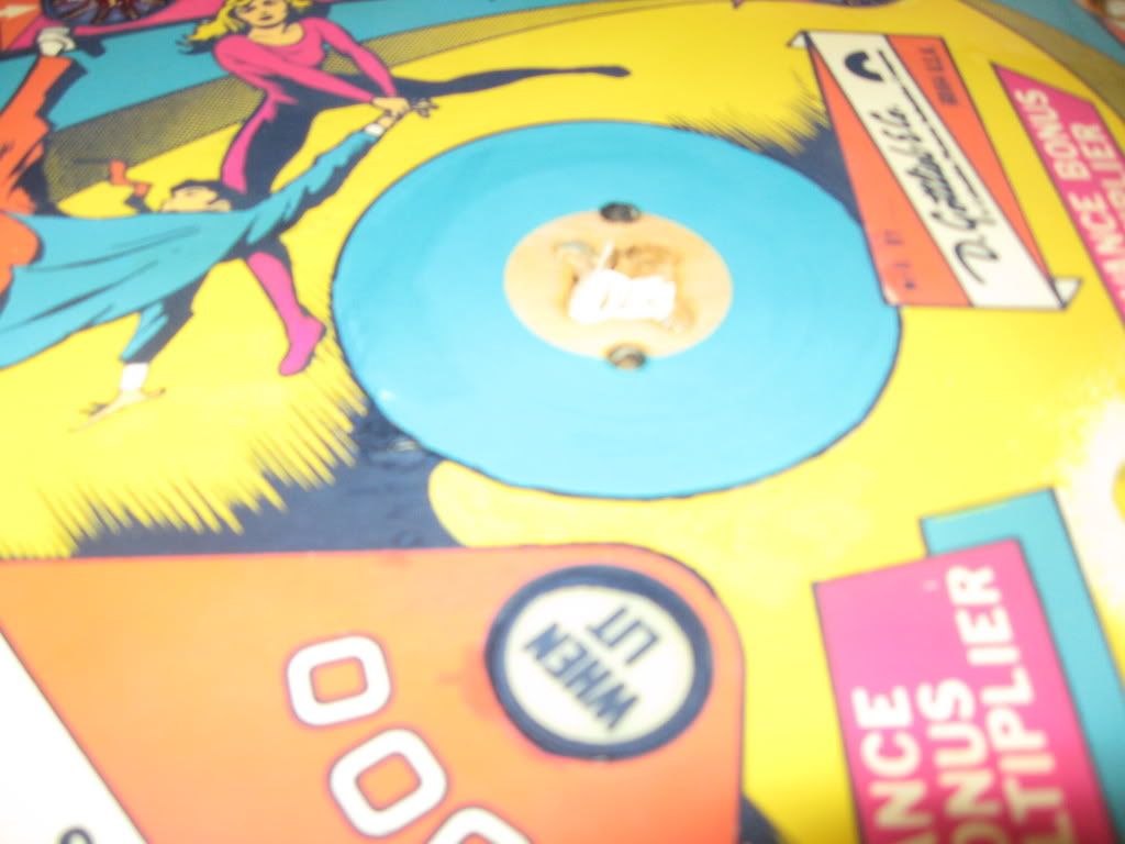

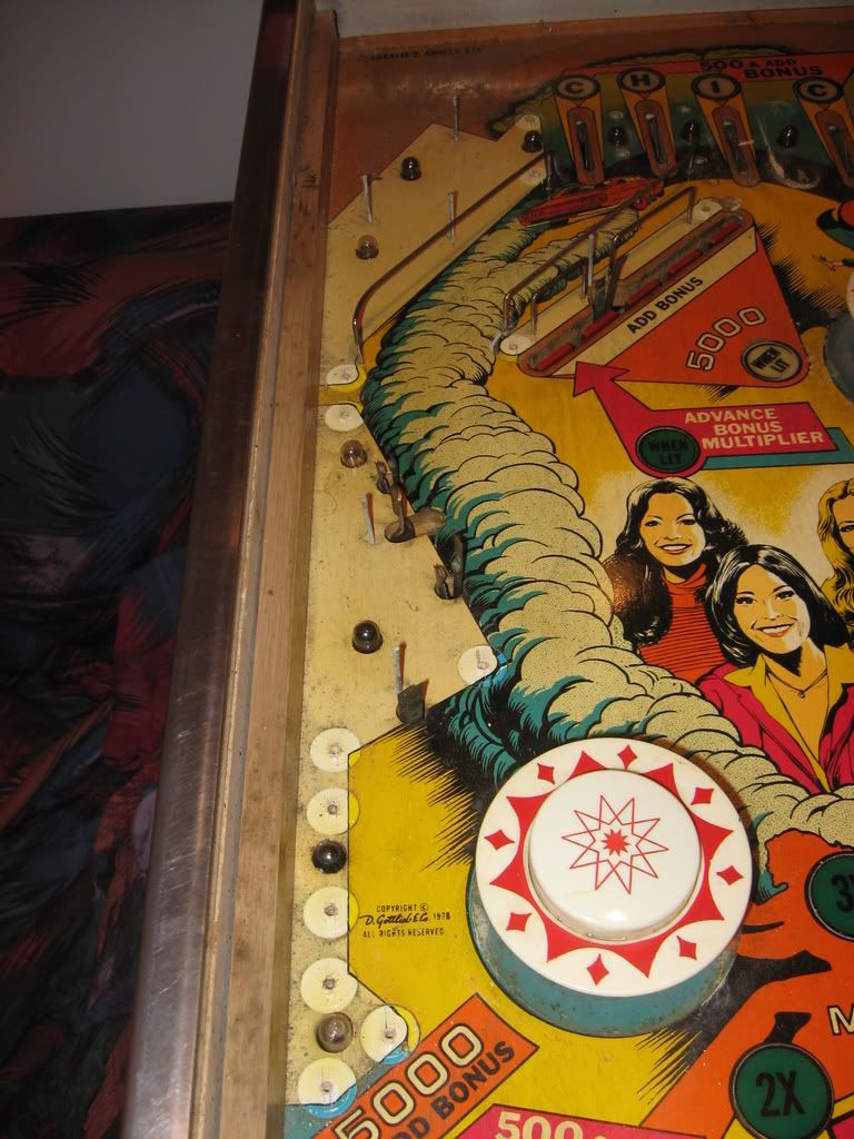

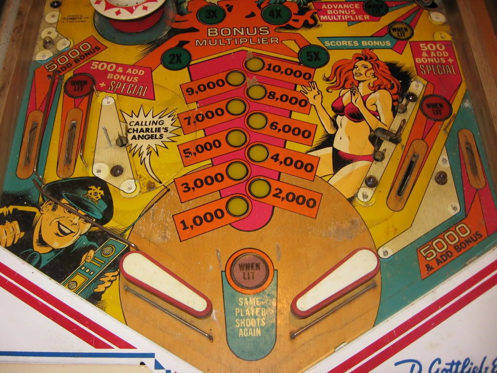

And of course, here are some pics.
Cosmetically, I couldn't have asked for a better pin for the price. Only two minor wear spots that will be easy to fix. The flaking on the skin of the girls on the backglass isn't all that bad and should be very easy to fix once I match the skin color. I don't know, I think I like the skin disease look. ;)
As you can see, the business end of the playfield is very clean. They say the mechanical parts on gottlieb Sys1's are very durable. We'll see once I get the mess of the electrical figured out.

shardian
  • Posts: 9218
Re: I finally got a pin...EDIT: WORKING!!!
« Reply #168 on: August 22, 2008, 11:17:40 am »

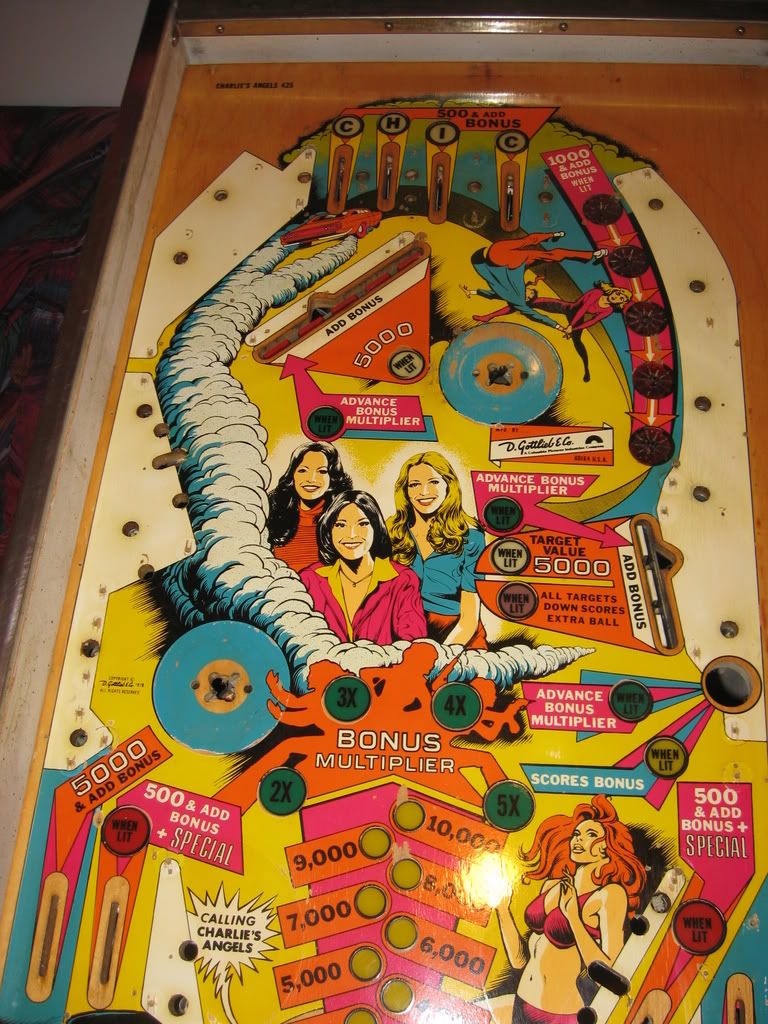

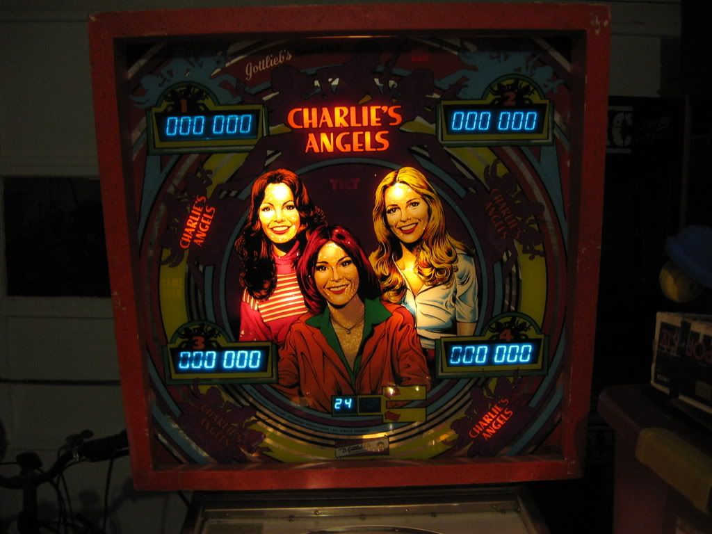

Some pics. Click the thumbnails for the big photos.

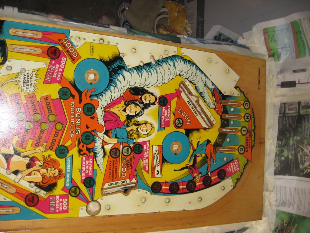

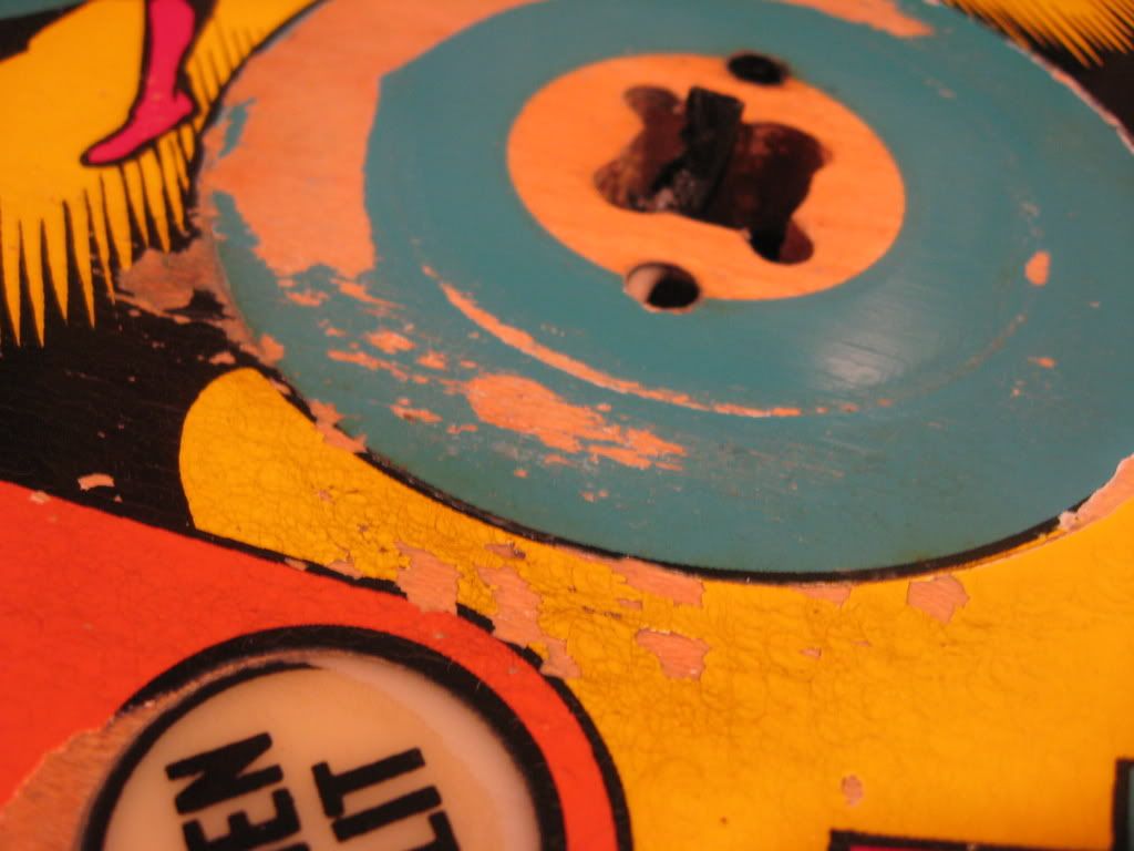

Okay, it is time for some pictures. First up, some 'before' pictures.
As you can see, it is just overall grimy and nasty, with plenty of ball swirl and stress cracking. It did look worse before, but a few months ago I did use a magic eraser and cleaners on it in a few areas.
shardian
  • Posts: 9218
Re: I finally got a pin...Starting the resto process.
« Reply #193 on: September 23, 2008, 08:54:06 am »
These photos are after cleaning, magic eraser, and Novus 2 buffing. As you can see, some areas have major wear. The white plastic areas I can only do so much with. I suppose I could work them over again with the magic eraser, but the return wouldn't be worth it.
I also have several wear spots in the non painted wood areas. I want to build those back up with llaquer before clear coating. There is alot of minor wear spots, but the top pop bumper is the worst area.
  • Posts: 38204
« Reply #194 on: September 23, 2008, 09:01:59 am »
Make sure you look into possible reactions between lacquer and whatever clear you use... RGP has too many horror stories about that to count.

Finished all the touch-ups last night. Me and the wife tag-teamed it all. The color matches for yellow, magenta, and orange aren't 'dead ringers', but the time/quality tradeoff for someone who doesn't know what they are doing dictated that it was good enough. No pictures for now, but I'll try to get some up tommorrow.
shardian
  • Posts: 9218
« Reply #211 on: September 29, 2008, 09:07:35 am »

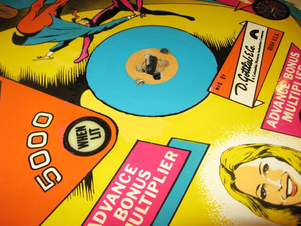

Here are some pics of the touchups. I decided to completely repaint the upper pop bumper area to make it look more even. It turned out really, really nice. I have been considering also doing the lower pop bumper, but think I'll just live with it. The brush line reducer stuff works wonders with uniformity of the paint. You don't really paint at that point, you just drip the paint on in a uniform way. It dries level, flat, and smooth (After 24-48 hours of course!).
Another thing you will notice is that one of the colors isn't quite right. Well you can thank my wife for that! I kept telling her that adding white would 'whiten' the color too much. She insisted, so we went ahead. It doesn't look as bad in real life as the pictures, but is still pretty noticeable if you look closely. It will darken a bit with clear coat though, so I guess I'll stick with it. Magenta darkened much more than the other colors when clear coated in testing.

  • Posts: 38204
« Reply #212 on: September 29, 2008, 09:29:48 am »
What's that?
Looks pretty good.  Nice job.
« Reply #217 on: October 01, 2008, 06:33:09 am »

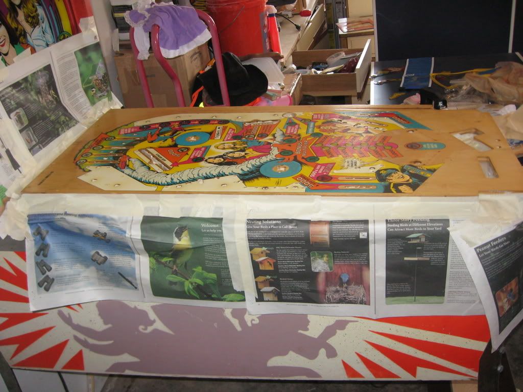

Clearcoat pictures:
  • Posts: 38204
« Reply #218 on: October 01, 2008, 08:49:51 am »
Good start... I definitely suggest next time just using Novus for that last wipedown before spraying the clear.  I need to get better at spraying on flat stuff like that myself.  I never seem to get optimal results.
shardian
  • Posts: 9218
« Reply #219 on: October 01, 2008, 08:57:46 am »
I can officially say that there is absolutely no reason to use Naptha. The stuff is absolutely worthless! 91% alcohol works just as well, and is much safer. You don't even have to use gloves with alcohol.
Another note for anyone considering doing this: Invest in tack cloth. The usefulness of this stuff is way understated. After sanding, a tack cloth will remove 100% of all dust on the playfield without any cleaners or other wipe down.

I should have thought twice though, because alcohol also wipes off the paint pen. I learned that when taking a q-tip to the star rollovers.
The magenta is staying as-is. The way that color changes with clear, there is no way I will ever match it up properly. Even though I added a ton of white, its final color was almost the same as straight from the bottle magenta! It looks 'good enough' for an old game. I just want to finish it up and get it back together.

Applied another thick coat of Polycrylic last night. I wasn't entirely happy with the way the clear 'touchups' turned out, but think by the time I put 1 or 2 more coats on, it should work out okay. I doubt I will get a 100% level surface from all of the bare wood areas, but it will be good enough. The inserts still aren't going to level either. I'll wait 48 hours before messing with this coat.

Another thing you need to do, and you didn't do in advance (because I didn't do it either) is flip over the playfield and put some water thin super glue on the inserts at their seam against the wood.  You don't want the inserts shifting after you've cleared the PF.  Do this after it's cured, though.
Can't do that on this pin. They did not use thru-holes for the inserts. There is a hole on the bottom, but it is smaller than the actual insert. There is no way to hit the seam without taking the insert out from the top. It makes me wonder if the inserts were ever level. If they are sitting on a ledge, then it may have just been a manufacturing innaccuracy.

As to leveling the inserts, I think 2 more thick coats with adequate sanding in between should get them to 'good enough' status. I have seen improvements with each layer. I was not happy at all with the way the previous clear patches went. I simply couldn't stand to see that on every insert. Besides, this machine will never be played enough to wear down thru all that clearcoat, being it will never see high traffic route abuse again.

Okay, I have almost all the inserts smooth and level. There are a few that have given me fits, and still have a slight lip. I'll give them another go once the 4th coat of clear dries for a week.
A problem I encountered with the 4th coat was tiny air bubbles in the finish. I never saw them in previous coats, but I had quite a few this time. I figured they would 'pop' after a few minutes, but most did not. I figure I can address these with a stick pin, then spray a bit more when spraying the final coat? I wasn't too concerned this time since I still have another thick coat to go. I still do not like the way polycrylic sprays on. If I had a do-over, I would have used standard polyurethane since it sprays heavier.

Well, the last coat of insert clear has all the inserts more or less level. I had to adjust the level of my playfield, because I think the slight angle threw off previous leveling attempts. Sanding those inserts down is a real ---smurfette---.
Now I just have to wait for one more warm day for the 5th and final coat of clear.

Well it's been a month, and I think that is more than enough time to cure. See, I CAN be patient!
Anyways, I went to town with 600 grit last night. After 3 passes, the finish still has lots of pinhole type spots. Will wet sanding help with this any, or should I just do a few more passes with 600, the a few with 1000?
I also picked up a 6" buffer with some rubbing/polishing compounds. I tried out some Novus on an inconspicuous area and it doesn't work very well. Once I get the pinholes mostly taken care of, I will hit it good with the buffing wheel. I don't think I;m gonna end up with a professional mirror finish though.  ;)

I did plenty more 600 grit sanding and got it 'good enough'. I've been experimenting with the buffer and the compounds. It appears that a heavy pass with rubbing compound and a light pass of polishing compound does very nicely. Follow that up with Novus 2 and it is SUPER slick. I only did half the table, so I need to get back out there and do the top half.
I also need to pick up some paste wax as a finisher. I'm really torn whether I should even bother with the wax. I have heard that it is not necessary if you get a mirror slick finish. Others say go ahead.

Playfield is thoroughly waxed up, pop bumper assemblies all shiny, and all metals polished. Now I suppose I have no more excuses to keep me from reassembly.

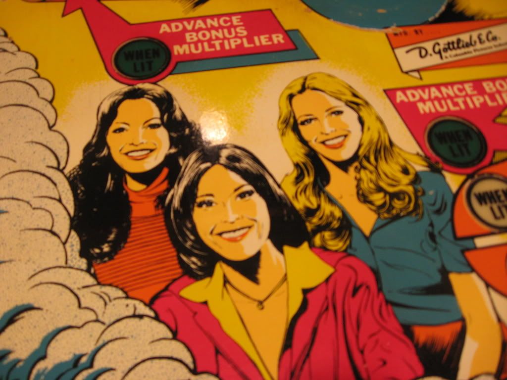

That thing really does look NICE.. It does look better in person.. You did an AWESOME job on it..    :applaud:

Thanks! I have stared for so long at all the flaws, that it is hard for me to appreciate the overall improvements.

I was just gonna post some notes, but I bet you all are getting sick of seeing my post bumped with out pics. Am I right?
It was a busy weekend with the family, but I did get the drop targets done. The silver paint was a very close match, and went on easy. The metallic green paint went on translucent, and I had to cake it on to make it opaque. This also caused the paint to be darker than I would have liked. I don't recommend using the glittery metallic paints - they are a pain to work with.
The original image created a depression on the plastic, so I had a pretty good built in template on each target. One white target wasn't original, so I used my wife's wax fabric pattern transfer paper to put on a light colored boundary. It worked well.
As you can see, I am about 75% finished. It takes a while when only working 5-10 minutes a day.  ;)

Video of the 'Wizard mode' Pi-1 modified gameplay. The original light scheme was very boring. Nothing flashed, no attract mode, no flashing events, etc. The displays were also very boring - just showing scores. This game was for all intents and purposes an EM that simply replaced the relay banks and reels with a pc brain, but acted exactly the same.
With a Pi-1, the game behaves more like a CPU controlled game should of that era. Flashing waves of lights all over the place, satisfying light events when you get a skill shot (also new), and the displays do all sorts of scrolling messages.
