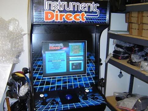

Here is an example of a Machine I recently did for my boss, he had no need for more than 3 buttons, so the existing CP was sufficient:
As you can see, the existing CP just BARELY had enough for even that limited layout. I made another cab at the same time for myself, almost exactly the same used cabinet as this one, but I wanted a larger 6-button layout with a spinner, trackball and admin buttons. The work involved in cutting, reshaping and building a new larger CP almost doubled the time involved, but I knew that was what I wanted. I'll post pics of the sister-cab to this one with the custom CP front to show you the difference when I get home from work.

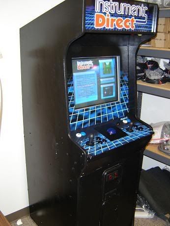

Here is the twin as promised:
Notice despite the same cabinet dimensions, the CP area was totally overhauled:
The colored buttons are the admin buttons as follows:

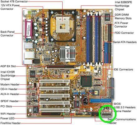

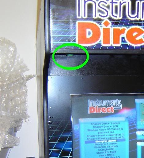

* Here's what I did for my power button. Notice how it's mounted totally out of the way, even away from the Admin buttons, there is a reason  :):
Simply mount a standard CP push button near the speakers, and wire the switches directly to the pins that control the PC's powering up on the motherboard (see below in green circle):

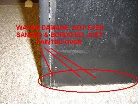

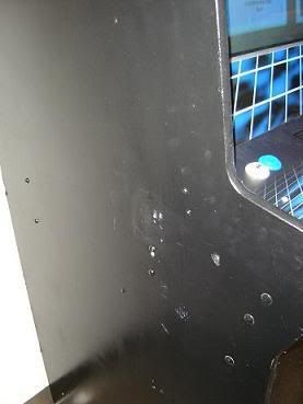

I have a confession to make, of the 2 cabinets I made (One for me and one for my Boss at work) the one for my boss was a heavily water damaged cabinet before I got to work on it, you will be amazed how well the above tips will clean her up, check it out:
Remember this? Looks fairly nice, doesn't it?
Look again.....
There was a 4" hole in the side of it when i got it, no lie.
And see here, hard to see the horrible water damage, I didnt even heed my own advice above, I just simply painted over it:
