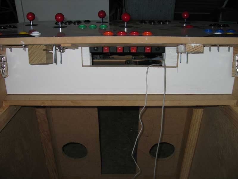

I've read through this thread more times over the last 2 weeks than I care to admit. But... Mr Bones, I have a couple of mix-n-match, oddball questions for you.
1. Would you mind posting a couple of additional pics of the back of your control panel (the part that seats against the cabinet) I'm having a hard time seeing how you've planned to secure it to the cabinet so that it won't move at all.
2. What influenced your decision to use those ball top joysticks as opposed to the "competition" variety? Authentic feel? Price?
3. Comment: looks like your rocker switches (your admin switches) are upside-down unless it's the rule of thumb in Aussie that "toward the equator" is off.  ;)
I have to say, however, that your design and the hard work you have put in to this project has inspired me more than many others because you aren't a veteran woodworker (had to buy your first sets of tools), had never built a cabinet before, and don't strike me as a geek (TBD :))
EDIT: provide link to control panel pic I'm talking about above
EDIT 2: Ok... nevermind on question 1. I thought you were actually going to use those case latches. (my bad)
Sorry man, I am unable to supply more pics at this stage as everything is back in pieces again but I will post something at a later stage during final assembly.
I think you may be struggling with the angle of this photo. The white painted section is the CP box (coffin  ::)) and the CP fits into this and is held down by gravity only. The CP has legs around 2" deep that locate it and stop it going anywhere. The coffin itself is bolted down and cannot move. (The case latches hold the dashboard in place only)
Nothing in this project has been based around a budget (except paying freakin $100 in freight for a freakin bezel) and I did not get a chance to try the joysticks out before I purchased. Here in Oz there are limited suppliers of arcade parts so I pretty much ordered what was available at the height of my excitement.
There is another place selling some Happ's joysticks now but I like to do my shopping all at the one place and this was what Ozstick had available at the time. I had a goal when I started to make this cab from locally available parts, in reality I now wish I hadn't. I had some bizare idea about supporting the developing hobby in my country...blah blah blah.
Are they really? Ohh well, live and learn. Thank you for highlighting my stupidity.

Yeah.... It is big. This pic shows the proportions well. I just couldn't bring myself to build a squashy 4 player CP.
When the colour goes on it will be interesting to see what effect colour has on the appearance and size.

I was just looking at your drink holders... do you have any extra wood protection from all the condensation that's going to come of those drinks?
Hate to see you start to put everything in the cab and have problems.
Aloha.  ;)
Boz
  • Posts: 371
  • Last login:March 23, 2025, 03:55:29 pm
    • Battle Chasers Upright Cabinet
Re: Arcade Bones (24/9/05 Priming continues)
« Reply #466 on: October 03, 2005, 05:02:28 pm »
I believe those are actually speaker holes. The one's just above the control panel, right?
Or was that a joke -- intended on suckering in the noob who responds and lining him up for unending ridicule. ~sigh~
:D
Bones
  • [Moderator]
  • Posts: 3993
« Reply #467 on: October 03, 2005, 05:18:39 pm »
In2ishun is right. The holes are for speakers.
Anybody who brings a drink near my finished cab will be beaten with great vengeance and furious anger.

Yesterday I applied two coats of undercoat over the top of my previously sanded and primed white surface. The undercoat is basically white with a black tint added to produce a grey finish. This was necessary in order to obtain the final colour I have chosen for my cab.
It was later explained to me that the original MDF sealer I used could have had the black tint added which would have reduced much of the previous work and help keep cost down.
At first I was a little pissed about not realising this but considering the problems I had along the way with the putty expanding, the amount of work and paint used would not have changed anyway.
The cab photo pretty much looks white not grey so I have included my paint stirrer which is in fact white and the difference can easily be seen.
