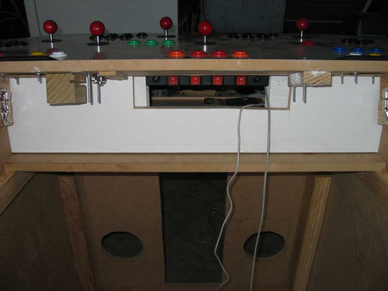

Mounting of remote control.

Re: Arcade Bones (Australian smartstrip. Arrrghhhh!!)
« Reply #427 on: September 14, 2005, 05:15:10 pm »
Peale built a simple relay-based circuit which turned on a power strip.
Here's a link to the thread
Bones, that's the one right there. Thanks budda

« Reply #429 on: September 14, 2005, 10:17:22 pm »
What I've done for every cab I've ever built so far:
1) Grab a standard AU$5, 4 or 6 point power board from anywhere
2) Grab a AU$4 standard 3-pin australian power connector from Jaycar/Dick Smith/whatever ( Link here ).
3) Drill an 8mm hole in the back of my cabinet
4) Cut the plug off the power board
5) Feed the cut cable through the hole
6) Reconnect with the plug from (2) (no solder needed - just strip the wires and screw in as per the instructions)
7) Jump into your PC BIOS and tell it in the power management section that it should power on after a "Power Failure".
8) Plug everything else into the power board (monitor, speakers, whatever).
9) When needed, plug your cabinet into the wall and turn it on.  Everything powers up.  When finished, power down your cabinet via your frontend (I use both MAMEWah and AdavnceMenu, and they both support this feature).  Turn it all off at the wall.  Next time you power on, up comes the PC again!
No crazy power strips needed.  If you're afraid of chopping up power boards to add the plug, you can just drill a bigger hole (say, 40mm or so diameter) and feed the original plug through that instead of a smaller hole for just the cable.
Even trickier, if you have a rear door on your cabinet, where the door meets the next panel you can drill a small 8mm hole on the side edge, so that you can easily place the power board cable there, shut the door, and it fits nice and snug.
If all of that sounds too confusing in writing, I can post pics of all three solutions in action.
