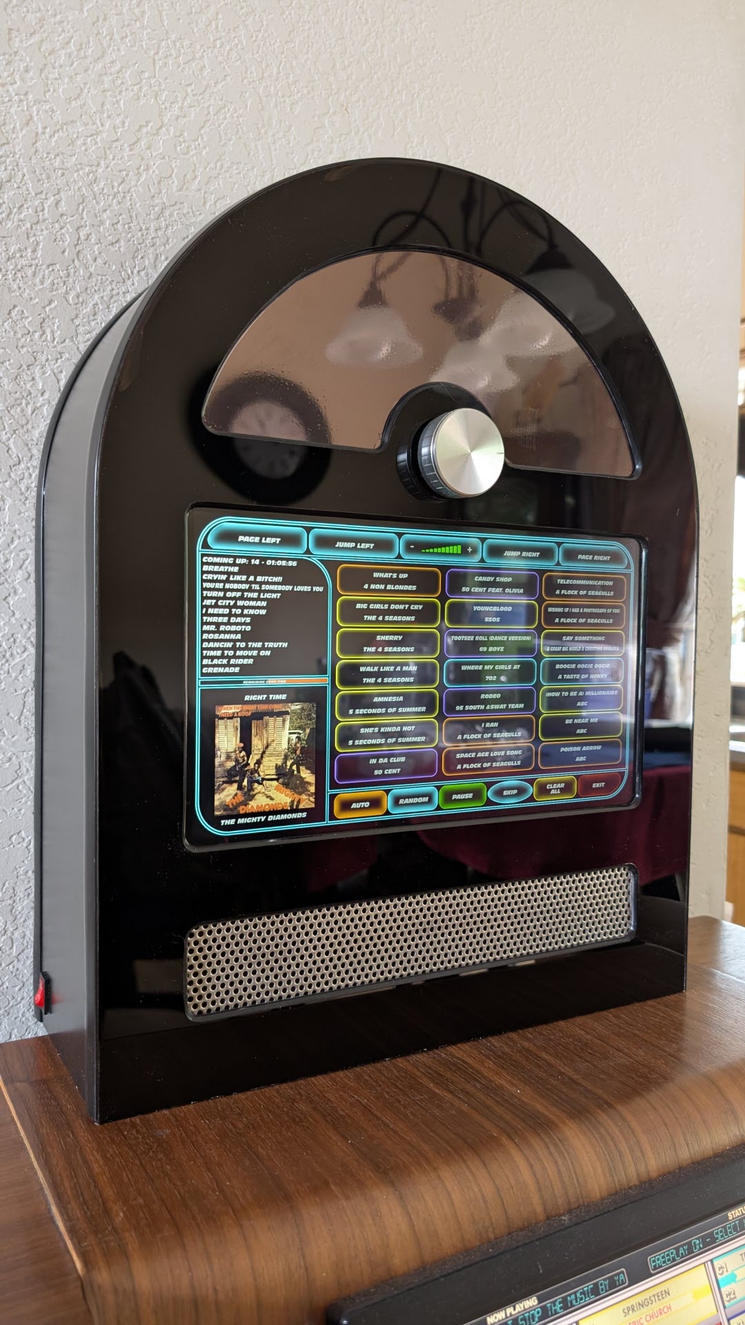

Wow. Been a while since I've posted here. I always was impressed by the Mountain Jukebox but never really had the time to build my own. Over the last few years, I've been using and creating skins for Fruitbox, a Raspberry Pi jukebox program and have created a few jukeboxes using old wallbox shells and a couple antique radio shells. I decided I wanted to build something from scratch this time so I decided to go with the tried and true Mountain design. I'm using the original Mountain post as well as posts from Martijn and javeryh as guides. Planning on this being more of a wallmount unit than a bartop so it won't be as deep as those but roughly the same height and width. Not sure yet if I'm even going to have a back on mine or if I'll leave it open. After all, if it's mounted on the wall, who cares what the back looks like?
Below are some pics of my initial progress. First image is cutting the radius. Second image is cutting a second front to use in the event I screw up the first. Also can use it as a template if I ever want to build another. Third is applying the plexi to the front. It has been sanded with a pretty aggressive grit to promote better adhesion. Fourth image is the plexi cut and bevelled.
I'll continue to post images as work on this continues.

Some more progress from yesterday.
1 - Back of front panel routed out
2 - Test fitting the monitor. This is a 13 inch touchscreen monitor intended to be used as a secondary laptop display. Hate that they put the connections on the side. Hade to seperately purchase 90 degree elbow connectors to make this work.
3 - Test fitting the speaker grill. The steel grill material I got on Amazon was exactly 12inch x 12 inch so the hole had to be pretty much exactly 12 inches wide. I based the other holes to be right at 12 inches too but I think the monitor hole is just a tad over 12.
4 - Plexi edges all polished up. Took about three hours of sanding and polishing to get it to this point, although now that I know what I'm doing, I think I could do it much faster now. It could probably use just a little more attention but I think it looks pretty close as is.
5 - Front panel glued up to the frame.
Next, I need to glue the laminate to the sides, cut a slot for the t-molding and figure out how I'm going to mount the volume knob. Once that is done, I will be ready to start on the electronics.

With the exception of the marquee area (still very undecided on this), this one is pretty much done. For now I have a one way mirror type tint on there. Thinking of an infinity mirror something or other.
A couple oops I made - I drilled a hole in the back and I cracked the laminate there. Not super concerned because who is ever going to look at the back? Still irritating though. I drilled the hole for the power cord at an angle so it would be happy sitting on either a surface or mounted to the wall. I used some CA glue to "fix" the cracked laminate and to add reinforcement to the underlying MDF in that area.
I also had a big mess on my workbench and my hot glue gun melted a big hole in the front t-molding. I'm lucky it was just the t-molding. I had some more on hand and was able to burn that with my soldering iron!  :banghead: More t-molding on the way.
When I routed the back for the t-molding last weekend, I decided it would be a good idea to route the inside of the back for t-molding as well. When I pounded the t-molding in, it seemed really loose. :angry: Duh, the pressure of the t-molding coming into the same area on both the inside and the outside caused the MDF to spit apart. Fixed it with some gorilla glue and decided for the inside t-molding to cut the t part off and just glue it directly to the MDF instead of pounding it into the slot hoping the MDF wouldn't come apart again. Seemed to work fine and the back seems solid now so lesson learned with that.
