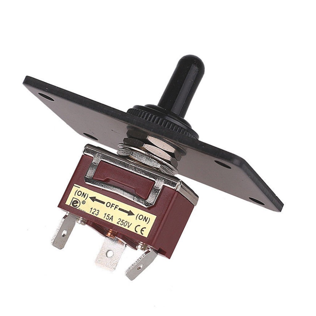

First I made some rookie mistakes by immediately jumping to soldering on wires confidently trusting everything would be ok.  Boy was I wrong.  Then because I decided to wrap the wires inside the holes of the prong and loop them around before heavily covering them in solder, I had a heck of a time figuring out a way to get them back out.  Turns out my micro flat head screwdriver was helpful because the solder wouldn't stick to it well and I could use that to try to slowly pry and unwrap the wire while keeping the iron on it with the other hand.  Also learned you gotta be more careful with hot solder flying around.  All that tugging flicked some hot specs back at me, causing me to flinch and drop the iron.  Fortunately the iron landed on something metal instead of the carpet. :)  The other big mistake I made was trying to pry a big excess glob of solder off one of the prongs sticking out of the back of the PC power switch board.  Turns out that solder holds pretty tight and I took the prong off with it.  :)  So.... then I had to create a make shift solder connection point with the bottom metal pad that was now exposed on the board.  After managing to get the two wires connected to the bottom of the board, I was finally read to try to do some connection tests and make sure all was good before making anything more perminent.
I was given a wiring diagram online from the seller of the switch and it seemed pretty straight forward, so I thought it would all just work.  However, after many tests I quickly realized that I could manage to get the button to light up, but that was about it.
After a lot of time thinking about it and going for a walk, I came back and decided to start trying other combinations of connections to see if I could get it to work.  In order to do this, I needed to make some additional wire connections based on the original diagram.  Fortunately I have some solid core #22 gauge wire I mistakenly ordered years back thinking it was stranded, and decided to use some of that to make some crude additional jumpers I could bend on and off to test.  This actually worked, and after studying it a bit more and trying different combos, I FINALLY found one that worked!  I still don't quite understand why it's so different than the diagram I was given.  My only guess is maybe it will work different if I have a separate power source like the diagram wants?  Any electronic wizards wanna shed some light on that for me?

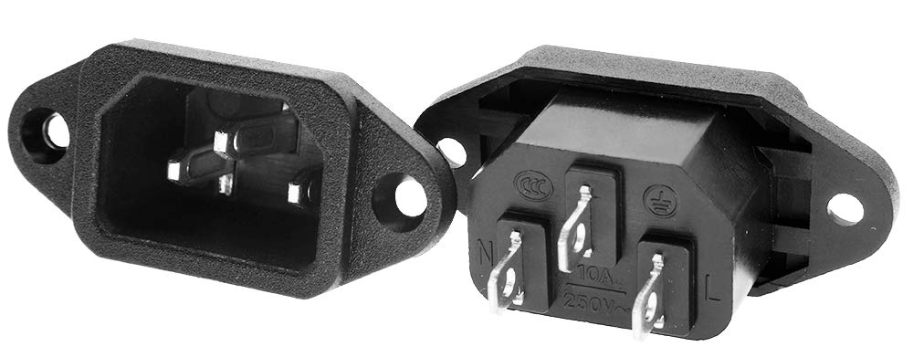

In looking at options for the power inlet / cord extension outside the cab to plug into the wall, and then how a lot of people are connecting it internally to a power strip, I've run into some questions.
First question is around the inlet choice.  Looking on Amazon there appears to only really be one option available and it isn't UL rated.  It has a red power switch with it and a 5A fuse.  It's also the same one featured on the electrical section of the Wiki here.  Is that really it for choices?  Given even the wiki mentioned some reports of melting and corrosion possibilities with these, are there better alternatives?
https://www.amazon.com/gp/product/B00NWO68JI/ref=ox_sc_act_title_5?smid=A2Y736KGZ14HTQ&psc=1
I'm also now debating if I really need 2 power switches.  One on the inlet, and then a separate one to turn on the PC, which also triggers the smart strip for the rest of the cab.  One idea was to set the bios on the PC to boot when it detects power presence, so I'd just have the one switch then.  The nostalgic side of me also wants to consider a metal toggle switch instead of the red LED rocker.  I only remember those on the backs / tops of cabs growing up.
The next question is the correct wiring gauges to be using to handle this direct power.  With outlets, to be up to code in high use areas (kitchen) you're suppose to use 12 AWG from what I've read.  14 is supposedly OK for something like a bedroom, but I've only ever used 12.  Yet when I look at some of these inlets that come with wires and quick disconnects, they appear to be using 14-16 gauge.  Then to further confuse me, the standard PC power cables all appear to be using 18AWG, which is what I intended on wiring the inlet to, and then connecting that to my power strip so I don't have to ruin the strip.
So given all that variance, what is the right gauge to not burn the house down?  If it's all converting down to 18AWG at the cable / power strip, is that all that's needed?  Why is that so different than outlet wiring gauges, and is that really acceptable given how much draw the full cab is likely to need?  :dizzy:

The reason outlets and strips have a lower gauge (thicker) is because they may have multiple devices powered at once.  Therefore the current draw may be more significant.  All you really need to do is figure out the power usage (watts) of each of your components at max usage then you will know the current draw at the outlet (P=V*I) so multiple each of your components Voltage * Amperage to get the max power used.  Add all the power of each of you components then divide that by the 120V that a standard US outlet outputs and you have your amperage at the inlet.
The melting and corrosion problems are almost certainly the result of user error.
i.e. Loose crimps, crimping mostly on the insulation instead of bare wire so only a few strands are making contact, high resistance connections, etc.
If you do the simple mechanical and electrical checks outlined in the wiki, you won't have a problem.   ;D
http://wiki.arcadecontrols.com/index.php/Wiring#Inspecting_Power_Wiring

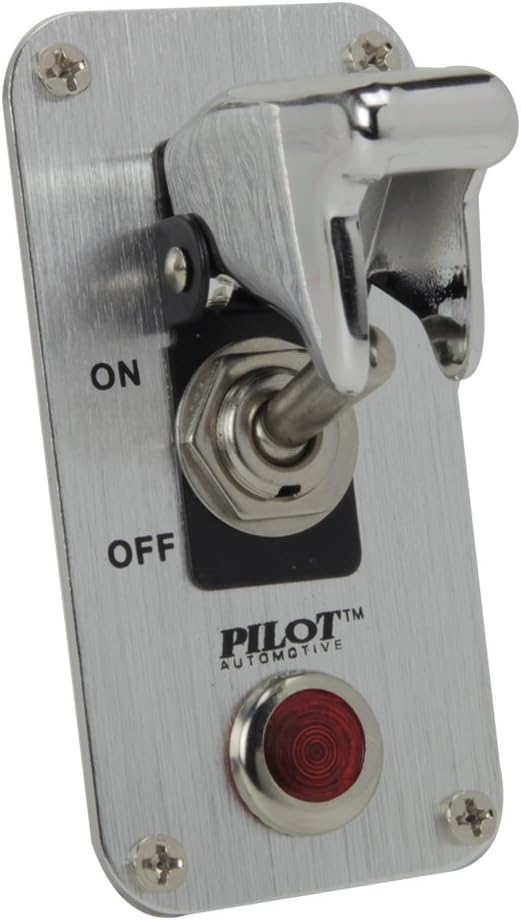

I haven't seen any fused IEC inlets with that type of switch, but you could use an un-fused IEC inlet and fabricate a panel for the toggle switch.
Wire the switch in series with the hot/live/black wire -- the tab marked "L" in this photo.
One easy and clean way to mount the switch is to use a blank single gang cover.
You may also consider using an "old work" single gang electrical box or low voltage ring with the cover.
The pre-fab single toggle switch on a panel options I've seen are usually rated for 12v (car/motorcycle/boat applications), so you'll probably need to replace the switch if you get something like these.

FYI, my power inlet melted because I used an ancient pc power cable.  The connectors inside that end were probably worn out or corroded.  Buy a new cable.  I redid everything exactly the same with a new cable and have had no issues since.

Thanks for the quick responses guys.   :cheers:  I'll need to recalculate what the total draw will be now that I've got most everything except maybe all the lights.  Although if I can run all those through the PC with the PacLed64 then the total draw is the max of my PC PSU anyway.
Scott, (or anyone), what would be purpose or advantage to having an inlet with a fuse?  My brother in law though the house circuit breaker covered the need for that.  I'm guessing surge protection, but shouldn't that be covered with a smart strip?
He also pointed me to an inset inlet on amazon like this:
https://www.amazon.com/Journeyman-Pro-Flanged-Commercial-Straight-Cap/dp/B01E6N0XFI/ref=sr_1_1?dchild=1&keywords=inset+inlet+outlet&qid=1599951944&sr=8-1
It's quite a bit more expensive but is rated for up to 15 amps.
Thoughts?
The circuit breaker is there to protect the house from an electrical fire caused by too much current drawn through the wiring of that circuit.
- You can easily fry a system with far less current than it takes to trip the breaker.
The fuse is there to be a cheap sacrificial part to protect the rest of the system from situations like a cascading failure if one part of it breaks down.
- A cascading failure is where one part fails, which causes another part to fail, which causes another part to fail, . . .
A 10A table saw and a Raspberry Pi plug into the same type of wall outlet, but have very different levels of current draw and protection needs.
Generally speaking, select a fuse based on the current draw and blow time.
- If there's a lot of inrush current when you first apply power (CRT, table saw, etc.), use a slow-blow fuse.
- If it's a sensitive circuit with only a little inrush current when you first apply power, use a fast-blow fuse.
- If it's an average circuit, use a regular-blow fuse.
A surge protector isn't the same as a smart strip, but I would expect a smart strip to include some type of surge protector circuit.
That would work OK if you want to use an extension cord instead of an IEC power cord.
- You won't draw anywhere near 15A.
Bloviator
