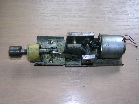

Choosing the right feedback
I struggle on what to use as feedback device. I initially thought of use a vibration motor, but it was a tad too big to fit and then I had to mount it horizontally which would make the vibration goes right/left, and not kick back and forth as you like for a gun.
Also thought of using a small vibration motor and then a small solenoid in conjunction but ended up using a real NAMCO solenoid from my second gun.
I had to modify the solenoids mount rails in order to fasten it and also lower it a bit by cutting the top part off so I could put the top back on.
The solenoid holds up and kicks hard. I initially thought that it would be super hot but it is luke warm at most. clearing the whole first level of Let's Go Island which is a more or less full auto all game through!
The videos of it does NOT make it justice. It kicks like an angry mule!

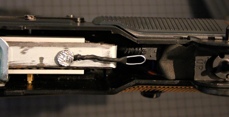

After some heavy play-testing I thought that I had to, even though this is NOT how the real mini UZI suppose to behave, connect the top cocking handle to the solenoid for a more arcade style of firing. This sounds more metallic, which also adds to the fun and more realistic I think!  :angel:
Here is the top cover (bottom view) with the cokcing handle which from stock is connected to a spring and ony works as a pull-and-return gimmick.
I removed the spring and created a latch of a metal sting covered in shringking tube. This is just a prototyp, but I thought it can stay in there and I reinfoce this function if broken as
I intentionally just wanted to see if this was a good idea or not. (edit: It was a great idea!)
Here it is screwed tight under the NAMCO recoil top screw. The task now is to catch the hook from the under side of the cocking handle so it stays connected.
I wanted to do this so can open this part fairly easy if needed.
Linked together

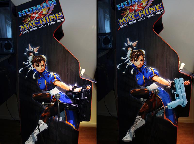

I also found it hard to mount an arcade gun to a standard cabinet. Front mount is a no go as it would poke the player and on the side would normally need a holster of some kind.
I thought they where a bit steep in price to get ithem shipped to Sweden, and also if I wanted to remove the gun they would just sit there over the vinyl artwork.
So I just mounted a long screw in the side which I then covered in shrinking tube.
Now when a gun is not connected minimal coverage is affected to the side art.
The only visible parts is the pin and the female GX16 connector for the module cord.
Here is how it looks with each respectively gun mounted.
The good thing a bout the cord also beeing modular is that you can display the guns when not in use aswell as hide them for underaged players(!)
Linked together
Video of the now recoiled cocking handle

Yes, I also found it hard to mount an arcade gun to a standard cabinet. Front mount is a no go as it would poke the player and on the side would normally need a holster of some kind.
« Last Edit: September 19, 2018, 03:58:00 am by gstav »

I have the BB version of that mini Uzi. I was thinking of using it to make a mold to cast a new light gun shell. I hate my Ultimarc light guns. I feel like I paid $100 for a $15 product...I literally lost interest in shooting games when they arrived. custom is the only option.
I was going to use a regular mini dc 6000rpm motor to cycle a bolt for the full auto recoil. I just don't understand how to make a solenoid cycle rapidly so there aren't many other options. Do you have to be able to write code for the "custom chip"?
The recoil kit from Ultimarc lacks full auto capability so it is essentially just an overpriced cheap solenoid to stick inside the gun shell yourself. Why can't anyone make a decent light gun for home use???
I feel like there should be an off the shelf product to allow you to cycle a 12v solenoid but apparently, the only way is for each of us to invent one for every project...

Nice build! It's the only good diy (or commercial) home light gun project I have ever seen.

Don't have any experience of the pre-made AimTrak guns, but I did bought the recoil kit with the solenoid, and the thing you get there really is non fireing solenoid when aiming off-screen.
Good effect for my Namco single shooter gun, but not a feasible add-on to this build.
I also think you should go custom or you will never get the true arcade feel. But good for those who just want to step up from playing with the mouse.
That's why did the mod to a real Namco gun with the oiginal solenoid for that good ol' "clack-clack-clack".  :angel:
The solenoid used in the juzi project also is a Namco orignal solenoid, and I do not think you can push the fire rate much more without raising the voltage as there is a bit of time for pull the rod befor release.
The solenoid is designed for 24v max i think and I running them on a 19v laptop supply.
For faster RPM one shoud go either with a shaker motor, which I tried with initially, or if I had the know how, one should build like on the real Operation WOLF gun.
(Not my pictures)
I did see the Terminator Salvation repair video, and they do use the same method but with a extended shaft to push to your shoulder. See link below:
You do need a code written to the Audrinuo mudule to control the state of the selected fire rate and how to puls the signal to the solenoid and to the Aimtrak module.
Not my area though, but according to mr.Juice who helped me with the code, this was easy as pie for him. It was all just which outout to pulse to in what interval and delays.  ::)
You can connect anything up to what the board can handle. I think around 50V is no problem, but my connected solenoid would think otherwise. Dont want to burn it as they are really expensive to buy new and har do get used in good condition.
I think of making a new gun for my brother using a shaker motor placed in the clip with the shake weight in the housing of the top opart of the gun. Then the chip just have to pulse on and of as long as the full fire is needed. Would feel a bit different and I could use a smaller gun. Thought of a Mac-10 or a micro-UZI. But that's somewhere in the distant future as of now..
I could check with him if a module could be created in some way. Soleding it was a bit of time consuming as I did want it to be as small as possible.
« Last Edit: September 24, 2018, 04:12:32 am by gstav »

My first step is to just use those sweet connectors to make the guns easily disconnectable. I've got a couple in hand and am happy with them. 8 pin.
Later on, I REALLY like the idea of having custom guns on the shelf with interchangeability like you got going on. Seriously sick.

Yes! It's great and if you ever got a broken cord, you just have to replace or fix it without the gun in the mix. I really have 6pin connectors, but 5pin is minimum. Guess it's just more crowded in the housing with more.
Only downside is the added work on the cable and the cab mount, if one want to disconnect the cable completely.

I have been having a frustrating time finding components that survive full auto recoil... the on / off pulse seems to destroy relays and the heat generated destroys most solenoids.
I just ordered some solid state relays to see if they can survive a 555 circuit.
What solenoid are you using for full auto and how have they lasted? It took less than one game with full auto recoil (using an Aimforce dongle) to destroy the solenoid and mosfet in the Ultimarc recoil kit.
I just ordered some real arcade gunblade guns which use a motor for recoil. I'm thinking this might be best.

Hi pal! I don't know if a 555 would be any different except o my setup with audrino you can change the fire mode from single - burst (tre real single shots to Aimtrak) or full auto.
My solenoid does not get ot at all running on a laptop supply 19v, think it is made for a 24v power supply originally.
It is an original Namco solenoid which I harvest from a broken time crisis gun.
Doing a new build now with a plastic rifle (log to come) and I have a smaller solenoid spec 24v, but same size as ultimarc. De sent get hot either though I have to test it in game but have no Aimtrak as of yet.
Also have a shaker motor in this build which is a neat effect indeed. Just wanted the solenoid as it also have a small sliding recoil part.

I was definately happy with the find. It's very hard to find these guns with the recoil motor for a good price.
I had to return a bunch of "complete" guns because someone had removed the recoil mechanism. IMO, they are only worth buying with the motor unless you feel like a project to fit a solenoid instead. There is certainly room inside but I never seem to finish that type of project...
With no more than 5 minutes with a dremel, you can make enough room at the front to hot glue an un-modded Guncon 2 board. Then you just have to wire the trigger and front grip button. I used the old trigger button from my Aimtrak (not needed after recoil mod) which fits nicely with just a little snip off the end.
Because it uses a 12v dc motor for recoil, I can activate it with a simple relay. It's one of the easiest full auto arcade recoil gun mods I have seen. No 555 circuits ir Arduino's to worry about.

Yeah me too. It's odd to me that this site does not have a dedicate shooting game section when it has so many pointless sections for everything else.
Arcade shooting and driving games have always been the hardest experiences to recreate at home and the most dependent on having quality peripherals. While there are now a great many quality ffb racing wheels for the home market, fans of shooting games with PC emulation have been limited to a tiny number of poor quality options.
Diy projects to convert arcade guns and to put Aimtraks and act labs electronics in better shells with recoil are the only way currently but there is surprisingly few threads on it. I just assumed that I was part of a tiny minority that love arcade shooters and want to create an authentic arcade experience.
