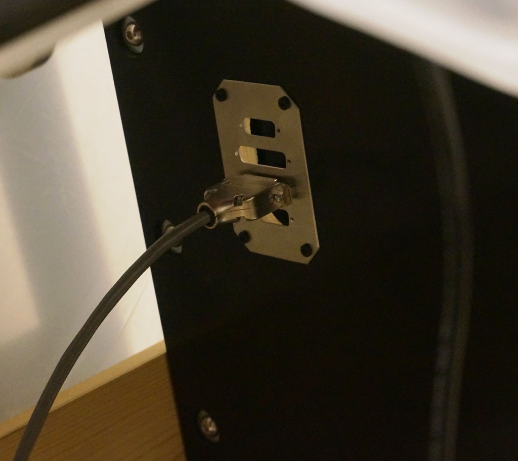

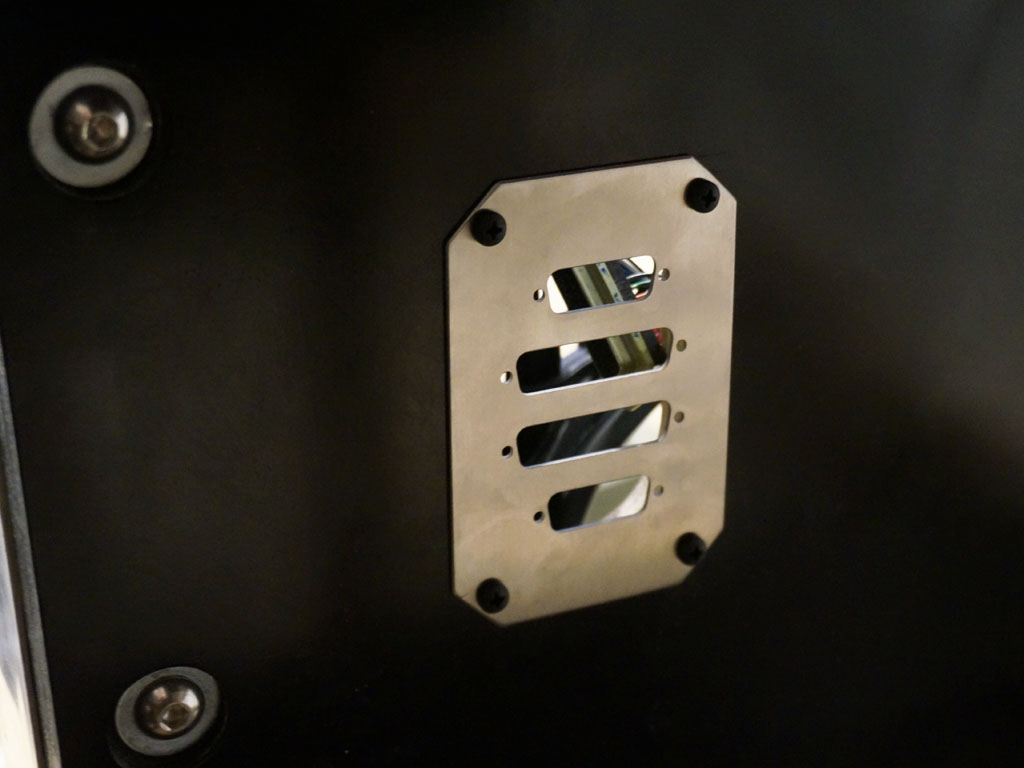

I'd like to share a detail I came up with that I'm sure has probably been done, but that I hadn't seen before.
My cockpit-side control panel is going to have a whirling playfield monitor swinging around behind it, so I need some clean cord routing to avoid disaster.
The flightstick has 2 wires, the steering wheel has 4, and the throttle has 1.  They're all going to be mounted on top of the control panel deck.  Some of them have rather large plugs.
So, my solution is to cut round-bottomed grooves in the back edge of the panel the width of the wires, at a depth equal to the T-mold barb plus the cable width.
Here's the notches for the wheel.
The idea is, the cords route through these, then the rear line of T-mold snaps in and holds them in place.  Here's the throttle illustrating the idea.
The vias don't have to be big enough to pass the bulky plugs.  I can peel the T-mold later to pull a device if I need to replace something.  Given I'll be using black T-mold on the back stripe, I think it'll look decently slick as a way to transfer the cords to the underside of the panel where I can route them out of sight.  They'll all use these vias to get to the underside, then run to the right and into the console.

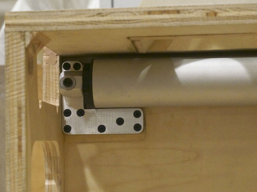

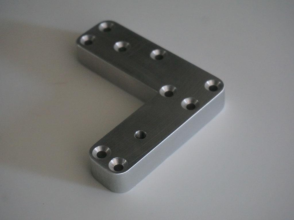

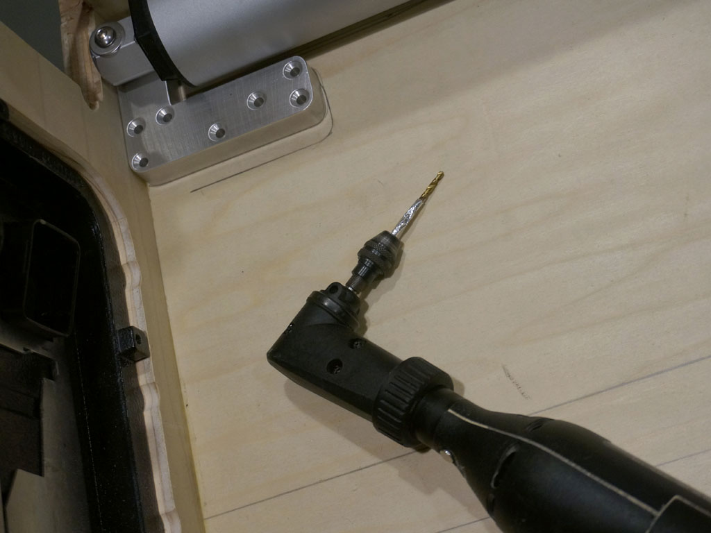

Most of my recent work has been on the console that shrouds the PC.  This will be the right side of the control panel; it houses the shifter, the coin door, the game exit button, the right side linear bearing rail trucks, and houses the 14" throw linear actuator that retracts and extends the control panel assembly from under the pinball table.
This is still missing a bit of the structure, but it's coming along.  I'll be radiusing the top and bottom corners to match the sides after they're both attached.
I didn't want to modify the G25 shifter, in the interests of making replacing it someday if I have to at least a little more possible.  This view shows the crazy weird inletting necessary to sink an unmodified G25 shifter in like it was built in.  It loads in from the front and attaches via the factory three-point clamps.
The right side panel, I'm holding on by hand... because this is only half of it.
It's going to be a laminate of 3/4" plywood and 1/4" hobby plywood, to buy me another half inch of internal width so that I can cram both the PC case and the linear actuator inside completely.
(I did all these cutaways with a dremel tool.  At this point I'm feeling like I maybe am to a dremel tool what Yamatetsu is to frog tape and an exacto knife.   :))

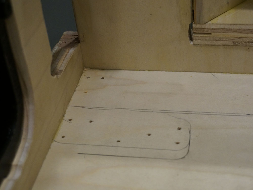

Looking up the bottom of the open-bottomed console, it looks like this:
The actuator rides on the left edge (here looks like the bottom), the PC will ride on the right edge (here looks like the top).  The actuator ram and the hardpoint I built for attaching it clears the clamps on the shifter by a hairsbreadth, they kind of wrap around each other.  The PC will come as far forward as that half-inch deep notch you can see at the top.  There should be a whole eighth inch of clearance between the actuator and PC, and between the PC and the sliding cover...  if I did this right.

In my last post I showed how the actuator that pushes out or stows the control panel fits near the gear shift.  The anchor point where the ram attaches to the plywood should be strong, as it's going to take some load.  Here's what I wound up with:
The ram of the actuator bolts in via the threaded hole, and then the other nine holes with countersinks are for wood screws.
This is a pretty thick piece of aluminum, equal to the distance between a flat of the ram out to the round actuator housing; that gets me all the thickness for threads that I can get, and minimizes the cantilever on the bolt going through the ram.  (Plus, I figure if I'm clamping the ram against this, then I'm also pre-tensioning the bolt, and getting some help from clamped together friction too.)
I worked out exactly where it ought to go - and changed my mind a few times, so you see some extra lines here - then transferred the screw hole positions with the points of the wood screws.
I didn't think to do this before gluing up parts of the box it goes in, so installing it requires drilling some holes pretty close to the inside corners of that structure.  I did my predrilling for the screws with this 90' head on my dremel, it does a good job getting into places like this.  I wrapped the bit in aluminum tape as a depth mark, because these screws should only go about 90% through the plywood, not all the way.
Here's the holes.
I roughed the back of the bracket up a ton with a scribe, wiped it down with methanol, swept off the plywood, mixed up a batch of devcon 2-ton epoxy, slathered the back of the bracket with it, slapped it down and immediately ran the 9 screws into it.  When I torqued them down, epoxy squeezed out just about everywhere.  A useful knifemaker trick - you can clean that up with methanol before it cures, and it does a pretty good job.
As installed:
I now trust this point of attachment - at least, it's the strongest thing I think I can make that still clears the gear shifter and doesn't use up any extra length front to back.

In a prior post I talked about the big forstner holes gone almost terribly wrong that I managed to fix up alright.  I got the stainless steel faceplate made up and mounted over that:
This'll carry 2x DB15s and 2x DB25s for things that need to get into and out of the back cabinet.  I'm going to flip the genders on the matching pairs, so that you can't connect anything in the wrong place.
One DB25 is finished - it runs to the front cabinet, carrying: switch signal and lighting for coin1, coin2, start game, launch ball - additional switches for the 4x pinball inside-coindoor admin buttons, the exit game button, and the coindoor open switch, doubled wires for the driving mode left speaker that lives in the front cabinet,  common ground and common +5v, for about 20 conductors of the 25 used there.
The plugs kinda match the faceplate.   The next run will be a DB15 run to go to the moving control panel carrying: switch signal and lighting for start, 4x VR view buttons, and coin1, additional switch for exit game, common ground and common +5v - that'll completely fill that, 15 of 15, but that's all I need in the moving part of the control panel.
The other remaining DB25 and DB15 are going to be for things like limit switches to see when moving parts have arrived where they belong, locking pins to lock the control panel in place, the actuator to rotate the playfield monitor, pinball solenoids, and such like that.  Figured it was better to have headroom than run short.
