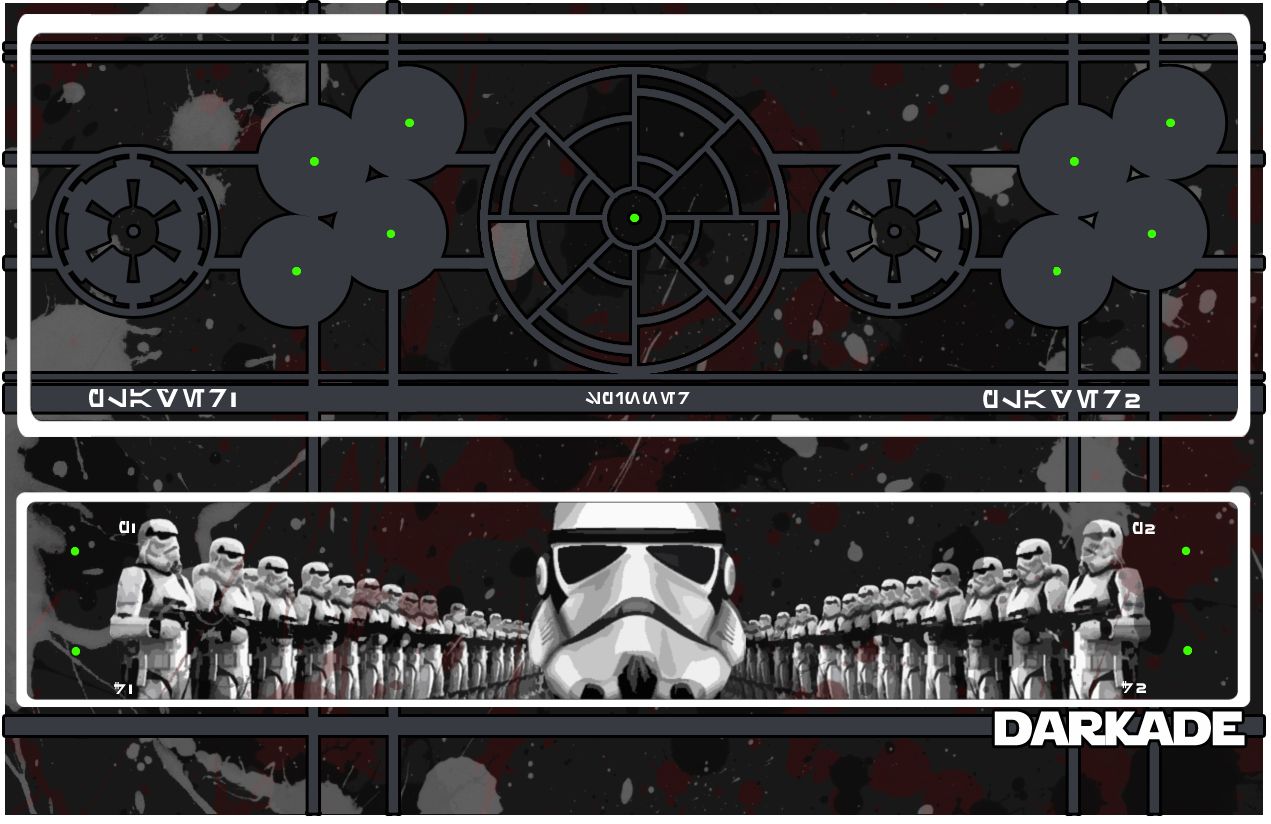

I'm a bit past the 6 month mark since completing this build, almost 8 now.
I've decided to redo the CP.  It works great as a single player but this cab has been getting a lot more two player action than I thought it would.  That is probably due to the absence of a full size multiplayer rig in my house at this time.
I have been so pleased with the auto 4-way 8-way I'm adding a second one.  Now both joys will have the functionality opening up a few other games and allowing me not to have to switch to the P2 position to play the classics.
Moving from a 6+2 to a 4 & 4 player button set-up.  This will cut down on guest confusion and open up all the two player games minus a few fighters.  I'm losing my MvsC and SVII but I'm not overly heart broken.  Besides I'll probably just program both those titles to play MP MK HP HK only and lose the soft hits because I'm a masher and don't use those first two wussy buttons anyway.  Already put in the order for the servo and Omni2 and have completed the updated CPO.  Going to try one of those cheap-o overseas print services and see how I like the product.
Here's the art:
Here's another version, I like the above, having the vertical lines not be symmetrical helps move the eye around the CP and with four I think it is over crowded.  Always open to suggestion and recommendation or course.
Oh, and I've got a black DOT knob coming because the red wasn't a good match for the ball-tops and always bugged me.  Changing that knob is what motivated me to redo everything.

This will cut down on guest confusion...
Nothing you do will help with this. Even when when the only usable controls are lit, I get "what does what?" C'mon, it's 2 buttons and a joystick, not too hard to figure out. When the screen says "Insert Coin", the coin rejects are lit, and there's a pile of tokens in my gameroom, I get "how do I start this thing?"
Anyways, art looks good! Looking forward to seeing your retrofit! :cheers:
