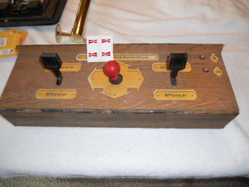

Well, well, well... Another day, another theme. I cannot seem to make my mind... Since the rock idea wasn't working for me, I thought I'd go for a theme based on one of my fiend favorite classic, Tapper.
While it is seemingly impossible to find a Tapper marquee in high res, I decided to try and recreate it.
In my search for art, I stumbled on markronz's Mame Tapper build. http://forum.arcadecontrols.com/index.php?topic=106027.0
I thought his custom marquee looks nice, so I used it as a template to make my own custom one...
Thus, Guinness Tapper was born.
This is still a WIP though...
The work file is 9000x3000, which should be good enough for printing...
As the Tapper cp is mostly wood, I thought i'd print only what was necessary and tint the wood underneath.
Of course i'll have to add a two way joystick with a custom Guinness handle on this... ::)

« Reply #8 on: July 16, 2016, 07:35:03 pm »
As the Tapper CPO is mostly a wooden pattern, I thought i'd print only what was necessary and tint the wood underneath.
Fixed that for you. Tapper CPs are made of the best material a CP could be made out of... metal.
Anyway... Tapper. Great choice for a bartop theme! ;D
