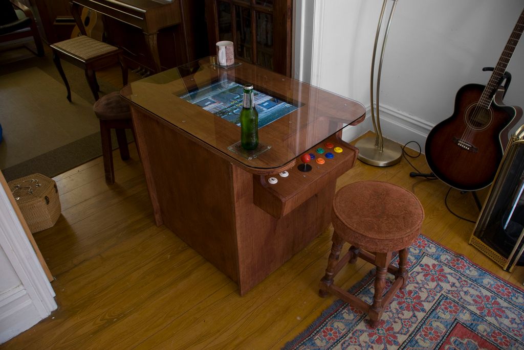

In this pic......
  ...if you will look closely at the screen you can see that its set up for street fighter 2 with the screen split so each person can see. I really just want a two player cab, can i split the screen like so or have they done some tweaking to the code that makes up the game?
  • Posts: 9791
  • Last login:Yesterday at 10:30:55 pm
Re: Another newb wants to build a cocktail cabinet
« Reply #46 on: December 04, 2015, 06:25:43 pm »
To do a split screen like the pic shows for most MAME games:
  1. Launch game.
  2. Press Tab. (menu)
  3. Select "Dip Switches" menu.
  4. Set Upright/Cocktail switch to Cocktail (if available) -- this is enough for many alternating-player games like Berzerk.
  5. Start a 2-player game.  If game doesn't display properly (i.e. flip for P2 like Berzerk does), go to the "Video Options" menu and select "Cocktail".
  6. Some games like Asteroids don't handle Cocktail mode properly.

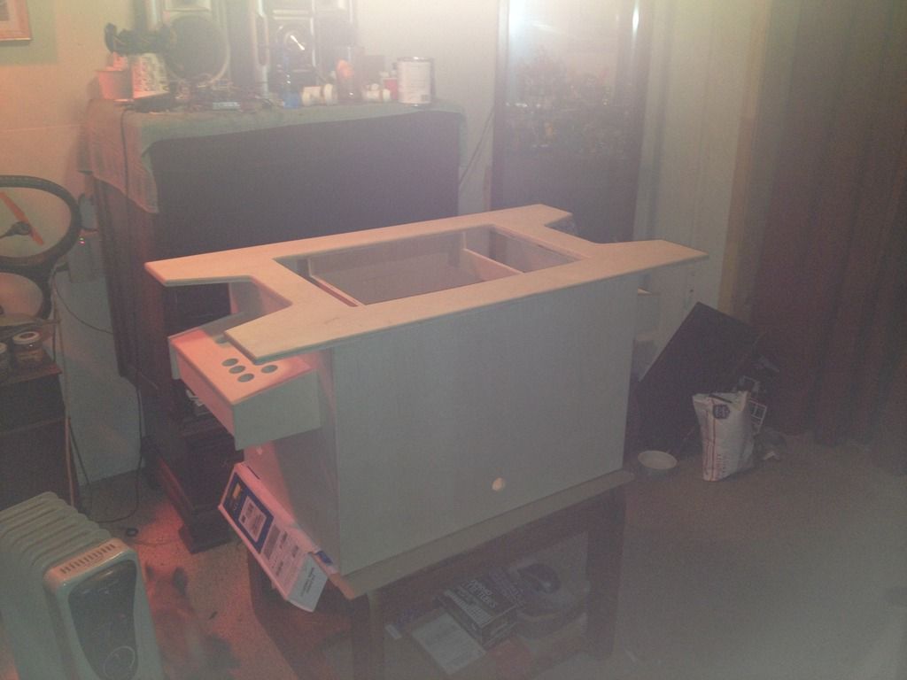

« Reply #48 on: January 02, 2016, 08:01:57 pm »
Built the cab today. Its not perfect but it should play well. I used 1/2 inch russian birch instead of the 3/4. It looks good and had a lil burl to it. We based all the measurements around the flat screen so it could be seen. comfortably. And built it tough enough for heirloom quality.
The flatscreen fits in a cradle then the top is put over it and alligned with some spacer scrap pieces so theres no wiggle. Also thought it would be eadier to get to the controls if the control box didnt have a bottom. Now they are easy to get to and the wires are fed through a 1 and 1/8 hole.
What would be the easiest way to mount the glass semi-permanent to permanently to the top? I plan on using 3/8 thick with a bevel.

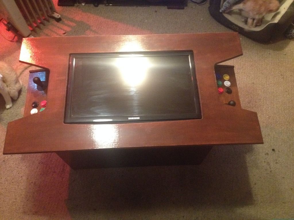

  Spent the day installing the buttons. The wires were way too short for a cocktail cabinet so i had to do some lengthening for the player 2 controls. Had to cut a corner off the sticks, the 1 and 2 player buttons were in the way.
So heres my set up.
Samsung 24 inch LED TV
Dell Optiplex 745 intel core 2 duo 2.6GHz 2GB RAM and 250GB HD
ATI Radeon HD 3450 XT 256MB PCIe graphics card
Go grove Sonaverse PC speakers with subwoofer
Generic S-video to HDMI converter
2 player Xin Mo mame arcade controls
I still need glass and could use a couple tips on attaching it to the table.
Is there an easy way to re-route the computers on off switch or make it come on automatically when power is applied. Like when i turn the surge protector on.

Well ive been sitting here playing with the controls after figuring it out. After some trouble I can play games now. For some reason in the controls menu i can put it on the menu caption for P1 right and hit the joystick right a hundred times but it would just put N/A or none. But eventually if i keep messing with it, it will show the correct direction.
   Also i just picked the glass off of top of my cab and everything is so hot!!! Especially the TV. Do i need to install some kind of exhaust fan or make some holes. Im afraid im gonna burn it up.
vwalbridge
  • Posts: 2082
« Reply #54 on: January 04, 2016, 11:53:20 pm »
Heat rises, so cocktails inherently suffer from this problem. And the glass just traps it all in right on the TV.
Most TVs have vent slots near the top edge for a reason.
If you don't have any exhaust, I'd think about putting some cold air intake vents near the bottom of the cab and some hot air exhaust fans near the top.
Not aesthetically pleasing but necessary for long gaming sessions. The bigger the fan, the slower it can spin so the quieter it will be. I hate hearing fan noise. Especially on an arcade machine.

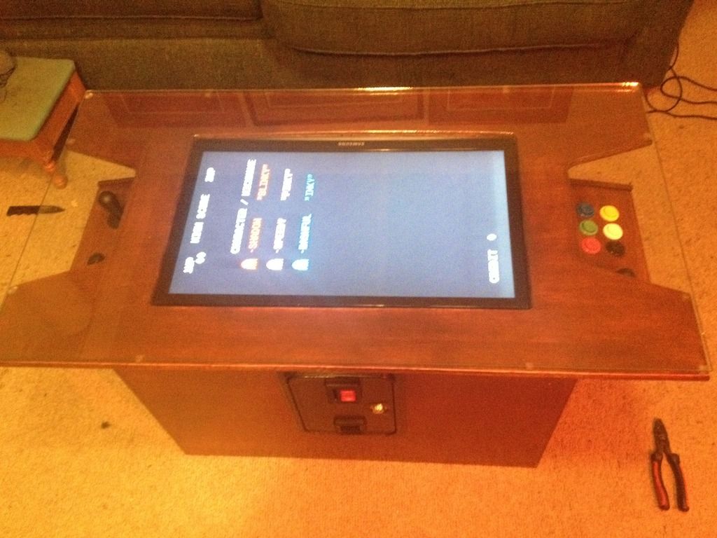

It got really hot!!!! So i want as much exhaust as i can get. They are about 23dba so thats not bad. Server coolers are much louder and that never bothered me much.
   Coin mech became necessary though. Dont want to Have to remove the lid and glass to get to the power button and keyboard and mouse.
Is there a way to configure mame to be able to change games and or exit a game using only the arcade controls?

   I actually did that on purpose to make it easier to move and remove the top. Gives me a lil rom to wiggle.
  I scratched some finish last night moving the glass and had to repair it today. With the heating problem, if i put bumpers under the glass that will allow some extra airflow to cool my LED screen once my fans come

« Reply #73 on: January 08, 2016, 09:24:45 pm »
Day-am!!! And thats 24/7???!!!
Was able to install both the fan bar and the coin mech. This fan is super quiet!!! It also has an on/off button which is pretty cool. Prolly gonna try to solder a limiter switch at some point or maybe hook up some kinda thermostat.
Heres a pic of the can with the coin mech installed.
