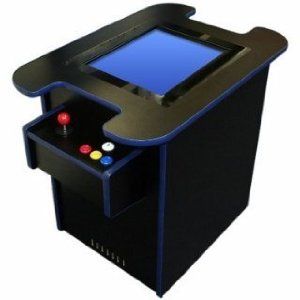

   Hi guys!! Im new to the forum here and new to building computers.
I would like to design and build my own cocktail cabinet arcade game. Ill be coming up with my own cabinet, im gonna say 3 1/2 to four foot long. My idea is to replace my coffee table with it. So i would like to add a drawer and would also like to make it juke box. Or at least make it able to upgrade to a juje box.
I can pretty much source everything but the brains. I looked at the "Read this First" and i would just like a level C platform so it will play some NES games like super mario, zelda, and such along with the classics like Pac-man.
Ive been looking for what the guide says but i am comming up short. Would yall mind helping locate an affordable brains system? Please?

By brains do you mean computer? Also not familiar with the term level C platform in this context, can you elaborate?
If you just away to play simple games (old consoles, some classics in Mame) then maybe a Raspberry Pi solution would suit, very small so easy to integrate into a build.

You don't want a raspberry pi. There is literally not a worse choice you can make. Anyone who suggests you use that is either trolling you, has no idea what they are talking about or are trying to justify the fact that they ruined a project with one by pretending it isn't terrible.
Also, making it super short and sitting on the floor to play doesn't work. The viewing angle won't be right. Also if space is actually an issue than you should be building a cabaret cabinet and not a cocktail.
Finally, most people vastly overestimate how much space an arcade game takes up. A normal arcade game has about the same footprint as those end tables next to your couch.

I guess what i mean is an elaborate coffee table. I definitely have the room for what i want to build.
Thanks for the tip on the raspberry pi. So now im just looking for a cheap used tower.

Ok i plan on using a 20 inch flatscreen pc monitor. The cabinet only has to be a couple inches wider than the screen on the long sides. It wont be 4ft long but maybe about 3 to 3 1/2 feet long. And you were right about playing it on the floor but at the height of my curent table you could sit on the couch and play and still see the screen area.
What do you think?

I think you should attach the monitor to a board with a hinge so you can flip up the screen and play console games from the couch.  Also,  be sure you get a monitor that allows you to see the picture from various angles.

Regardless of how cheap it is, I believe the Pi is something that should only be considered in a build if space is a premium. (ie, NES, gamegear, coleco tabletop, micro arcade, etc)
Otherwise, I think it should be avoided because the cost of small, fan-less Windows-based machines are getting very competitive.
If space is not a concern, I can't think of any reason I'd choose a Pi over a Windows computer.

I wouldn't put a Pi in it either.
This dude has some cheapy computers for sale if your looking: http://forum.arcadecontrols.com/index.php/topic,133968.0.html
Or you could always hunt up an HP Slimline or similar pretty cheap on eBay.
If your trying to minimize space, buy a mini ITX board and small form factor power supply. Pair it up with a low wattage CPU. It's MAME, no need for an 8 core 125 watt CPU.
For graphics a GT 730 makes an excellent choice in price, performance, and dead silence since it uses no fan. Or, if you don't want a card sticking out, any of the AMD AM1 series boards with integrated graphics works well. Cheap too.

I'm no stranger to arduino but from what I can see of the Pi there would still be extra I would have to buy to run it. If I buy a used widows PC though I get almost everything need at once for the same price as the Pi.
Let's go ahead drop what I said about how much space I have.
I would like to have the whole top as one sheet of tempered glass or acrylic with a lid to go o even that so I can still use it as my table without hurting the cabinet. Being able to tilt the screen is a good move but I still have a tv and game consoles.
This is ,ore like a "have nothing better to do with my time kinda project". Something to do for fun. And you would be surprised at how much I can stuff into a small space. Thank you 90's pc game 3D Tetris.
I would also like to add a coule 6x9's and a 10inch woofer for jukebox mode and stereo sound for gaming. Is there a way to do that with a PC Card or will I need to buy an amp and stuff?

You'd need an amp to drive a 10" sub but I'd also be concerned about having a speaker of that size so close to all the other components if it ends up being a tight fit.
Having a glass top was one of the main criteria of my table arcade build:- http://forum.arcadecontrols.com/index.php/topic,148135.0.html
So far I've had no issues with viewing angles, but the panel I used whilst old was pretty good.
Do not use acrylic. You will thank me us later.
You definitely need an amp.

Yea tempered glass is my first choice. I've used acrylic before on a lizard cage and it sucked!!!!
Aluminum is pretty cheap and makes a perfect shield to ban magnetic waves.

Talk to me about monitors and orientation. The cabinet I'm building will be a 2 player machine made like a regular cocktail cabinet. can wide screen monitors he used? Is there a way to set up orientation so it plays like a classic 2 player cocktail table? How does all that work?

What is a "regular cocktail cabinet" to you?  To me it's ms pacman, but I don't think the players can face each other from 4 feet away and still see the game properly.  Are you thinking Asteroids? Maybe q-bert?
Cocktail games can be flipped in MAME just like they do at a restaurant.
Why would you want a 16 x 9 monitor for something that is going to get 4:3 usage?

Yes like a ms paceman cabinet.
I'm down to 3foot and a 20 inch screen

Heres what im going after except the conyrolls being completely under the glass and not so high
paigeoliver
  • Posts: 10994
  • Awesome face!
Re: Another newb wants to build a cocktail cabinet
« Reply #26 on: November 13, 2015, 10:23:58 pm »
That one is missing the glass entirely.
Duhjoker
  • Posts: 168
  • Last login:August 29, 2016, 08:03:00 pm
« Reply #27 on: November 21, 2015, 04:11:45 pm »
No the one pictured has no glass but mine will. I was just showing a reference pic of the type of machine i would like to build.
