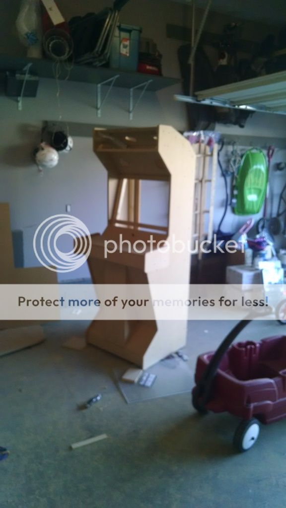

Sawdust!
« Last Edit: November 30, 2015, 02:06:06 am by Frank Drebin »

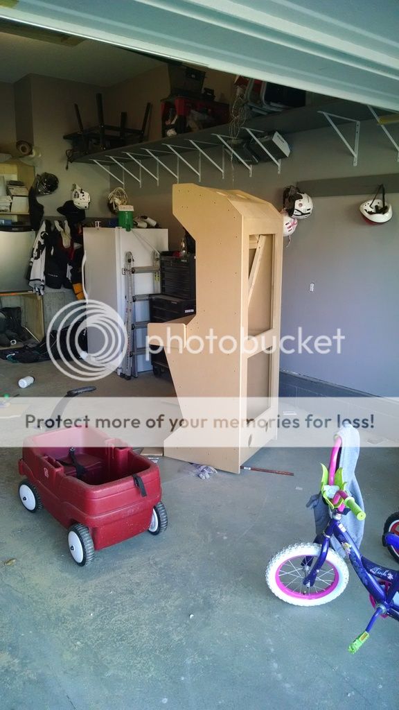

« Reply #19 on: September 30, 2015, 11:06:19 pm »
« Last Edit: November 30, 2015, 02:06:20 am by Frank Drebin »

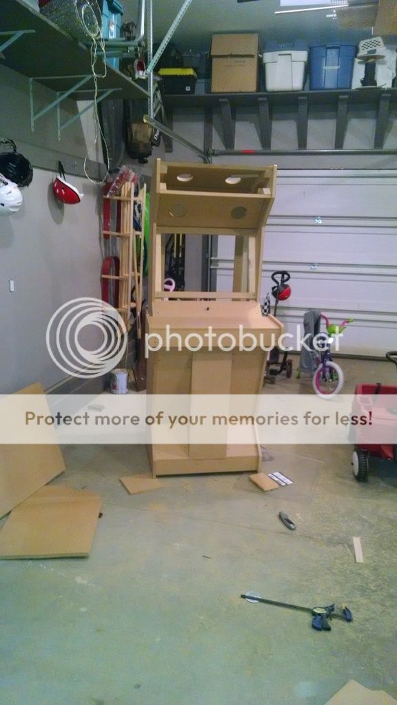

« Reply #23 on: October 04, 2015, 04:42:31 pm »
« Last Edit: November 30, 2015, 02:06:44 am by Frank Drebin »
Re: Stand up build - "The Mongrel"
« Reply #24 on: October 04, 2015, 05:14:23 pm »
That first photo reminds me of a ferret standing upright.

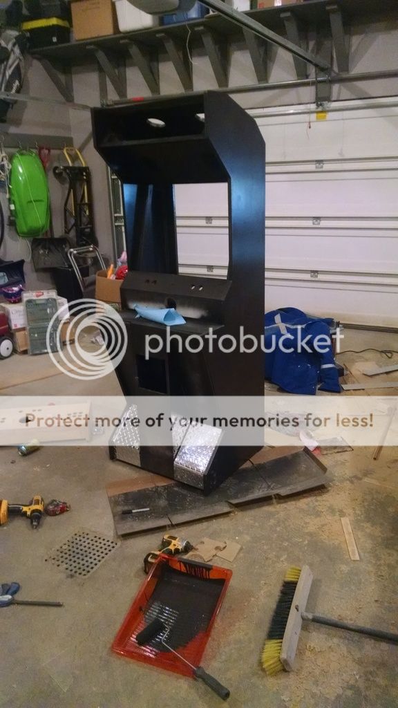

« Reply #33 on: October 16, 2015, 04:25:19 pm »
Got the control panel fitted together, getting close to priming stage, just the doors and the front piece left, and of course the rounding of a few pieces and t molding slot cuts.

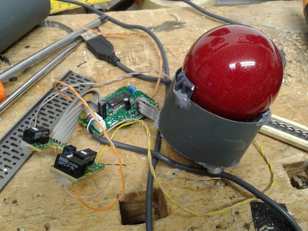

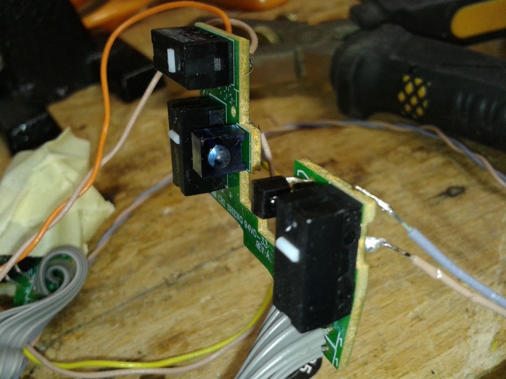

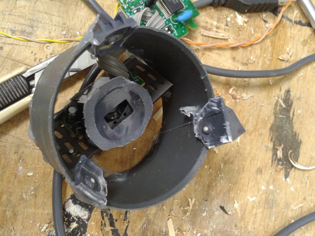

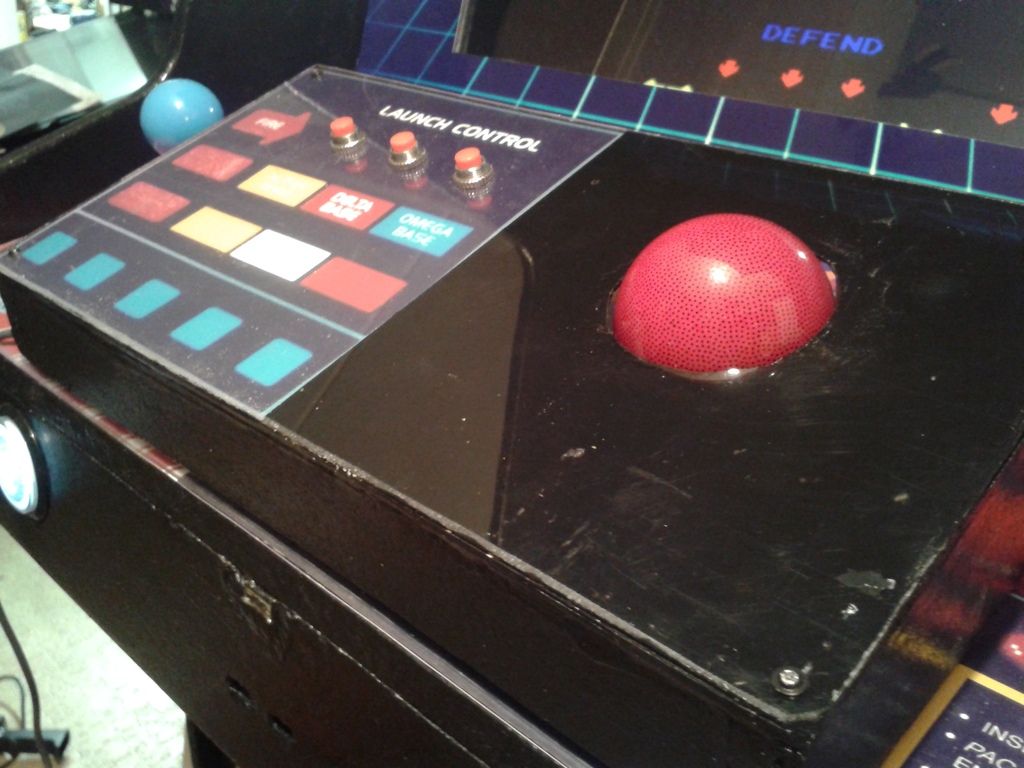

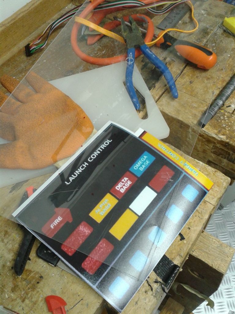

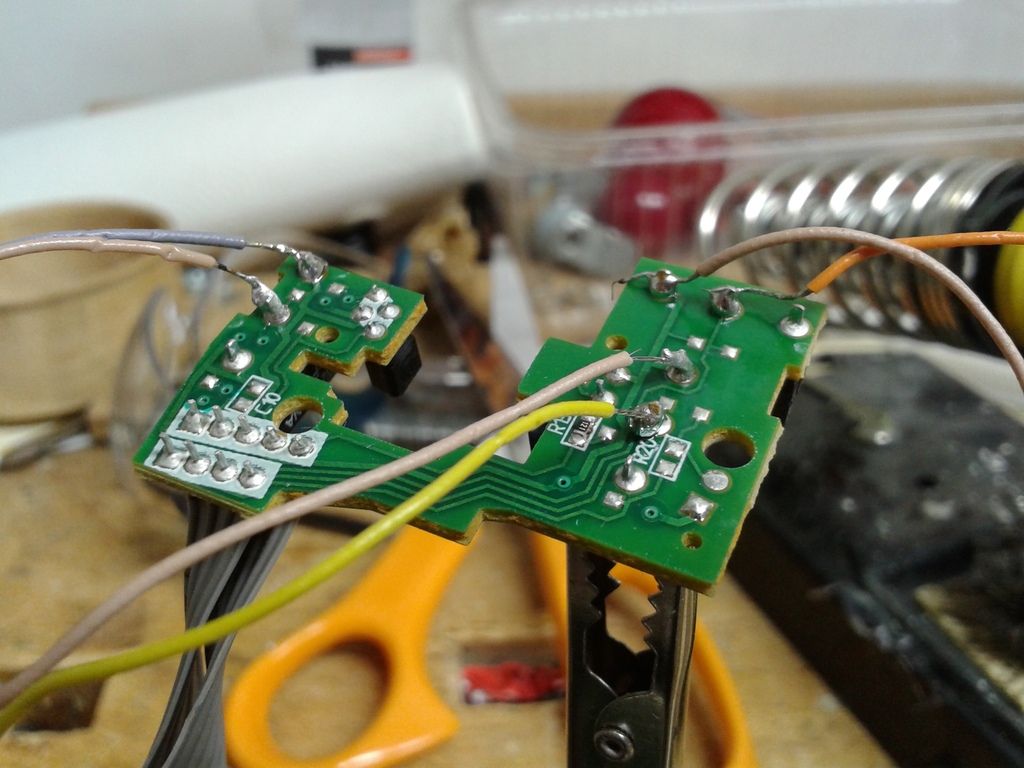

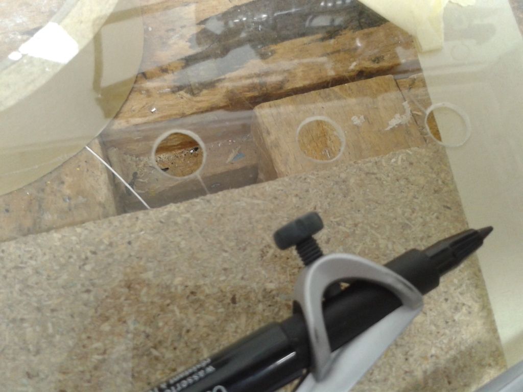

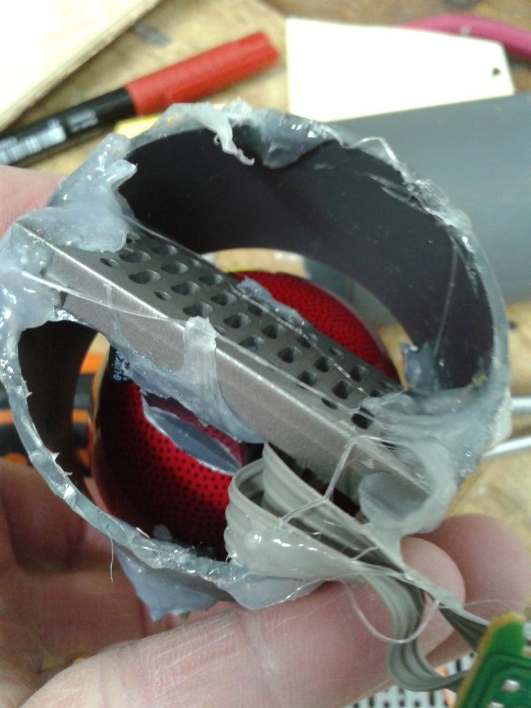

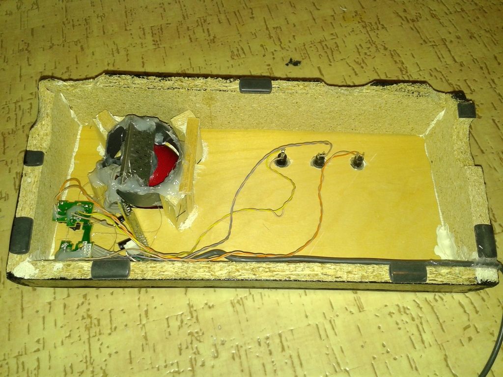

Control panel question:
Was planning on putting a spinner at the top similar to Knievels control panel, and having 2 leaf buttons (as my RGB's have microswitch) beside for rapid fire games such as track and field  (either mapped to mouse left/right or duplicates of P1 button 1/2) .  Are two buttons enough for most rapid fire games?
Frank Drebin
  • Posts: 263

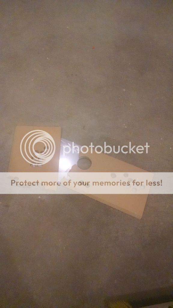

« Reply #38 on: October 27, 2015, 10:37:13 am »

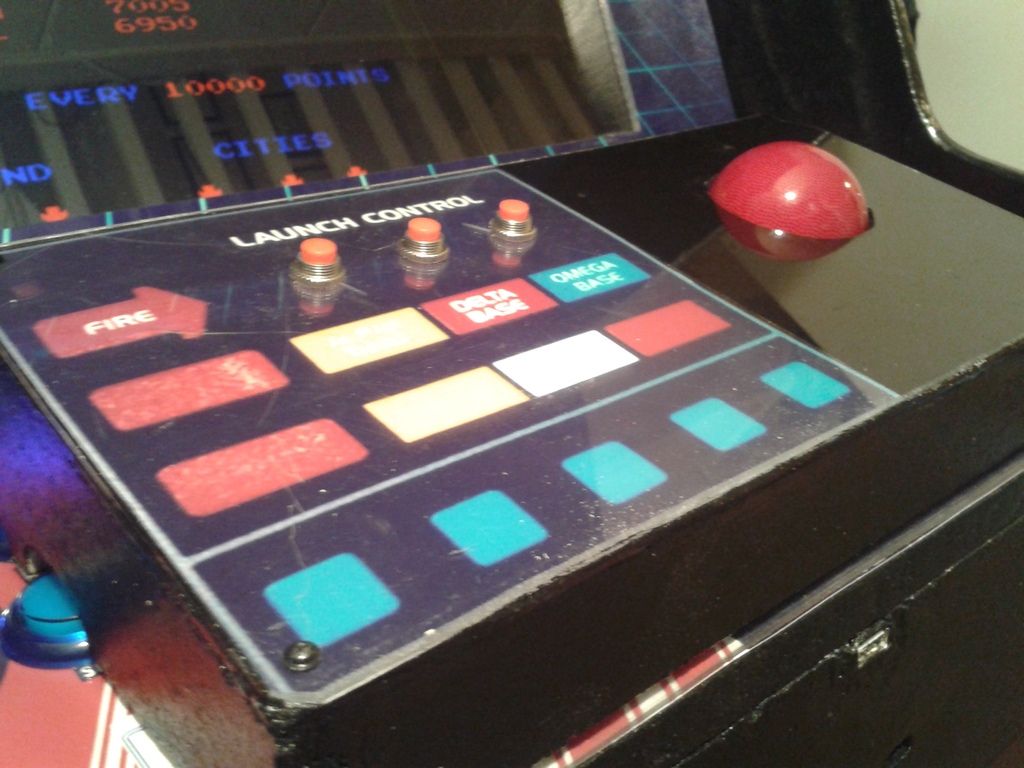

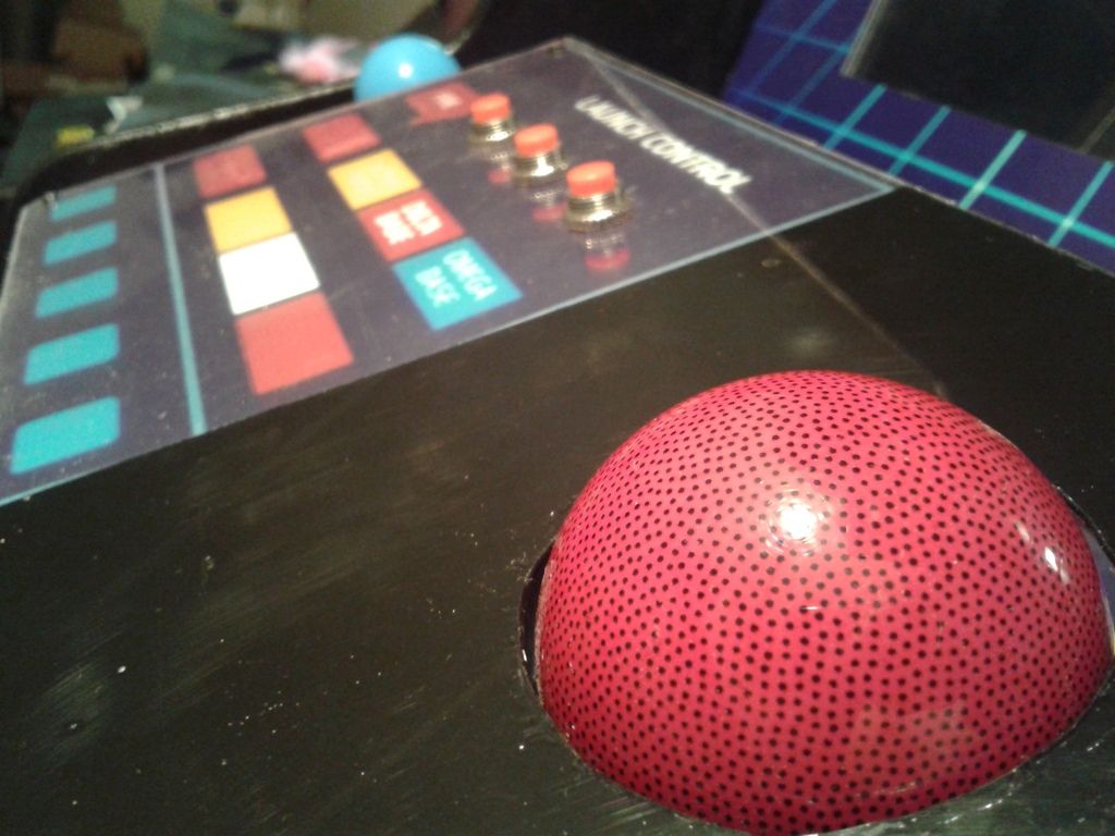

Got some work done on the control panel last night.
(I need a bottom bearing bit)
On the positive side, I'm making Hyperspin my bi%$#.

Frank Drebin
  • Posts: 263
« Reply #39 on: October 31, 2015, 02:51:08 pm »

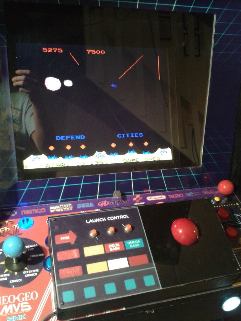

Ready to bring downstairs and throw some vinyl on.
