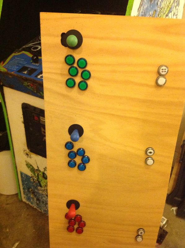

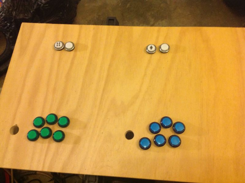

Here is my quick mockup of the control panel:

You don't need 6 buttons for P3 and P4 if you're going straight MAME.
Cobolisdead
  • Posts: 594
Re: My First MAME Cab Build!
« Reply #3 on: October 14, 2014, 04:00:08 pm »
Yeah, it's more of a symmetry thing than a control requirement.

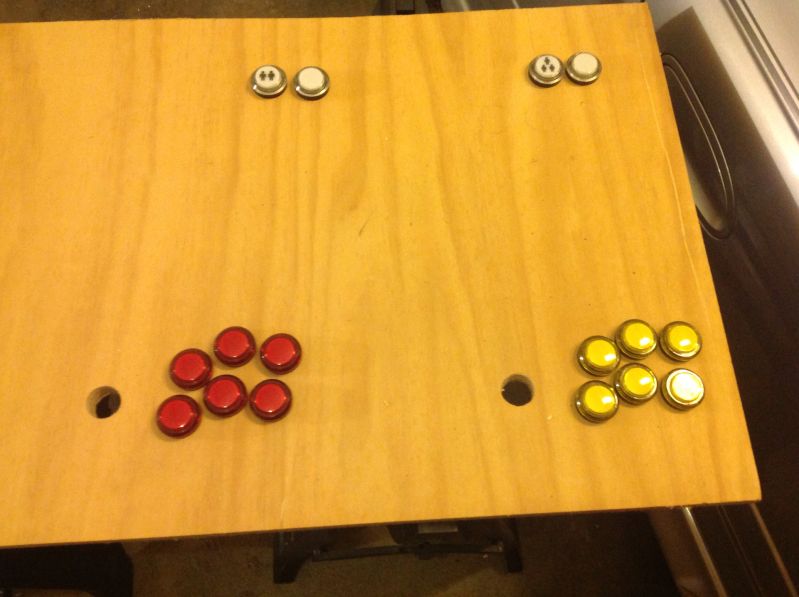

Slightly modified the red controls of player three to be symmetrical with Player four.

Ill jump in since I dont know wtf Im talking about Yots.
I would think angled P3/4 would be better for comfort.  Think of it as a mirror rather than symmetrical.  I'd hate to be P4, either standing crooked or "over-reaching" with my left arm.  Perhaps you could keep the same angle as the CP.  Just remember to keep the joysticks putting up to the screen.  Don't angle those.
**Sigh**. I was going to post some comments, but I remembered my resolution since "The Kaneda Incident" to stop getting involved in 4 Player Cab layouts, so I'm going to gracefully bow out of this one. Good luck with your build.
Hey, I am a noob at this, so please post whatever you feel about it. I am very appreciative of all the info I can get on this.  And this is the planning stage for this control panel, so feedback is greatly appreciated and will be factored in.
so something like this?

« Reply #11 on: October 15, 2014, 02:26:56 pm »
Yes.
I would also suggest grabbing a large piece of cardboard and testing it out from all 4 positions.  An old refrigerator box is perfect to cut to size and play with.
Whats the story with the buttons at the top?  What all are you planning to emulate?

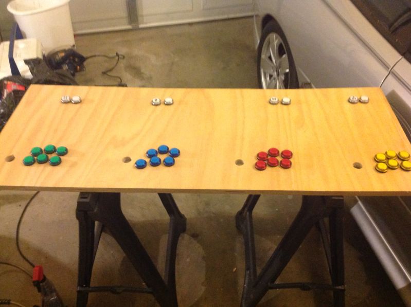

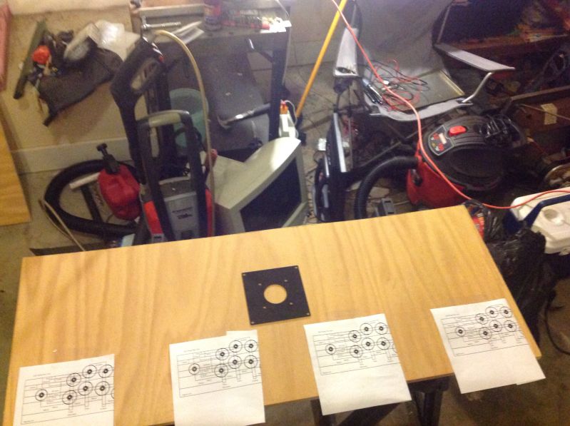

« Reply #25 on: November 24, 2014, 08:48:14 pm »

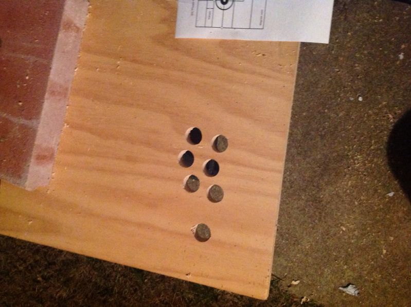

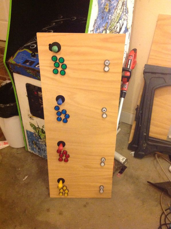

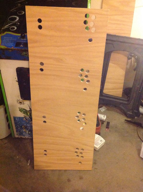

After a long time off due to life having things pop up, I am finally getting back on this project. I decided to change my layout a little bit to simplify the design since i am still a wood working novice.  I started off by removing a good third of the depth from this piece of plywood.
Then I laid down my templates, and taped them down to where I wanted them to be.
Then I started by drilling the holes for player 4.
I did fairly well, but my templates got tore up, and I messed up the spacing a little bit for player 1. :(
Still, it looks like it should be pretty awesome layout once it is up and running.

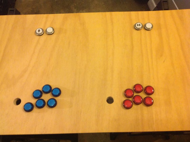

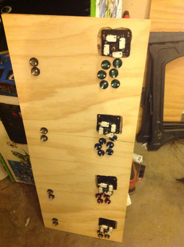

Well, I still need to do some work for the joysticks to get them to properly mount. However, here are some pics with the buttons in!
Looking at it here, you can definitely see where the spacing ont he bottom row got shifted over to the left. It actually still works well though so I will probably keep it for now.

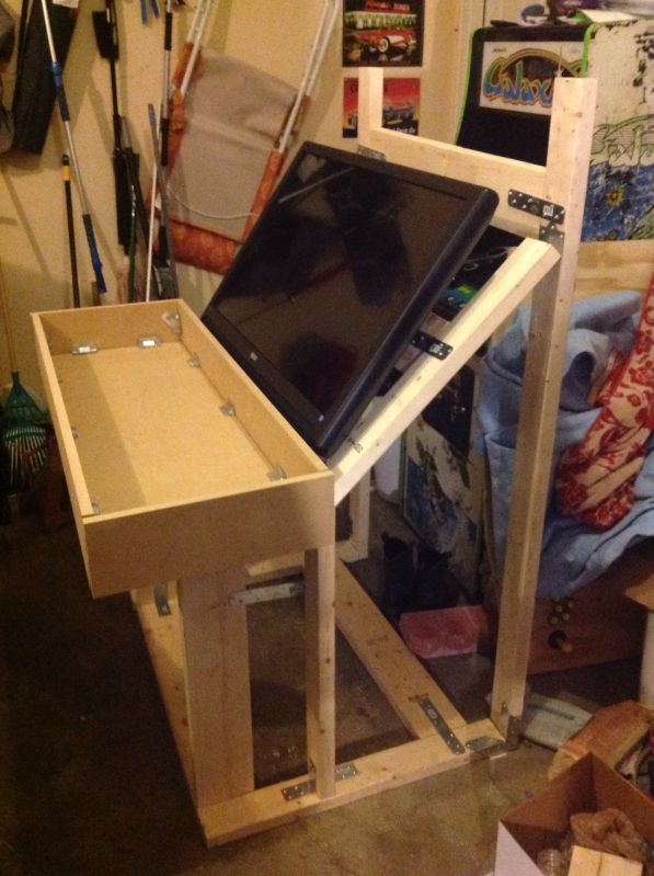

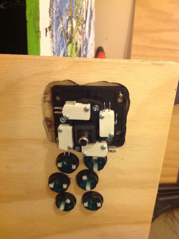

So, is there a special technique to route the bottom of the control panel to get the joysticks to install properly? I tried searching for videos on it, but my Google Fu is weak today it seems.
« Reply #28 on: November 25, 2014, 05:17:21 pm »
http://www.slagcoin.com/joystick/mounting_layering.html
This site should have all you need. Though it doesn't spoon feed the masses with a video, it has descriptions and diagrams for practically all CP installation needs.

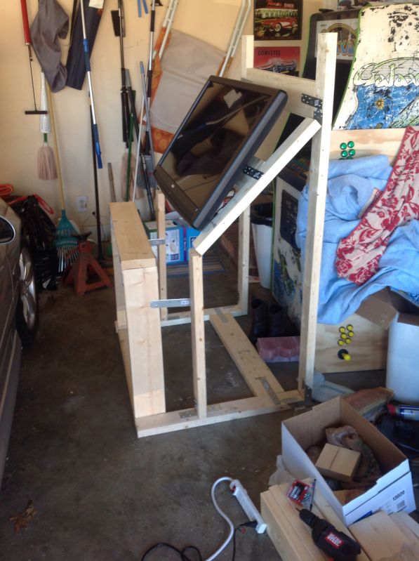

Anyone have a any recommendations for a bit for my router? I got one months ago, but I didn't get a bit for it. I need to make a quick run to lowes to get one.

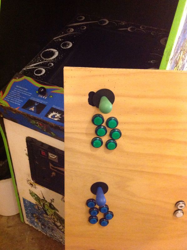

ekk! are those joystick holes too close to the buttons? I'm thinking the joystick body will be touching or overlapping the button mounts.

Well, I test fitted the joysticks, and they seem to work just fine as far as spacing goes for players 2 -4. Now since Player 1 is off, it might be a bit closer than I would like.

« Reply #32 on: November 25, 2014, 11:03:19 pm »
Well, I had some measure of success tonight mixed in with some failure. For my first time using a router, I think that I did quite well. Unfortunately, the router did not do so well. It got all the way through to the last joystick, and within three seconds of making a weird noise like it was caught on some wood, it broke through the wood as the bit came flying off! :( Fortunately it didn't hurt me or do too much damage to the control panel. Here are the pics of the control panel with everything assembled on it.
I think that this is still salvageable, but now I am definitely going to need to put some sort of layer on top of it.  Also, I still need to work on the joystick spacers a little bit more as they don't want to hit the microswitches when the control panel is turned right side up.

if you have a holse saw, a leftover plug can be glued in there, then bondo and sanding to fill the "oops" caused by the bit.  Otherwise, fiberglass and epoxy, although a new section of wood might be cheaper, although you will probably end up needing the bondo to smooth the top out anyway.

I might try to bondo it if I get some free time this weekend. I might be able to do Friday since I won't be shopping this year.

Between the mishap on P4 and the weird button layout on P1 I'd think about chucking it out and starting again.  Not trying to insult you but the effort in fixing what you have now probably won't be worth the result.  Just my 2 cents.  Cool project!

Yeah, I thought about doing that too. Might just end up doing that and using the first one as a template, minus player one of course. :)

You could do that, or use the printouts from slagcoin again but this time use a smaller drill bit to mark the center of the cutouts instead of going right in with the spade bit.  Once the center pilot holes are marked you can throw the paper away and drill with the spade.  I'm assuming thats what happened is that the spade bit caught your printout before you had a chance to drill them all out?

« Reply #38 on: November 26, 2014, 04:02:09 pm »
Or use it for routing practice, since it's your first go at using a router. :cheers:

« Reply #39 on: November 26, 2014, 05:44:14 pm »
Yup. It ripped the template away from the tape and tore it to pieces. The next two I ended up drilling pilot holes in the center of and removing the paper, exactly like you just said.
Now that is a great idea! I could use it for practice when I attempt to cut the groove for the T-molding.

Okay. I have the the new panel constructed. The curve didn't go as smoothly as I had hoped, but everything else went well. As soon as my iPad stops being finicky, I will post some pics!

Ok, trying to attach the pics. Let's see how this goes.

« Reply #55 on: December 03, 2014, 11:21:10 pm »
Is that photo flipped? Or are you left handed?  :dizzy:
Cobolisdead
  • Posts: 594
« Reply #56 on: December 03, 2014, 11:27:02 pm »
I play left handed.
« Reply #57 on: December 03, 2014, 11:40:34 pm »
And so will the other three people.  :cheers:

Ever think about flipping P2 and P4 to a normal right handed layout?  You could have a truly symmetrical CP with some right handers for others.
« Reply #59 on: December 04, 2014, 12:40:47 am »
Or leave yourself with a slight advantage   :burgerking:
While I get your idea behind that, I'd rather see him leave it as is than have some one way and others the other way. That just never looks right.

« Reply #61 on: December 04, 2014, 02:48:31 am »
I may be mistaken, I've never seen a left handed arcade .. Surely you've placed the buttons on the wrong side? Take all the buttons out and flip the board over and place them back in - it's just natural to wiggle with lefty and mash with righty 😜

« Reply #62 on: December 04, 2014, 03:16:19 am »
Well, as soon as i take some pictures you can see a second one.  I've a moon-cresta panel going onto a gutted Carnival cab.  Instead of bodging the panel up with welding and redrilling, i'm putting a joystick into the old fire button hole, and going with a 2 button cab.  The girl-child is left-handed.
The joy of this hobby is that you can make what you like.  Lefty away.

« Reply #63 on: December 04, 2014, 08:44:34 am »
In actuality, I didn't intend on setting it up for left handed play, I just forgot to flip the dang thing over last night before I routed out the joysticks, and didn't even catch it until you said something about it. That is what I get for hurrying and trying to get it finished before the fiance got home. Sadly, since I didn't catch it until after I routed it, that means that there is no way to salvage this piece. I might just leave it that way and use it, but I am thinking of starting over yet again.  I will have to go get some more wood/MDF though, as that was my last piece.  :badmood:
I will look into Batten and see if I can find one. That "curve" didn't do too bad, but it wasn't what I was hoping for. I just had some difficulties following my lines with my saw.

I cant figure out how 3 buttons for player 1 and 3 buttons for player 4 isn't symmetrical.   :dunno
Just a guess here, but my wife sounds like she is a lot like his...symmetry might not be the right word for it.  Consistency might be better, as in "Why do two of the players only get 3 buttons?  That looks dumb they should all have the same amount".
Then you say "Honey, it's because there are no games in MAME that use the extra three buttons. At $5 a button, that saves US $30!" (she doesn't have to know buttons don't cost $5)  :cheers:
Cobolisdead
  • Posts: 594
« Reply #74 on: December 04, 2014, 01:50:34 pm »
Keep in mind the plain and bland rectangle makes it a lot easier to line up the player 3/1 and 2/4 sticks for games like 2 player Smash TV.
On my X-men Cabinet i went retangle to play off the the original design.
Also i play alot of smash TV. Consider how much room you have, like when you stack 4 people around the cabinet where are they going to stand.
Placement is key.
Other things to consider how often you will be using players 3 and 4, If you not going to be using a ton consider making the CP smaller so it doesn't look like a giant spolier on your cabinet. Unless you have a wide cabinet, to go with.
How well does your X-men cab play with 4 people? As an aside, that is one awesome cabinet!
Those are great things to consider.  I started out doing the 4 across in a a line with the trackball above it, because it gives enough room for people of my size to squeeze in rather than try to be at an angle.
As far as the width goes, the cabinet is going to be fairly large too. Probably around 36"-38" to accommodate for the display. I Imagine that the CP might not stick out that much, if at all.
Exactly. I know that they are useless buttons, and she does too, but it just looks better to her with the 6 on all of them. I am making a quick edit of the pic to show her what it would look like with just 4. Maybe she will like that, and I can save drilling 4 more holes. (Already have the buttons though. :) ) Also, I thought there was at least one that uses 4 buttons.

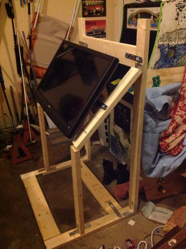

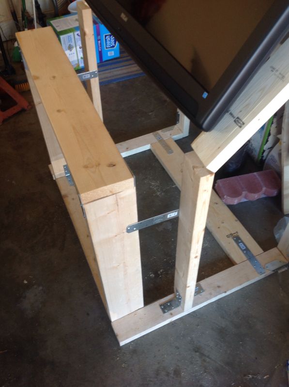

So I got some work done today with some help from my cousin who was visiting, and I think it is coming along nicely!
So far, it is just structure, but it is sound. Here take a look, and let me know what you guys think:
I still need to work on the control panel and mount it to the box, attach the Marquee support, as well as put on the MDF casing.

Hundreds of views, but no comments. I must really be doing something different or extremely wrong. lol!  :lol
EMDB
  • Posts: 865
  • Project RetroCade
« Reply #88 on: January 28, 2015, 12:52:15 pm »
Okay:
Your CP seems too low but it is hard to see on your pictures.
Most CPs are angled a bit. Yours is not.
The TV seems a bit (too) low too. Put a keyboard on top of the CP or even better inside to get the same height as the top of the CP, connect a PC to the monitor and play some MAME to get a feeling of the heights / angles.
« Reply #89 on: January 28, 2015, 02:16:30 pm »
This is the cab where the girlfriend dictated the amount of buttons, right? Did you ask her?  >:D
Joke! Joke! I agree with EMDB's comments.
Cobolisdead
  • Posts: 594
« Reply #90 on: January 28, 2015, 03:06:04 pm »
:) She rather likes it, also she has been upgraded to wife status now.   :cheers:
Okay:
Yeah, it's not angled, but I didn't trust myself to make that kind of cut correctly, so I made the box flat. I figured that I could always go back and build a new box f I need to later on if that becomes a problem. As for the control panel height, it is the same height that the TMNT/Simpsons/Xmen 4 player control panels were at, and I will be adding casters to the bottom so that will raise it up a couple inches even higher. Its not really at a bad height at the moment. I will try out the PC in the mount like you suggested, and see how well the height works. I could use some more arcade construction time after the week that I have had.

Here's some advice you probably don't want:
0. Buy a router, and at least a flush trim bit.  NEVER use a jigsaw for cuts you want to be straight.
1. Design and cut your side panels FIRST.  STOP what you are doing now, start over, and do the panels FIRST
2. AFTER you have the panels cut, cut the rest of the panels.  Use a router or a circular saw (or table saw) and use a guide/rail.
3. Attach your batons to your side panels, affix the remaining panels, paint
4. Mount your TV
5. Mount all other peripherals
6. Make your CP last.  LAST.  DO IT LAST.  Don't do it first.  When do you do it?  LAST.
7. Attach the CP, put the final touches on construction.
There are plenty of great and not so great builds on this site.  Ask yourself if you want something great in your house.  If you do: take others' good advice and follow other good builds.  If you don't: just wing it.
Cheers!
