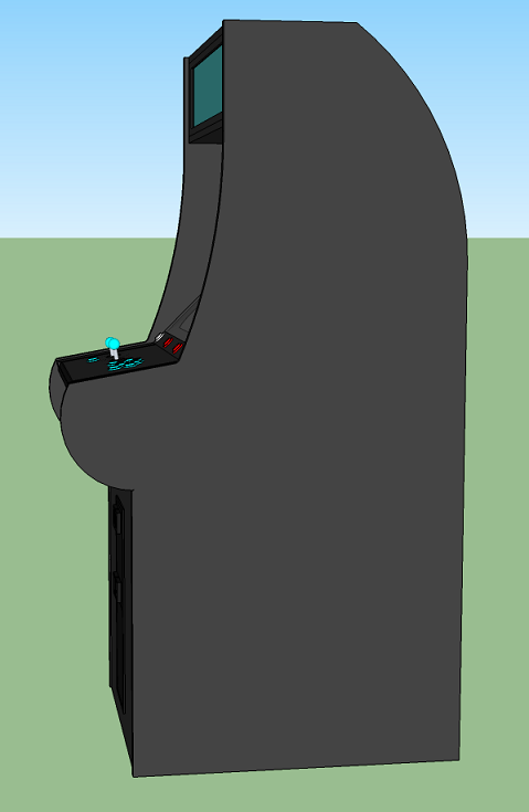

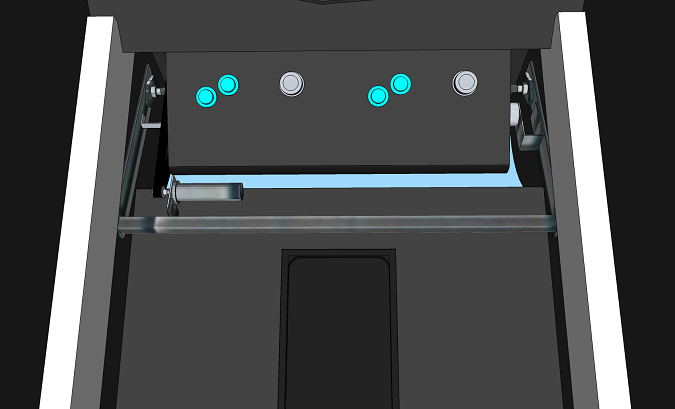

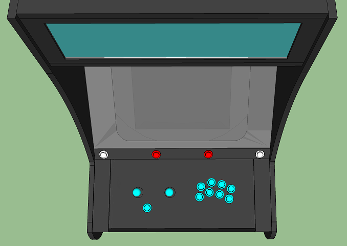

I've taken some pics of how the CP unit sits in the cab, to give a better idea of overall look.  Yes, it does move the monitor back/up a little, but I don't think its too far. I've tried to minimise the boxy look by having a circular front plate to cover the hidden control panels (missing in these pics).
As you can see from the top view, there is a static 6cm ledge each side of the rotating unit. I am planning on hiding this "join" somewhat with strategically placed artwork, or I may put El wire along the sides where the joins are so that they illuminate the plexi on the CP top.  I ideally wanted the whole width to rotate, but this is the trade off (either this or as you say, add width to the cabinet).
Here you can see how the unit sits in the cab. The steel frame will be mounted at an angle so that the front/bottom panel of the cab (with the coin door) doesn't stick out too much.  I actually think I'll probably end up mounting the top 6mm ledges on each side of the panels to the steel frame itself, so the whole thing is then one unit that can easily be taken out in one piece.
Here's a shot of inside the cab, you can kind of see the angle the steel frame is mounted at, with enough room still for the coin mechs/door.
Finally here's a side on profile so you can see how compact I'm trying to keep it.

Typically you will need to have enough space between the cp and monitor for the panels swing.
In my opinion, it makes for a goofy looking cabinet because of that space
I had this problem as well, it looked like everything would work on paper but when I built it, I needed that extra space under the monitor for clearance.
Yeah I'm concerned about this also.  I've tried as much as possible to prevent this from happening too much in the design...
There is just enough clearance for the rotating CP unit in the current design.  Hopefully I won't need to make too many modifications as I don't think it sits too badly at the moment.
Just waiting on a few more parts to turn up then will start building!

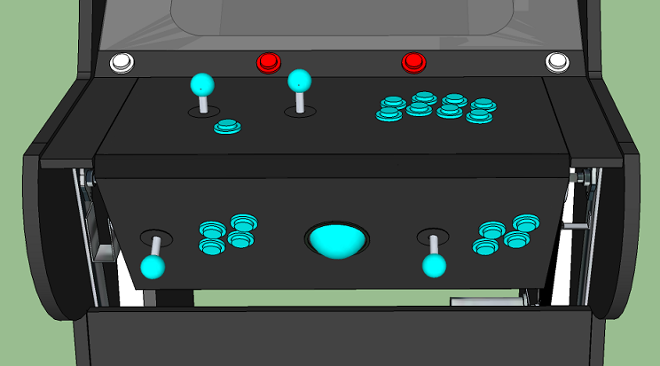

Been trying to finalise the 3 control panels these last few days, and I'm settling on the following: -
  • Dedicated 1-Player panel
  • Centralised playing stance for all single player games
  • 4-way ball-top leaf joystick with dedicated Defender reverse button
  • 8-way Suzo System 500 stick (my fave stick for shmups)
  • 8 Buttons - Mostly I'll be playing MAME games, but I figure having 8 will help with other emulators - rather too many than not enough.
  • Dedicated 2-Player panel
  • 2 x GGG Dominux8 leaf switch joysticks
  • 4 buttons each player (never used more than that)
  • Plenty space between players for comfort (plus the I-PAC Ultimate is going to sit between them under the panel)
  • This will also be my Robotron panel
  • Dedicated "Other games" panel :)
  • Ultimarc U-Trak trackball
  • 2 x TT2 spinners for spinner and driving games
  • 2 x buttons per player for spinner/driving games
  • Dedicated Asteroids setup (another fave game in our house)
  • I will be playing ScummVM games on this panel with the trackball
I'm virtually sold on GGGs Electric Ice buttons with RGB LEDs, and also the Dominux8 joysticks for the 2-player panel (mainly for Robotron).
I realise this is going to cost a fair bit! ;)  I do have some of the controls already though, collected over the years.
OK... on to the theme.  After finding the kind of logo-look I wanted online, a kind friend of mine tweaked it as a concept for my logo/theme... in rough idea form here it is : -
The word "ARCADE" would be going in the blue bar at the bottom.
Needs a bit of work/tweaking etc... but as a concept I like it :)
Feedback/criticism/ideas welcome as always.

I'd put 6 buttons each on the two player panel for fighting games.

Yeah if you're going to all that trouble then you may as well do 6 buttons for the fighters.

For the dedicated 1 player panel, I'd kill the 8-way stuff right off the bat.  It's kind of redundant when you already have it in your 2 player panel.  In my opinion, most 8-way games are "usually" on the left side anyway in the actual arcades (2 players, Character is usually on the left etc).
I think that panel would best be served as a dedicated 4 way panel instead, with the 4 way joystick centered.  Most 4 way games were 1 player at a time (2 players usually switch positions when it's their turn).  Plus playing Pacman games will feel more natural then being on the side.

I'll give it a go... going to be tight for space between P1 and P2 underneath the panel as that's the only space I really have for the IPAC ultimate.  Agree though, if I can make them fit I should.  :cheers:
Thanks for the feedback.  I think I'm still going to keep the 8-way, because I really love the stick I've chosen, it's very nice for shootemups with a short nicely defined throw.  However you've convinced me to swap the positions of the 4-way and 8-way so the 4-way is now in the centre. :cheers:

I finally received my GGG order at last and I want to get the 3 control panels finalised before I go any further (i.e. drilling)...
Top Panel
  • 2 x TT2 Spinners, plays 1P and 2P driving/spinner games
  • U360 joystick for analog/special games (sinistar/q*bert/etc)
  • 4 x Electric ICE leaf-switch LED buttons
Middle Panel
  • Single Player 4-way dedicated panel
  • Pac Pro leaf-switch 4-way in centre
  • 4 x Electric ICE leaf-switch LED buttons each side (ambidextrous layout [mainly for the wife])
  • 2 x Electric ICE leaf-switch LED buttons as "thumb" buttons (e.g. for defender)
  • Buttons can be used for asteroids etc (RL, RR on the left, Thrust, Fire on right, hyperspace in middle)
Bottom Panel
  • 2 x GGG Dominux8 8-ways
  • 4 x Electric ICE leaf-switch LED buttons each player (we don't really play fighters, plus see note about space below)
  • U-Trak LED trackball in center
  • Can be used for C64, Amiga ScummVM games (using trackball as mouse)
  • Robotron - obviously :)
Some interesting restrictions on the layout... space under the panel is TIGHT.  Trying to get everything to fit without overlapping when the panels are wrapped round together has been challenging!  Also, the joysticks are all in the middle of the panels (vertically) because they need to be else they'll stick up too much preventing the unit from rotating.  So far, everything fits... just... by a few mm. :)
I've tried to keep it simple, but allowing maximum flexibility, but suggestions welcome before I start drilling.  Pleeease tell me if I've missed something major, because I've been staring at it for a while now and I might not be able to see the wood from the trees. :)
