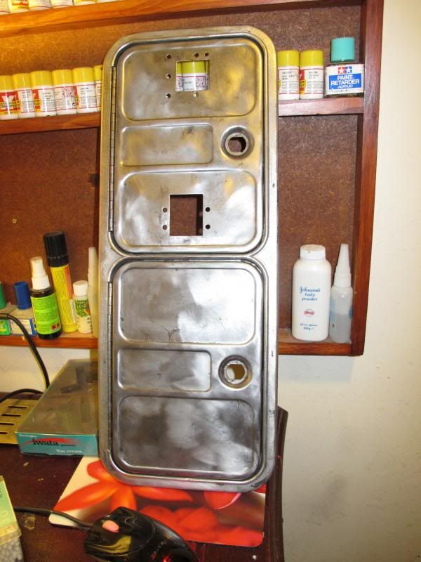

Bought a coin door off a popular auction site for £30 came with a C120 coin mech, which was nice. What wasn't nice was the rust. It was covered in it. And a lot of the paint had lifted. So I Stripped it with paint stripper. Which kinda worked. The paint was very resistant and took a lot of wire brushing, sanding and scraping to get back to bare metal.
This is where I am at
More soon :)

Hi, what kind of paint stripper did you use? Bought a used coin door myself, and its rusty as hell.

"Hi, what kind of paint stripper did you use? Bought a used coin door myself, and its rusty as hell."
Hi. I used Nitromors. It's probably as aggressive as you can get. It's evil stuff btw. Don't get any on your skin! (google it). I also used Kurust on the rust I couldnt wire brush off before I primed and painted it. I bought kurust from an auto shop. It's white. You brush it on the rust and the rust turns black.

Thanks, I got the paint off, started to sand the rust but it will take ages so im going for some rust remover
