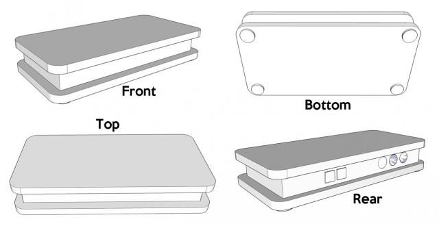

Here's a couple of "blueprint/design" images I put together in Google Sketchup and Adobe Indesign.

looks nice

i hate poeple who know how to use sketchup.....looks good man...

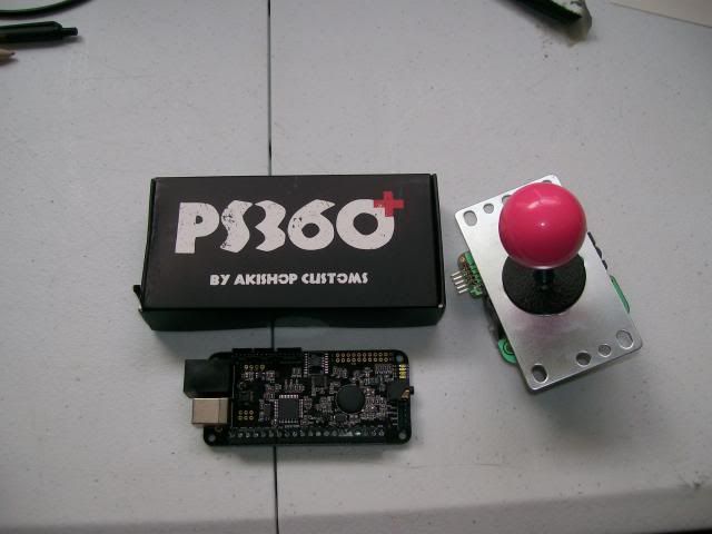

JLF Joystick and the PS360 PCB board. This thing is slick. The Joystick balltop will be replaced with a dark blue bat top. I don't care for balltops.

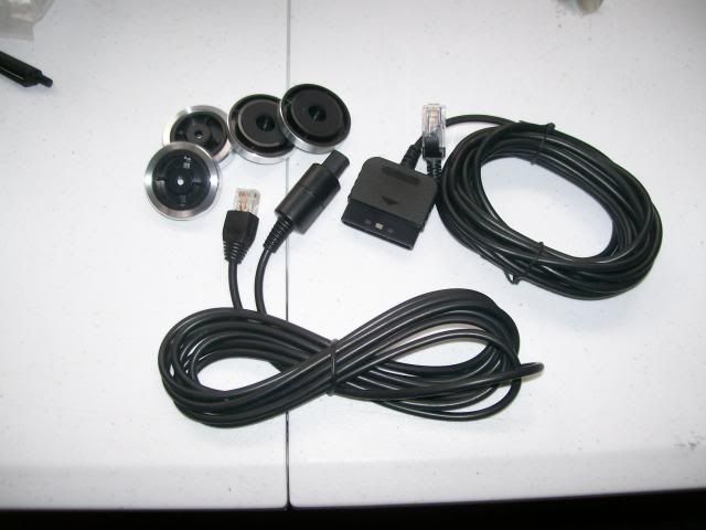

The RJ45 to Playstation 2 & RJ45 to Dreamcast cables, and the Joystick case feet.
