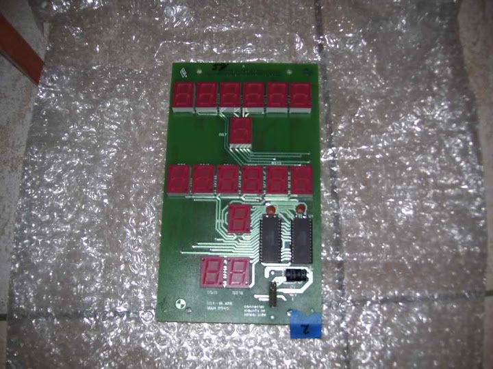

I received this little beauty last week. It's a half sized Dragon's Lair scoreboard that works with Daphne emulator. I actually got two of these made up with blank PCBs for another five. So if one does go down I have a spare to install and can then get another built up from copying parts of the other into a blank.
This was built by a guy in the States (Mark Spaeth at Cambridge Arcade Supplies) who also supplies full sized DL scoreboards for original cabinets. He was extrememly helpful and co-operative with this project especially as this is a one off. I emailed him a half sized image of the scoreboard plexi glass and he was then able to make sure all the digital segments lined up correctly. I've not yet had a chance to test it myself yet with Daphne as I don't yet have a parallel cable and also that my current Daphne install is on a PC that doesn't have a parallel port. So I suppose that's my next step... get a cheap tower with the correct port.

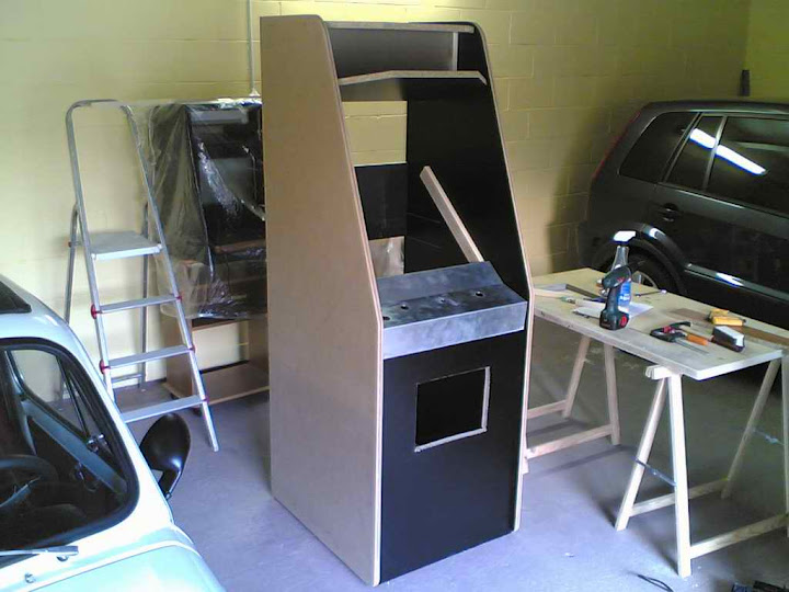

I worked 3 days (3 of my August holydays...) to build this little "present" for the anniversary :
It's a MINI Dragon's Lair cabinet, built from the beginning "around" an Asus eeePC900 (my wife's computer... ), and it's 1 : 2.4 scale.
I decided in that way to make marquee and CP dimensions compatible with A4 format for printing artworks by myself !!!
After a few days, I fix it all and made it "free" from the eeePC...
> an all-in-one MB with a Pentium4 H.T. 3 Ghz
> an 8" LCD TV / VGA monitor
> two USB-powered stereo speakers
> LEDs back-lited marquee, powered by the +12v taken from a PSU molex
details of the marquee : heat-bent brown plexyglass  ;)
details of the controls interface (this time I wanted something cheaper than the "regular" I-Pac... so I went to an ArcadeParts e-shop in the UK...
All its part, except for the display ( 50 €uros, new ), the speakers ( 10 €, new ) and the  control interface ( 20 €, new ) are "recycled" from other previous buildings  :D !
MDF, joystick, buttons, spary paint and the computer parts... all "USED"  ;D !
Then I could say it's an "ECOLOGICAL cabinet"  :D .

I suggest you to have a look at the drawings I got here:
https://picasaweb.google.com/117710395593968524416/DragonSLairAtariCabinetSHEETS
Watch all the cabinets all around the web and pay attention to their shape and how they do look...
You'll find out that Jacobud's drawings does absolutely NOT respect the reality !
I remember many years ago at the Dragon's Lair Project site we thought that this Jako'sheet could have been the one of the PROTOTYPE cab, but no one was really sure and never had any clue to confirm it (also because no one of us had seen such a cabinet !!!)
PROTO CABINETS (we couldn't see so much of them... but that's it  ;D )
And this is another PROTO-cab... one of the "people-test" pre-release  ::)
Oh... hehe, the plexyglass...
The more the thickness is thin, the better it takes the shape you want. But, as you would see if you'll try, when you warm it up it follows the shape and when you turn off the hairdryer it will come back in its previous shape, also defying the force of gravity  :-\ :D !
Nothing impossible, just insist... but pay attention that it could deform too much if not put under a full buffer (and a marquee could not  be "full", as it might have empty space between its top and the bottom...)

Yeah, parallel port is the only way to bring life to the Dragon's Lair hardware scoreboard !
I remember when me and a friend of mine worked on it several years ago... I also suggested to the Daphne "leader" to write a little program which is able to reset the scoreboard out of Daphne.exe, then I put it in the "auto execute" folder in XP so when the o.s. is fully loaded, scoreboard turns off :) !

Not got too much done recently, but there has been progress. I decided to fix the marquee panels by setting them back as they should have been in the first place. I also slightly changed the lower panel to match the way the US marquee looks. As mentioned earlier (and in the link MacDLSA posted) there is a slight difference between the US and EU marquee details. And in Jakobud's plans it certainly looks like they detailed the EU marquee which isn't the one I want.
I also fitted the coin door. I needed to make sure it fit nice as well as have space behind for the PC panel. Although I'm not using any actual coin mechs I still have some protrusion at the back of the door that I needed to make sure cleared.
I finished the shell of the cab off with these two hinged doors. I needed two doors because if i fitted panels I wouldn't be able to get in and fit/adjust the monitor or the scoreboard panel. There is a small panel between these doors of course, but I can work around that. Doors have been removed for access but they fit nice. The inside of the fan hole has been trimmed with T-molding. And yes... that fan is overkill I think for this cabinet. But it was cheap and should be quiet.
