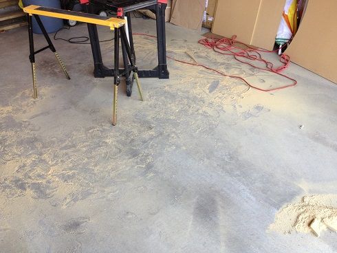

cant wait to see the saw dust piles in the background of your pics :)

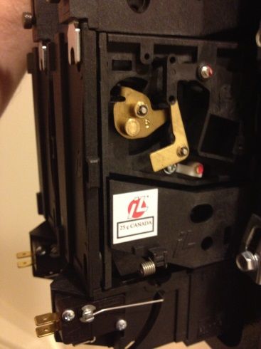

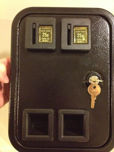

Second to last day before vacation starts and UPS arrived at work with my coin door and mechs. I ordered these from Starburst (Playdium) in Toronto.  The mechs are Canadian quarter mechs as that is what I adjusted my other cab for.  I usually just use the coin insert buttons but sometimes it's fun to plunk a quarter in.  For example...is it even possible to enjoy Ms. Pacman without first hearing your coin plunk in before the intro and start?  :laugh:
The Aliens cab has a Williams Pinball wide coin door so with this vertical one for aesthetic I went with the slim Over/Under (Over portion only) variety.

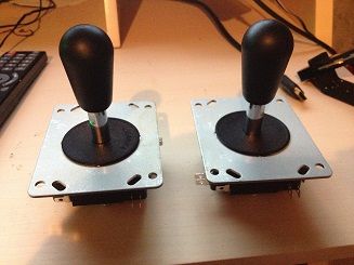

Also have decided to not go with balltops on the vertical. I will stick with Sanwa as I consider them the strongest all around arcade stick on the market but have opted for the bat handles. To me Bat handle sticks are a must for vertical gaming. I will just keep the other pair of balltop Sanwa's for a CP project etc:

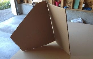

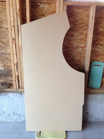

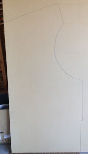

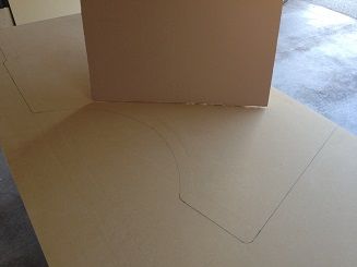

Work today amounted to not much more than measuring the outline.  Again, given the size of my monitor I had to make some compromises with the original Taito cab dimensions. I have seen a project where the cab was made less deep so figured not much harm in making it a bit deeper. After carefully measuring I opted for an additional 2" of depth...rather than being 30" at the deepest point (mid cab) I am at 32".
Here is the outline with the revised depth:
And the monitor in vertical orientation (cutout as the WG is HEAVY):
My monitor cutout also takes into account depth as well...the deepest part of the monitor is a small square at the center back so with a few adjustments should fit fine:
Tomorrow the cutting begins. I will ensure I document that with video as well as pics as the router makes creating a copy of one side nice and easy.
« Last Edit: June 30, 2013, 09:39:23 pm by Epyx »

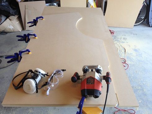

So today...

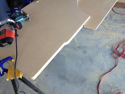

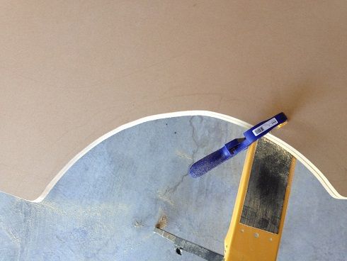

Started where I left off yesterday with the drawing about 2" deeper than a stock Taito cab.   One of the other things you tend to forget is how much ---smurfing--- dust a router bit on MDF creates...
First side cut...wasn't completely happy with the Taito semi circle but sanded it out later:
Always wear your safety goggles when working with routers or saws!  A ventilator like this one is nice for the MDF dust as well...unless you like coughing this stuff out for days! This may have been  harped to death in the years since I was last on but the easiest way to make your 2nd side is to simply rout it using your first as a template like so:
Halfway through the process the 2nd side is starting to take shape:
Here you can see the imperfections in the Taito semi circle:
Nothing a little sanding can't fix. I have an orbital sander that is perfect for stuff like this.  Here you can see the two sides next to Version 1 of my Alien cabinet sides. They were 3/4" MDF and when I made the decision to go with laminate over paint I opted for 5/8" MDF instead...still have these standing around.   The CP is about 4" higher on the Aliens cab because the Taito sides still don't have the 4" base and caster wheels...once those are on it will be roughly the same CP height:
Back to work tomorrow...so likely no lamination until the weekend...very excited can't wait. What is nice about the Taito design is laminating the inside will be very easy compared to what I went through with the Aliens cab.
Oh some videos that basically cover snippets of the pictures above:
« Last Edit: July 01, 2013, 09:22:45 pm by Epyx »

Looks cool.  +1 on the MDF dust.  A lot of this MDF creates some NASTY chemicals when worked, too...it's not just the dust.  I do all my cutting and routing in the driveway, then blow the dust onto the lawn and neighbor's cars when I'm done.  >:D
I also want to invest in a good leather apron, too.  Flying carbide tips from router bits would hit just about balls high!  :o
