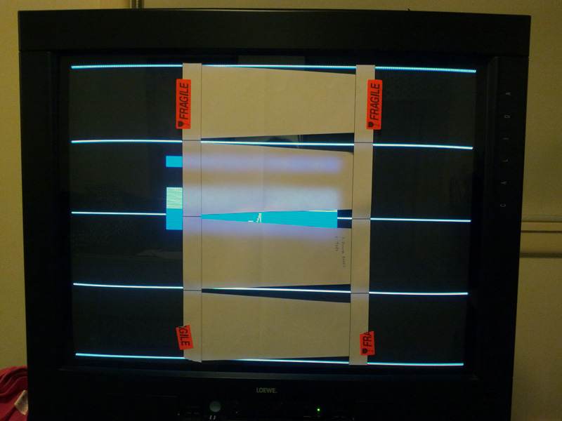

« Reply #13 on: May 08, 2013, 10:36:52 pm »
All,
Really appreciate your suggestions, and I promise I am trying to study up on the theory to understand what is really happening with each setting!
With many of the modelines generated with these settings, I noticed a strange curling in the top few lines, almost like a bowing (upper left and right only) in the top row of squares using ArcadeOSD using 256x240@60 as an example. When I adjust the dotclock manually down to 5.27 MHz, the bowing goes away! But then my vertical settings are 4-3-18 or 0.261,0.196,1.176 at 57.767 Hz. This does result in a perfectly centered picture, with clear borders seen on each side of the test pattern.
The complete line for this mode is 15625-16200, 55.50-61.00,4.557, 4.557, 7.596, 0.261,0.196,1.176, 0, 0, 240, 480
What component of the vertical or horizontal modeline causes the bowing to occur? Is the limitation in the Sony Trinitron (NTSC) CRT, or my settings?
Any updates regarding the 288-line mystery? I've tried going beyond this limit, but cannot settle on a good display afterwards.

For everyone's information, I think the 288 lines switch must be available on most pal capable TV. I have this behavior on my Philips (chassis anubis aac) and back in the 90s I could see it working on many TVs when plugged to a PAL console.
For example, to get rtype (which runs at Vfreq 55.018 Hz) inside the screen I set the Hfreq to 15845 kHz thus I get 288 total lines (15845/55.018= 288) so the overscan is switched off. There are even little black borders at the top and the bottom of the screen but that's still far better than the overscanned default display.
Now what remains problematic for me (since afaik, this tv has no service menu available) are the 240 lines games, when overscan is on I loose a few lines and when it's off the picture is shrunk too much.
