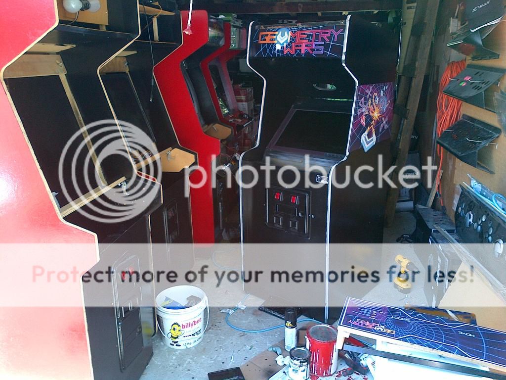

Re: Geometry wars dedicated cab!! Questions
« Reply #19 on: July 25, 2013, 03:23:06 pm »
i'm horrible with updates, you know life gets in the way right  ;) Geo wars retro-fied if you will
Hopefully get it done shortly

« Reply #20 on: July 26, 2013, 10:42:30 pm »
That is so frickin cool.  :applaud:
Looks like you opted for the pedal idea then?
I just read Le Chuck's idea of using a single stick with an analog hat for firing...that actually sounds like a good idea.
« Reply #27 on: August 22, 2013, 02:58:28 pm »
Crappy vid to boot, still needs some finishing touches though, t-molding on the CP and chaning up the color of the buttons and ball top,
« Reply #28 on: August 22, 2013, 03:31:44 pm »
Looks great!
A few questions:
-  Does the game directly boot?
-  Did you end up using the standalone version of Geometry Wars (non-Steam)
-  Are any other games built in?
-  Do you have a front end running to choose which game to play?
« Reply #32 on: August 22, 2013, 09:38:54 pm »
Looks great!
A few questions:
-  Does the game directly boot? (Yes)
-  Did you end up using the standalone version of Geometry Wars (non-Steam) (Yes)
-  Are any other games built in? I have grid wars and echos that im playing around with as well, looking to get waves installed if I can find it
-  Do you have a front end running to choose which game to play? (no not at the moment)

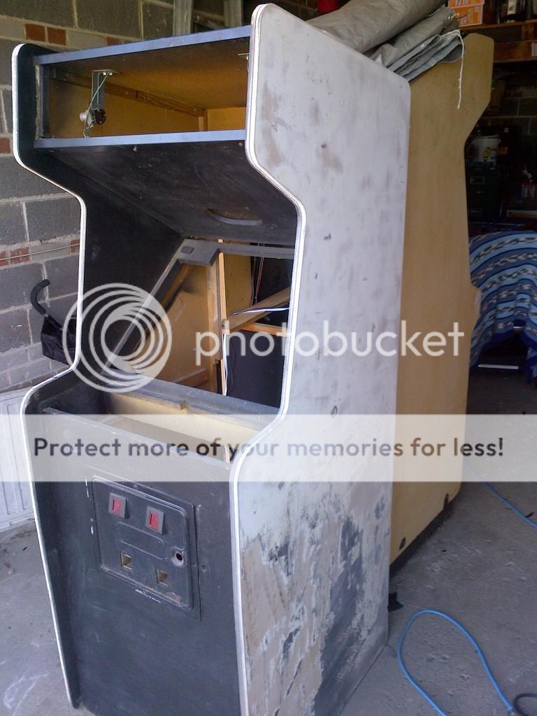

MAME TIME
  • Posts: 175
  • Last login:March 23, 2019, 10:23:19 pm
« Reply #43 on: October 07, 2015, 11:41:59 pm »
thanks for bumping my old thread I actually have an update, its just a general info vid regarding the analog setup. full credit goes to chuck for the panel setup and I really appreciate the community that helped me out on this build, I'm just rapping up the build as we speak and hopefully have an update shortly
 old vid
update
Too Much Game, check out my ish!!!
Geometry Arcade
Neo Geo 360
MK2 standup
SF2 champ edition X2
SORHP
  • Posts: 180
  • Last login:April 30, 2026, 06:41:43 pm
« Reply #44 on: October 08, 2015, 12:58:25 am »
Thanks for the update video, I think you might have a williams cabinet???
I plan to use analog sticks as well, I bought a set of Naomi sticks with adjustable pots, I plan to wire them into an Xbox 360 pad, time will tell,  it will be a bit before I can get to mine... I will be using an original robotron cabinet, and it will keep the robotron Art , cross fingers that the control panel works well.
Games: Super Punch Out, Fix It Felix Jr, DK, DKjr, DK3, PC10, UMK3, TRON, MS-Pac, Pac, Centipede (2x), Robotron, Galaga, Space Invaders, Street Fighter 2 CE, X-Men vs SF, BuckHunter HD, 2X Custom Vewlix, Custom Nintendo VS 3/4, Atomiswave
