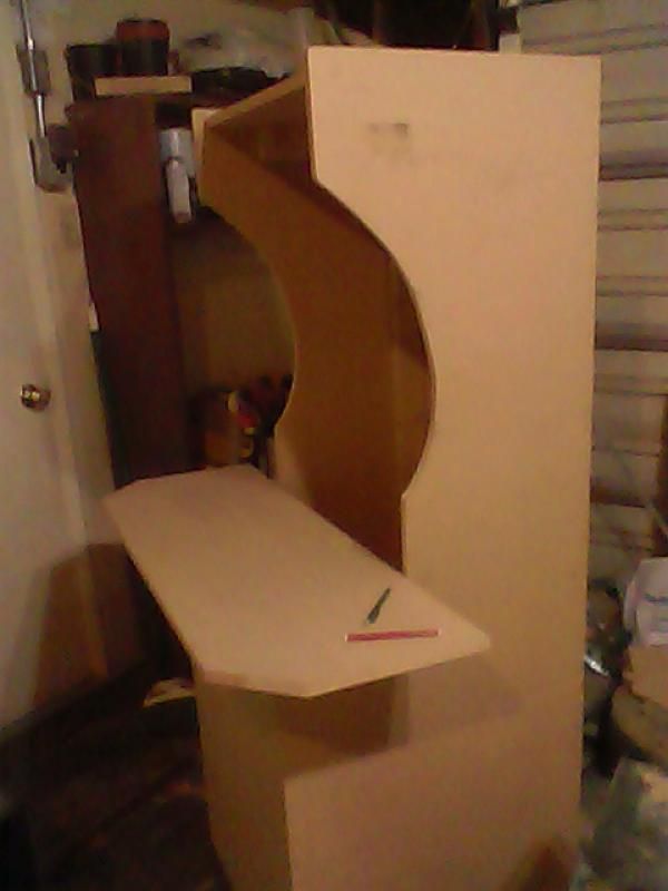

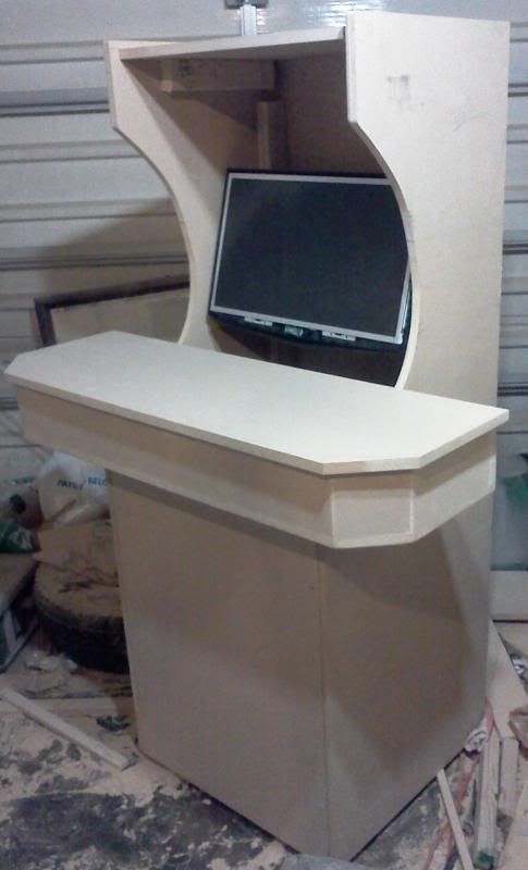

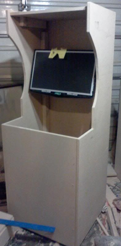

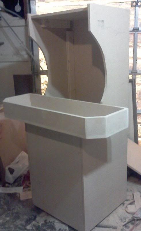

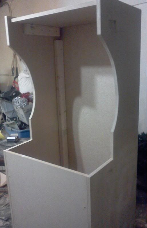

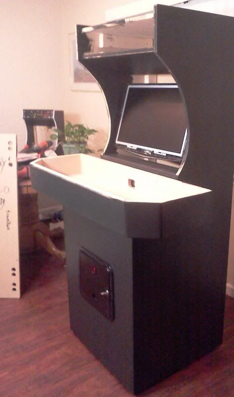

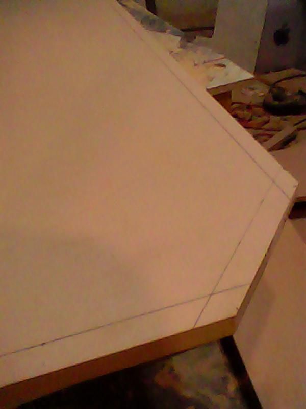

Decided to post pictures, even though my camera is complete shite.
Guy wants a 4-Player, originally wanted 8-Buttons per player.......But I talked him down to 8 buttons for Pl1\Pl2 and 4 buttons for Pl3\Pl4.
I am not working off anyone's plans, winging it off of plans I drew up myself.

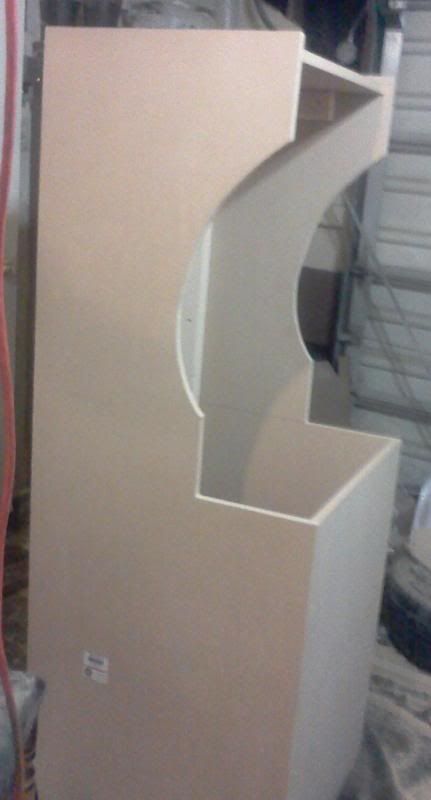

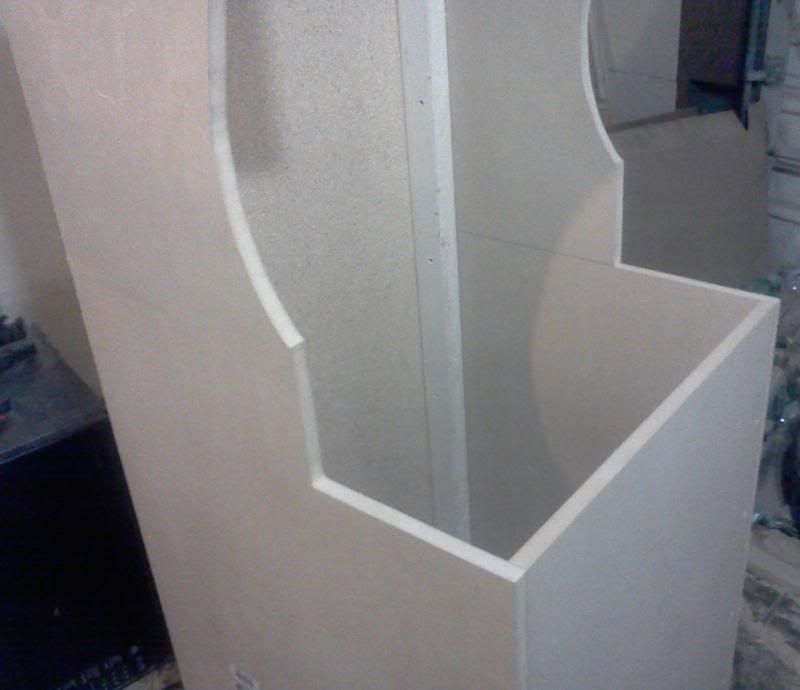

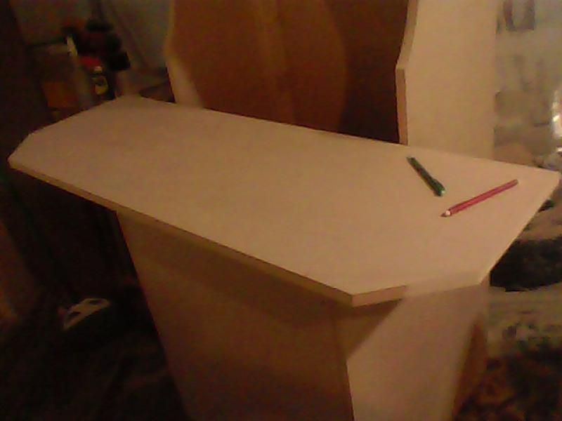

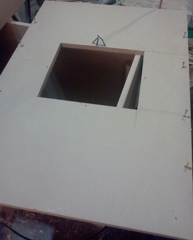

The base cabinet shell is the same design as the Clyde's Corner with the front cut off for a control panel and some slight design tweaks

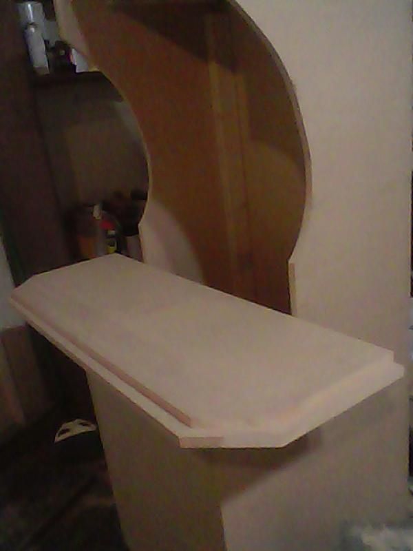

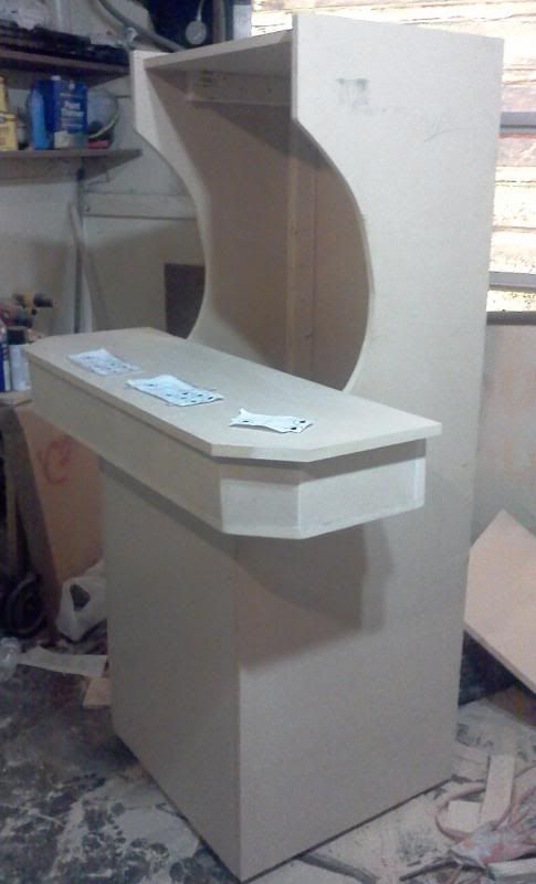

Control Panel top cut
Made a duplicate of it and then cut off 3\4" off every side of it to make the base of the CP box

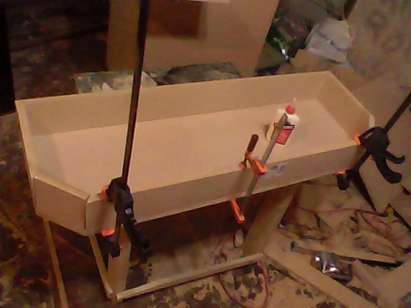

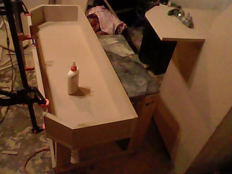

Side pieces cut and gluing them up
After first pass of sanding
That is where I am at on this build. More to come.  :cheers:

Re: 4-Player Customer Build
« Reply #1 on: April 07, 2013, 11:18:10 pm »
I like the hood shape, what size monitor is going in there?
CoryBee
  • Posts: 2093
  • Bopity Boopy
« Reply #2 on: April 07, 2013, 11:47:13 pm »
24" LED my good man
« Reply #3 on: April 08, 2013, 01:32:18 am »
How's the viewing angle from the P3 & P4 positions with the curved sides like that? Any of the wood get in the way of viewing the left and right edges of the monitor?
Looks like the monitor would have to be mounted back a bit. Just wondering out loud since can't tell envision how the monitor will be positioned yet. Besides, I'm just looking at a bunch of pictures and not standing in front of it.  ;)
Construction is looking nice.  :cheers:

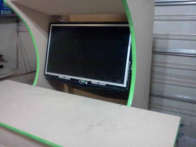

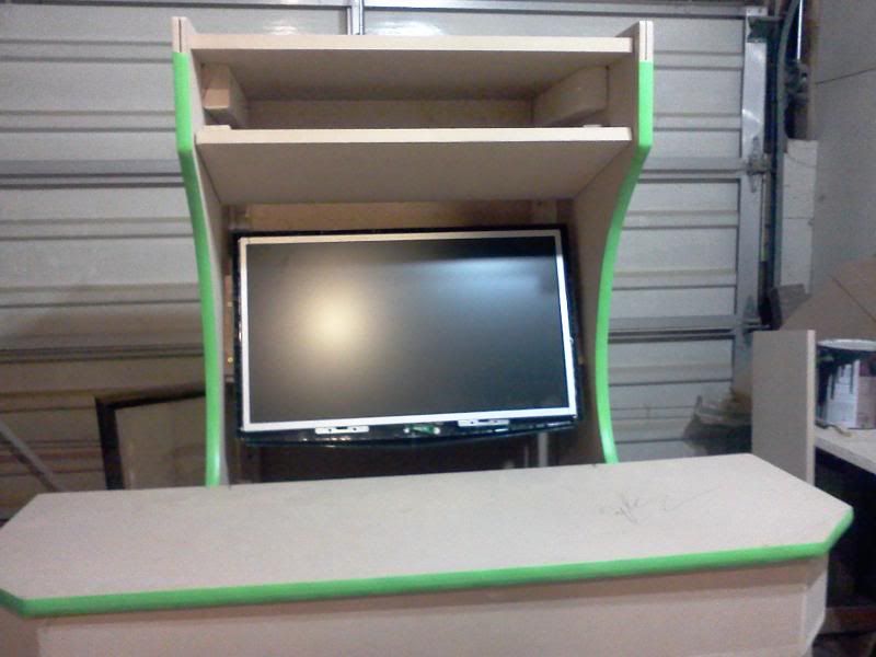

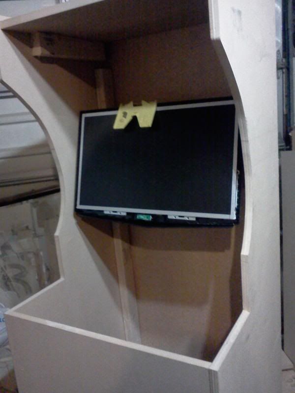

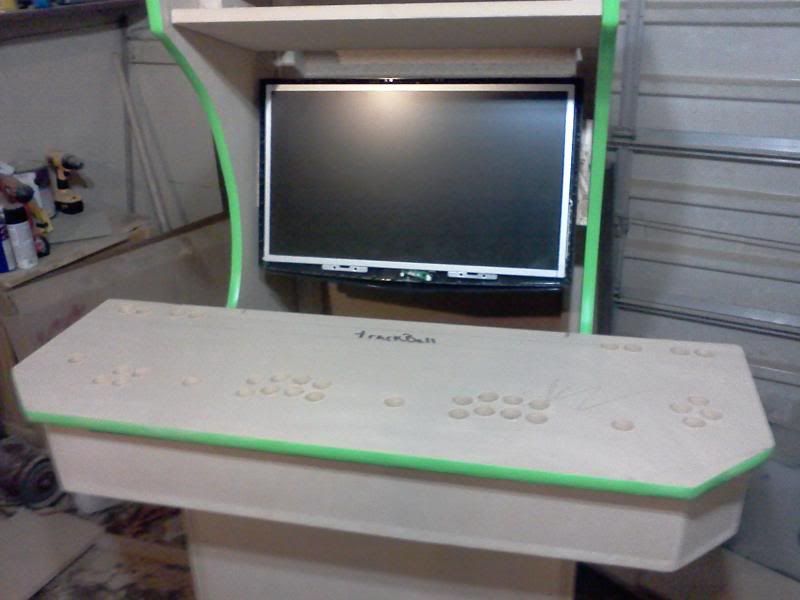

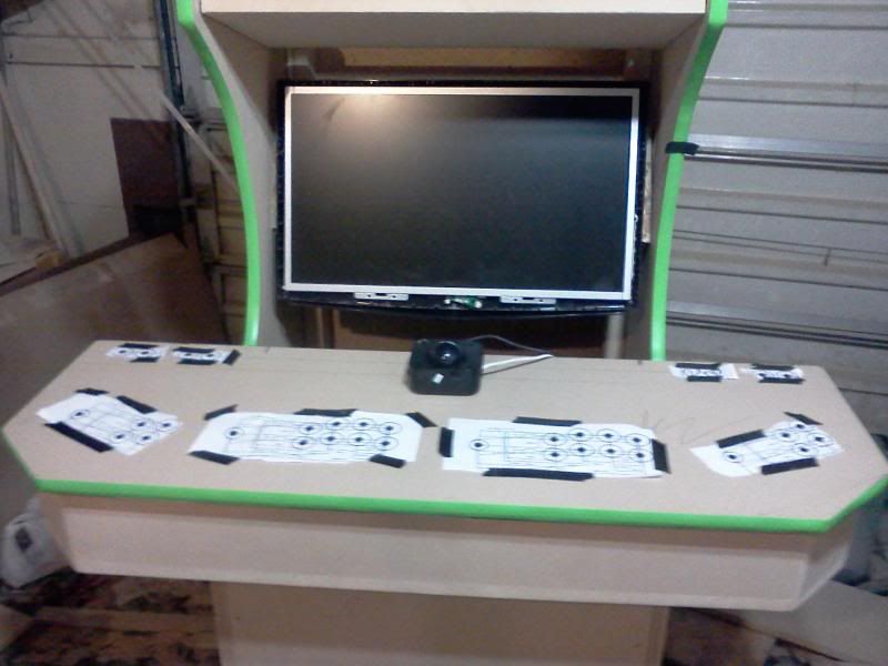

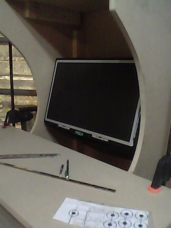

Thanks for chiming in maverick. To answer that question, here are some pictures.
Just got done mounting the screen (that is a bubble level on top)
With words:
The viewing angle is just perfect for P3\P4, I had my brother come by to test the angles. Had 3 people on it, everyone fits nicely and no wash-out on the screen (IPS for the win)

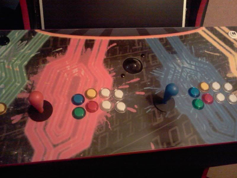

I-Pac4? Lono2? Something else?

GPWIZ40 ol' chap
Plus one hacked gamepad for the extra inputs.
« Reply #7 on: April 08, 2013, 01:34:19 pm »
:thumbs up:
« Reply #8 on: April 08, 2013, 03:57:34 pm »
Heres the thing with 4 player cabs....  They are either really tall, so the screen is at the same height of your head, or the screen is tilted back so that everyone is looking down perpendicular to, atleast, the y axis of the screen... like so:
Unstupid
  • Posts: 997
« Reply #9 on: April 08, 2013, 04:08:36 pm »
Are you sure about your viewing angles cause in this picture you are already cutting off the top right of the screen.  And as you get closer to the cab it looks like you will be even further right and a little higher causing the side panel to cover even more of the screen...  Try standing in the player 4 position and take a pic of the screen...

« Reply #10 on: April 08, 2013, 04:30:59 pm »

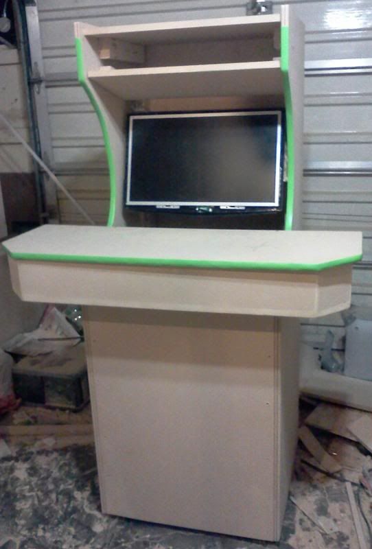

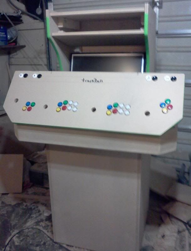

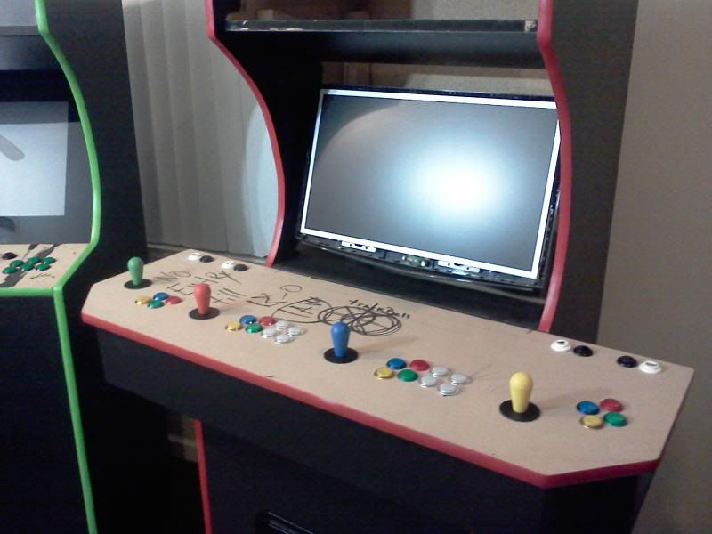

So I took a picture from the furthest player 4 will be on the edge. There is a little bit of the curve in the way.......Hmmmmm
The control template is not in the right position and will only have 4 buttons so don't mind its position.
Any suggestions?? Should I cut the shroud at a right angle??

« Reply #13 on: April 08, 2013, 09:03:39 pm »
Maybe bring the top of the screen a bit forward?
ccmathome
  • Posts: 179
  • Last login:February 25, 2021, 12:40:52 am
« Reply #14 on: April 08, 2013, 09:08:24 pm »
That little corner shouldn't be that big a deal. You might want to power up the monitor and get an image up to check the view angle for pl 3&4
Sent from my SCH-M828C using Tapatalk 2
CoryBee
  • Posts: 2093
  • Bopity Boopy
« Reply #15 on: April 08, 2013, 11:58:44 pm »
Powered it up and connected it to my Laptop. The corner isn't an issue even a bit further when the focus is in the middle. If there is a problem I will just tilt it a bit forward.

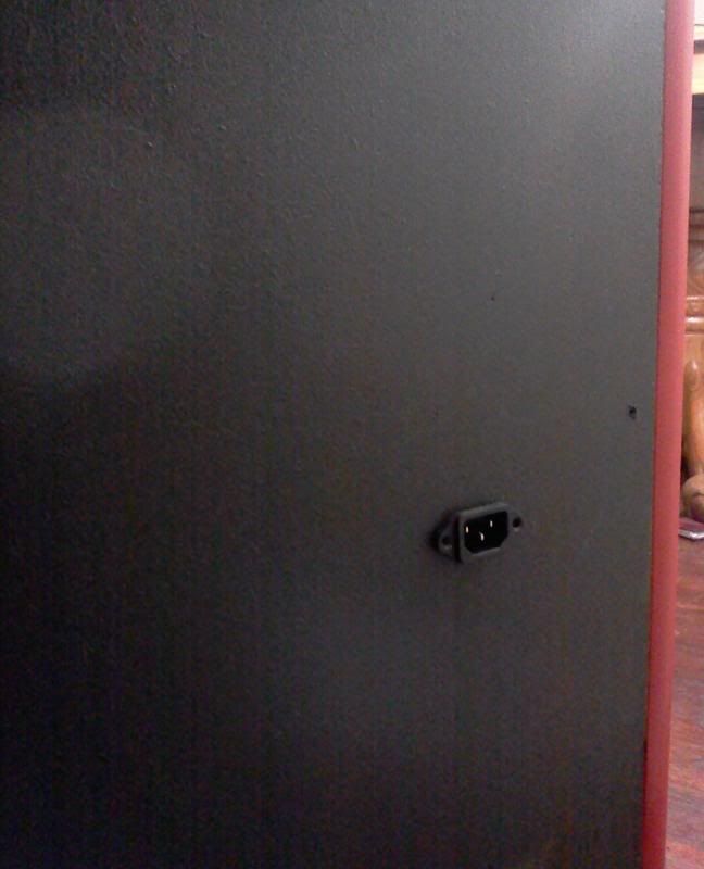

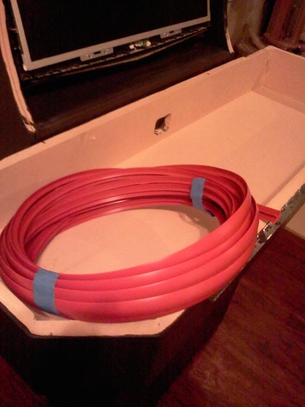

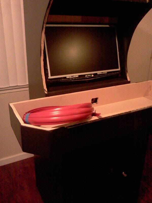

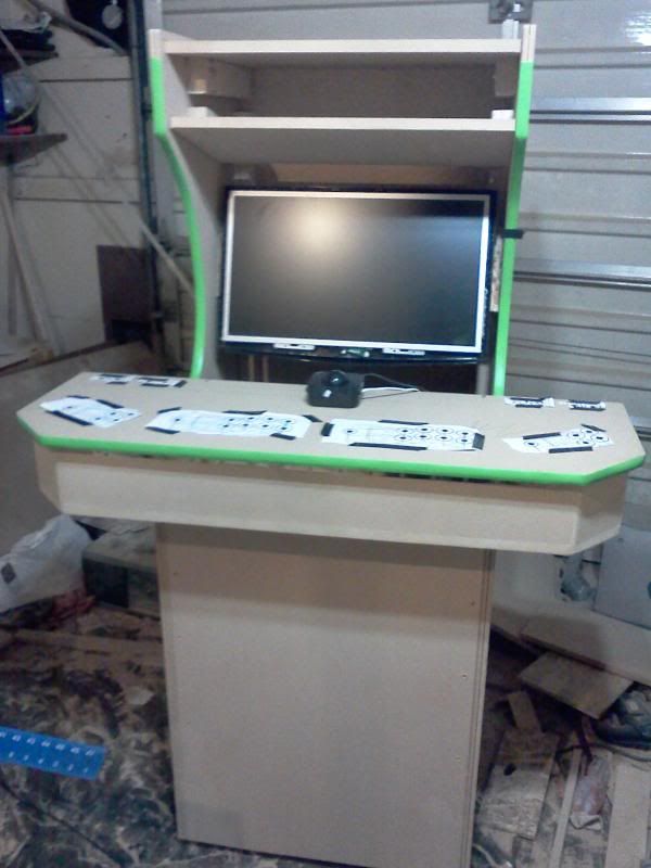

Got the speaker panel all measured and installed as well as routed the t-molding.

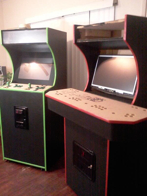

(T-Molding will be Red, had some green left over from a previous build and wanted to see what it looks like)

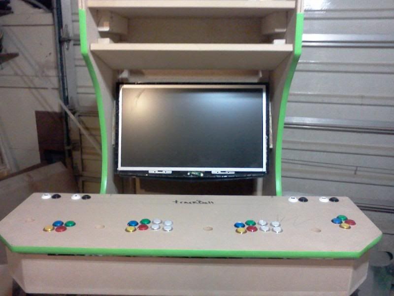

« Reply #16 on: April 09, 2013, 10:50:54 pm »

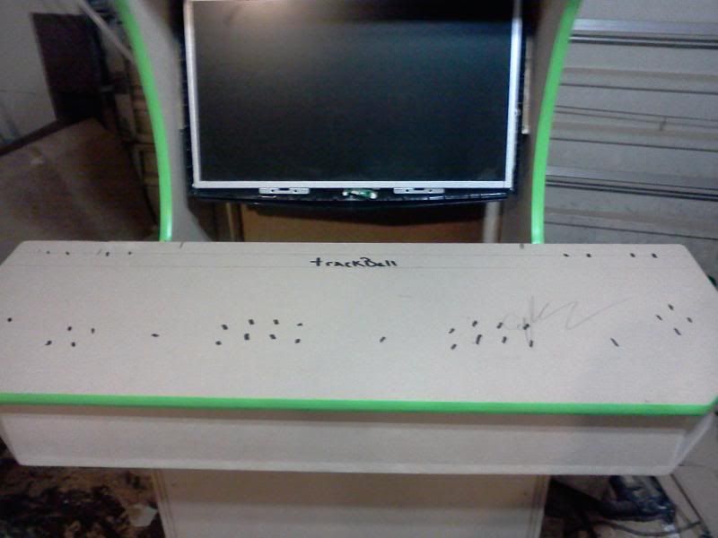

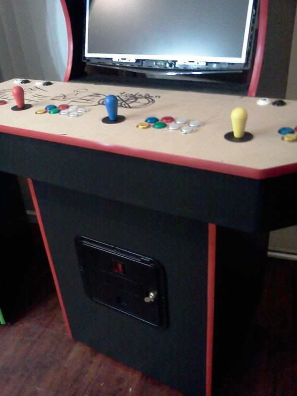

Quick update. My hand was a bit swollen after drilling all of these holes.
A nail and a sharpie
Also got the hinge installed

Bring that trackball down some!  Players will thank you for doing that.
Otherwise, this is looking pretty nice.  A nice combination of oldschool cabinet body aesthetics with a more modern approach on the control panel.

The trackball has not been determined yet. Was planning on having it a bit lower than it was shown.

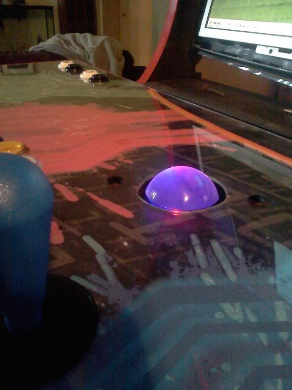

Thanks for the tip, I think about it every-time I have test fitted t-molding. I just always forget the next time haha

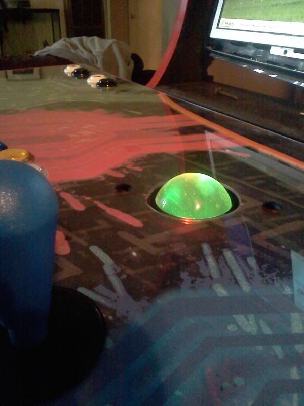

This trackball is clear, I did a small hack to it. Cut the traces off of the LEDs and hooked up a RGB strip to it, looks awesome this way and will match all of his LED buttons & the many pinball cabinets he has making the living room glow.
I hooked up the LED strip with using a bit of telephone cord (4 wires, perfect match)

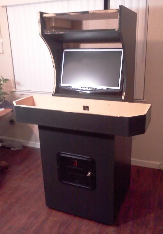

« Reply #27 on: April 11, 2013, 03:34:05 pm »

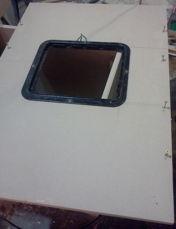

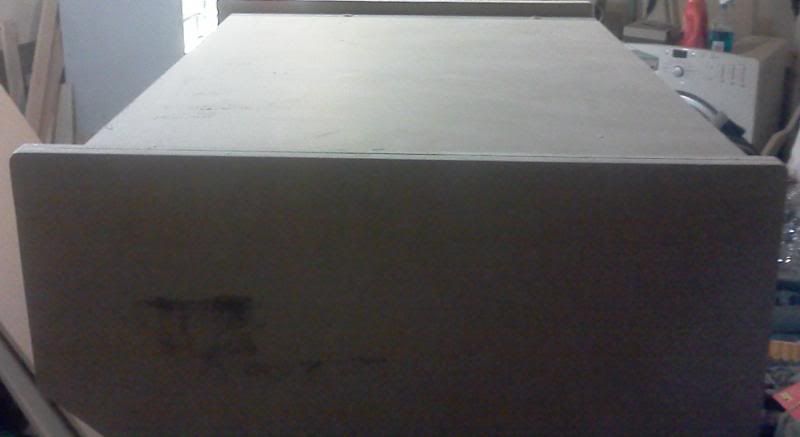

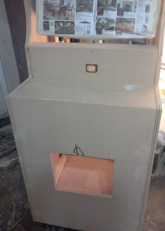

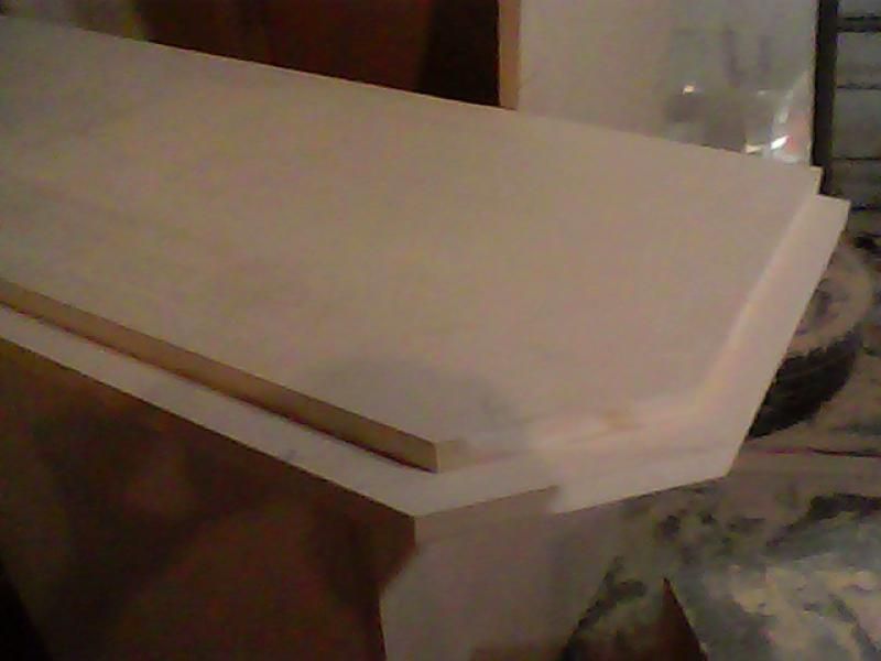

Quick update:

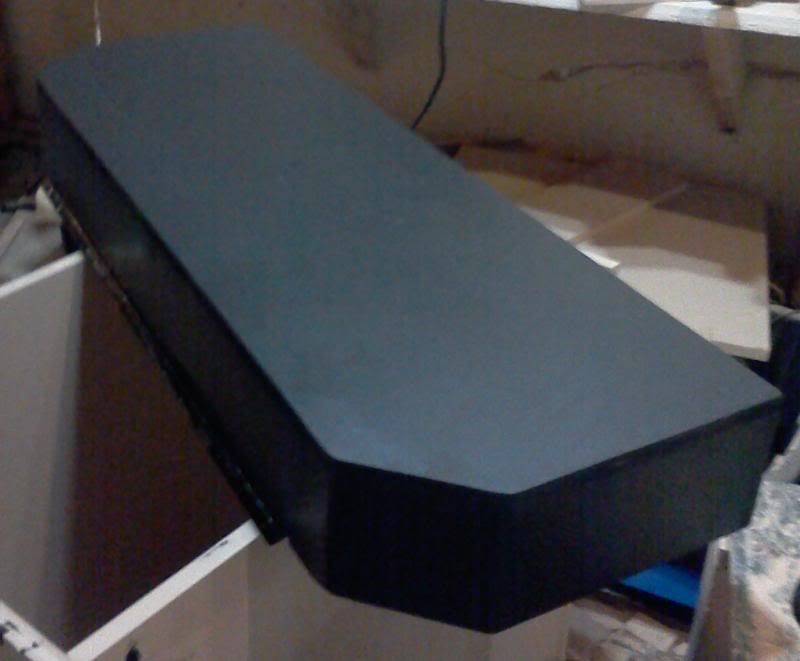

Constructed a base for the control panel to mount on
Coin door hole
And the first coat of paint

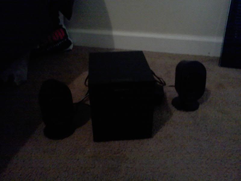

Thanks fellas, got some more pictures for ya. (didn't say they were of good quality)
Sounds system

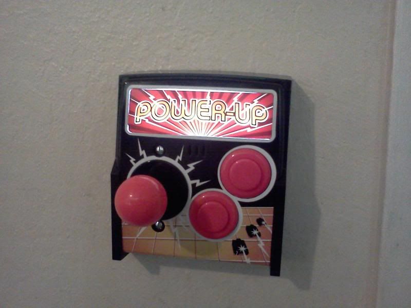

What games are on that mini controller plug and play?
« Reply #32 on: April 11, 2013, 07:59:04 pm »
That's a light switch. ;)

Haha, yes it is a light switch. And it was $5, thanks to "deadpool18". Or  thanks to "deadpool18" I spent $36 at thinkgeek......Meh I like the decoration toys I got.

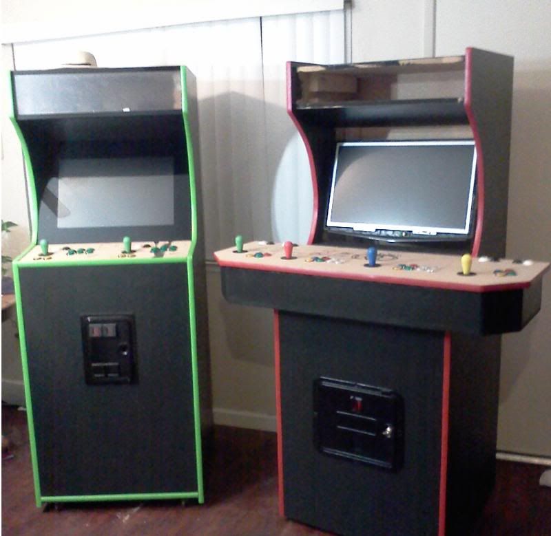

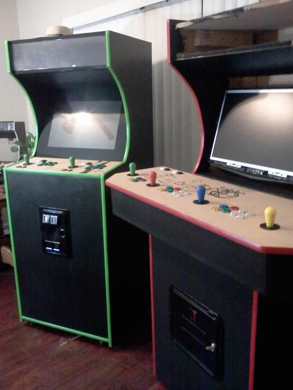

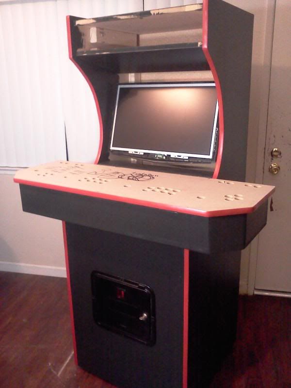

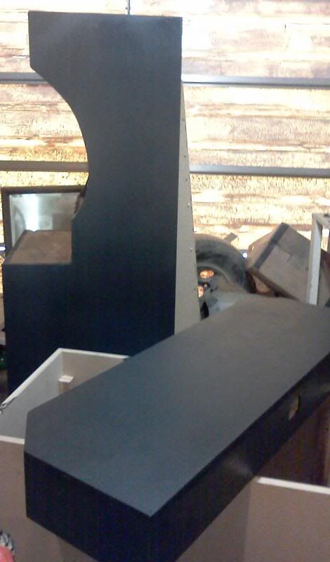

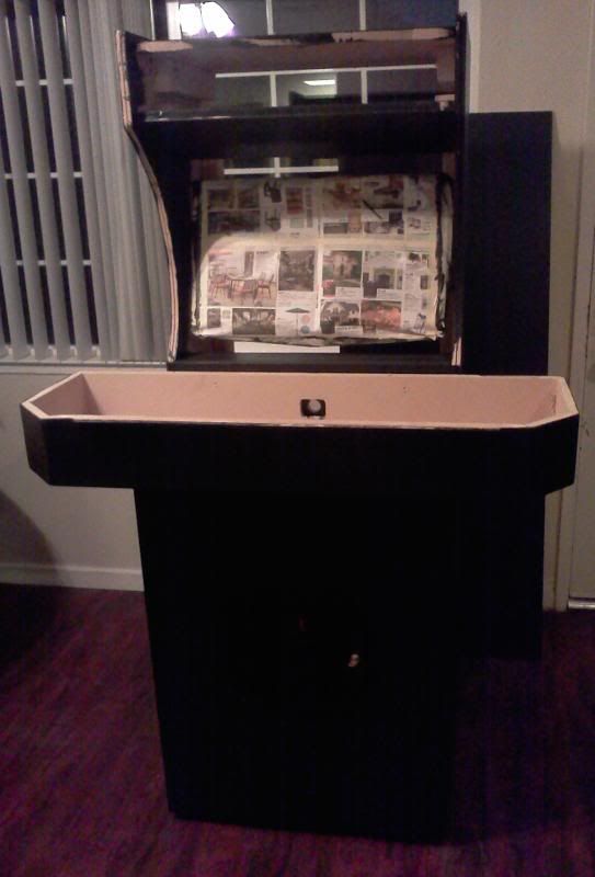

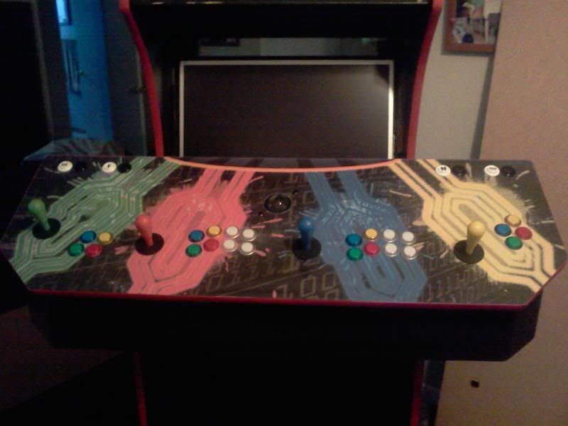

Fourth and final coat of semi-gloss paint has dried, here are some pictures for your enjoyment. The arcade to the left is for a future thread, don't mind that
;D
T-Molding
I think I am going to go get some 3m Auto Polish stuff and wipe that on it to give it that final glow

Update:
Spent some time painstakingly putting together the LED buttons and after an hour I got the CP art applied and all the buttons. Save the wiring for later....
Can't wait to light this thing up!

Spent a fair amount of time wiring up all the buttons and their LEDs......very tedious, yet relaxing. Running a "GP-Wiz40-Eco USB" for all player buttons and for the 8 coin\black buttons I used a hacked gamepad.
I love this thing so much, was jamming on some 4 player and I know that I need to have one for myself.
Tried to keep it tidy in there
I will have a decent camera to take some pictures in the next few days so bare with me. The trackball magnifies the position of the LEDs on the strip from the earlier mod, adds to the ambiance a bit
All that is left is Marquee, Bezel and software  :cheers:

« Reply #45 on: April 24, 2013, 11:06:53 pm »
Almost everything is completed. Once I finish organizing everything and finish up all the software I will take off the acrylic pieces and clean up any dust that is on the cab.
Modified the coin reject button to serve as the power button for the computer. Used a two part epoxy thing and an old joystick micro-switch.
Here are some random shots
Thanks for looking!

Finished the beast a few days ago, been meaning to upload pictures.
Enjoy!
"Smart-Ish Power Strip"
Getting it prepped software wise to be delivered. Think I will modify some menus for it. Maybe a black and red theme frontend layout?
Cheers guys, thanks for the support.

Not sure why but the white LEDs kept failing on me. They would blink for a while then just stop working or become severely dim. I got replacements but still same issue with the new one and a different power supply. This only happens to the white LEDs, anyone know why? I decided to replace the LEDs in the normal housing with ones from an LED strip, was fun to dissect them.
The failing LEDs, the rest of the white ones were previously replaced with the same hack
Offending LED and a piece of the strip
LED was removed from strip and connected to the legs of the old one, then wrapped around the holder
Comparison of the old vs the new

Game settled in and nice and colorful next to his Pins.
(Don't mind the cat's ass)
It is a bit low because we took it off of the casters and he will be putting on adjustable risers like on the pinball feet.
It was well received and even got the approval of the warehouse arcade guy.
