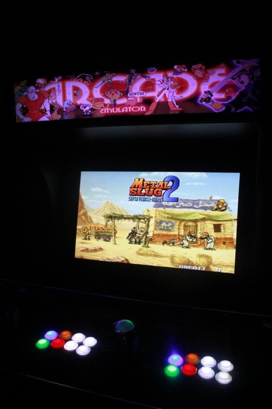

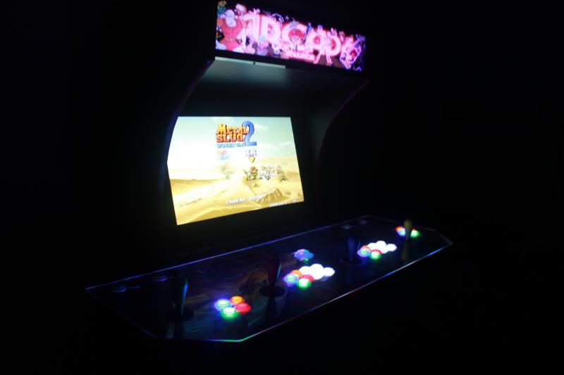

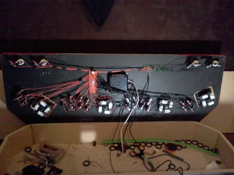

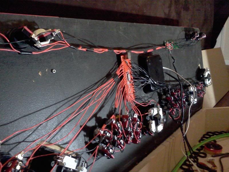

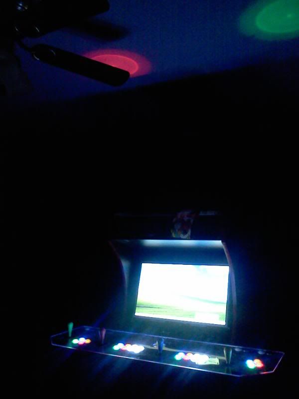

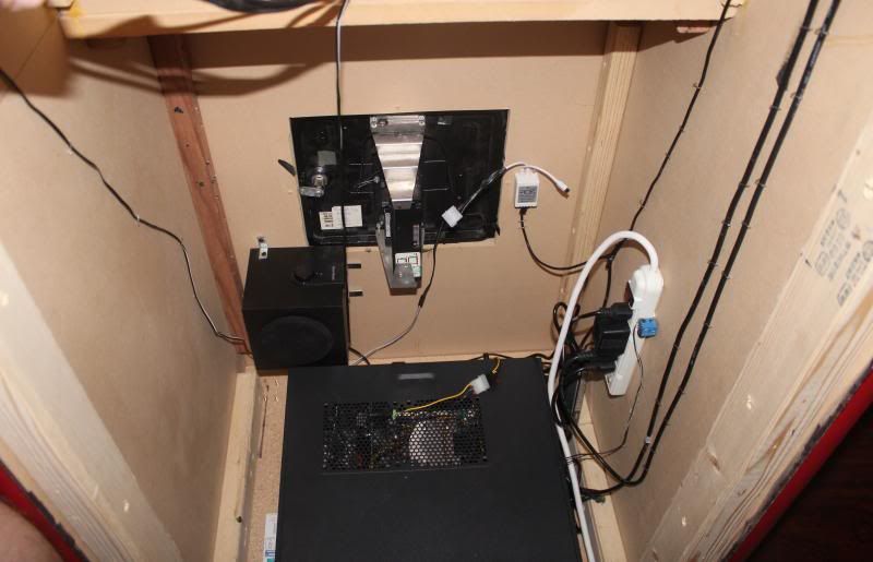

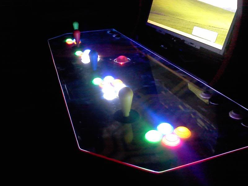

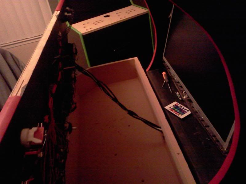

Spent a fair amount of time wiring up all the buttons and their LEDs......very tedious, yet relaxing. Running a "GP-Wiz40-Eco USB" for all player buttons and for the 8 coin\black buttons I used a hacked gamepad.
I love this thing so much, was jamming on some 4 player and I know that I need to have one for myself.
Tried to keep it tidy in there
I will have a decent camera to take some pictures in the next few days so bare with me. The trackball magnifies the position of the LEDs on the strip from the earlier mod, adds to the ambiance a bit
All that is left is Marquee, Bezel and software  :cheers:

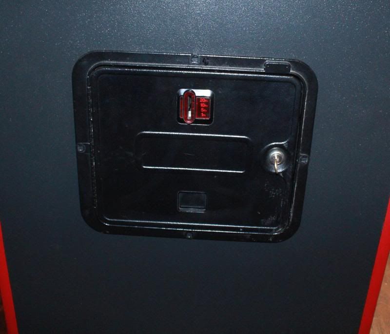

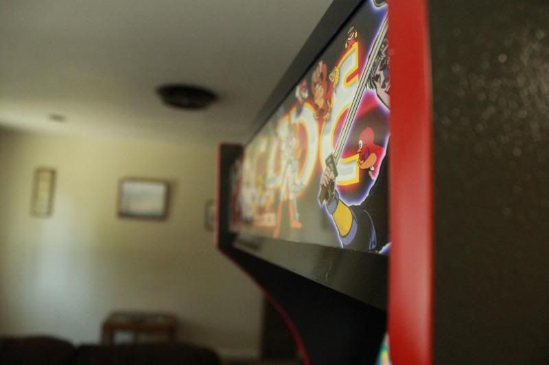

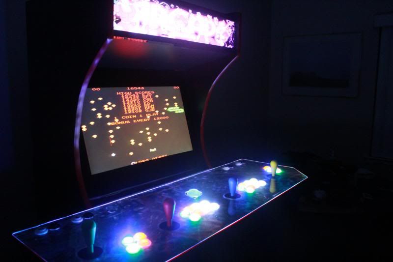

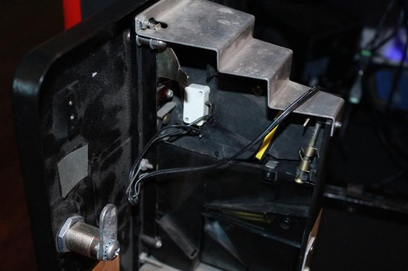

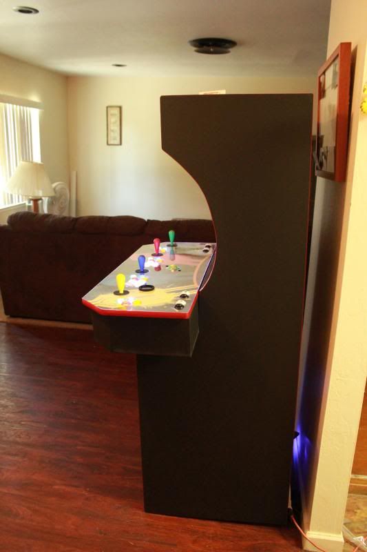

Almost everything is completed. Once I finish organizing everything and finish up all the software I will take off the acrylic pieces and clean up any dust that is on the cab.

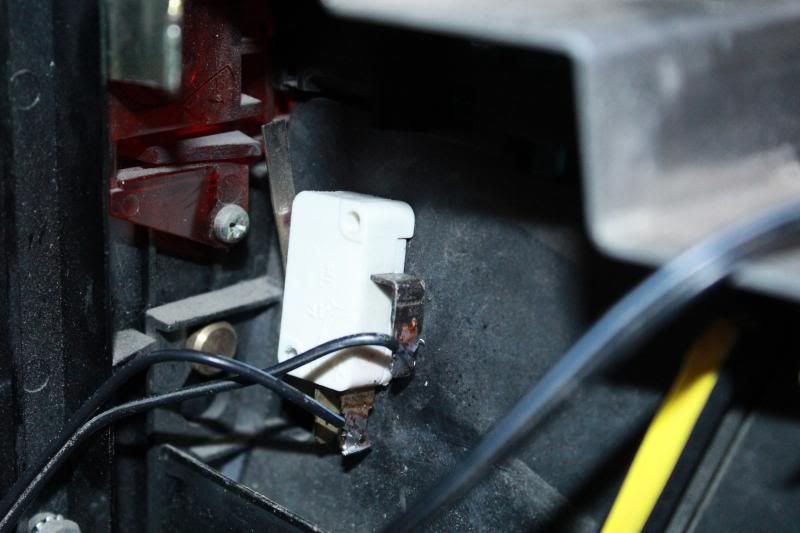

Modified the coin reject button to serve as the power button for the computer. Used a two part epoxy thing and an old joystick micro-switch.
Here are some random shots
Thanks for looking!

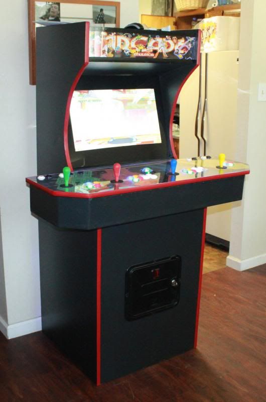

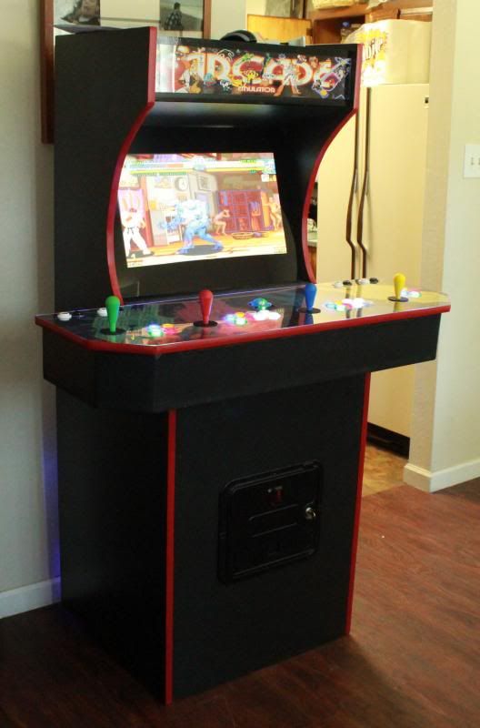

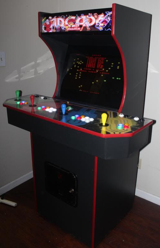

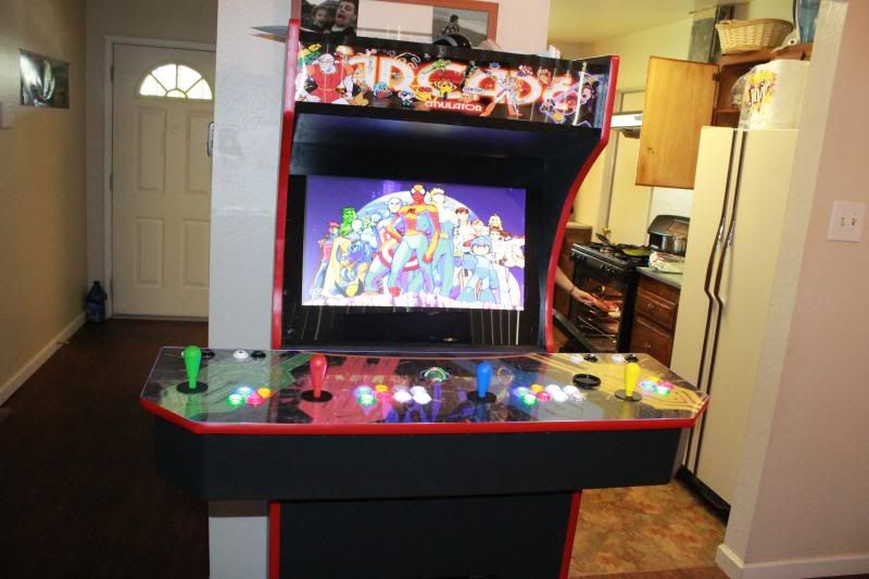

Finished the beast a few days ago, been meaning to upload pictures.
Enjoy!

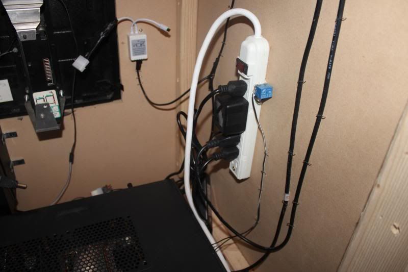

"Smart-Ish Power Strip"
Getting it prepped software wise to be delivered. Think I will modify some menus for it. Maybe a black and red theme frontend layout?
Cheers guys, thanks for the support.
I can already see kids randomly pushing the coin reject button and shutting down the computer.
Build looks nice.
Build looks nice.
It is for an adult household, no kids allowed. You have to press it all the way back to press the switch in.

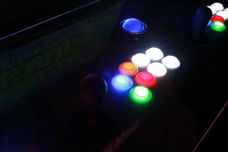

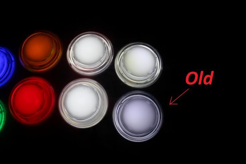

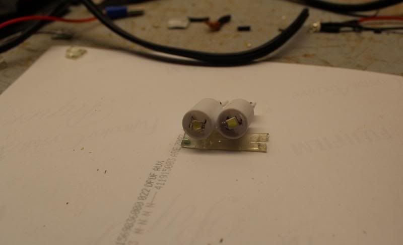

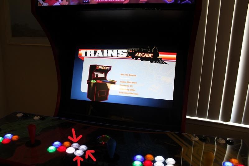

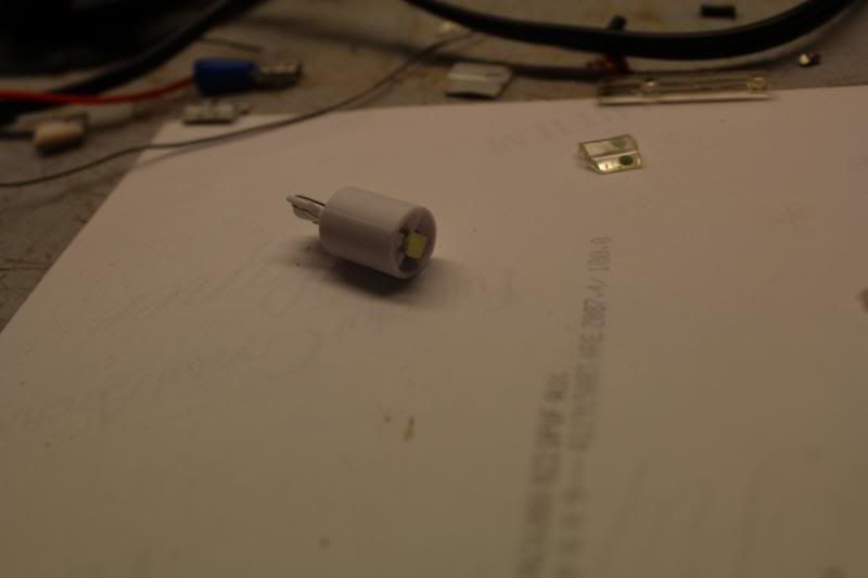

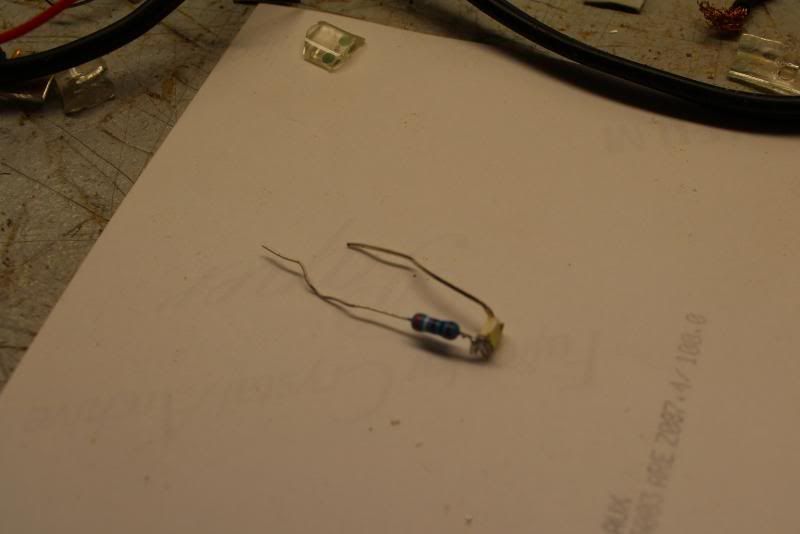

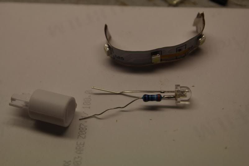

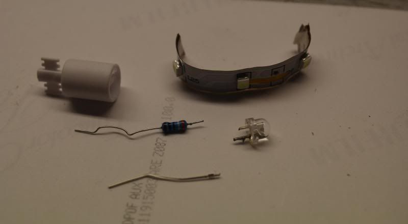

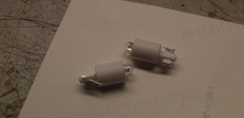

Not sure why but the white LEDs kept failing on me. They would blink for a while then just stop working or become severely dim. I got replacements but still same issue with the new one and a different power supply. This only happens to the white LEDs, anyone know why? I decided to replace the LEDs in the normal housing with ones from an LED strip, was fun to dissect them.
The failing LEDs, the rest of the white ones were previously replaced with the same hack
Offending LED and a piece of the strip
LED was removed from strip and connected to the legs of the old one, then wrapped around the holder
Comparison of the old vs the new

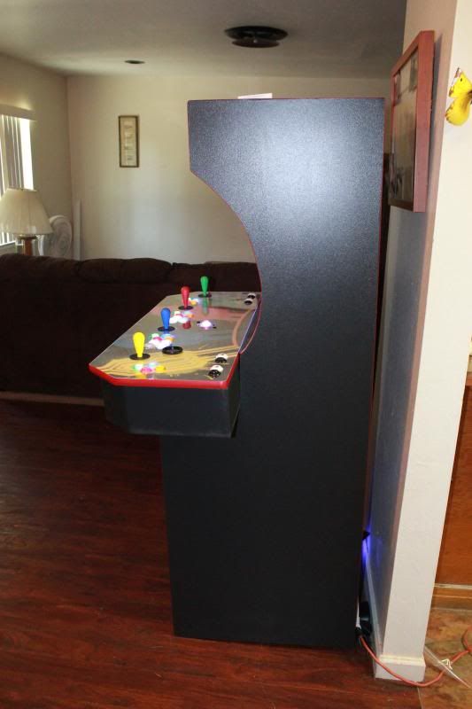

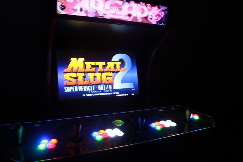

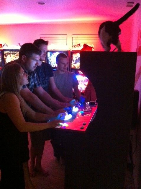

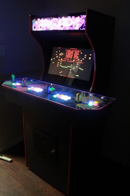

Game settled in and nice and colorful next to his Pins.
(Don't mind the cat's ass)
It is a bit low because we took it off of the casters and he will be putting on adjustable risers like on the pinball feet.
It was well received and even got the approval of the warehouse arcade guy.
