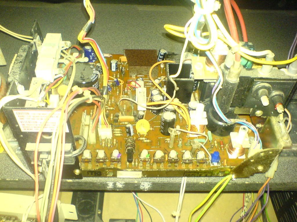

BTW would anyone like to see my arcade cabinet? If I can get decent enough images with my CRAPPY samsung galaxy camera, I could post them here.
EDIT: took some pictures but they ain't worth sh***. I can't believe my old nokia from 2000 could take BETTER pictures than a year old galaxy!.
Tried to play my mille miglia, but game wont start anymore :( Monitor starts ( makes the sound and static) and sound system starts (when adjusting volume higher makes noise) but game just wont start. No test image, no ramm testing, no anything. Monitor stays black. If monitor was dead but  game was not, then after putting together two cords in coin lock should make sound. but no sound so I know the game is not running at all.
 Is there a fuse for the gameboard somewhere maybe? My arcade has this black box that looks like a pc powersupply, only smaller. It has these ports as +5 volts, +12 volts and so on. AND it has a knob 5 volt adjust. Is that the thing that powers the game board? It has red led and it illuminates, and I suspect it powers the sound system too (sound board says sega 1986) so I don't think that is broken.

Tried to play my mille miglia, but game wont start anymore...
You should be able to visually identify any fuses in the cab.  Check them visually, or with a multimeter to be sure.
Yes, that's the power supply.  It's one of the first things you should check.

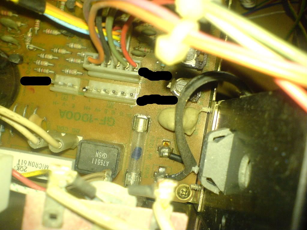

Ok, got the apparatus yesterday. Connected it to the monitor And to my IBM. AND IT WORKS! Games look good with it, the resolution what you give to the apparatus HAS a difference. Lower-> Looks better. And powerstrip allowed my radeon integrated graphic driver to display 320x200 resolution.
Only thing, The picture is...faded? IT has like white could over it. Could it be I made wrong connection with the monitor?
My arcade has 2 connectors as I understand. Both have equal number of pins. Other has R G B E -V And a pin with written ( this had the original game connectod to it, Cable colors are Red Green Blue Black White). Cable colors are same as in the apparatus so I connecteds to this. And it works, but picture is very faded with white "overlay".
Other Connection has R G B E V+ H+ And One pin removed from the board and then Pins E V- H-
What would be the right connector to use? And should I put white/black together as I seen in some posts?

Also does anyone now how the sound aplifier is connected, the pins I mean. It has 3 connectors, one is power (big leads), one with 5 pins and a larger one which has about 8 pins and  I can't remove it (too much power would break it). Both have same color leads going to the connectors. Speakers get grey and yellow ( suspect it is a mono amplifier because every speaker has same color leads, gray and yellow) Sadly those leads go to both connectors :( Was thinking of putting 3,5 mm jack adapter to it to get the sound system working with my laptop mame :) Board says SEGA 1986, any clues from that?

Made the cable, pins 1 (Arcade R) ,2(Arcade G) ,3 (Arcade B) and 13 & 14 twined together (Arcade -V)
also twined together pins 5,6,7,8 to arcade E pin
And running it now.. so my monitor did not blow up, but No picture, just running lines across which might represent  windows dekstop?
Running soft15khz-> no effect. With soft15khz saying installed or uninstalled, looks the same. Cannot choose other resolutions from powerstrip other than standard (lowest 640) resolutions
And soft15khz says my card is ATI MOBILITY RADEON 7500 which was listed ok on soft15khz forum.
Now what?

Could not get it to work better. here is a picture of the monitor chassis connectors:
rCadeGaming
  • Posts: 1256
  • Just call me Rob!
Re: VGA to CGA video converter from hongkong
« Reply #26 on: December 26, 2012, 12:13:20 pm »
I didn't watch the first video.  Way longer than should be necessary.
R G B E V H = Red, Green, Blue, Earth (Ground), Vertical Sync, Horizontal Sync.  Double check with the VGA pinout that everything is coming from and going to the right place.
http://pinouts.ru/Video/VGA15_pinout.shtml
Not sure whether you should be using the top or bottom input on the monitor with the info provided.  Whether you're using + or - V and H sync depends on what the computer is putting out.  If you don't know how to determine this, you'll have to try different combinations.
Did you solder or properly crimp all of your connections?  Don't do anything else until that is fixed.
Finally, you have to figure out if your Soft15kHz install is setup and working correctly and it's actually putting out 15kHz.  The monitor won't sync up if it's getting too high a scan rate.  It may just roll like in the second video.

Another update was playing with my monitor and actually managed to get a picture to it (Altough it is very dark).
Problem is it only works with one resolution selected from arcade_osd. any other resolution-> a mess and have to boot in vga mode from windows safe menu to get picture back in my normal vga monitor. here is a video
I ordered videoamplifier with cables from ultimarc so that should not be a problem anymore And I believe i can get picture brightness back with that. Problem I believe is in the crt_emudriver install, can somebody give me a detailed instructions how to install? I just downloaded 9.5 version of it and installed it. after that been using arcade_osd program. should I set something somewhere when installing crt_Emudriver? monitor type or something?

apparently not the only 1 having problems with this type of chassis, read here:
http://forum.arcadeotaku.com/viewtopic.php?f=3&t=194
nice pic of the connectors, are spot on idetical, has same marking GF-1000 AND has one potentiometer glues with buble gum and at the flyback screen potentiometer has been glued (notice the red stuff):
http://i306.photobucket.com/albums/nn267/purplec_2008/13-1.jpg
http://i306.photobucket.com/albums/nn267/purplec_2008/chassis.jpg
Was playing around with my arcade. Tried with making a bootable pen drive out of usb stick with nevest groovymame linux distro. Booted up nicely, but no picture in arcade, only in my vga. Went to setup meny, setup my screen as cga 15 khz. started emulator. No go. picture comes to vga, but not to the arcade. started game..pic does not come to the vga, only in arcade, but it is not syncing correctly keeps running very fast from down to up.
Played around with arcade_ods. GOT STABLE PICTURE when customised 640x480 60i to lower khz (arcade osd edit modeline) when at 12 khz, started to get stable. below that-> monitor shut down itself. but after waiting couple of minutes restarted again, must have some kind of protection circuit.
Is is possible that this monitor just wont sync with vga signal? This is so rare type, not many posts about it in the web, g19-AEO. all the other g19 are CCO of something like that and sizes 13-19 inches. mine has 26 inch tube.
