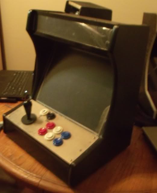

Apparently Sacramento likes that two player I built. Have several requests to produce more bartops. One 2-player, and two one players. This will be the home thread for the One Players.
Might be kind of redundant since I have made this design before but I like pictures so I am documenting this one too. Pretty much only difference in the one-player bartop is that it is of a higher quality wood than usual and will have CP art.

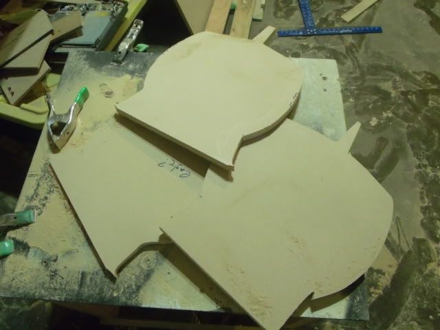

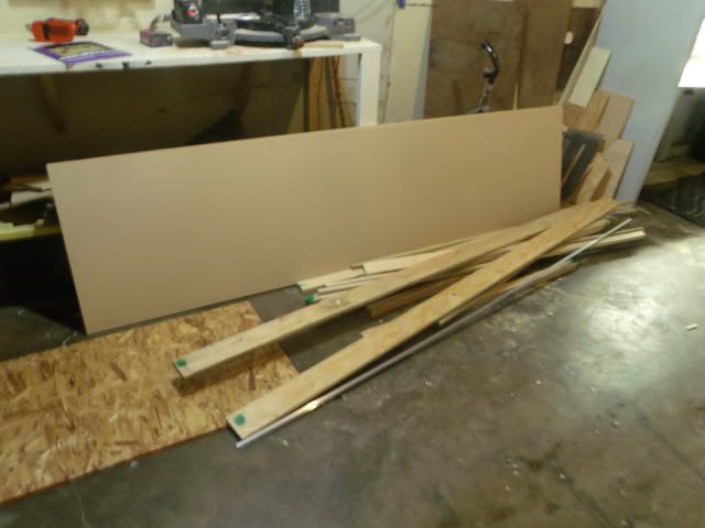

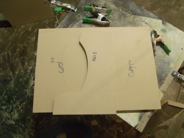

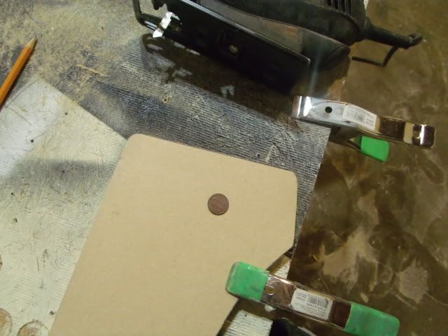

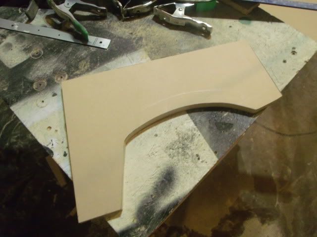

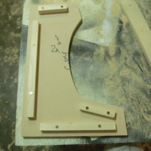

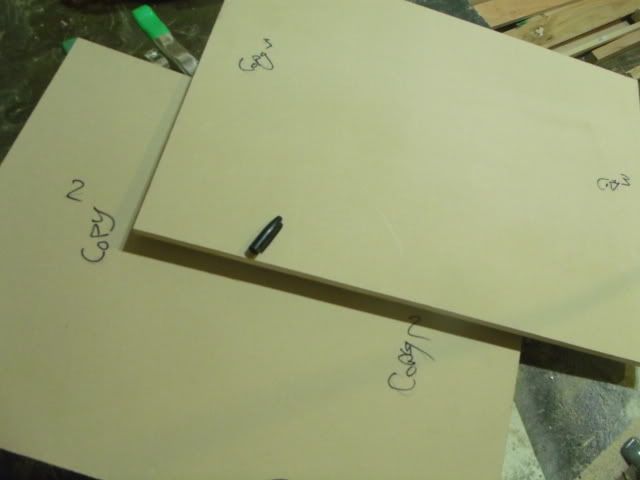

Purchased a 4' x 8' slab of MDF and had it cut in half. Also raided the scrap section of Home Depot while I was there.

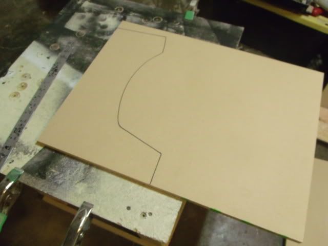

Template piece from before, traced
Rounded corners courtesy of one American penny
MDF chunks to make the side blanks

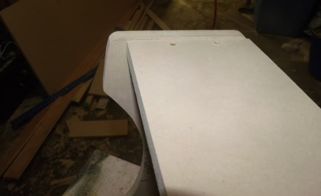

All pieces cut out with jigsaw very roughly on the outside of the lines to be cleaned up with flush trim router bit
A ton of dust kicked up from making these pieces
Not sure what to do with these pieces that were the negative of the side panels.......perhaps eagle stencil?

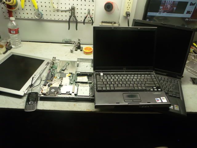

Anyways, have a ton of laptops from a trade to be the brains of these projects
I promise to make these of much higher quality than my "cheap arse bartop" collection. Already ordered 60ft of t-molding, a ton of thick black board vinyl, little tid bits too like multiple usb powered pc amps, switches, etc......

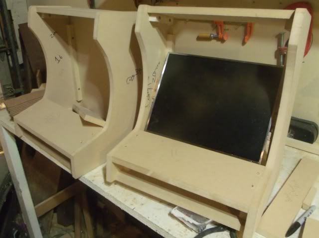

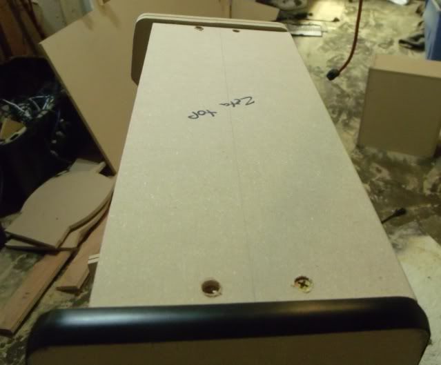

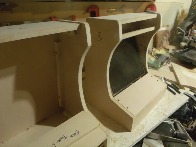

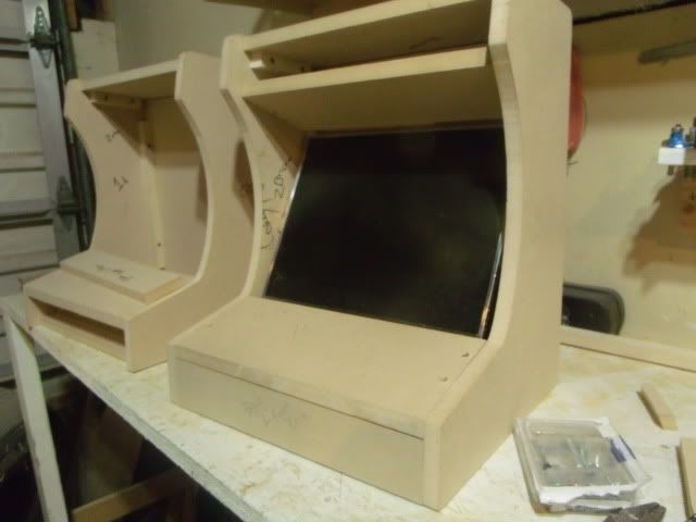

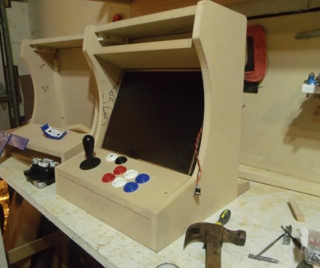

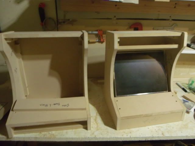

Going to just focus on these two until I figure the dimensions for the two-player one again

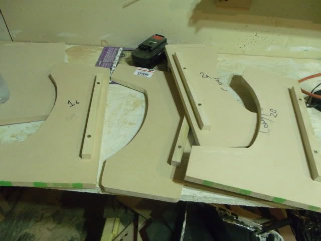

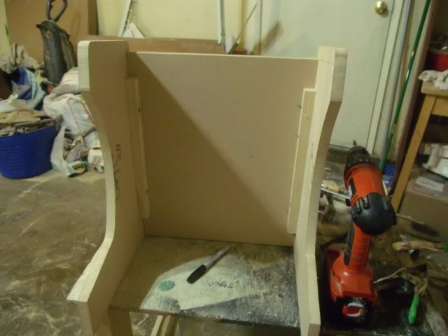

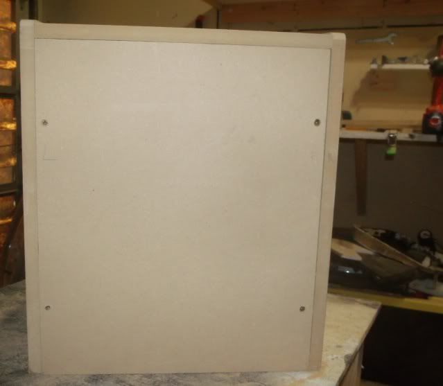

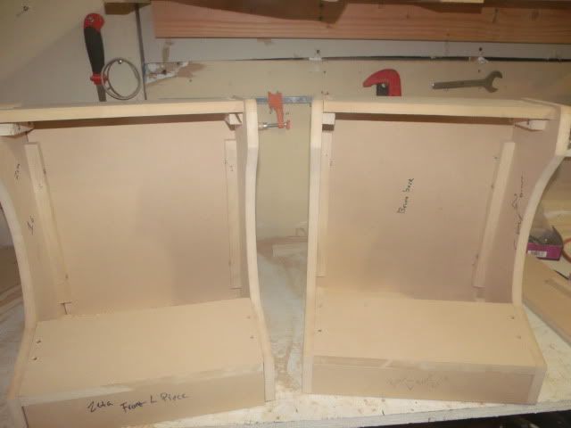

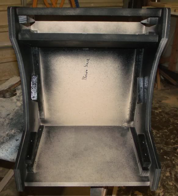

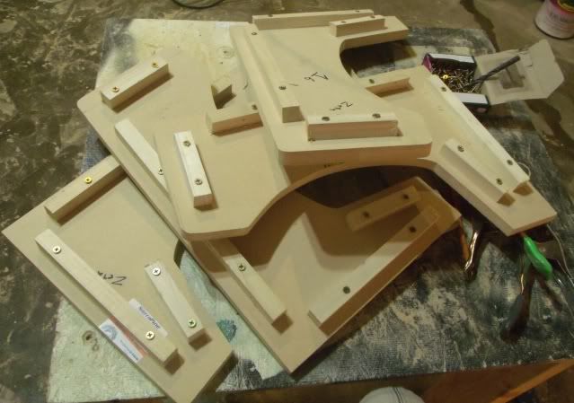

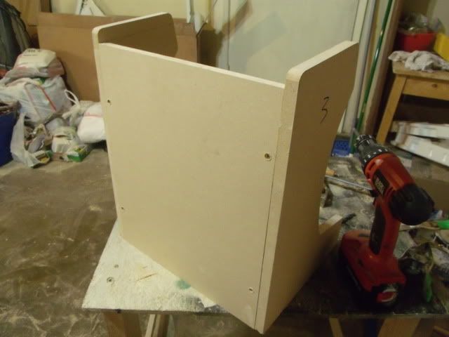

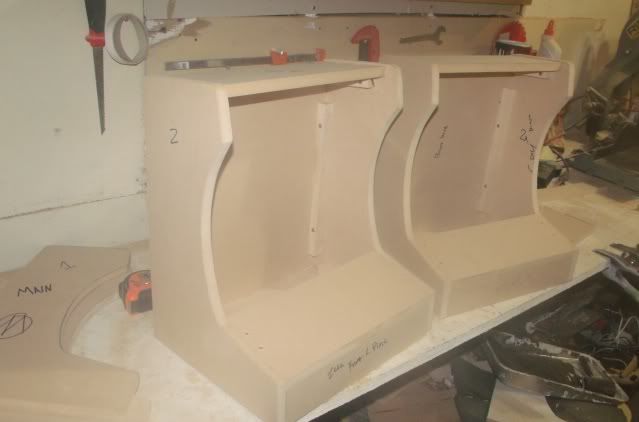

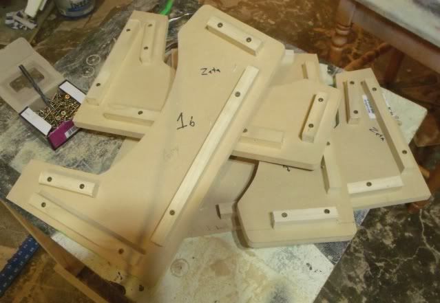

Frame supports
Two sets of side panels
Beauty shots
Screen mounted on one
Speaker panel added
Got a lot done in 24 hours, will continue some more tonight or tomorrow morning.
Thanks for looking.

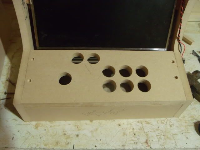

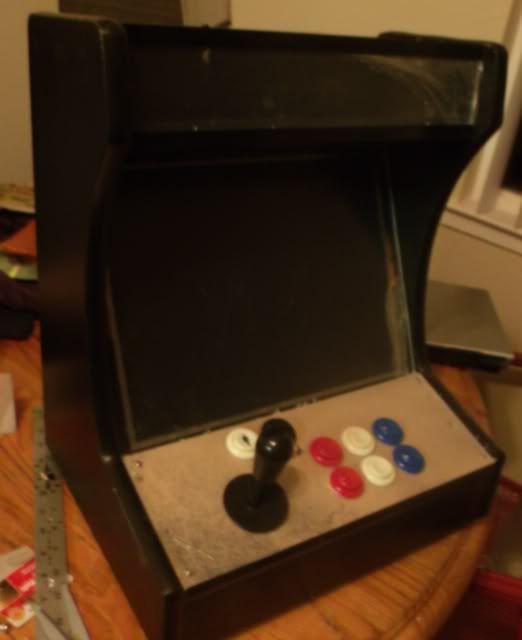

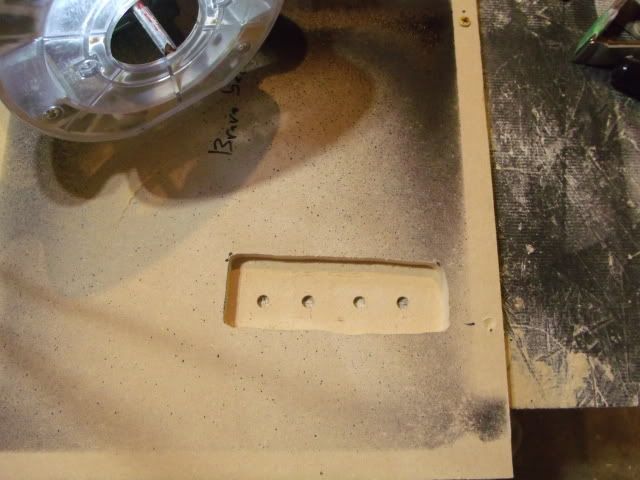

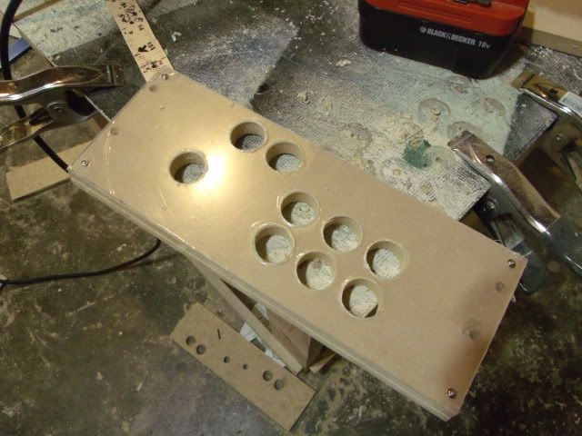

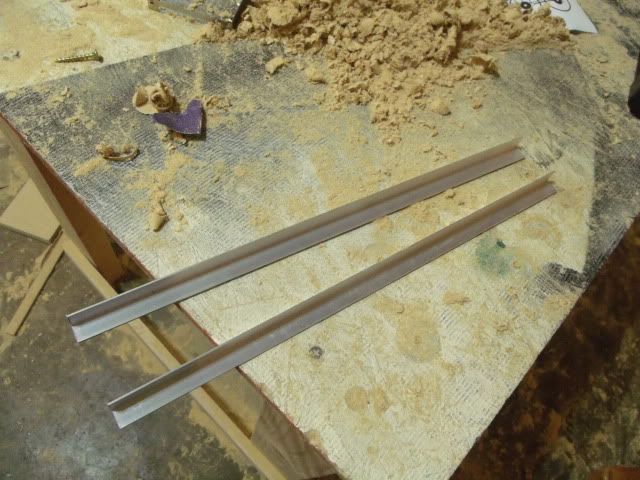

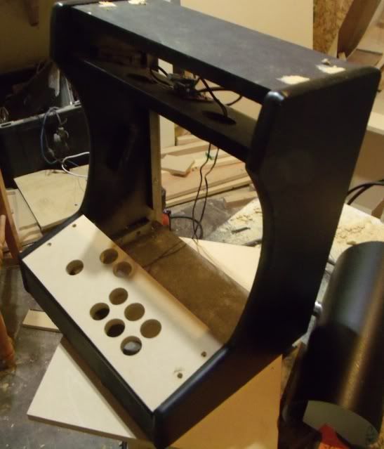

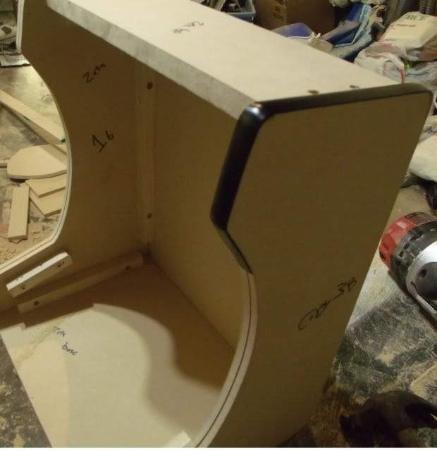

Holes drilled for the street fighter single player layout bartop
Found some aluminum L edging stuff at home depot that will make a much better marquee retainer than the last one

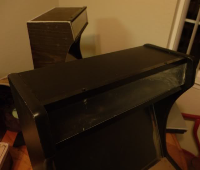

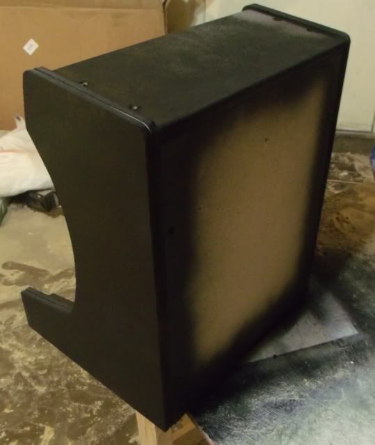

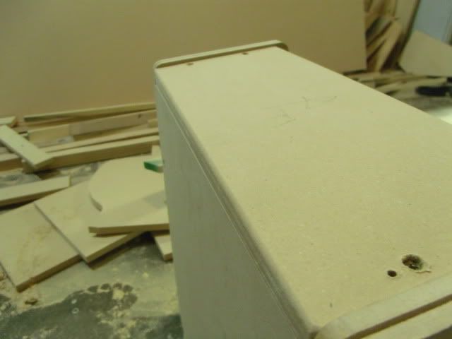

Routed for t-molding and put a test piece in. Also rounded the edge of the top piece so it doesn't stick out anymore.
Rough paint to hide any imperfections after vinyl

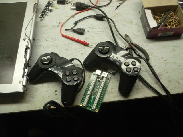

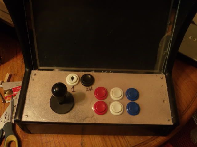

USB controllers came in and acquired an i-pac for the 2-player

Making two single player bartops and a two player. The i-pac was free (well part of a trade) and will be for a two player.

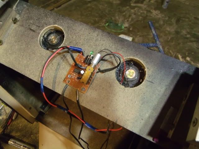

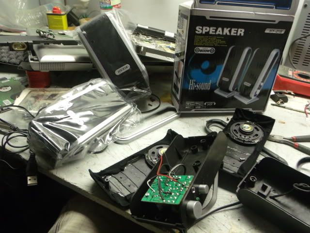

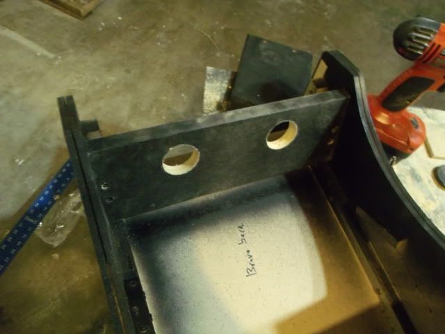

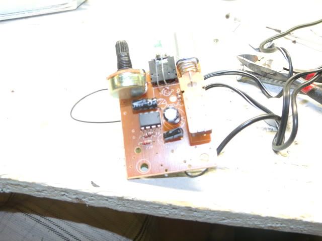

Decased the speakers, nice little mini amp
Getting speaker panel ready

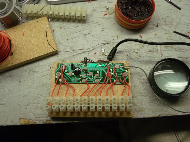

Hacked up the gamepad - did this twice, one for this build and one for the minecraft build

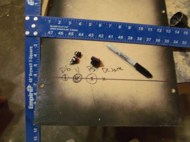

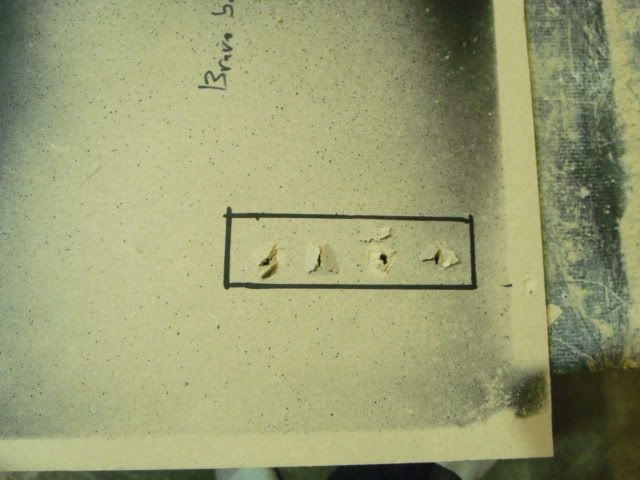

Drilling holes and routing out the back panel for the main power\volume controls
Everything fits, just waiting for the paint to dry
« Last Edit: December 03, 2012, 11:09:38 pm by CoryDee »

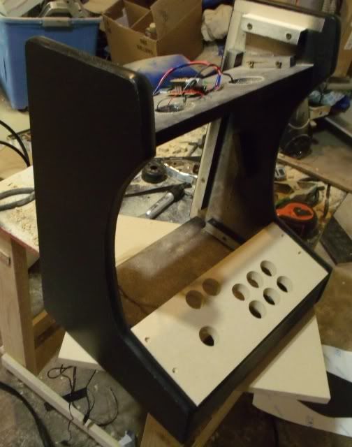

Audio stuffs mounted, T-Molding installed and vinyl applied

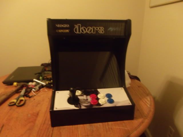

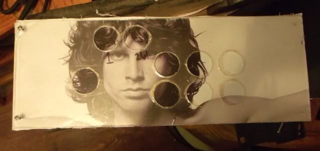

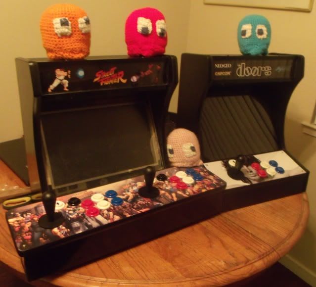

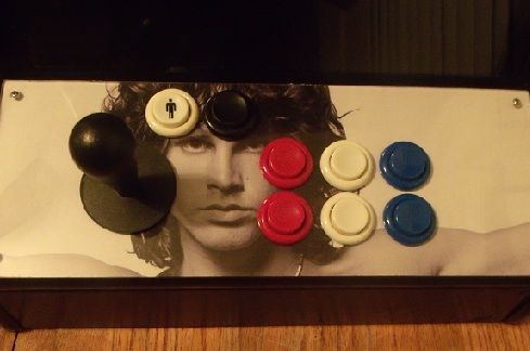

Just spoke to the customer and he picked out some art, so the arcade is officially Jim Morrison themed.....
Here is the art he wants:
- Marquee -
- Control Panel -
- Boot Logo -
I'm not a big fan of this decision, but hey it's his call  :dunno

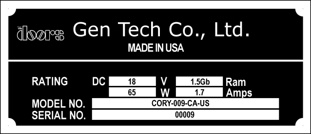

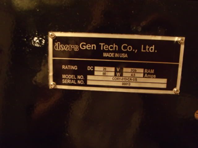

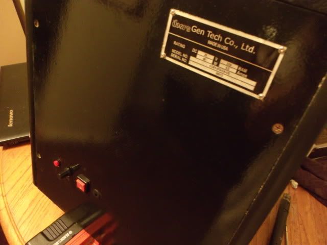

- Might as well edit the serial plate for it -  :banghead:
CoryBee
  • Posts: 2093
  • Bopity Boopy
Re: Jim Morrison Bartop??? - Plus Extras

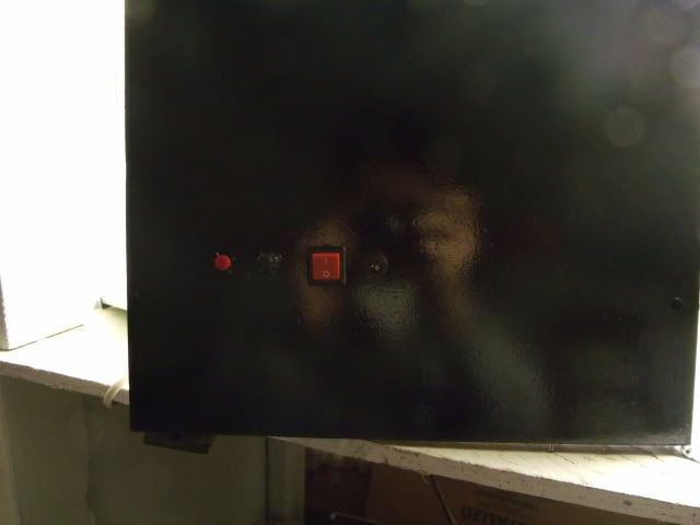

« Reply #28 on: December 05, 2012, 09:50:15 am »
Soldering to extend power button to the back panel

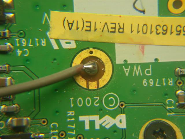

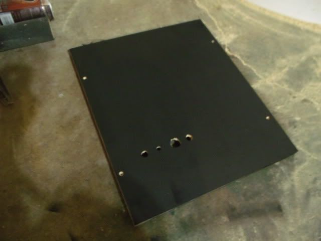

Got the back panel painted (gloss black) and the electronics wired up - tested sound and switches everything is a go
  • Posts: 9792
  • Last login:Today at 03:56:49 pm
« Reply #29 on: December 05, 2012, 02:55:10 pm »
Assuming "Ram" refers to random-access memory, it should be "RAM".
[/editor mode]

I really like those serial plates, maybe I'll make one myself as well
Just got my avery clear labels in, going to the ACE hardware around the corner for some clear coat
http://www.ebay.com/itm/390497865321?ssPageName=STRK:MEWNX:IT&_trksid=p3984.m1497.l2649

Flush trimmed the acrylic to fit the control panel and drilled through it for the buttons
Printed the serial plate
Now to wait for the clear coat to dry
CoryBee
  • Posts: 2093
  • Bopity Boopy
« Reply #35 on: December 06, 2012, 10:28:16 am »
Can't really see how awesome it looks without being in front of it. Worked out beautifully.
Shot with close-up lens - ( before I wiped it down to get the dust off for pictures )

Okay, so about the aluminum I used.... :-\
I couldn't cut the sheet I had in the garage, was too thick. Every time I cut a piece the edges were too serrated, need something else to cut it with.
So what I ended up doing was using soda cans, properly cleaned of course and only the best (A&W) soda. They are curved which is annoying, but was easily solved with a clothing iron. Properly flat after that, gives it the aluminum look and feel and looks amazing. Glad that KLOVER posted that video all them days ago

Thank you gnobar! If anybody wants one I can make them a serial plate (that is if you even like mine), only reason I offer it is because they are so light the postage would just be a stamp to send it out.

CoryBee
  • Posts: 2093
  • Bopity Boopy
Re: Confused Bartop??? - Plus Extras
« Reply #41 on: December 07, 2012, 03:57:41 am »

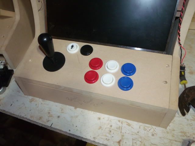

Test fit the buttons and joystick. Comfortable fit. :)
Also painted the marquee retainer black - (don't mind the dusty acrylic, will remove the cover when the art is complete)

« Reply #42 on: December 07, 2012, 04:42:08 am »
What kind of joystick is that?  It's very shiny!  Also, is it just me or is it not perpendicular to the control panel surface?
CoryBee
  • Posts: 2093
  • Bopity Boopy
« Reply #43 on: December 07, 2012, 04:51:59 am »
I got the stick in a trade, ended up with a bunch of computers, several joysticks and a hand-full of buttons. I think it was on something to do with street fighter, cause I got an XBOX arcade controller box with it all. There are no logos anywhere on it besides it saying "patent pend"
The base isn't mounted on it, just tossed it in the hole to see how it looks (still haven't routed the bottom yet)

Art re-sized and moved around to fit the size of the bartop
Marquee
Control Panel
Boot Logo
If I can get all the art done for these cabs in the next hour or so I can have it printed out today as well

Art printed

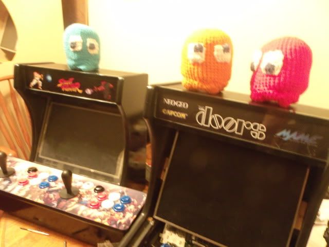

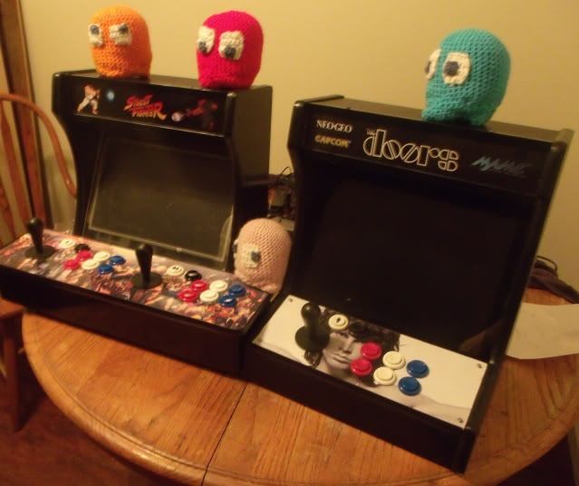

He picked it up yesterday and totally loves it.  :laugh:
1 down, 2 to go
