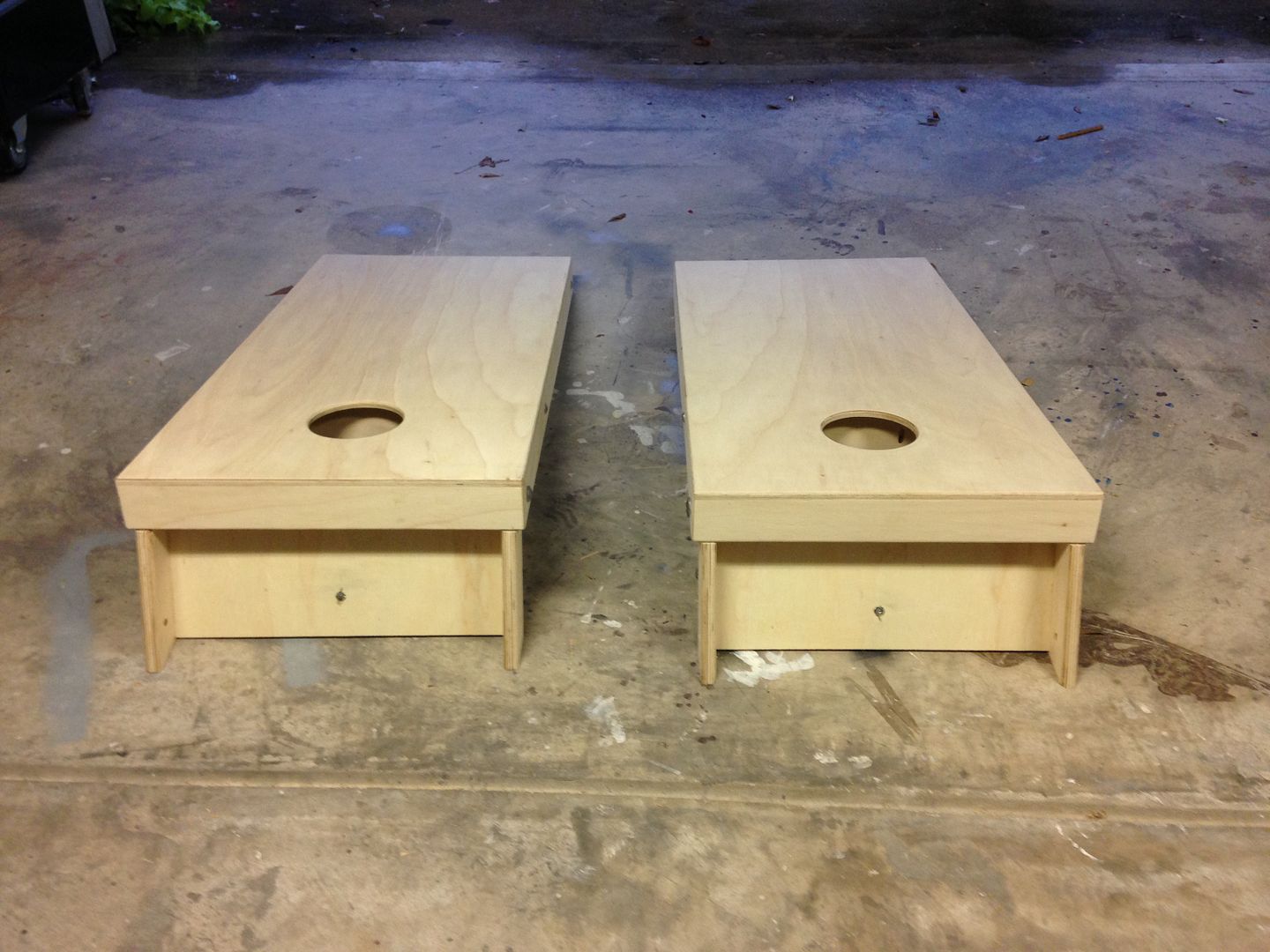

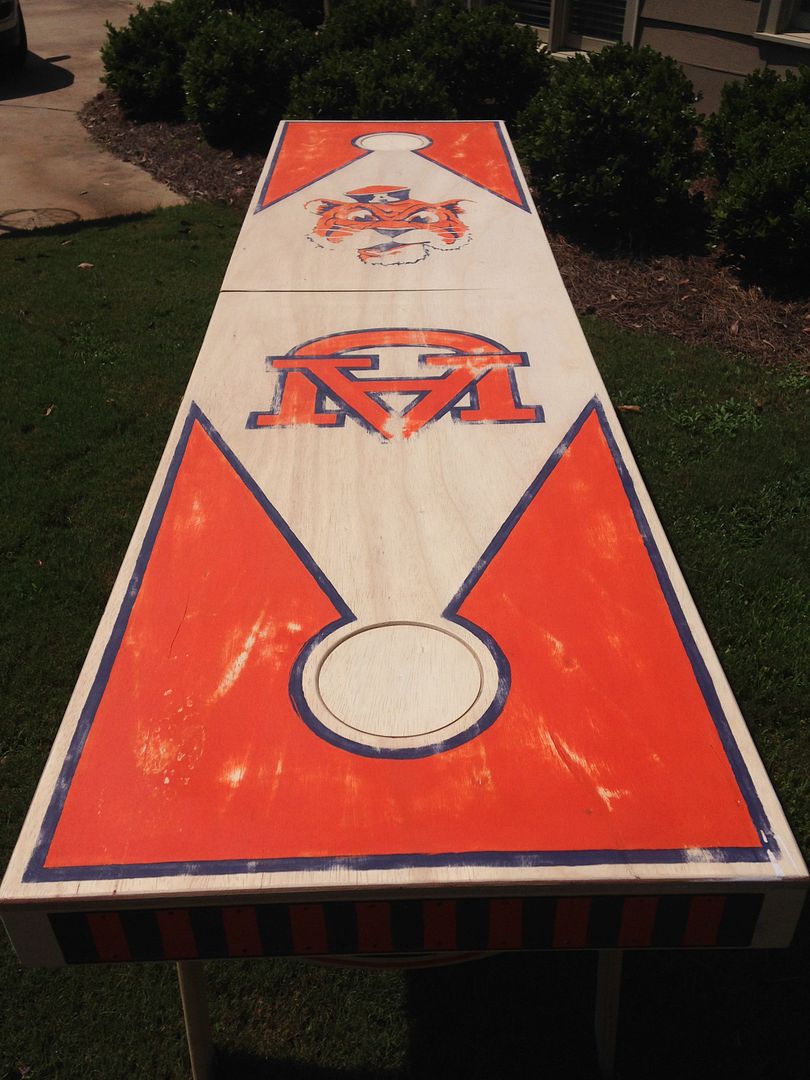

A buddy asked if I could help him build a cornhole set. If you're not familiar it's a bean bag tossing game usually found in the midst of barbeques and beers at major tailgating events.  He's a UGA fan (the concessions I make for some folks) so it got the appropriate paint job and he'll be tossing on all kinds of decals I'm sure.
This is my first set and I thought it came out pretty nice.  Not content to build a simple set I decide to make it a conversion so it can be used as a beer-pong/flip-cup table as well.  It will probably see some use for poker as well.  Basically I raped a folding table.
I'm itching to build my own now but want to do mine out of PVC sheet with pipe for legs and do a full vinyl wrap on it so I can go "full retard" with the art.  War Damn Eagle.
Anyway thought I'd post up some pics and and wanted to see if there are any other Holer's out there with a board to share.

Very nice.  A few friends here play a variant of washers called Grunt.  Not sure if they made it up or they just play it.  Fun enough if you have a lot of people around.

Hmmm. you could do some sort of vibration sensor (contact mic?) for on-deck hits, and a microswitch for  in-hole... then run the signals to a detached scoreboard... just thinking about how to pimp one out BYOAC style...
That's a good idea - tricky to implement with slide offs and bounce outs tho.  I added T-molding for a bit of arcade feel but it is in desperate need of feature creep.  I need to look into those scoring towers anyway.  I've seen some decent ones that double as drink stations.  I could probably implement a dart board as well but something tells me I'd need to go soft tip.

LeChuck, I like that paint job.  What kind of tape did you use?  A buddy suggested that I try Frog Tape and it worked out well.

That's a nice set. I'll probably stay away from the 4x2 full size and stick with the 2x3 tailgate size. I used Frog Tape as well, have a few very small bleed throughs that I had to fix. First time using it. Next time I'll base coat the tape with gesso like I usually do with regular tape. It did have a nice clean release. We haven't poly'd this set yet, good advice to use it to keep the decals down.
I had bleed through too and asked my friend who owns a painting company.  He suggested the Frog Tape and shared a few techniques that helped.  Common sense stuff that I should have known....   :banghead:
Hadn't heard of gesso before.  I'll have to look into it.

Gesso is a base coat used to prep canvases for other media.  It seals the canvas so the pigments don't run through the threads.  As a side use it also seals tape edges so that the paint doesn't run underneath and allows you to wet sand over the tape.  I usually use it and always get crisp lines.  Tried Frog Tape and really liked it but there is no substitute for old school.

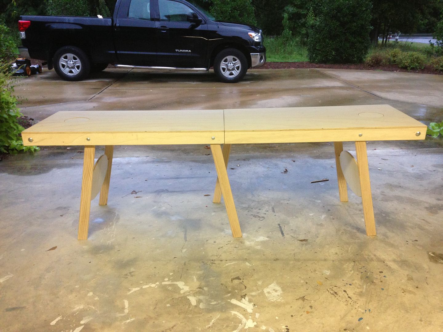

Necrobump because my favorite time of the year is soon upon us - the Fall, when there are tailgates everyweekend and public drunkenness is not only condoned but expected!!!
So at the top of this thread I made a corn hole/beer pong table.  There were several things right with this build but a few things wrong.  It was heavy - stupid 2x4 and 3/4" plywood heavy, and it was kind of a pain to get into and out of corn hole mode.  Fortunately it was for a friend, which is the best way to do new projects because they're always happy with what you make and you can make all your mistakes on theirs.
Well after some careful planning I am proud to present the yet unpainted but construction-wise finished BEERHOLEtm!!!
BEERHOLE is lighter but just as stable as the original, with no bounce play as a corn hole.  It is self filling - no more screwing in that pesky corn hole.  It is regulation size for both competitive corn hole and beer pong (yes that's a thing... god bless 'merica!).  Best of all, for a single person conversion it goes from pong to hole in 1 min flat and from hole to pong in 90 seconds.
Just need to get it painted.  Pics!
Beer Pong mode

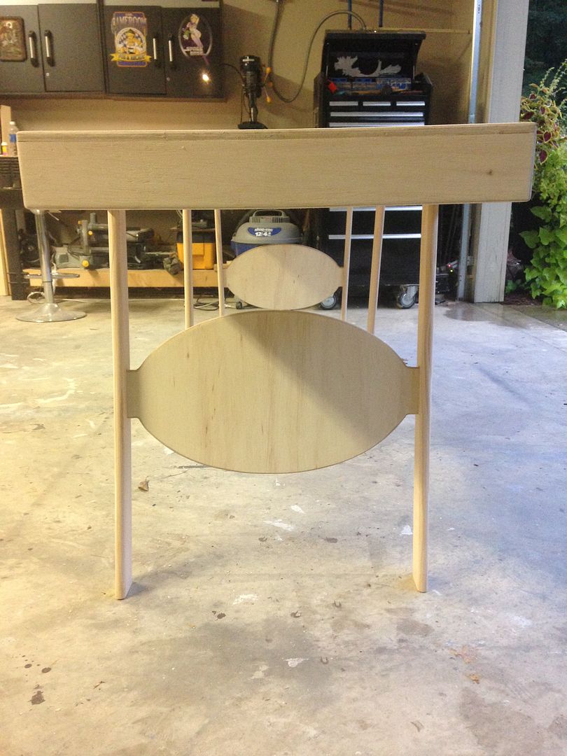

From the end

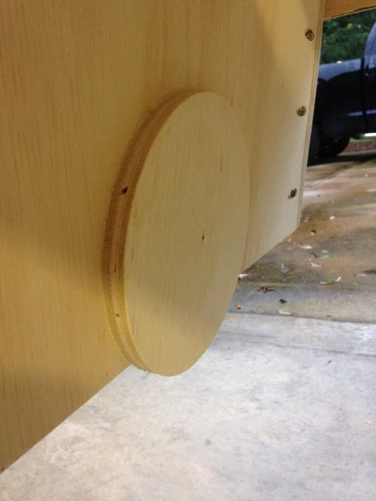

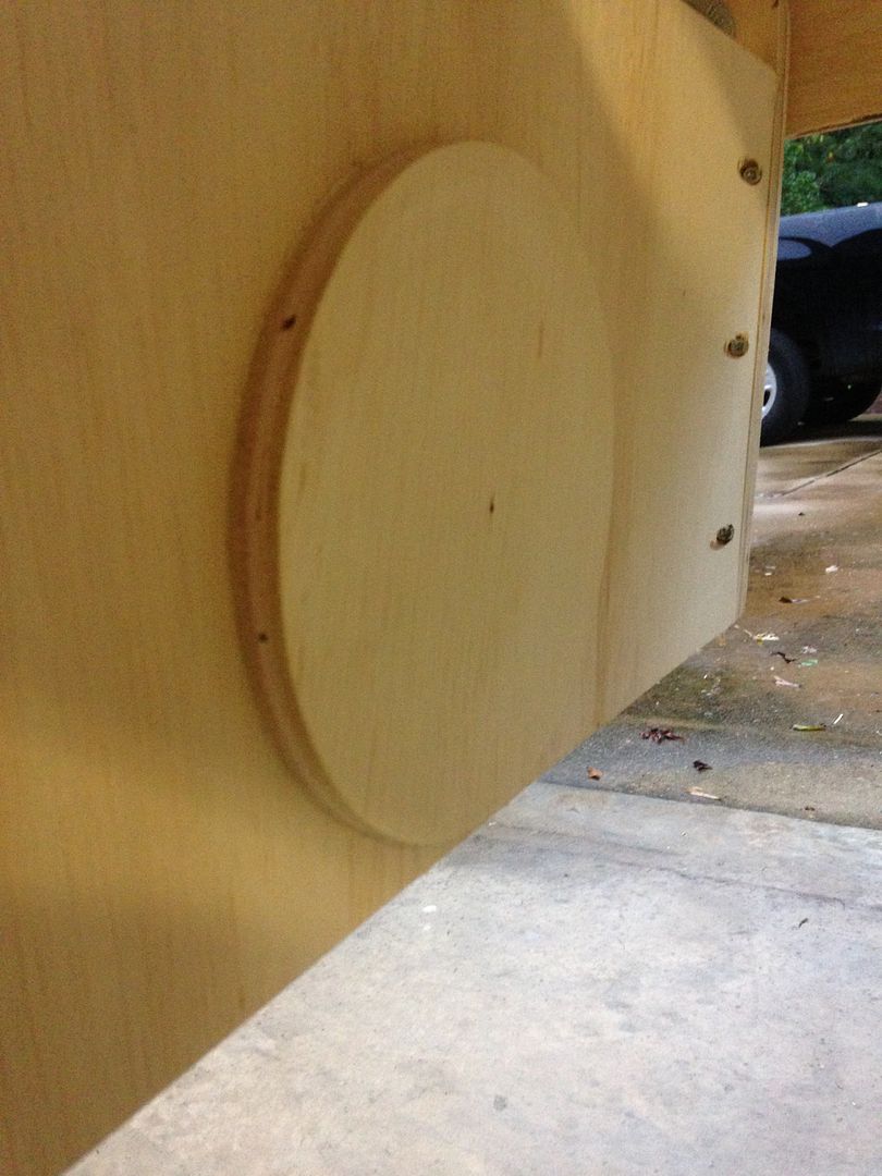

Detail 1 of how I cured that self filling corn hole issue, the disc is on a picture hanging type slide to allow vertical movement so it can clear the shift into position and also automatically tuck up when on the ground in corn hole mode.
Detail 2 of the same, just slide up for ground clearance.

That's a brilliant idea.  Great job.

« Reply #58 on: August 24, 2014, 12:45:30 pm »
Now all I have to do is seal it and it'll be done.

« Reply #59 on: August 24, 2014, 01:55:42 pm »
Is that 'worn' look intentional? I really like it.
Re: Show me yer Cornhole!
« Reply #60 on: August 24, 2014, 02:07:58 pm »
Yep. Terrified my wife when I spent hours painting it then she finds me sanding it down. I wanted to add some patina before I seal it up.

« Reply #61 on: August 24, 2014, 02:10:47 pm »
Awesome job, my friend.  :cheers:

« Reply #63 on: August 25, 2014, 04:42:22 pm »
Thanks guys, I need to do some work on the plans and get it converted over to mach3.  My buddy just bought a full sheet CNC and I get free tool time on it which means I have to start learning some software.  I want to focus on Space Base build wise for the next several months but I think there may be an attempt to go retail with this design.  Going to test it by throwing parties and going to fullball games with this season and see how it holds up.
I have to be out of town for AU's opening game but I'll get it to out to the first home game I can and see how it does in the wild.  Might bump the final up to a full 3/4" panel if I can get the full build out of a single sheet that way.  I think I might be able to swing it.  Maybe not.
