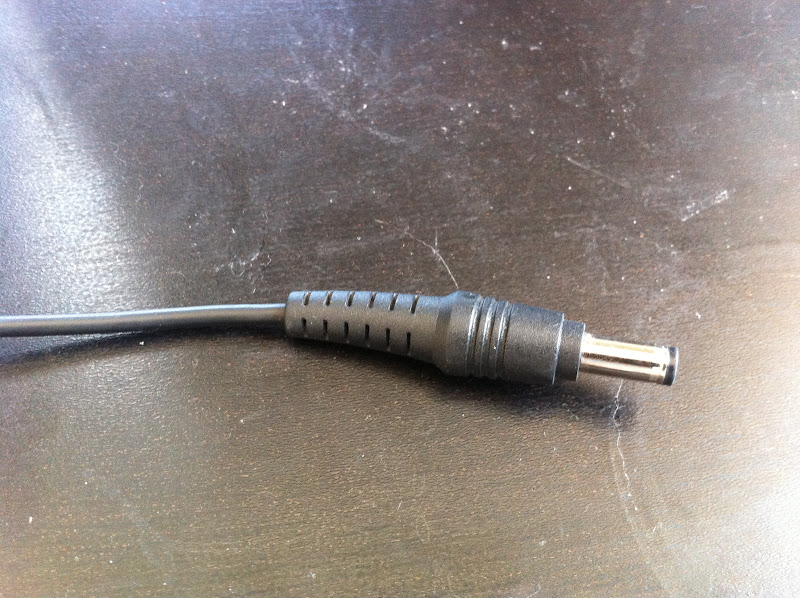

One issue I have been thinking about is how to mount the power plug, since it is side mounted.  Looking at the mobo and seeing where the cooling fan is, i am thinking giving it an extra 1/2" on that side where the power is would probably be good, and maybe allow me to not have to add an air vent over there.  I am going to mount the power block in the back of the cabinet so you can simply plug a molded cable into there.  I think I can probably take some of the extra plastic off of this power plug and really reduce how much space it needs along the side.
