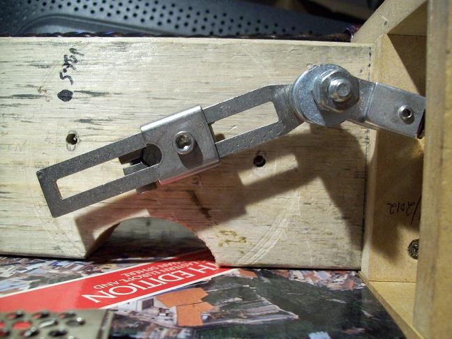

Ok, I have been working on a rig to rotate a LCD monitor using one of DarthPauls actuators. (Thanks DarthPaul!).
The initial test was a complete success.

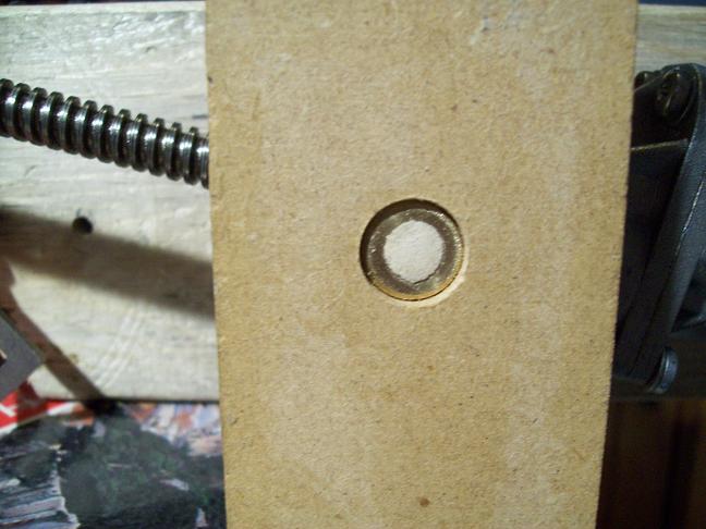

I have attached a picture of my test rig. It is strapped to a bar stool right now, notice the belt? (I have often wondered why God allowed me to get fat in my old years, now I know why LOL).
I used the same pine 2X4 rig I built for the stepper motor trial, which was a failure. The actuator, however works very well.

Here is a better picture of the rig. I added some labels to help explain what I am doing.

I found that it is not necessary to use both contacts on the limit switches. I just wired both the terminals on the strip for each switch to just the NC contact of the switch. So I adjusted this drawing to show that, no need to use extra terminals if you dont need them.

Ok, I found a limit switch arm that I figured would work and look better than the hastily thrown together crank I used to test the actuator rig.
I had to drill the hole in the center of the arm to fit the 3/8" shaft.
The arm had a roller on the end, I removed it and bored that hole out to 1/4"
It is adjustable in crank length and rotation angle on shaft.
I am happy with the way it turned out:
Next I made bearings for the actuator pivot points.
I used brass pipe plugs (3/8"). I drill out a hole in the center for the pivot. (1/4", a little big but as close to pivot diameter that I had). I then filled the plug with wood putty. The putty set up pretty hard. I did this to keep oil from soaking into the wood and to help steady the pivot. Probably  not necessary. Then I drilled out the wood putty (1/4") to the depth of the length of the pivot.
I then bored 1/2" holes in the wood supports and threaded the plugs in. It is a tight fit and I dont think they are going anywhere.
The actuator pivots a lot smoother and stays in line better.
Here is a pic of the backside of the bushing, showing the wood putty filler.
