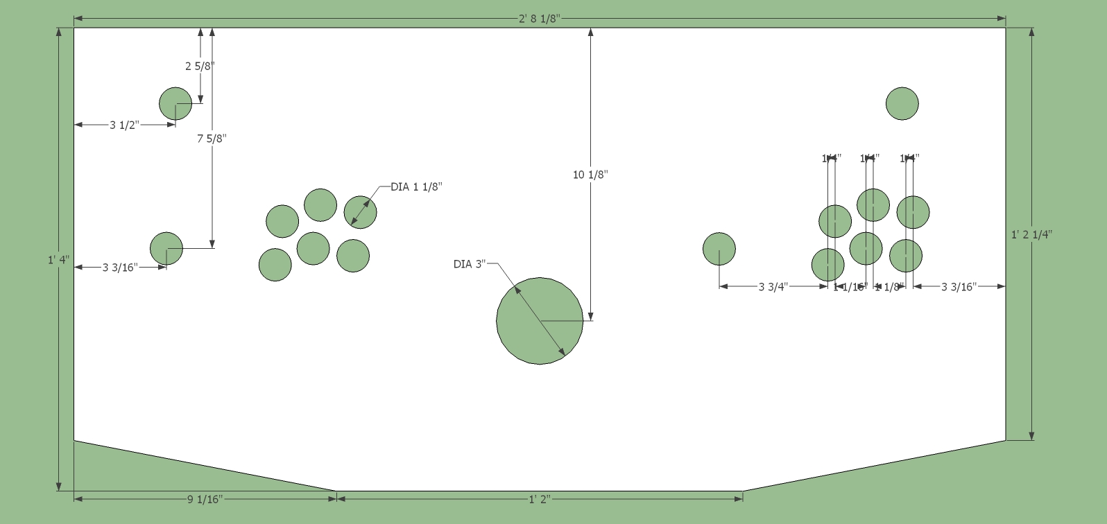

jimmy2x2x
  • Posts: 1215
Looking good, I would consider lowering the trackball down a couple of inches to give you a little more operating room when you are slapping the trackball - nothing worse than slamming your hand into a joystick!
Seith
  • Posts: 402
Great idea.  I would have to do some modifications to the measurement of the box.  Something like this?
+1 to moving the trackball down.  Also, that panel is a monster, 32+ inches?  Is that your cabinet width or are you going to be overhanging the sides?
Seith
  • Posts: 402
I have a 27" television screen I am putting into the cab, which I have planned around leaving in it's case.  As a result, my cab is pretty wide.  The control panel will not have any overhang.
I don't mind the width, although bringing it in on the sides would make it easier to fit down the stairs (as it is I have measured and I have about 2 inches clearance total on the sides).
jimmy2x2x
  • Posts: 1215
Not sure if the last pic is to scale, if it is the angle may be a little steep although this is very much personal preference.
Reducing the angle of the sloped top will allow more freedom in placing the trackball.
Green Giant
  • Posts: 1124
Yes, that is what you want to do.  Notice how the Terminus panel you linked has the TB lower than everything else.  This is primarily incase you do any type of goldentee game where heavy spins happen.  Since you won't be angling the monitor like golden tee dedicateds, you will want to give as much follow through space as possible.

Seith
  • Posts: 402
This is how it looks currently in Google Sketchup:
Seith
  • Posts: 402
I could build the box out so that the bottom lip of the box matches the angles of the control panel itself which would allow for me to put the trackball VERY low, but I don't think I have the tools to be able to do angled joints like that.  What kind of tool does cuts like that?
EDIT:  was able to bring down the trackball some without having to mod the box at all.  There is currently a 9" clearance between the top of the ball and the runner.
Also, I was mistaken - there is a bit of overhang on the left and right sides.  I hope to make the box in such a way that it can be removed for transportation.
« Last Edit: March 14, 2012, 06:14:56 pm by Seith »
jimmy2x2x
  • Posts: 1215
Looks comfortable to me
I have 8 3/4" clearance between the top of the ball and runner, 6" from edge of ball to right hand stick.
Plenty comfortable for me, my hand is 8 1/2" from finger tip to base of palm.

Seith
  • Posts: 402
So for now I think I am going to leave the box under the CP as-is.
Here is the updated measurements of the control panel (click for large):
I also had my first order come in a few weeks ago.  Here it is (with some buttons mounted into a cardboard box to get a feel for the button angling):
You'll have to excuse the crappy cellphone pics, I hope to have access to a better camera later on in the build.
The measurements on these aren't perfect, I did it more just to get a feel for the button layout.  Not sure i'm entirely happy with this, although it may feel different on the actual CP as opposed to this small box.

Just updated the control panel layout, using the slagcoin astro city button layout.
« Last Edit: April 24, 2012, 10:51:54 pm by Seith »
