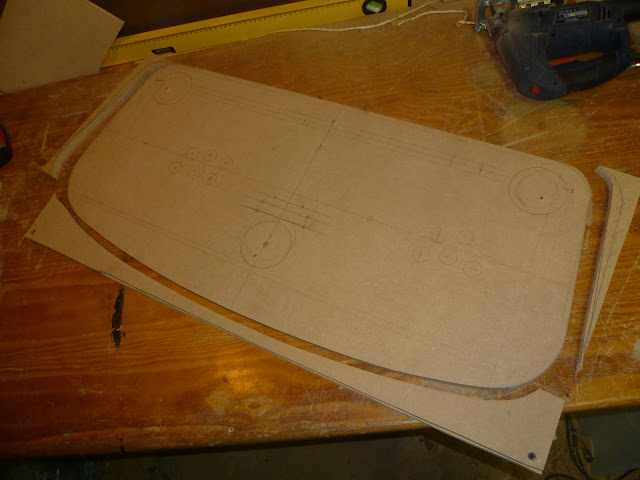

early plan to sketch out the idea:

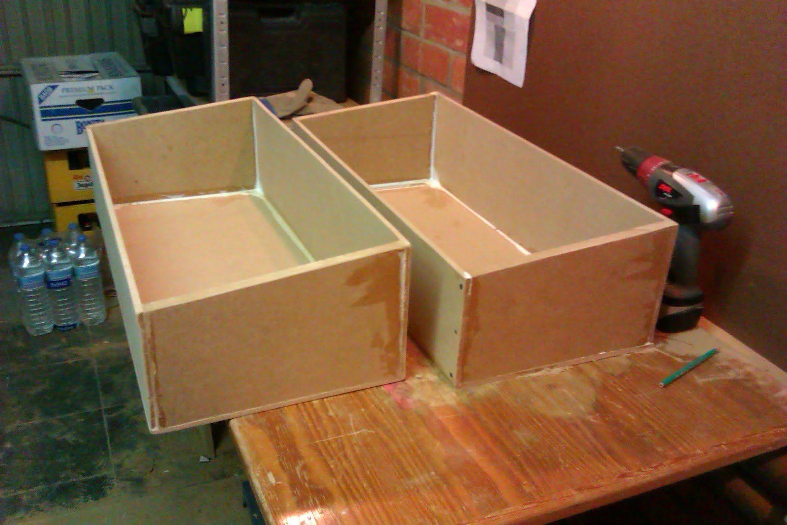

First building phase: the Box

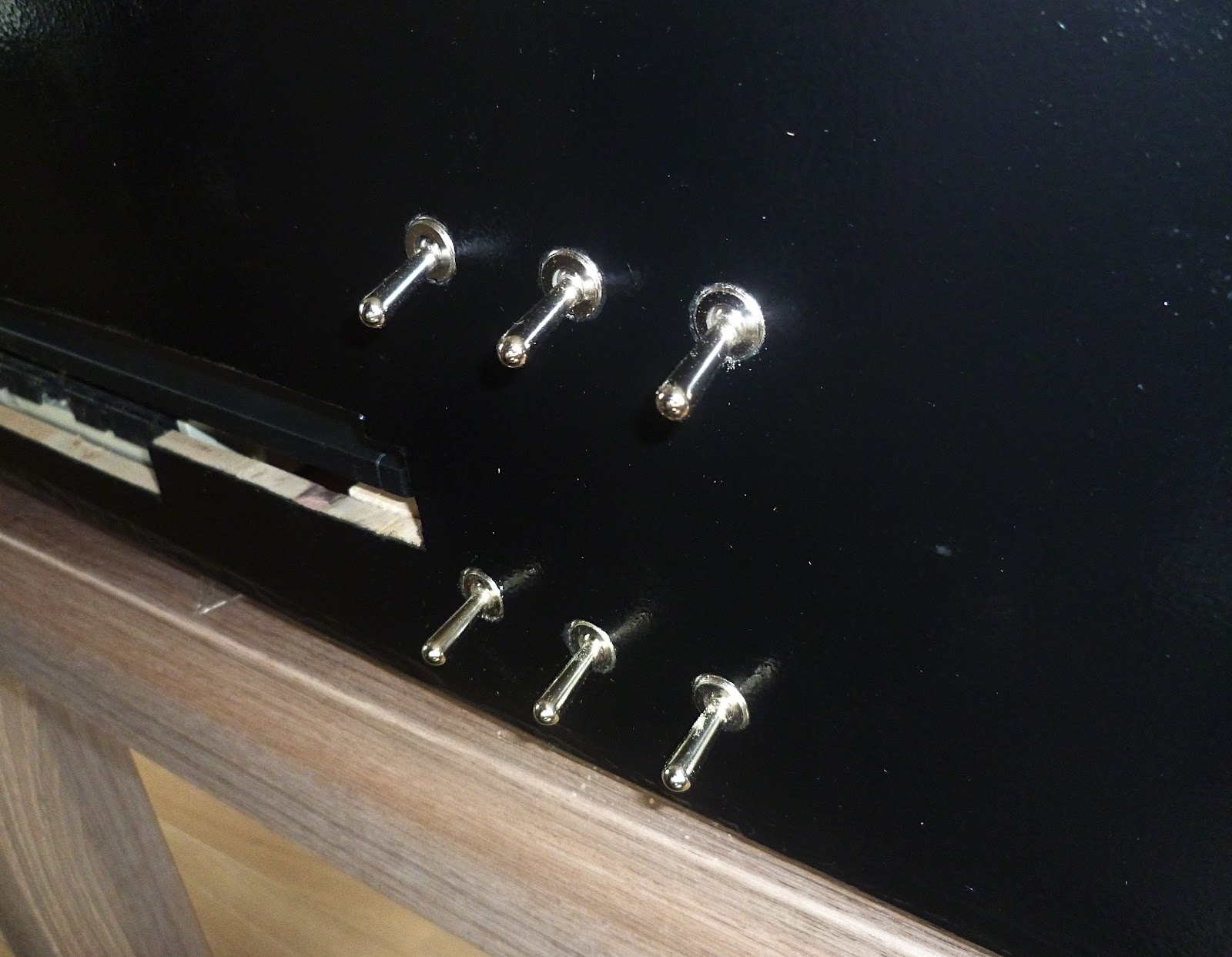

KevArcade: to turn the button illumination on/off, the KevArcade uses a set of chrome switches

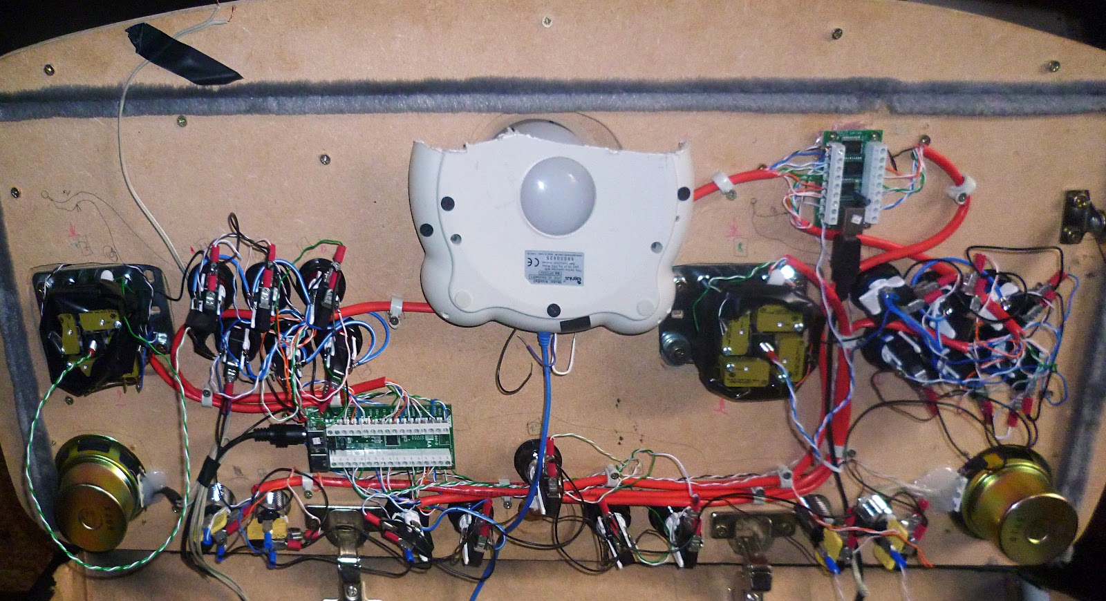

underside of the control panel. I hacked an old jumbo sized trackball mouse, replaced the yellow ball with a transparent ball and drilled a hole in the bottom of the housing, so i can add a led lamp to light it up
led light to light up the trackball - when the top panel is closed, it's positioned exactly under the trackball hole. But it committed suicide. Damn drama queen.
unfortunately my led lamp "blew up" with a sharp bang and a bright spark for an unknown reason. I'll be replacing it with another type soon. I'm not sure what happened because it had the right voltage and there was no shorted circuit or anything.
It just committed suicide. Maybe the pressure of playing the role of an element that brings such an amount of kickass into a project that oozes kickassness (retro arcade games are the summum of kickass) was too much for it?
Panel Layouts

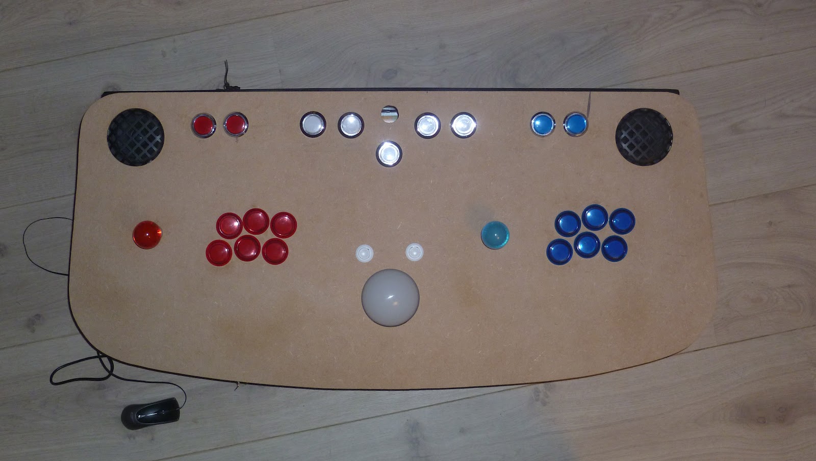

We're using slightly different layouts for the Sig- and KevArcade. The 2 boxes will have different finishings here and there (panel edges: plastic border vs "light rim") and a different graphic overlay on top.
Kevin's Arcade will get a Megaman theme and mine will get a blue/red brushed metal overlay, based on the design idea I had for my old arcade project. But It will be  more colorful this time :)
KevArcade panel cutout
SigArcade panel cutout with test fitted buttons

it's been very busy with work, so I had to leave the project for a short while, but now I have some new updates. I have the overlay print and sandwiched it between the panel & plexiglass. It's looking good :)
I also made some button graphics to put inside the buttons. i printed them on transparent "overhead projector paper". I had to print twice on the same sheet to get good light blocking black. i still need to make a "start-select-OK" button. But I'm not sure what to make. Maybe those three words in a retro font OR just the "play" triangle from tape recorders. But since this button functions as select/launch game/select character in some games, I think the 3 words optin might be more logical.
Or maybe just "OK"? or...
I can say that now it's officially almost done. Just some final touches here and there (such as rims around the speakerholes, adding a black plastic finishing around the keyboard hole in the front, ... )
I am going to add 2 light guns, but I see that as part II of the project so for now, part I is nearly done.
The button lights look prettier in real life... shiny and colourful :)
the new trackball light still needs to be added.
HS control buttons on top: (exit - pause - start (still need to make a graphic for that button) - genres - favourites)
close up of genres & favourites:
coin-player II
