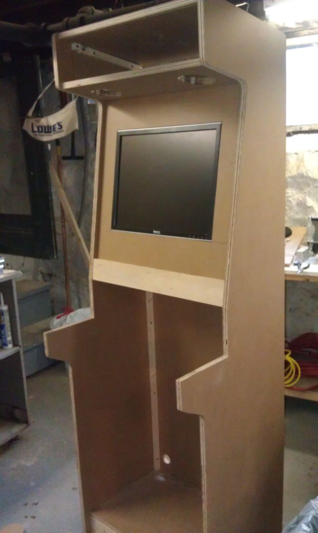

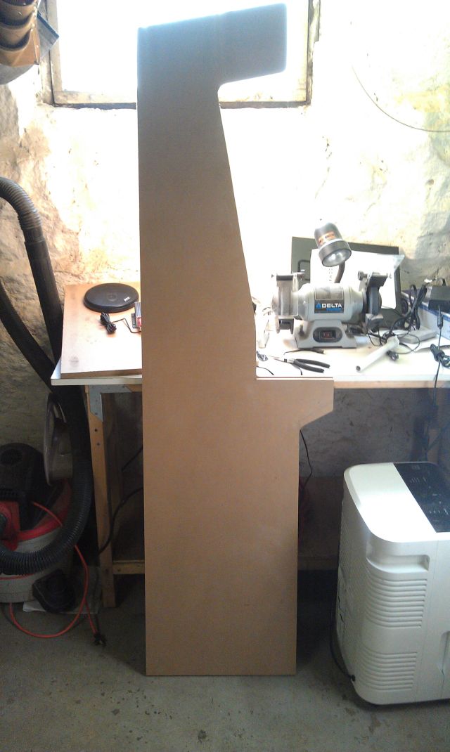

I have begun construction on my first build.  It is a slim cabinet with a 20 Dell 2007FP IPS panel for a monitor.  The design is a mashup of the many slim cabinet projects that I have seen on this forum.  It is certainly inspired by Knievil's Evolution build as well as Alfonzotan's build.  It has a depth of 17.5" and is 24.5" in width.  I will be running Hyperspin as my front end.  The control panel will be the typical Knievil design with 3" trackball, spinner, dedicated 4-way stick, and two eight ways with 6 player buttons each.  I have ordered led strips for the marquee since I don't have a whole lot of space for the light.  I will be using 4" car speakers and a Lepai amp for the sound.  I build the cabinet from 3/4" MDO which has been great to work with.  I have run into a few problems along the way since I am not really using plans to build this.  Routinh the slot for the t-molding was one of them.  I screwed that up pretty good because my router plate was sitting a fraction of an inch lower than my router table.  It has been challenging learning how to try and get this right the first time.  I have good woodworking skills and a great shop with a cabinet saw, router table, jointer, 14" bandsaw, floor standing drill press, and even a wide belt sender.  Even with all of this it has been a challenging project.  Kudos to those of you who build beautiful cabinets with limited tools.  That takes patience and some ingenuity.  My next step is to finalize the artwork.  I have always liked the cosmic frostbite image in green.  I know it isn't very original so I am looking at doing something different.  I am having a real hard time naming the machine.  I know that it will be something cosmic so if you have any ideas for me I would love to hear them.  Anyways, here are some pictures of my progress so far.  Tonight I work on the keyboard drawer and the front door.  I have to mill up some edge banding material out of hardwood for the door since I am using MDO plywood and the edges would be exposed.  Thanks to everyone for the inspiration.
The profile
On the base with the back, top, admin panel, speaker panel, and monitor attached

Re: First Build - Slim Cabinet - Not raising the bar at all.
« Reply #1 on: February 21, 2012, 04:37:09 pm »
Looking good. Have heard of MDO but I haven't seen it in these parts yet.
I recently discovered Superlight MDF and I've been pretty giddy about that. Perhaps MDO is even better?
Great choice of monitor. Use them in all my builds.
No need to raise the bar, just build something you will be happy with.
