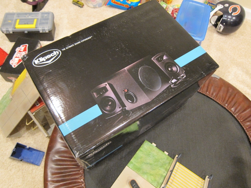

I needed to get my cabinet speakers out of the basement so today I finished installing them in the the cabinet.  For speakers I went with pretty much the same method that is recommended in the Project Arcade book.  I got a good deal on the Klipsch ProMedia 2.1 speakers just before Thanksgiving.  A bit overkill but the sound is great and I'll be prepared whenever the Mamedev's get around to converting Pac Man to stereo sound.  :cheers:

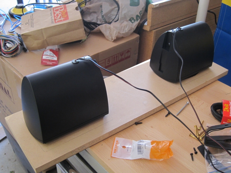

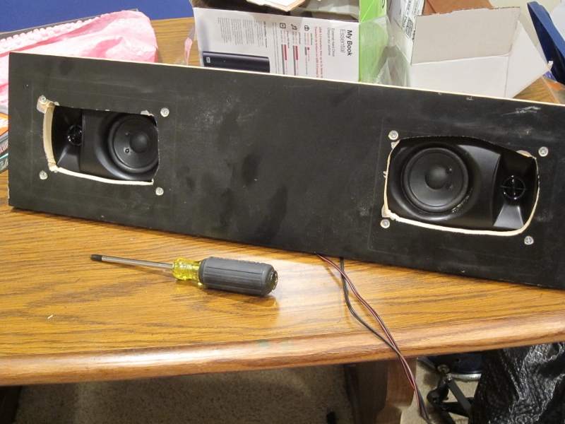

I took a scrap piece of MDF and cut holes for the speakers.  As in Saint's book I drilled holes through the work piece, removed the screws holding the speakers together and used longer screws to attached the speakers to the work piece.
There is a slight gap because the speaker's are rounded.  I don't want any light from the Marquee to come through the speaker grills so I sealed the gap with a little electrical tape.

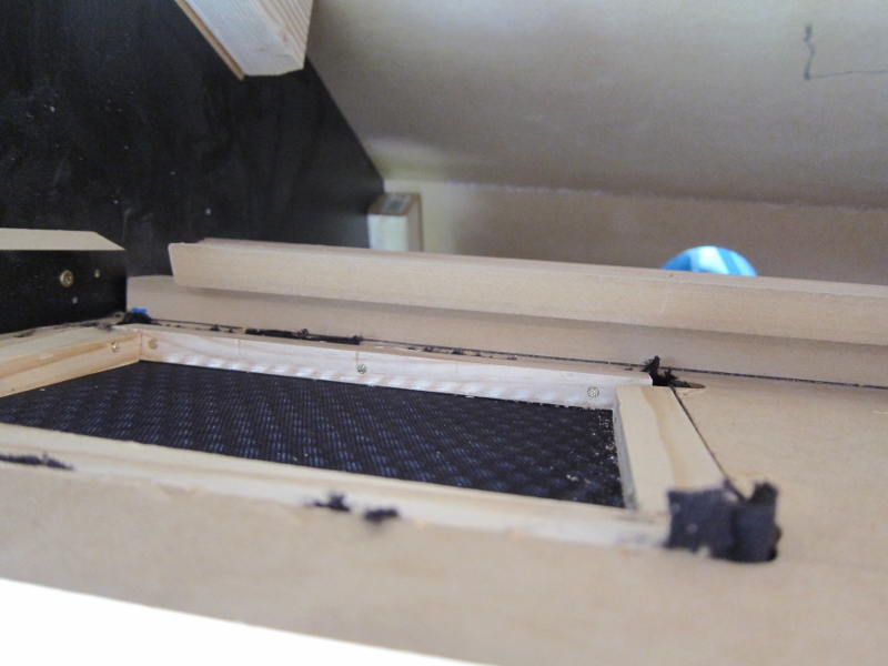

I wanted to install the speakers after the cabinet was put together so I added a lip at the back of the speaker grill shelf so I could just slide the speaker assembly in place.

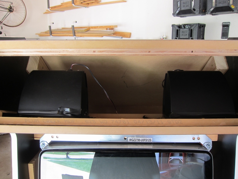

Here it is installed in the cabinet.  The lip makes it so I don't have to worry about trying to screw the speaker shelve down in back.
I just slid the speaker grill in place (making sure it fit securely under the lip) and put a couple of set-screws to hold it in the front.  This way I should be able to easily remove the speakers if I should have the need in the future.
