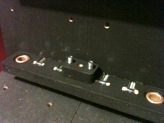

Bronze bushings
The bronze bushings from TechPaladin.com arrived yesterday. I now understand the "self-aligning" feature of those parts. They glide so smoothly on the printer/scanner rods that the LM8UU linear ball bearings seem really inferior by comparison.

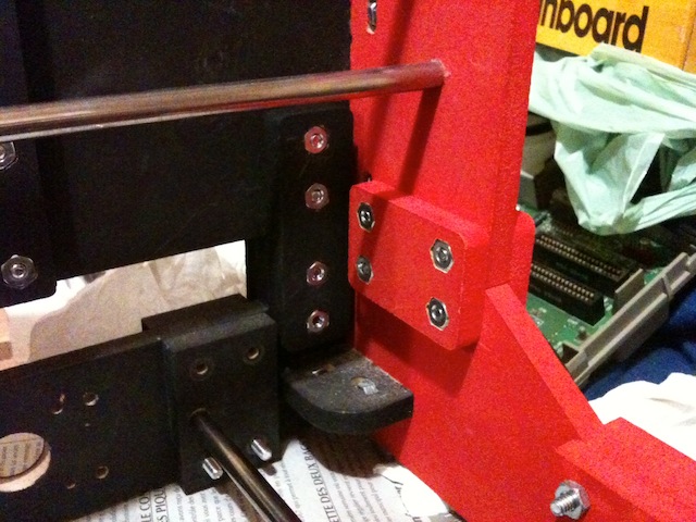

New assembly plates
I was really tired of having bolts and nuts sticking out everywhere inside and outside the machine that I'm replacing the assembly plates with new ones that feature custom-cut countersunk holes for the bolt heads and the nuts. Yes, hexagonal holes.  :D
Threaded rod drive
Previously I talked about threaded rod drive versus belt drive, I tried making CNC64 bigger to be able to at least cut the control panel for MVS-99-6, etc. The problem is, the base of CNC64 is too low-profile to convert it into a belt drive CNC but I also didn't want it to go to waste. So I tested with a #6-32 threaded rod and nylon nuts and the result is nothing short of amazing. Using a nut on both sides of the moving platform, I can't feel any play and it turns extremely smooth (plastic on metal). I had to make tiny plates to hold the nylon nuts, using the same countersunk hole method as the new assembly plates.
So the goal is to complete CNC64 using this new method, along with its first copy. Oh, didn't I mention this already? There's another CNC64 machine that's nearly complete. It's not a clone since it was cut by the MDX-3, but it's a trade between me and my friend for the stepper driver board I mentioned in an earlier post.

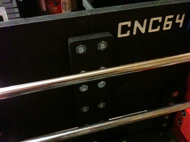

Okay, so those bronze bushings really are precise. More precise than my MDX-3 is at aligning two holes, apparently.  The LM8UU didn't seem to complain about my rods alignment but the bronze bushings always seem to jam near the end points near the plates supporting them. I have checked my measurements three times and made a series of four test plates. Nothing seems to help.  :cry:
So I'm modifying my approach to have bronze bushings on one rod and Lucite plates with elongated holes on the other rod. After re-checking my old Roland MDX-3, it seems all its axes are build this way, bronze bushings on one rod and a simple two-pins plastic "fork" riding on the other rod. To avoid bending/torsion, the force is applied on the side with the bronze bushings. Most printers and scanners are also built this way, two bronze bushings on the belt side and the other side just rides directly on a little wheel or on plastic.
Since Lucite is an extremely hard plastic, it takes around 4 hours and 45 minutes for the MDX-3 to cut a single plate. It's going to take six of those plate. One down, five to go...
The edge is not clean at the bottom because my CAD program still lacks tabs.
Edit: I have now added "ramping cuts" for some functions of my CAD program, the MDX-3 can now cut one of those little Lucite plate in 30 minutes and one of those 2x2 holes MDF assembly plate in only 16 minutes.
Edit 2: ramping cuts are nice but cutting too much material puts stress on the structure of the MDX-3 and the cuts end up all wrong. Back to the old cutting speeds.  ::)

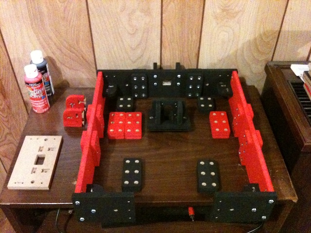

« Reply #181 on: November 25, 2013, 12:40:27 pm »
Some panels still needs a coat of paint, otherwise the Z-axis is completed and 100% working. It's also using four 8mm bronze bushings. The MDX-3 isn't precise enough but it's always the same lack of precision, so after doing a few tests plus/minus 0.1mm of what I need, I can get usable parts that are aligned for the rods and bushings.
The new Z-axis is also a lot more compact and lighter than my previous one. The old surplus 4.00$CAD Japan Servo KP4M2-008 motor has no problem whatsoever moving the Black & Decker RTX up and down, so the other two motors won't have any problem with the X and Y axis either.
The green panels are discarded cuts of Sonopan sheets, given to me by a cousin. I've calculated that I have just enough to make a soundproof box for my belt-driven CNC. I'm still debating on how to do the actual box. I have enough hardboard but I don't think it would be strong enough for a box that size.
Now that the smaller and most problematic axis is done, I'll continue with the other two. I'll do the X-axis next since that's what the Z-axis is connected to. I already had the Y-axis working with lucite plates on one side to prevent binding/sticking though. I'm going to try switching to four bronze bushings there too.
Hopefully, at the current rate, I should have the first CNC64 up and ready before Christmas. If all goes well I would like to have the second one ready too, since my friend has been waiting since this summer.

CNC64 - MDX-3 upgrade: dumbgineering (2014-05-04)
« Reply #192 on: May 04, 2014, 10:31:00 am »
I made a serious mistake with the new Z-axis assembly. I guess I was tired when I did the mistake, because it's really dumb.
Here's how I designed the assembly in Sketchup:
But since I wanted to have flush bolt heads:
I had to countersink the bolt holes:
However, since the design required a slot for a part on the back:
I had to do the countersink on the other side:
But I had to do that countersink, manually, with a drill bit on the other side:
And what had to happen, happened. The thin wall of expanded PVC broke, the bolt could no longer hold the part on the other side, the RTX mount wasn't tied to the Z-axis assembly anymore, the RTX became randomly offset with the programmed pattern and the end mill bit just continued cutting anyway:
Ouch.
I learned two things from this mistake:
  • the RTX is powerful enough to cut at least 1/4 of the thickness of the MDF at a time, so I'll program deeper cuts next time, maybe 1/16" just to be on the safe side. With 3/8" thick MDF, this means only 6 passes to cut through, compared to my usual... 70 or so.
  • The RTX is powerful enough to actually burn the end mill bit, that means I don't have to worry about the power of my spindle anymore, which is a good thing for future cuts with my modified "Roland RTX-3", for CNC64 and for CNC86.
I'll patch the broken part with a big washer, offset the bolt head thickness with washers, cut new Z-axis assembly parts again (maybe in double, to have a backup), order more Dremel #650 end mill bits (with a few spares as backup this time) and continue forward.  :laugh:
« Last Edit: May 04, 2014, 10:56:09 am by Yvan256 »

« Reply #198 on: May 20, 2014, 06:54:39 pm »
Since I need to cut new plates for the Y-axis for the belt drive, I've decided to try to fix the bushings alignment problem.
Lucky me, the new design for the part "Y1" fits four times on one plate.
The new Y-axis assembly design has seven distinct parts, with four plates having one bushing each. Two top plates will then join the front and back plates+bushings and the left and right side will be joined together with a plate with slotted holes. The end result is something that can be easily aligned after assembly.
Here's an exaggeration of the "sliding" design that should allow perfect alignment with the Y-axis rods. We're talking about plus or minus a fraction of a millimetre here. Alignment has to be perfect, as I learned the first time around. Those bushings are extremely precise.
And here's the four Y1 plates with their bronze bushings.
Belt attachment design and three more plates to go.
« Last Edit: May 20, 2014, 07:02:42 pm by Yvan256 »
Yvan256
  • Posts: 1043
    • Yvan256
CNC64 - Y-axis, first half (2014-05-21)
« Reply #199 on: May 21, 2014, 07:02:19 pm »
If I had started cutting panels this morning instead of this afternoon, I'd be almost done with this...  :(
Oh well, here's the almost-first-half of the new Y-axis assembly.
Half-enjoy!
