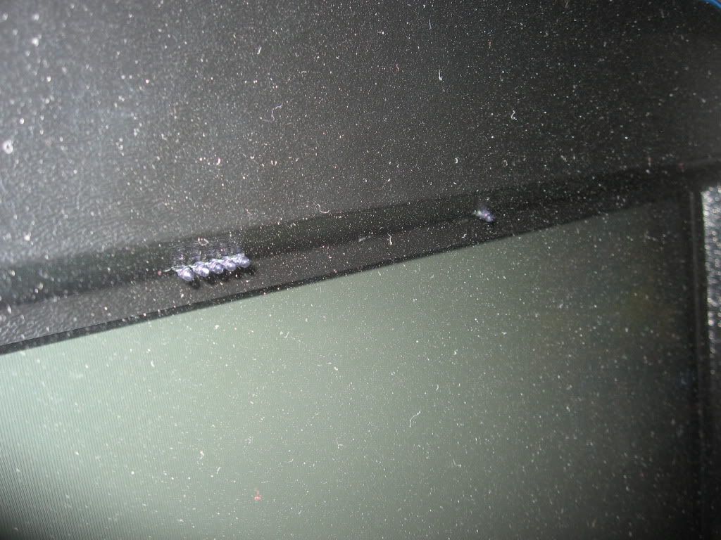

I've got the D9800 and the Happ bezel, and I mounted the LED bar through the bezel.
I also tried the silver act-labs gun, but I couldn't get them to work.  At some resolutions the whole screen wouldn't flash, and on other resolution the accuracy was off more than a few feet away from the screen.
The Aimtraks are pretty good.  The only downsides are the calibration being off for people much shorter than me, and with the big size of the D9800 I've got to be back from the screen just a bit further than I'd like to hit the bottom.  Otherwise, they are extremely flexible and accurate.  They work fine through my tinted glass.
