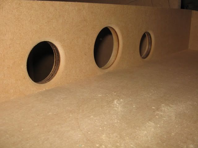

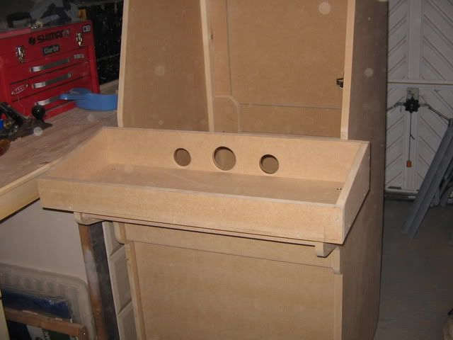

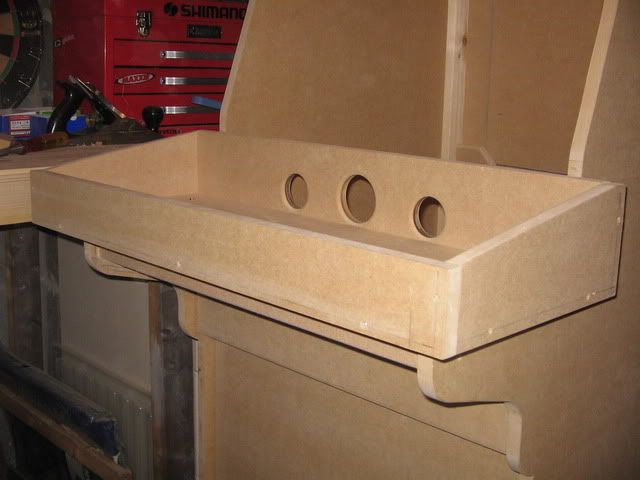

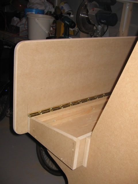

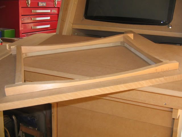

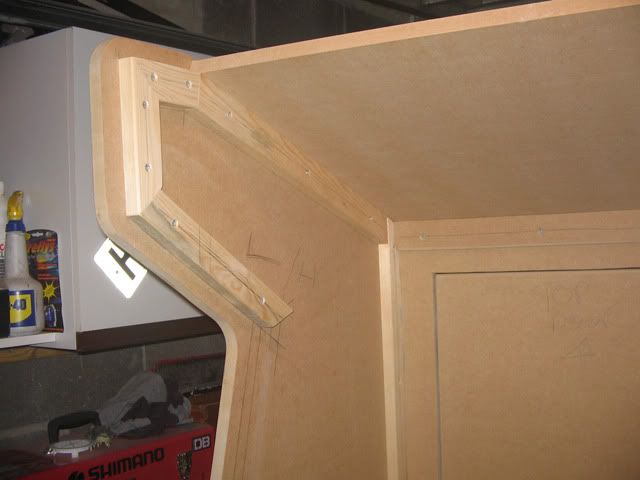

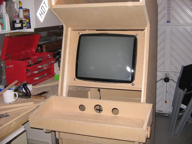

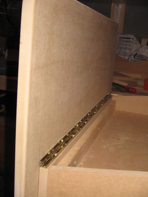

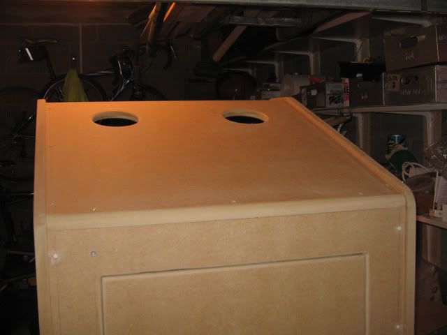

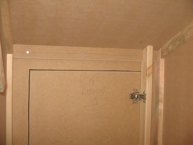

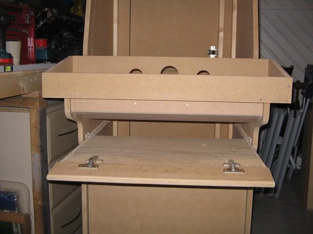

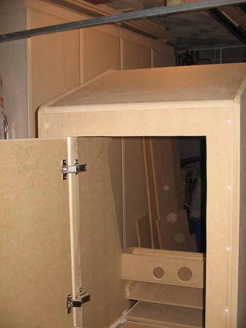

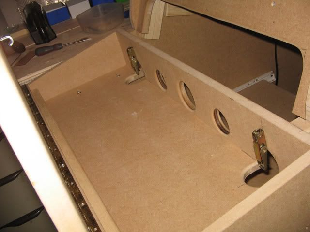

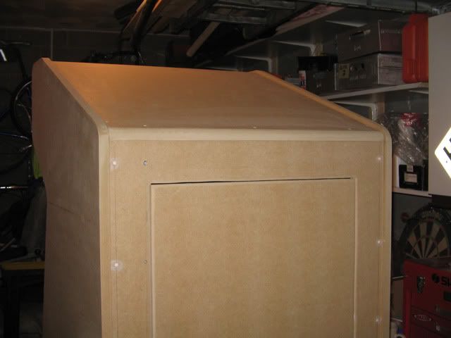

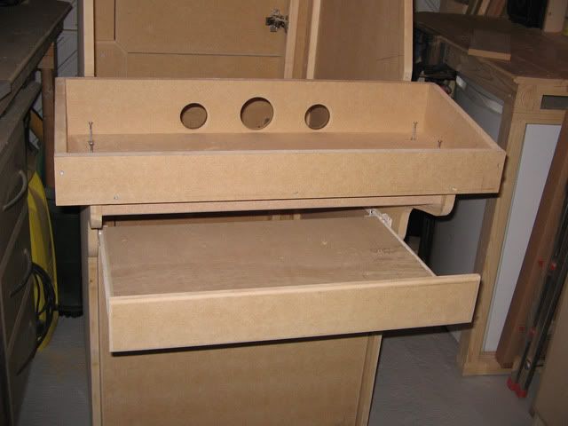

Made more progress tonight, thought i'd take some pics of some of the "ATTENTION TO DETAIL" of the cab,
CP gonna get cut next along with the marquee, then its time to attack the monitor :D
back of the cab with both doors now fitted. note curved top edge;
CP box test fitted with pics of the beveald cable holes;
Pics of inside of the cab, mainly of the inside of the doors.

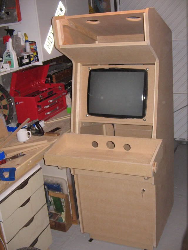

Re: WIP Street fighter cab started :D

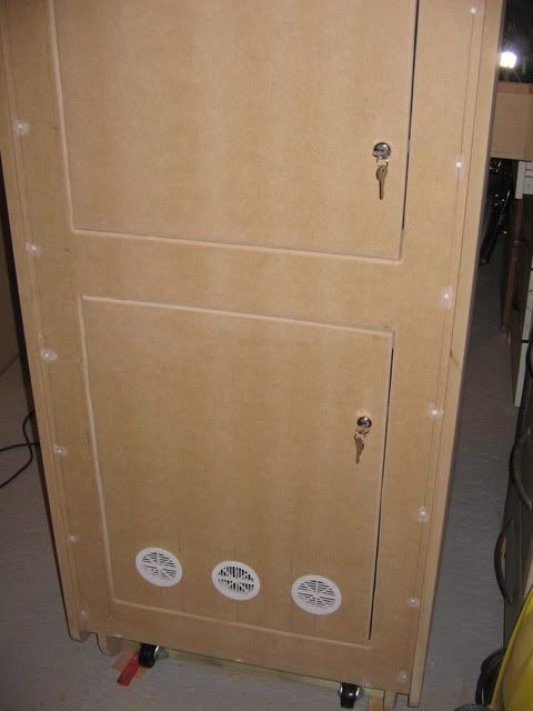

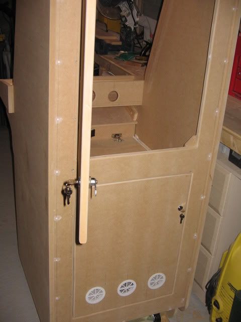

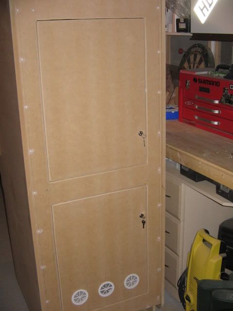

« Reply #50 on: January 31, 2011, 05:10:35 pm »

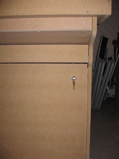

more updates comments welcome.
locks to keep little fingers out... and some vents that might be painted black;

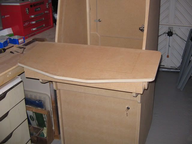

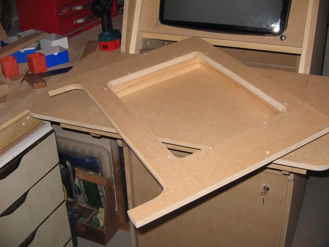

« Reply #51 on: February 04, 2011, 05:23:58 pm »

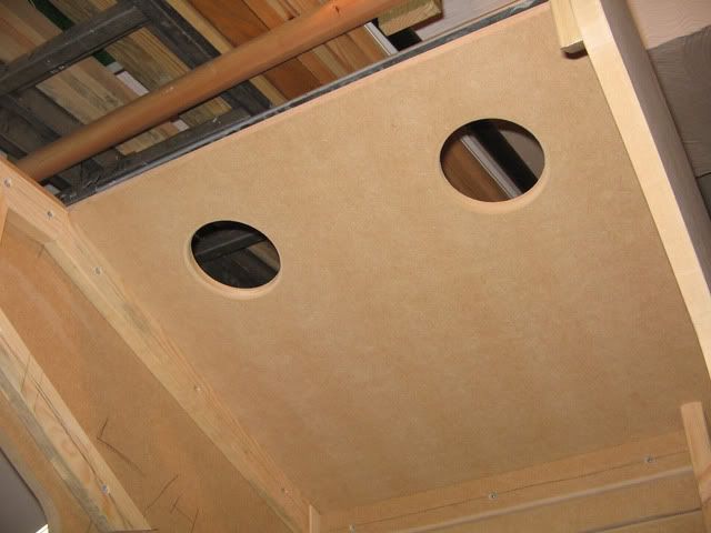

pics of exhaust fan outlet on top (120mm)
CP
plz keep the comments coming :D

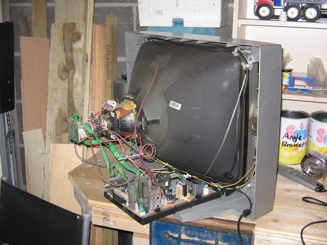

Got screenage!
comments plz good or construtive
« Reply #53 on: February 06, 2011, 06:18:04 pm »
Going with scart on this one?

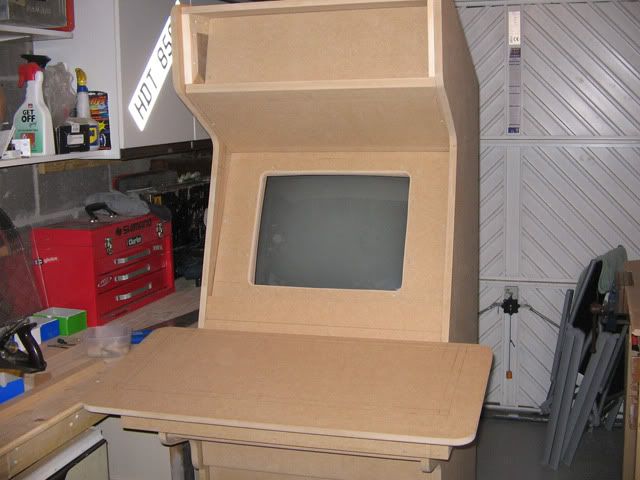

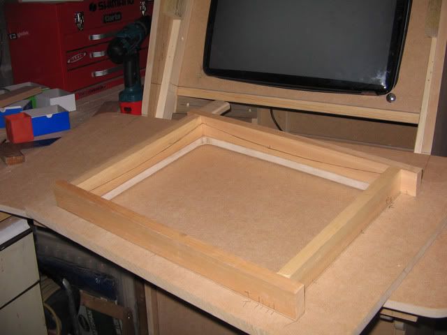

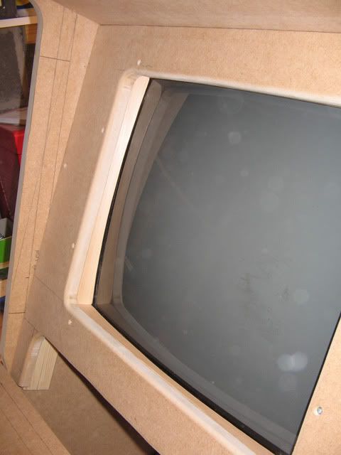

« Reply #55 on: February 08, 2011, 05:12:22 pm »

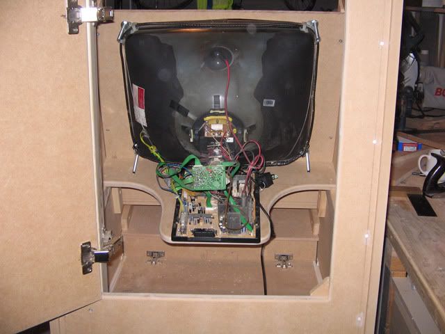

Screen fitted;
base for thr PCB to sit on :D
plz comment
« Reply #56 on: February 08, 2011, 06:50:27 pm »
That looks sharp! I like the shelf/base for the TV's board.

I like many aspects of your cabinet, good work so far!  :applaud: Yor finishing details are nice with the rounded edges everywhere..
Few things I would reconsider though;
Reduce the amount of overhang on your control panel. The overage has no purpose, and just makes the monitor look smaller. If it was usable surface area, that would be different....
Player 2's button layout should be rotated slightly counter-clockwise, or it may be VERY uncomfortable to play when standing side by side. Since P2 stands slightly right of center, his right hand will have to rotate uncomfortably to the right to compensate for standing off-square, causing a hard bend at the wrist. I figured I'd at least mention this since you haven't drilled anything yet. I understand that symmetry is 'pretty', but with an 8-button layout, you really should reconsider your ergonomics a bit more (especially if you plan on bringing these to market). There is also too much spacing between the buttons. You would need GIANT hands to take advantage of your current layout. You also need to move player 1&2 further apart. It looks like there is only about an inch between P1's buttons and P2's joystick...That will make you sorry.
Have you ever visited slagcoin.com? they have great layout templates there...

« Reply #79 on: March 05, 2011, 05:31:35 pm »
thx for the comments i'll check the site out, i'v also changed the CP
fiited some CP latches aswell as the bezel, tinted perspex to follow, for people without a good eye.. the control panels shape has changed also;
