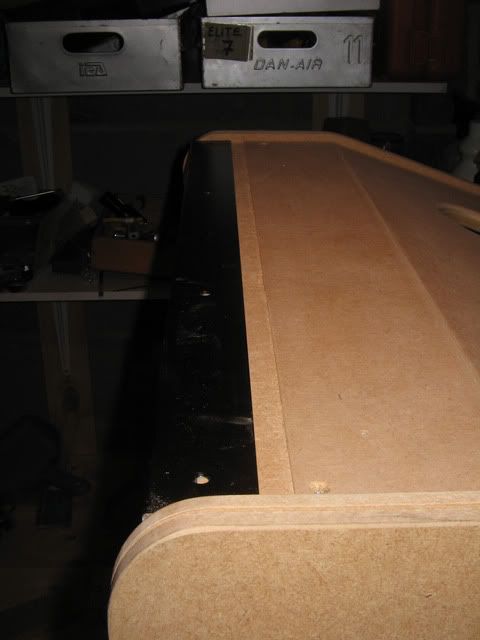

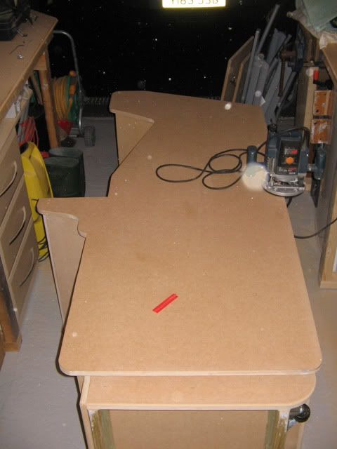

Got the t cutter today :D uncle couldn't wait to cut it! (note how dark it is outside!)
just paint, artwork and the eletrics next
here are the pics;
CP Cut, (its cut high so when the plexi glass is fitted it will sit flush...... bottom is beveled and will be painted black

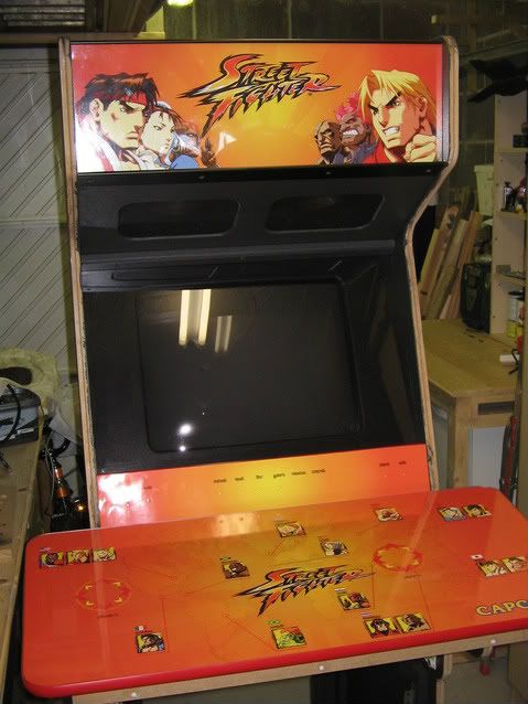

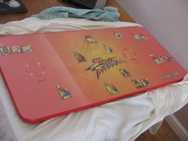

« Reply #81 on: March 18, 2011, 09:45:20 pm »
some more updates.... feels like we're getting closer now.... any comments welcome :D;

« Reply #82 on: March 19, 2011, 12:17:04 am »
Thats looking really sharp. Don't ya just love that feeling when you cant wait to do something! Thats what the hobby is about. Looks like you are enjoying your work, and I see you visited slagcoin, good choice on the layouts. Is that the astro city layout? If so, are you using the different p1 & p2 layouts? I was surprised at the subtle differences between the two in terms of spacing, and now having drilled them, its amazing how well they fit your fingers.
I made a panel before where I used only the p1 layout for both players, and it felt like your wrist was gonna break after a while if you were in the p2 position..Thinking back, it definitely gave me the upper hand in Street fighter 4 when I had friends over to play! >:D

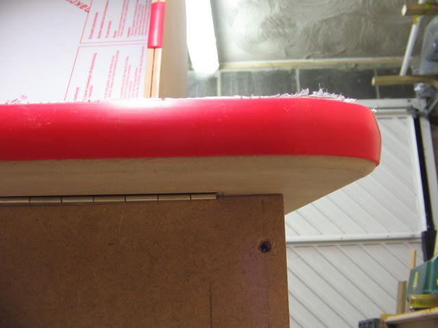

thx for the kick up the arse guys... lol  i'm gonna get some paint at the weekend.... get it painted..... almost got the artwork printed.... then the tmould will go on.....
it isn't a "Marquee retainer". its a kitchen worktop edge strip :) and ALLOT cheaper then a marguee retainer, even tho its the same thing lol

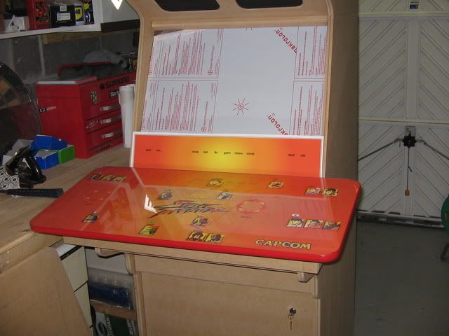

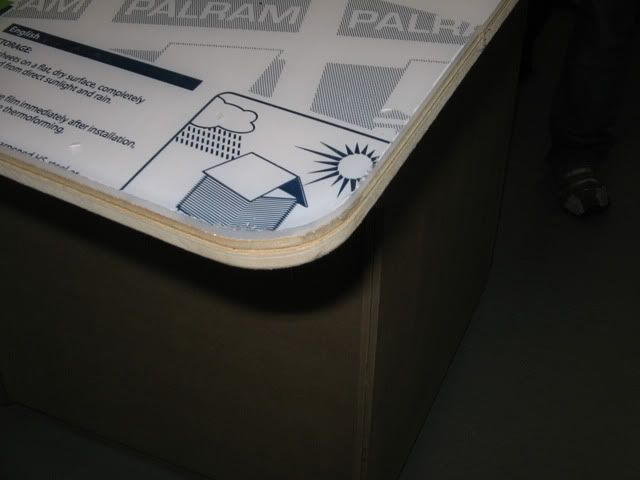

jahilton2002
  • Posts: 308
  • Last login:January 17, 2026, 05:34:53 pm
Re: WIP Street fighter cab started :D

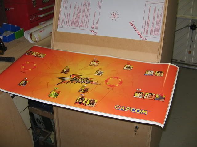

« Reply #87 on: April 01, 2011, 05:39:09 pm »

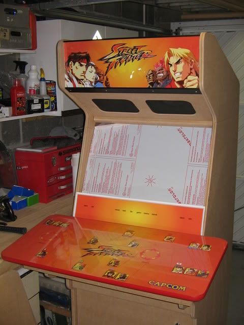

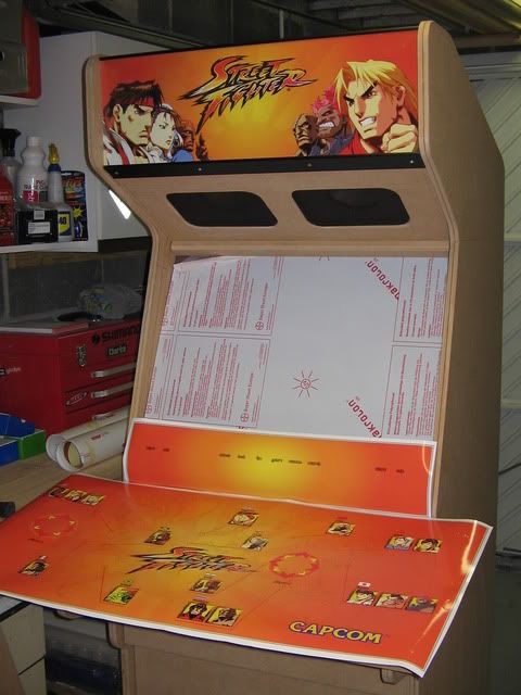

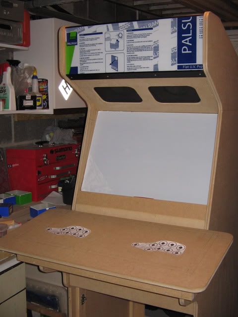

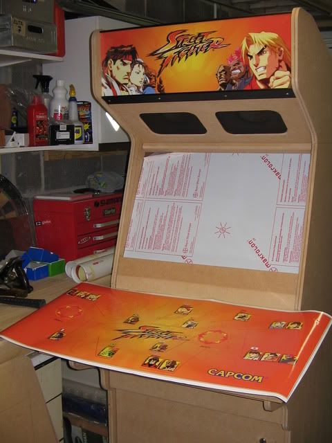

got the paint tonight... so will be painted soon..... here's some pics of the perpex being cut on the cp
plz keep the comments coming thx;
excess perspex
el toolio
like a glove
trial fit to see it t-barb is flush with top....... it is :D
underside showing bevaled edge will be painted black also;
« Reply #88 on: April 01, 2011, 05:48:19 pm »
like a glove
No. Like socks on a rooster. Lookin' good!

« Reply #90 on: April 05, 2011, 05:41:15 pm »

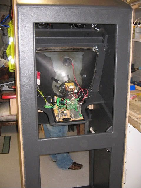

Make sure you sand and polish the edge of the plexiglas - it will really give it a "professional" look and you will be amazed at the difference (the router always leaves scuff marks along the edge).
Can you post more pics/details on how you are planning to access the hinges inside your CP?  I see the (hidden) holes for your hands to get in there but how do you get to them?  Does the entire CP come off first?
Finally, how are you going to power on your TV when you power on the computer - is that going to be an issue?
This thing is looking really sharp - I can't wait to see some art on there.   :cheers:

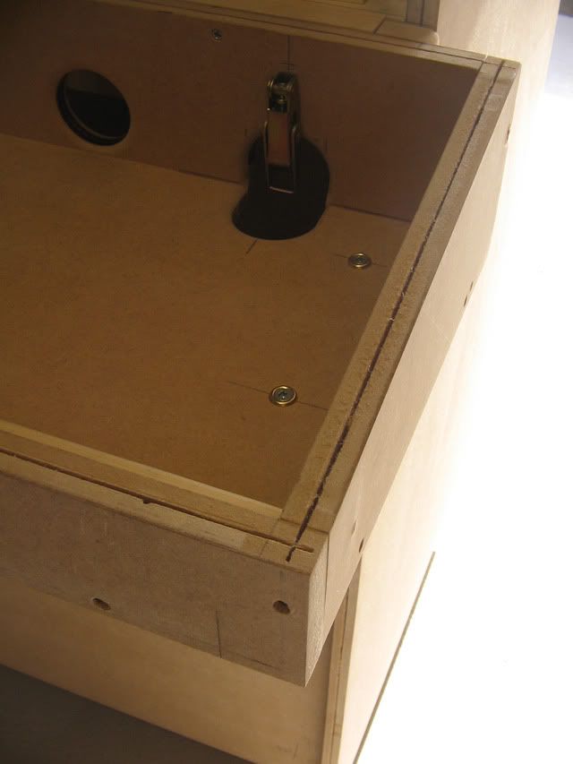

the latches for the control panel are easily gotten to via the front "door" or via the keyboard draw....
the tv will be powered via a two stage switch from on top of the cab..... first powers the pc.... second stage powers the tv..... the scart to vga is wired to auto switch to AV (although this hasn't been tested yet)
not sure if the power switch for both the pc and tv can be on the same parallel wired switch...... if that makes sense...... but i'll look more into this as i get there.

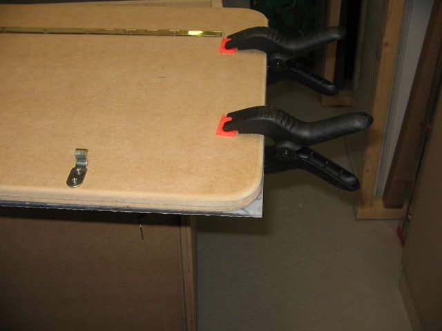

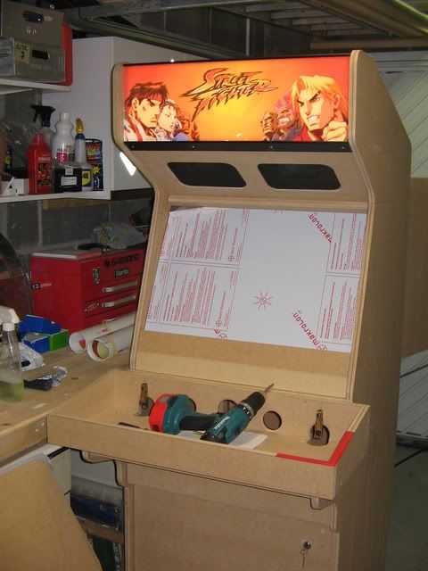

« Reply #93 on: April 06, 2011, 02:14:44 pm »
hear show the cp catches in more detail
« Last Edit: April 06, 2011, 02:16:28 pm by jahilton2002 »

not sure is the power switch for both the pc and tv can be on the same parallel wired switch...... if that makes sense...... but i'll look more into this as i get there.
I have wondered this myself and thought it would be best to use a DPDT or DPST momentary switch to keep the circuits seperate. However, I couldn't find a DPDT or DPST microswitch that would fit on the end of an arcade button, so if you want an arcade button for the power button, this wouldn't work. But if you're flexible you can probably find a DPDT or DPST momentary switch/button that wouldn't look half bad.

You can always use a smart strip to power on the TV when the computer is turned on, or vice versa
  • Posts: 8000
  • Last login:Yesterday at 03:06:24 pm
« Reply #96 on: April 06, 2011, 03:13:40 pm »
That's only if the TV has an actual on and off switch though, right?  My 19" bedroom TV will not turn on from a light switch, for example.  If I turn it off, the only way to turn it back on is to press the power button.
Donkbaca
  • Posts: 2648
    • Slim built MAME/Xbox cab
« Reply #97 on: April 06, 2011, 03:23:38 pm »
There are ways to fix that.  One way is to keep the power button pressed down.  Then it should work with the switch  >:D
Also, you could set the power switch so that the TV is the main, and set the bios on the computer to wake on power.

would this mean the tv was always on??? even on a black screen it would still be lit?

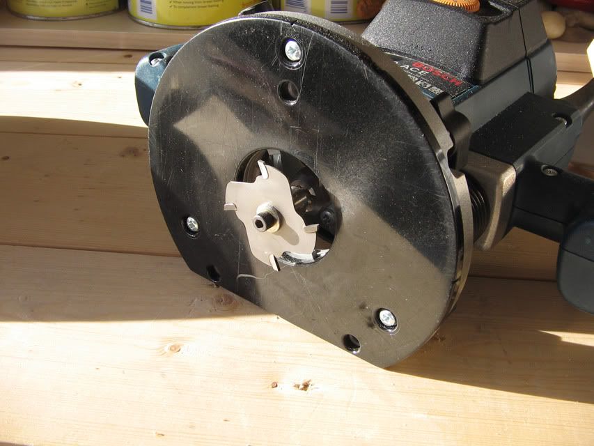

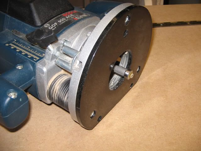

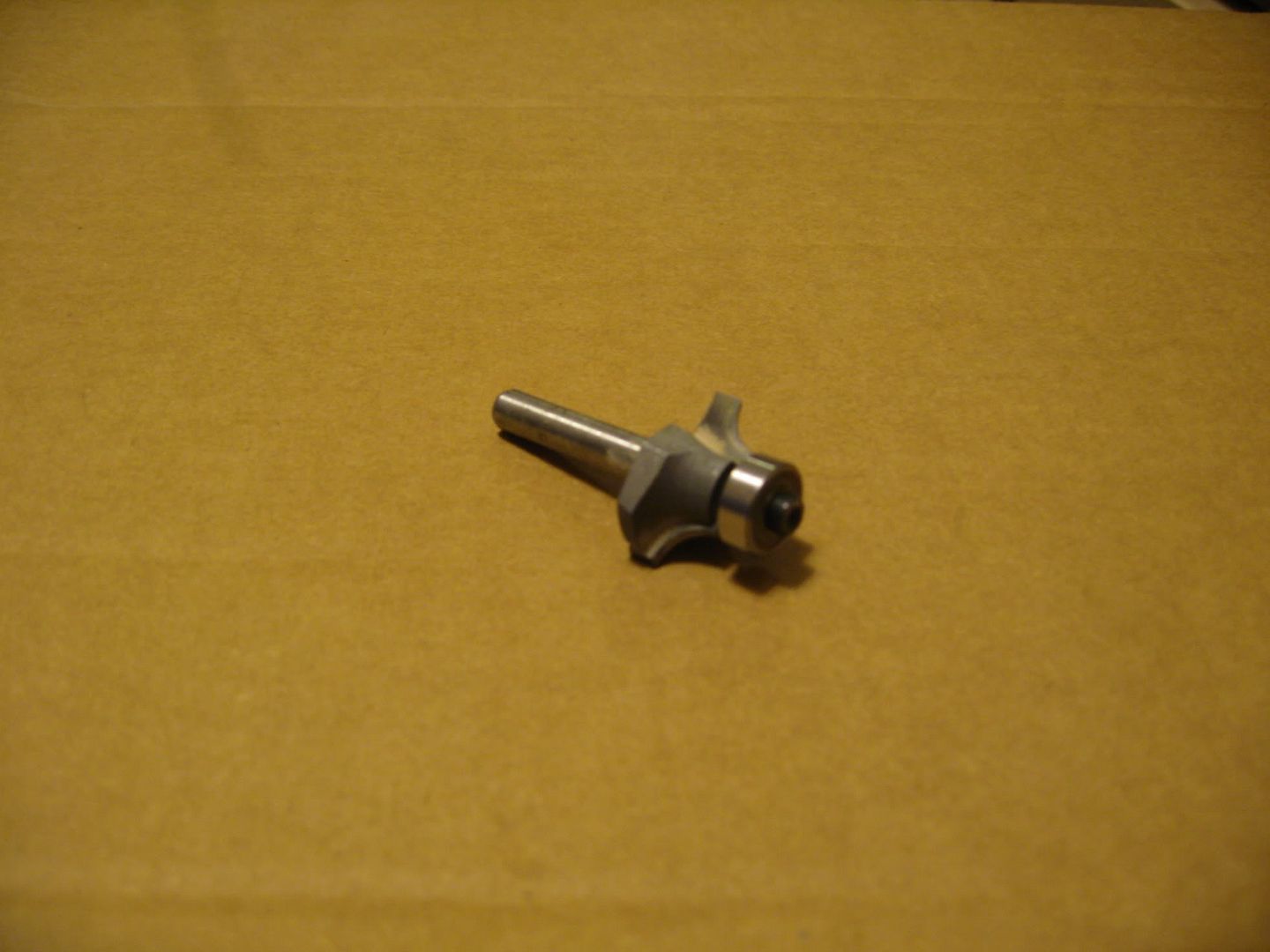

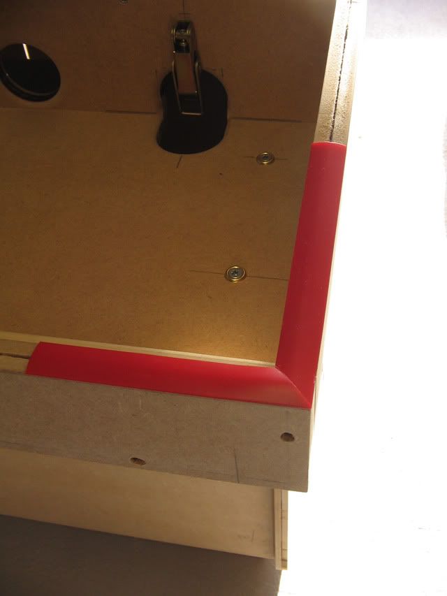

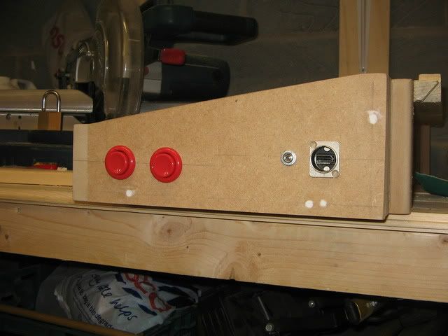

More updates, just alittle more attention to detail things really...... didn't like how you could see the top of the CP box when the lid was open..... so tmould fixed that :D .
take self circumcision tool;
cut some slots;
test fitted :D;
« Reply #103 on: April 21, 2011, 07:26:53 pm »
Loving this cabinet so far, it's given me some good ideas for my first build.  I'm making a shopping list and was hoping you could tell me what different types and size router bits were used?

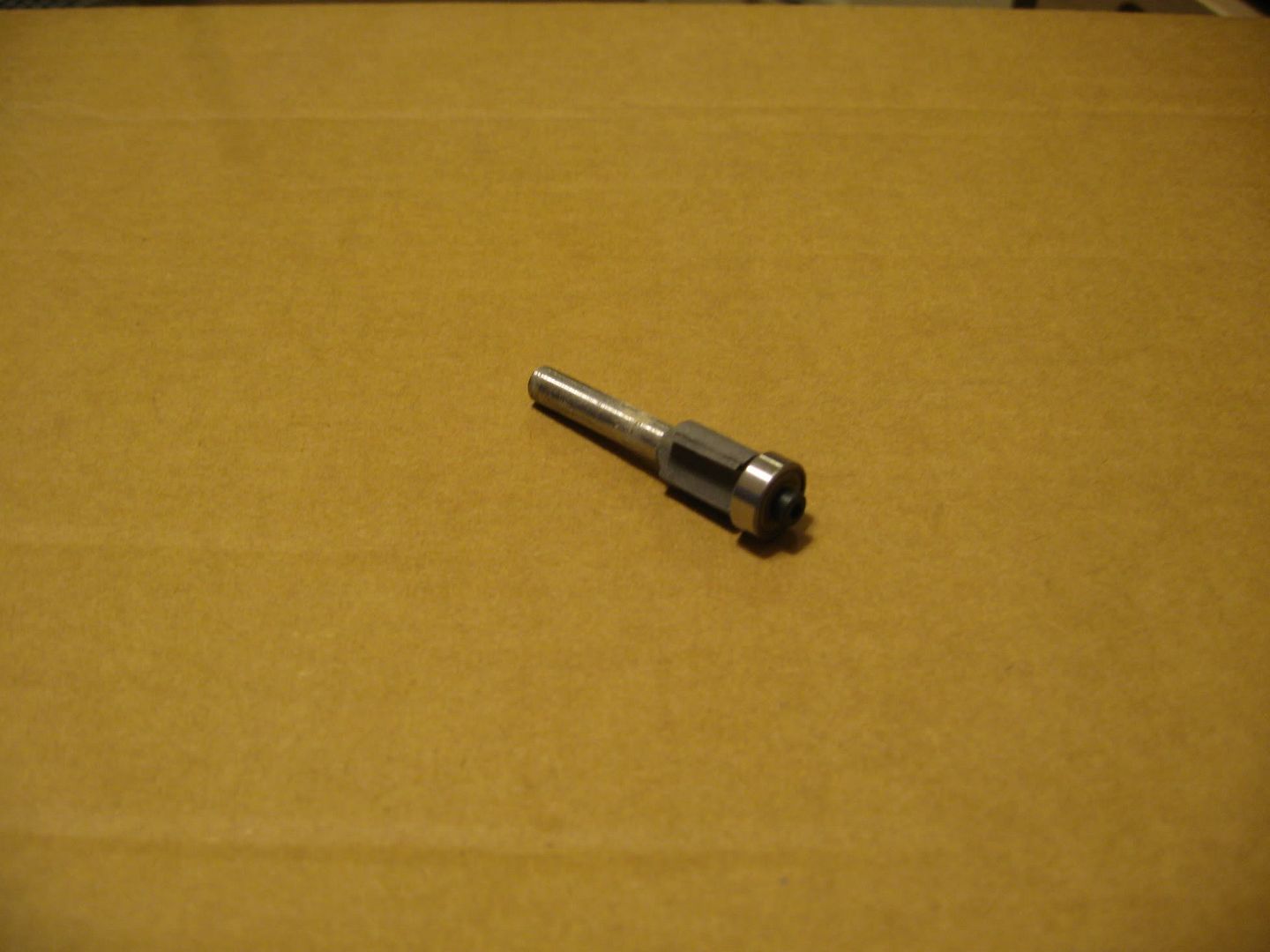

here you go....
1638 4 wing 1.6mm slot cutter - 1644 18mm guided ovolo cutter - 1647 guided twin flute trimmer - 1649 9mm guided ovolo cutter

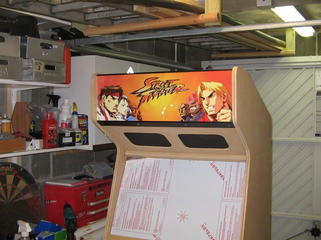

« Reply #104 on: May 11, 2011, 04:38:52 pm »

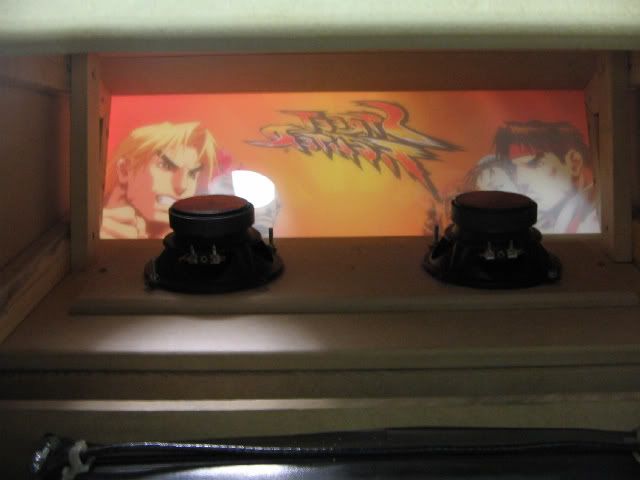

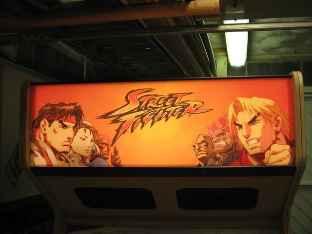

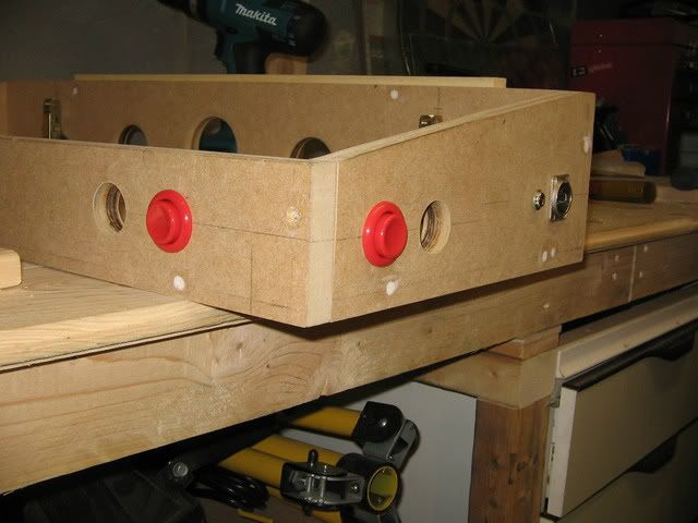

More updates, cp to follow...
ignore the shadow in the marquee, don’t have the tubes fitted yet... using a make-shift tripod flood light shining into the back of the cab :D
SNAAKE
  • Trade Count: (+29)
  • Posts: 3583
« Reply #105 on: May 13, 2011, 12:46:03 pm »
what kind of marquee retainer is that? the top one looks thin(better) than standard happ stuff. either way everything looks good. cant wait for the final pix :cheers:

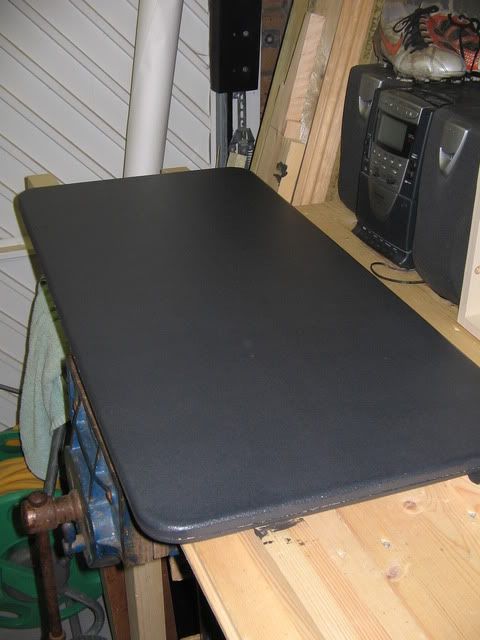

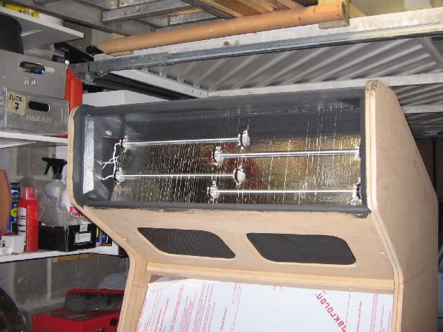

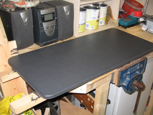

some more updates, started to paint also;

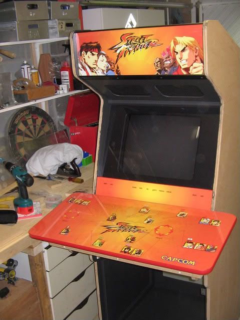

« Reply #110 on: May 21, 2011, 05:05:21 pm »

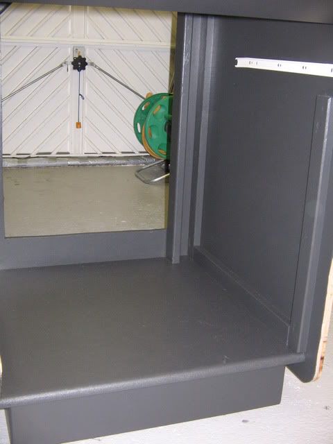

started to paint, fitted lights but was worried about hot spots...... looks great better than i thought it would!
jahilton2002
  • Posts: 308

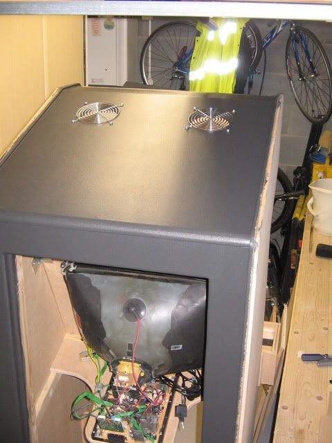

« Reply #111 on: May 23, 2011, 05:05:19 pm »

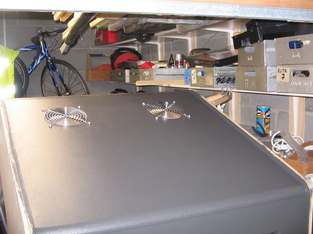

more paintage and exhaust fan guards fitted
comments welcome.

Looks like a fine job so far. I'm still skeptical of the possible marquee shadows on the sides from those framing blocks. I would have taken the advice of your fellow byoac'rs here and removed those. But you should post some pictures of it lit up with the installed lights, to silence the skeptics like me.
How heavy is the cabinet? Looks like a lot of  wood in this build, which could make this thing a beast in weight.
Also, like SNAAKE asked, what are you using for the retainers? The top one looks cool being so thin.

« Reply #114 on: May 24, 2011, 03:55:19 am »
the marquee retainer is a kitchen worktop edge strip......

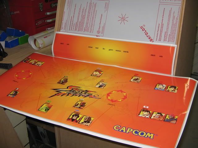

« Reply #115 on: May 29, 2011, 12:58:44 pm »
little update :D

here you can see the right side (player 2) right pinball fliper (left red button) and nudge (right red button).
here the front pinball plunger button and front nudge.

« Reply #119 on: June 06, 2011, 04:56:11 pm »
more mock up updates...... almost done building the cab now, just the CP box to paint and the sideart to fit..... then on with the wiring! :thrasher:
