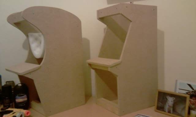

WIP Street fighter cab started :D
« on: January 10, 2011, 08:14:04 am »
some of you might of seen my art thread:
 http://forum.arcadecontrols.com/index.php?topic=108054.0
so the next step is the cab :D
just playin' with ideas at the mo.
tell me what you think guys.
« Last Edit: January 13, 2011, 02:58:14 pm by jahilton2002 »
Re: Made some 1/8 scale wooden models to start my Street fighter cab
« Reply #1 on: January 10, 2011, 08:26:47 am »
For a street fighter cab, I like the one on the right.
« Reply #6 on: January 10, 2011, 12:48:35 pm »
Looks good. I like the right one better than the Left .
Though I would have gone with replicating a Dynamo cabinet, either Z-back or straight:
Back then, most Street Fighter kits were installed in dynamo cabinets.
At 1/8th the size, a dynamo cab would look pretty cool!

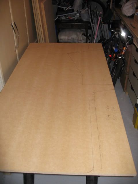

jahilton2002
  • Posts: 308
  • Last login:January 17, 2026, 05:34:53 pm
« Reply #9 on: January 12, 2011, 03:08:11 am »

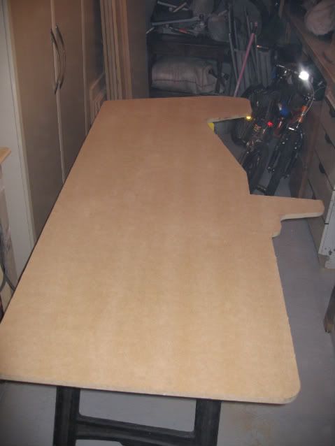

well the woodwork technician marked out one of the side panels today..... looks sweet..... looks like the top right one....... but it doesn't have a flat top.....and that one is dynamo based :)

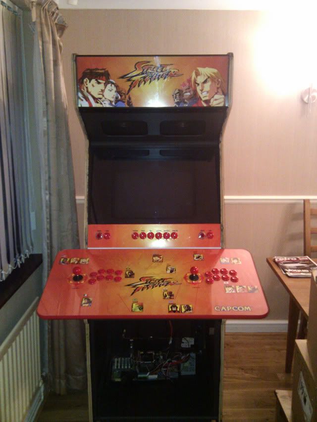

jahilton2002
  • Posts: 308
« Reply #13 on: January 13, 2011, 02:57:39 pm »
good luck , i like left but less dept
oh what an honour!!!.... it was your cab that inspired me to make this one..... :D
jahilton2002
  • Posts: 308

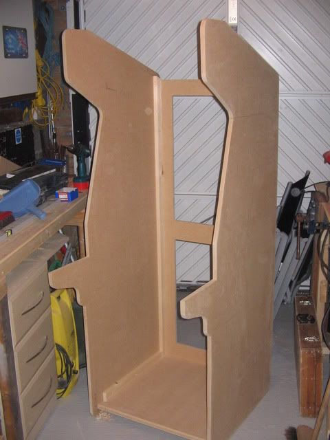

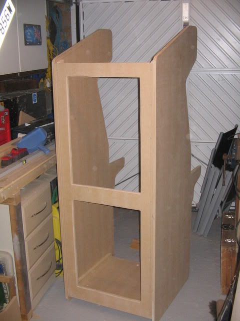

Re: WIP Street fighter cab started :D
« Reply #14 on: January 13, 2011, 02:58:39 pm »

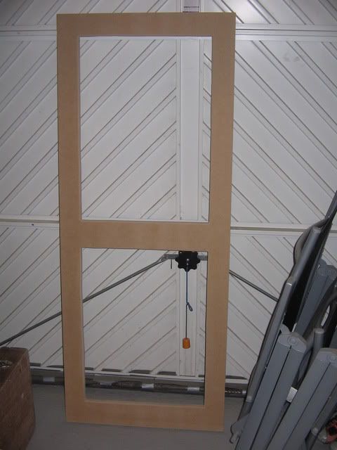

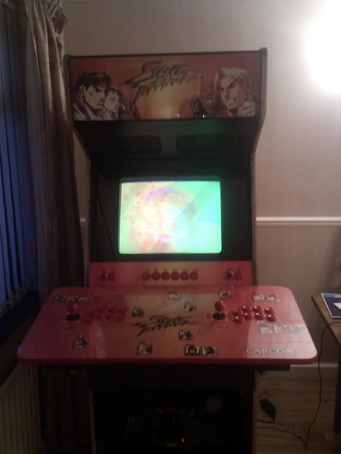

Well me and my uncle started to cut tonight....... well i say "we" but tbh i'd kill myself with any power tool!! to watch him work amazes me!...... he's a cabinet  maker by trade! :)
based on a dynamo design with some "extra" touches. its our first build together, and its a no expense spared job :D
more to come soon.......

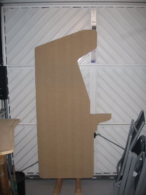

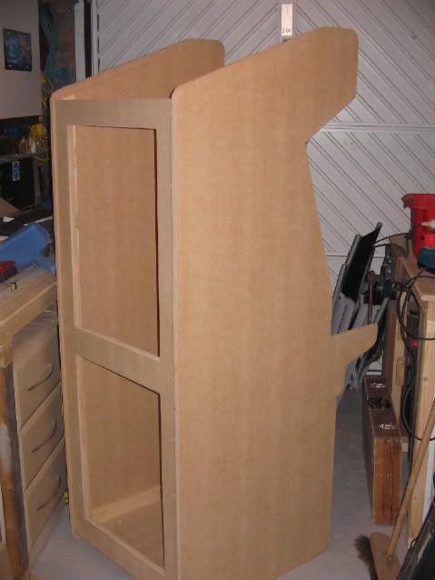

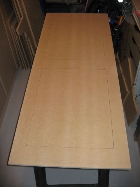

« Reply #19 on: January 14, 2011, 07:04:54 pm »

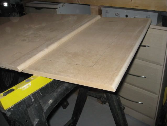

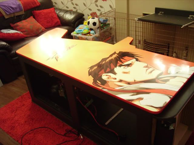

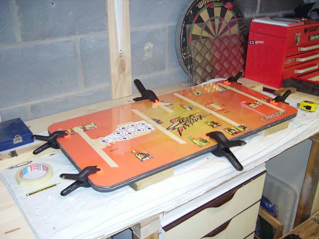

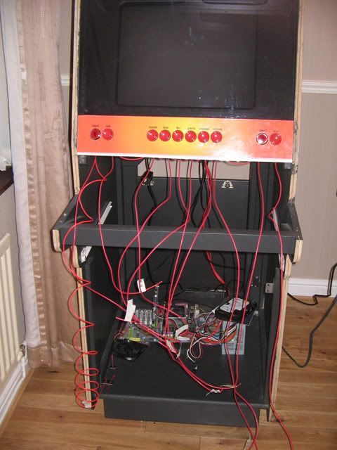

back cut to size and bottom edge routered and marked up for two doors, and base cut to size with top front edge routered.
more soon

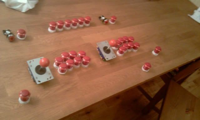

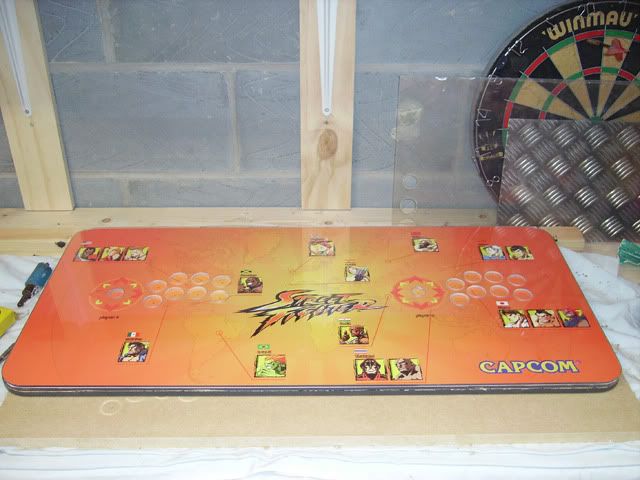

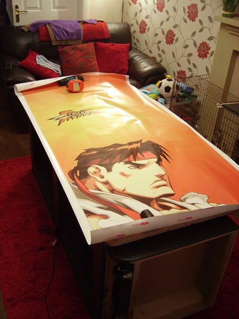

« Reply #20 on: January 15, 2011, 12:43:44 pm »

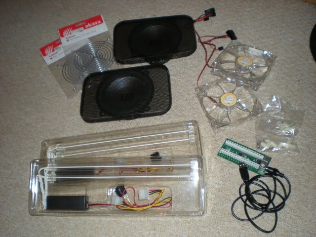

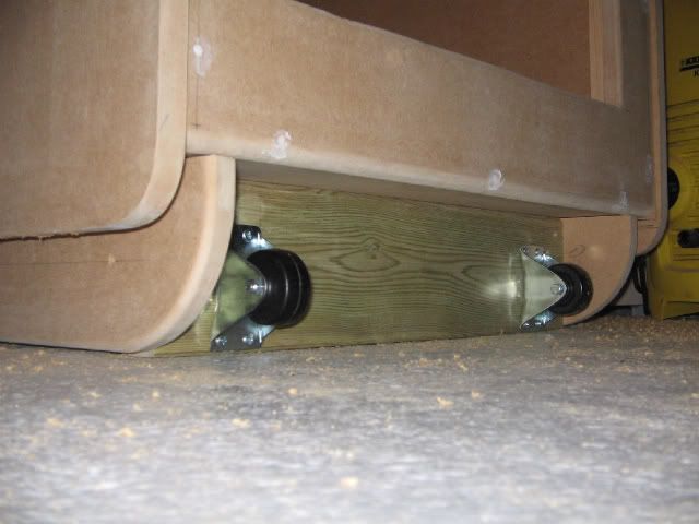

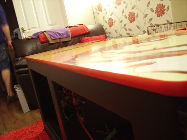

things have also started to come in the post also.
jahilton2002

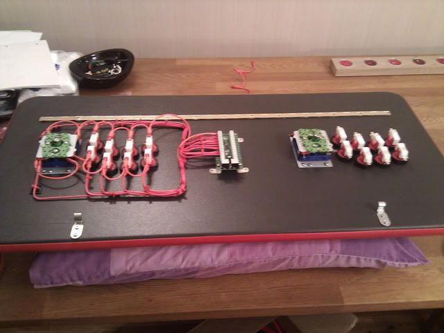

« Reply #21 on: January 16, 2011, 05:08:40 pm »

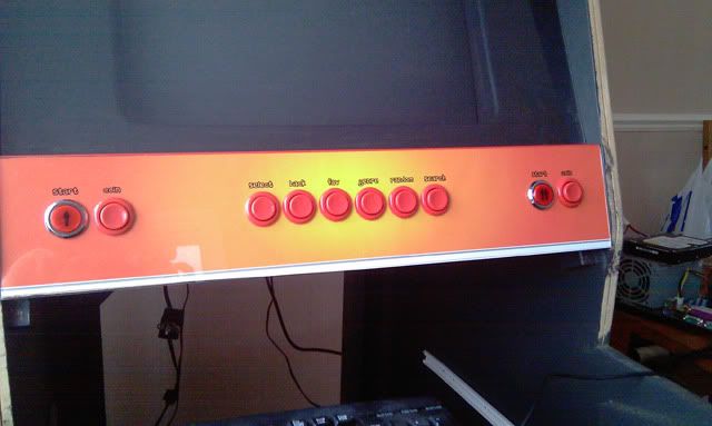

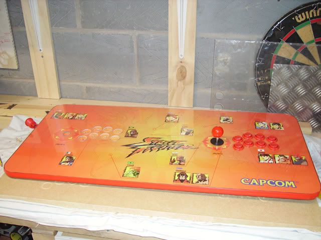

some more updates...... some comments would be nice guys :(

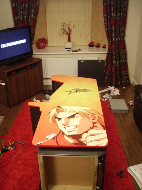

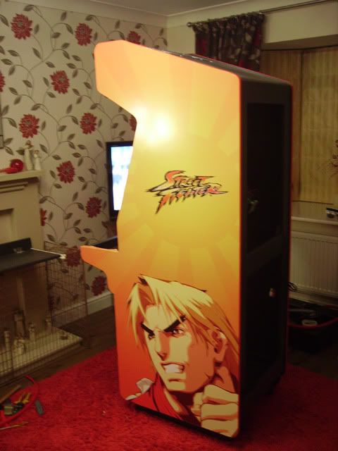

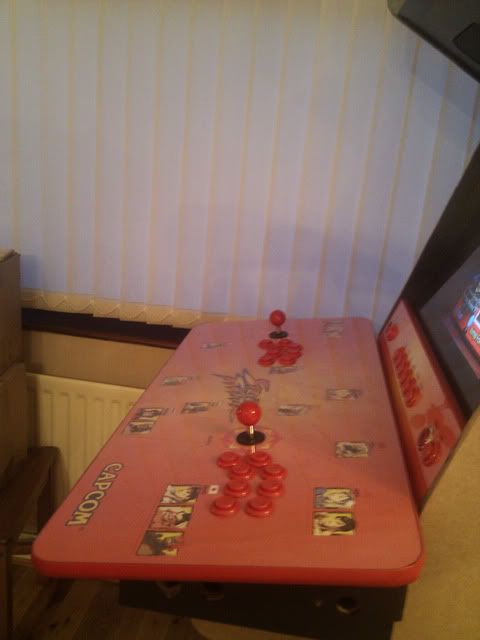

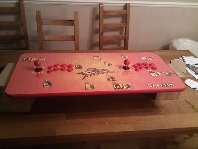

« Reply #22 on: January 18, 2011, 04:49:55 pm »
More updates :) but still no comments? :(
« Reply #23 on: January 18, 2011, 07:15:03 pm »

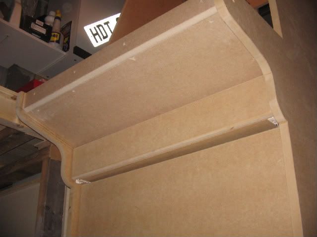

Looks like it's coming together nicely.  I like the curves at the bottom.  Where are the speaker grills from?
Donkbaca
  • Posts: 2648
    • Slim built MAME/Xbox cab
« Reply #24 on: January 18, 2011, 07:43:54 pm »
I agree, it all looks very clean and straight
« Reply #25 on: January 18, 2011, 08:57:42 pm »
I like how you have the back as one piece.

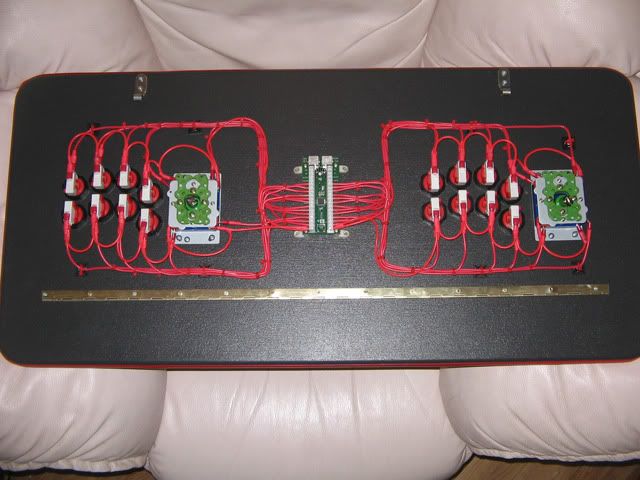

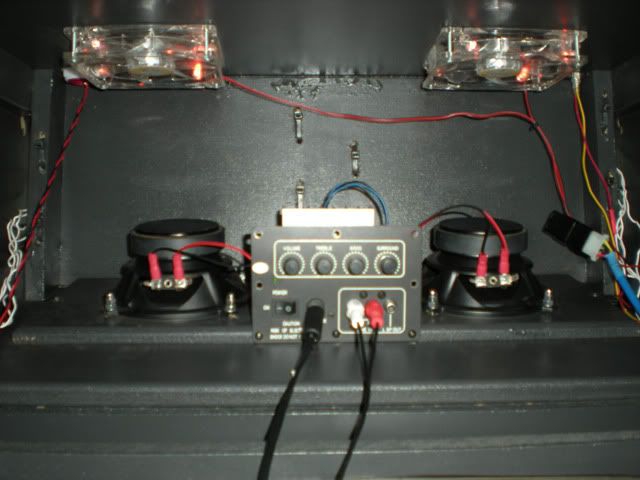

« Reply #26 on: January 19, 2011, 03:21:56 am »

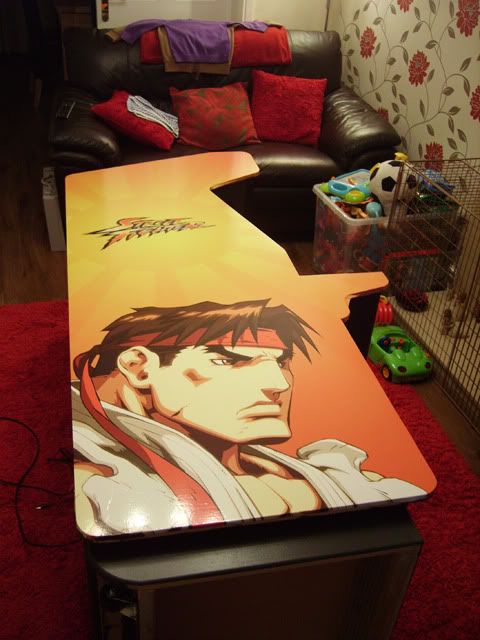

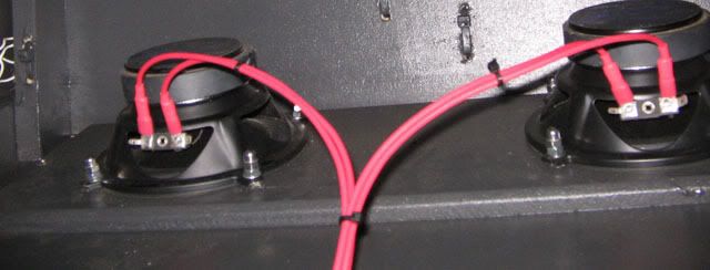

thx for the comments guys, the speaker grills are just from an old set of hifi speakers.

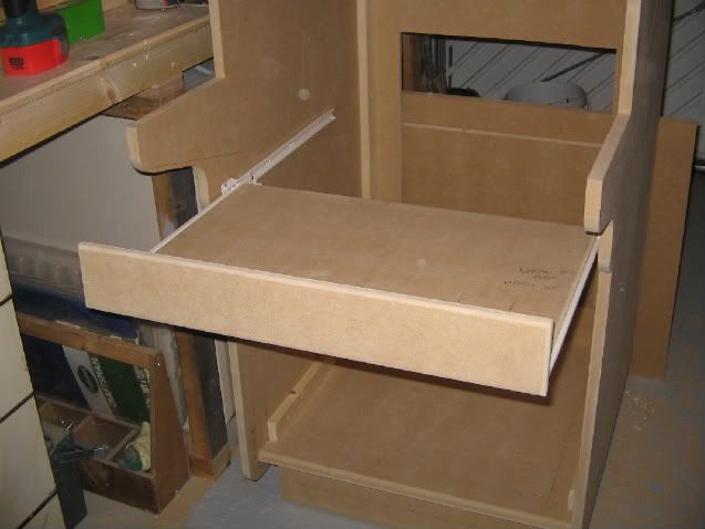

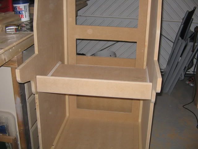

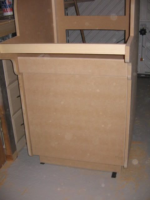

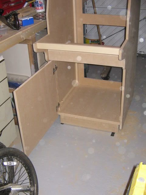

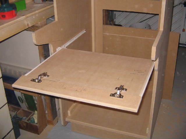

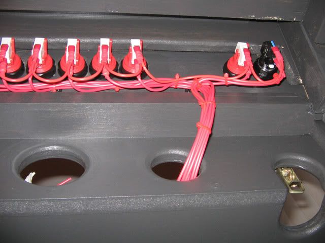

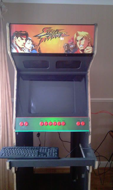

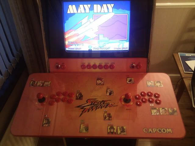

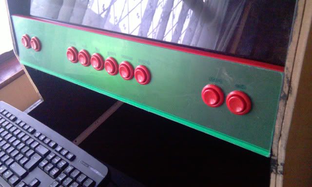

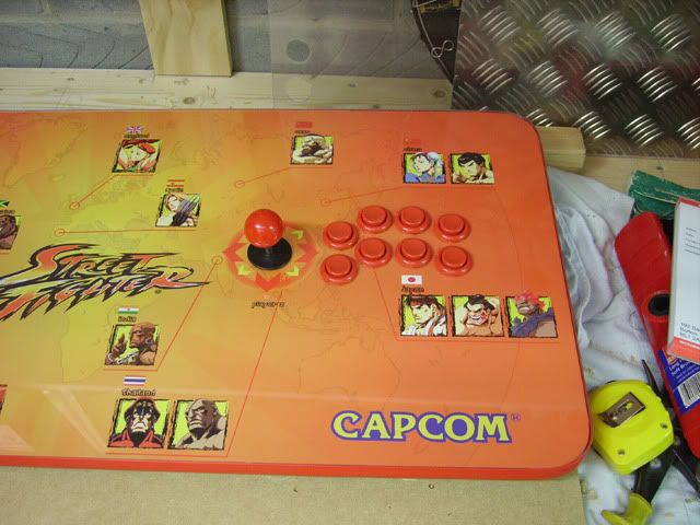

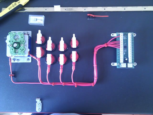

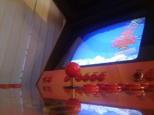

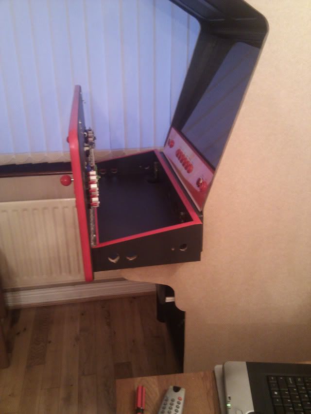

Here's some more updates.... happy birthday to my uncle who is the master behind the cab build :)
« Reply #28 on: January 22, 2011, 08:42:29 am »
I like that hinged keyboard tray.
jahilton2002
  • Posts: 308

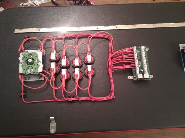

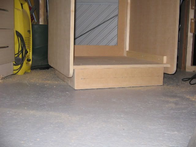

« Reply #29 on: January 22, 2011, 02:10:00 pm »

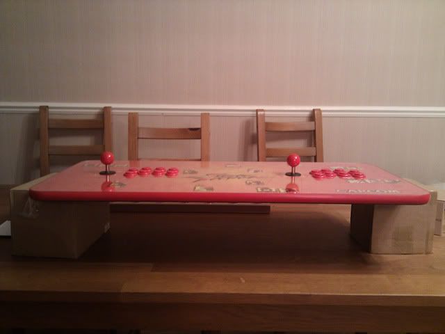

more updates
« Reply #30 on: January 22, 2011, 02:29:10 pm »
I also really like the hinged keyboard tray idea.  I wish this thread was around before I started my cab, I woulda done my keyboard tray the same way.
Looking good.

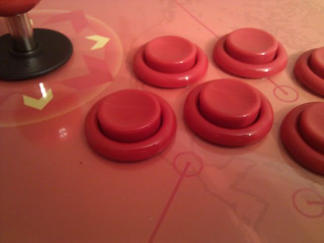

thx for the comments guys, feedback means alot so plz keep em comin'

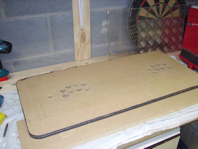

« Reply #32 on: January 22, 2011, 03:00:48 pm »
Are you waiting to cut the t-molding channels in this cab? Or is this not going to have t-molding? I know you asked about red t-molding in another thread, but not sure if it was for this project or another game you might have.
jahilton2002
  • Posts: 308
« Reply #33 on: January 22, 2011, 03:05:02 pm »
yes it going to have t-mould and red like you said.... :)

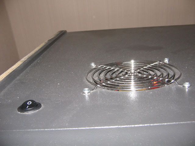

dugg8
  • Posts: 68
  • Last login:February 01, 2012, 04:51:00 pm

Why do you need so many buttons?
jahilton2002
  • Posts: 308
« Reply #38 on: January 28, 2011, 01:06:40 pm »

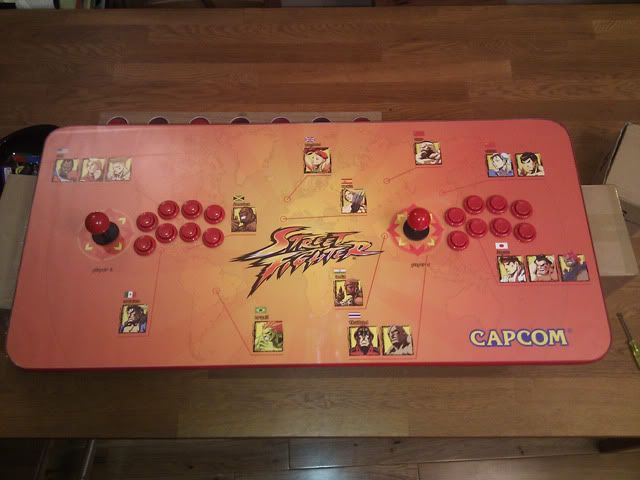

i knew i was gonna get roasted for that  ;D bottom three are pinball
8 butons per player n64/ps1/ps2/ps3
1player + start (mame)
2player + start (mame)
middle for HS fe, genre,menu,pause etc etc
my family will use it alot and i want them to be able to use the functions with having to "ask" how to use it.
i dont want to use a shift key as each buttons function is labeled, here's my cp artwork;

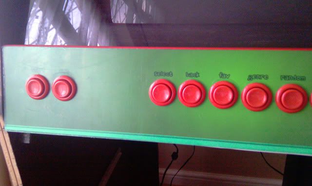

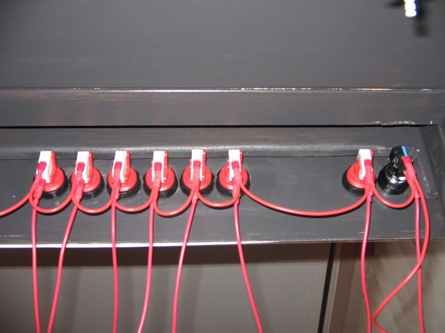

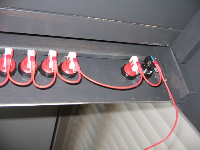

thinking about i could put the buttons on the bottom of the monitor bezal if that makes sense  :(
« Reply #40 on: January 28, 2011, 01:15:13 pm »
Not a bad idea.

« Reply #41 on: January 28, 2011, 01:18:06 pm »
Donkbaca
  • Posts: 2648
« Reply #42 on: January 28, 2011, 01:33:58 pm »
I think the buttons in the middle of the CP would look better if they were on the bezel.
Are you sure you want 8 buttons?  From my experience, console games play better with control pads then joysticks.  But whatever works best for you!
jahilton2002
  • Posts: 308
« Reply #43 on: January 28, 2011, 01:50:50 pm »
well thx for the opinions guys, gonna look into the bezel buttons :)

How do you like those wheels on your cab? I had an Atari DigDug with similiar wheels. I hated them, it always felt like it was going to get away from me when I was moving it.
I'm assuming you mean, "without having to ask how to use it".
This is why it's vital for a more simple CP. The less buttons, the less intimidating it'll look, the less need to figure out what does what.
I personally don't like having mame function buttons. IMO it takes away from the arcade experience. Things like Pause (pausing an arcade game??), Back, Enter, a dedicated button for hyper-spinning? But hey, some people like that granularity of control, and there is no mistake this clearly is a Mame cabinet.
I'd go with the bezel mounting for these buttons if you're going to keep 'em. The cleaner the CP space, the better.
Many folks have gone this route, Kman mounted his to his bezel:
Then of course there's Pixelhugger's fine work:

Made more progress tonight, thought i'd take some pics of some of the "ATTENTION TO DETAIL" of the cab,
CP gonna get cut next along with the marquee, then its time to attack the monitor :D
back of the cab with both doors now fitted. note curved top edge;
CP box test fitted with pics of the beveald cable holes;
Pics of inside of the cab, mainly of the inside of the doors.

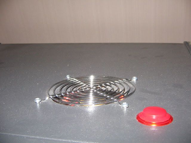

pics of exhaust fan outlet on top (120mm)
CP
plz keep the comments coming :D

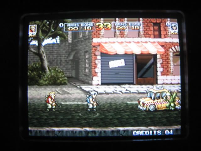

Got screenage!
comments plz good or construtive

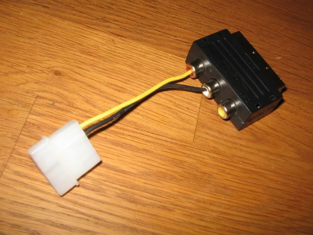

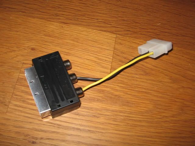

Going with scart on this one?
jahilton2002
  • Posts: 308
« Reply #54 on: February 07, 2011, 01:05:38 pm »
yeah vga to scart

I like many aspects of your cabinet, good work so far!  :applaud: Yor finishing details are nice with the rounded edges everywhere..
Few things I would reconsider though;
Reduce the amount of overhang on your control panel. The overage has no purpose, and just makes the monitor look smaller. If it was usable surface area, that would be different....
Player 2's button layout should be rotated slightly counter-clockwise, or it may be VERY uncomfortable to play when standing side by side. Since P2 stands slightly right of center, his right hand will have to rotate uncomfortably to the right to compensate for standing off-square, causing a hard bend at the wrist. I figured I'd at least mention this since you haven't drilled anything yet. I understand that symmetry is 'pretty', but with an 8-button layout, you really should reconsider your ergonomics a bit more (especially if you plan on bringing these to market). There is also too much spacing between the buttons. You would need GIANT hands to take advantage of your current layout. You also need to move player 1&2 further apart. It looks like there is only about an inch between P1's buttons and P2's joystick...That will make you sorry.
Have you ever visited slagcoin.com? they have great layout templates there...

thx for the comments i'll check the site out, i'v also changed the CP
fiited some CP latches aswell as the bezel, tinted perspex to follow, for people without a good eye.. the control panels shape has changed also;

Got the t cutter today :D uncle couldn't wait to cut it! (note how dark it is outside!)
just paint, artwork and the eletrics next
here are the pics;
CP Cut, (its cut high so when the plexi glass is fitted it will sit flush...... bottom is beveled and will be painted black
jahilton2002
  • Posts: 308
« Reply #81 on: March 18, 2011, 09:45:20 pm »
some more updates.... feels like we're getting closer now.... any comments welcome :D;

« Reply #82 on: March 19, 2011, 12:17:04 am »
Thats looking really sharp. Don't ya just love that feeling when you cant wait to do something! Thats what the hobby is about. Looks like you are enjoying your work, and I see you visited slagcoin, good choice on the layouts. Is that the astro city layout? If so, are you using the different p1 & p2 layouts? I was surprised at the subtle differences between the two in terms of spacing, and now having drilled them, its amazing how well they fit your fingers.
I made a panel before where I used only the p1 layout for both players, and it felt like your wrist was gonna break after a while if you were in the p2 position..Thinking back, it definitely gave me the upper hand in Street fighter 4 when I had friends over to play! >:D

got the paint tonight... so will be painted soon..... here's some pics of the perpex being cut on the cp
plz keep the comments coming thx;
excess perspex
el toolio
like a glove
trial fit to see it t-barb is flush with top....... it is :D
underside showing bevaled edge will be painted black also;

the latches for the control panel are easily gotten to via the front "door" or via the keyboard draw....
the tv will be powered via a two stage switch from on top of the cab..... first powers the pc.... second stage powers the tv..... the scart to vga is wired to auto switch to AV (although this hasn't been tested yet)
not sure if the power switch for both the pc and tv can be on the same parallel wired switch...... if that makes sense...... but i'll look more into this as i get there.

« Reply #93 on: April 06, 2011, 02:14:44 pm »
hear show the cp catches in more detail

not sure is the power switch for both the pc and tv can be on the same parallel wired switch...... if that makes sense...... but i'll look more into this as i get there.
I have wondered this myself and thought it would be best to use a DPDT or DPST momentary switch to keep the circuits seperate. However, I couldn't find a DPDT or DPST microswitch that would fit on the end of an arcade button, so if you want an arcade button for the power button, this wouldn't work. But if you're flexible you can probably find a DPDT or DPST momentary switch/button that wouldn't look half bad.

You can always use a smart strip to power on the TV when the computer is turned on, or vice versa
That's only if the TV has an actual on and off switch though, right?  My 19" bedroom TV will not turn on from a light switch, for example.  If I turn it off, the only way to turn it back on is to press the power button.

There are ways to fix that.  One way is to keep the power button pressed down.  Then it should work with the switch  >:D
Also, you could set the power switch so that the TV is the main, and set the bios on the computer to wake on power.

would this mean the tv was always on??? even on a black screen it would still be lit?

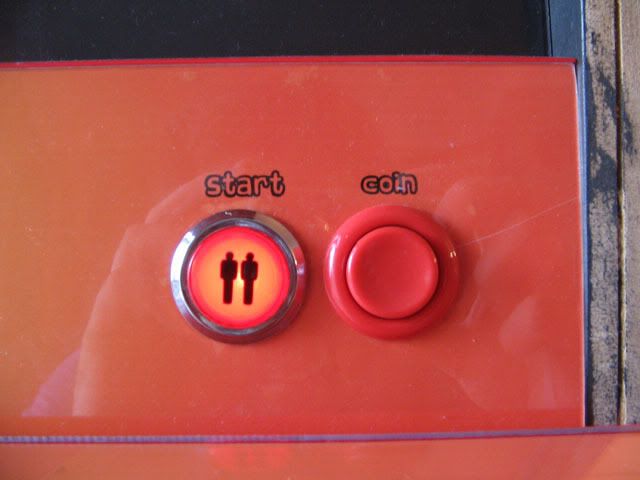

More updates, just alittle more attention to detail things really...... didn't like how you could see the top of the CP box when the lid was open..... so tmould fixed that :D .
take self circumcision tool;
cut some slots;
test fitted :D;

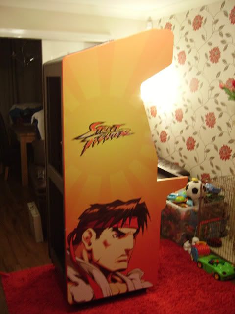

my photographic skills are poor, so this is just a teaser...just a mock-up. more to follow
« Last Edit: May 15, 2011, 05:59:49 am by jahilton2002 »
jahilton2002
  • Posts: 308
« Reply #108 on: May 16, 2011, 02:18:20 pm »

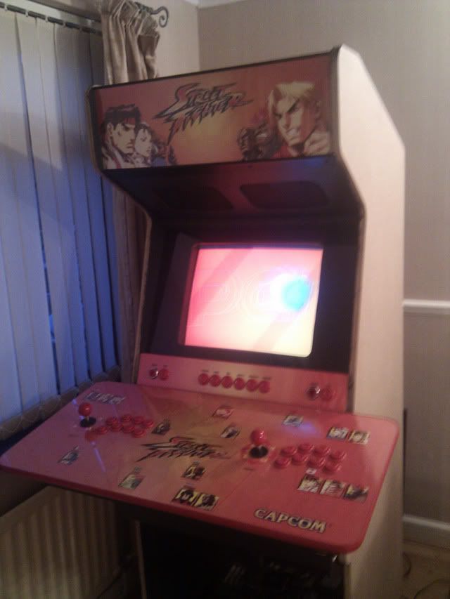

another mock up shot!.......

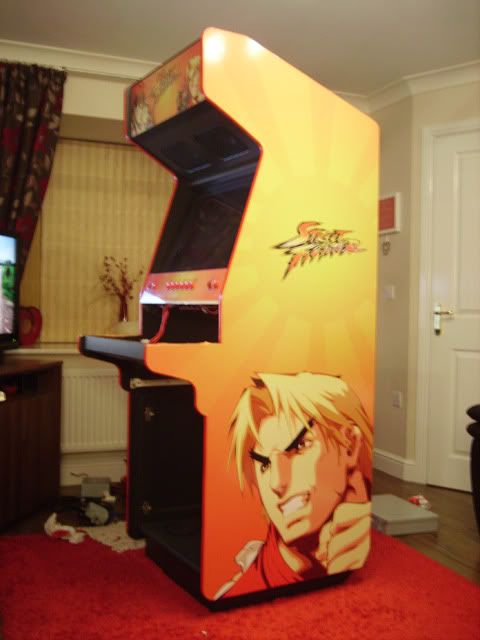

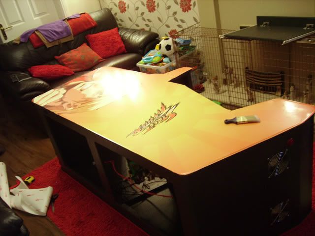

started to paint, fitted lights but was worried about hot spots...... looks great better than i thought it would!
jahilton2002
  • Posts: 308
« Reply #111 on: May 23, 2011, 05:05:19 pm »
more paintage and exhaust fan guards fitted
comments welcome.

Paint job looks very good!  :cheers:

Looks like a fine job so far. I'm still skeptical of the possible marquee shadows on the sides from those framing blocks. I would have taken the advice of your fellow byoac'rs here and removed those. But you should post some pictures of it lit up with the installed lights, to silence the skeptics like me.
How heavy is the cabinet? Looks like a lot of  wood in this build, which could make this thing a beast in weight.
Also, like SNAAKE asked, what are you using for the retainers? The top one looks cool being so thin.

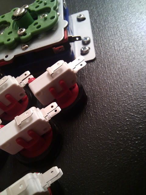

here you can see the right side (player 2) right pinball fliper (left red button) and nudge (right red button).
here the front pinball plunger button and front nudge.
jahilton2002
  • Posts: 308
« Reply #119 on: June 06, 2011, 04:56:11 pm »
more mock up updates...... almost done building the cab now, just the CP box to paint and the sideart to fit..... then on with the wiring! :thrasher:

just the CP box to paint and drill now...... then shes off to the living room..... and the wiring will begin. cut hole for the admin controls...... i hate shift keys sorry.... and a "power" button up top..... the button is just a test fit.... a black one will be used.

I absolutely love the paint job on your cab. What kind of paint did you use? It sort of looks like a matt/flat textured finish (which I'd like for my own cab someday).
Keep up the good work! Very inspirational!  :cheers:
http://www.diy.com/diy/jsp/bq/nav.jsp?action=detail&fh_secondid=11477515&fh_location=//catalog01/en_GB/categories%3C{9372013}/categories%3C{9372030}/categories%3C{9372120}/specificationsProductType=emulsions
not sure why it looks grey in the pics...... uk based company also.
two coats with a brush then a 3rd coat with a roller.... let the paint go alittle tacky so the roller pulls up the paint so that you get the texture effect.

ok the cab is at home now.... the workshop looks strange with her there (decided its a girl BTW)
first sorry about the pics..... i had to use my phone...... dont do it any favs if im honest...... but i just had the share them!
test hardware to test the screen really..... then i couldn't help myself and started fitting buttons lol;

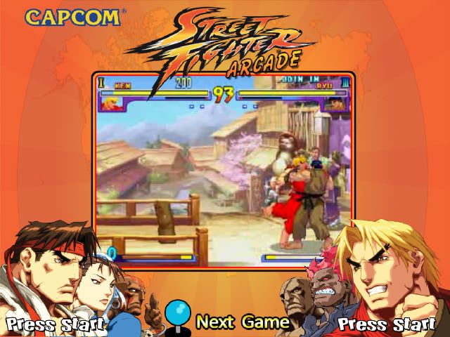

is that HYPERSPIN your using as the frontend?? if not, what is it??
Hunk_4TH
  • Posts: 313
  • Last login:January 21, 2026, 09:48:13 pm
  • I DON'T ALLOW VANDALISM IN MY STOOOOOOOOOOORE!
« Reply #128 on: June 12, 2011, 04:18:03 pm »
It's definitely Hyperspin  :P
jahilton2002
  • Posts: 308
« Reply #129 on: June 12, 2011, 05:39:48 pm »
yes it is hyperspin... its great!

thx :D more updates;
Ok some more updates..... fitted the sticks of joy and buttons to the CP..... Cp box is still in paint so pics with the CP on the arcade are just mockup so the angle and height is wrong in the pics.....i've started to smile now when i walk into the room :D
sorry for some of the pics (phone)
would love to hear your comments.....
Martijn
  • Posts: 822
  • Akira!
    • ModMyBox
« Reply #132 on: June 14, 2011, 05:44:27 am »
Nice clean job on the control panel :applaud: In my oppinion a bit to large compared to the cab, but the artwork and plexy finish really makes it nice
almost there  ;)
maybe make 2nd player buttons yellow?
jahilton2002
  • Posts: 308
« Reply #133 on: June 14, 2011, 06:05:41 am »
the CP box isn't finished and not fitted in the pics..... i'll take more pics maybe tonight...... does look huge in the pics... but its at the wrong angle and too low...... just a trail fit... again thx for them comments

more updates:
CP box fitted along with CP. to be removed for sideart install.... machine works now... but again still waiting on cablin' :(

was having a few probs with the rgb to scart switching to the AV..... made this little gadget....
here:s the result!

started to do some of the CP.... its sooooo slow at this point.... snip snip cut cut zzzzzzzz

Very nice wiring job!

Thx for the comments guys, some more updates;
com cables;
signal cable:
guess the game?
all for now thx
  • Posts: 2021
  • Last login:Today at 12:19:20 pm
« Reply #139 on: June 26, 2011, 06:10:32 pm »
Guess the game? You're kidding, right?  :blah: Super-clean wiring. Kudos.  :applaud:

+1 on the wiring job.
Cab looks great!  :applaud:

what did you use to clip the cable ties to?
« Reply #144 on: July 01, 2011, 10:25:57 am »
You can buy them at Home Depot / Lowes in the electrical section.  I forget what they are called.  They have self-adhesive backs.

 they are zip tie anchors, they are right next to the zip ties

ok so started to get more time to start the arcade again... reason i've not been updating much.........................
Im a DADDY!!!!
more of the arcade, sorry again for my crap pics and all the dust!;
sound amp fitted.... wiring still WIP here so alittle messy;
speakers:
player start button leds wired;
computer power and light switch fitted and wired;
pc build done;

anyway.... here's just alittle theme i made to match the look of the cabs artwork...... finished the cp wiring now..... just need to add the side art and waiting for my arcade VGA now :dancing2:

had some probs with the sound amp picking up FM radio..... thats sorted now.... fitted a new amp..... alittle vid also;

Got the sideart done..... bed time now sorry for the fussy pics low light levels...... to say im happy is an understatement..... pics speak a million words!
jahilton2002
  • Posts: 308
« Reply #158 on: November 15, 2011, 02:10:52 pm »
no comments guys, im still smilin' !
borals
  • Posts: 64
  • Last login:March 07, 2020, 05:51:14 am
« Reply #159 on: November 15, 2011, 08:48:19 pm »
Cab is blowing my mind  :dizzy:

« Reply #161 on: November 24, 2011, 04:44:29 pm »
DONE!
:cheers: would just like to say thx to my uncle "Peter Elmes" because without his very skilled hands..... this wouldn't of even happened..... what started as just an idea..... became an expensive hobby..... THANK YOU :) :adore:

Very clean looking build!  Love the finished product!
dextercf
  • Posts: 432
  • [thisispersonal]
« Reply #164 on: January 21, 2012, 09:33:04 am »
Lovely build dude!
Pretty gfx, clean cuts, all over a nice cab!
-0,003 points for the "box cp". Something about that large top-board and the sharp corners on the box underneath that doesn't fit the rest of the cab. No biggy tho!
