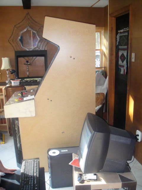

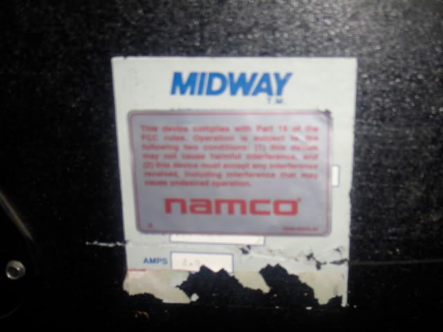

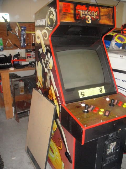

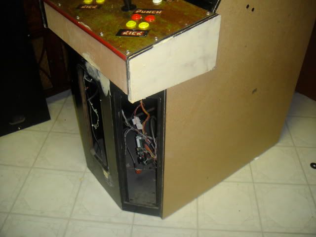

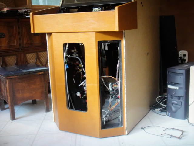

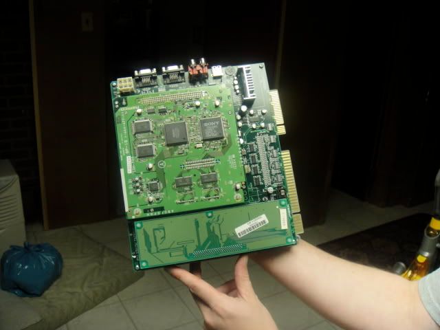

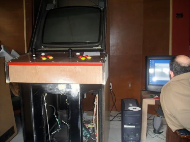

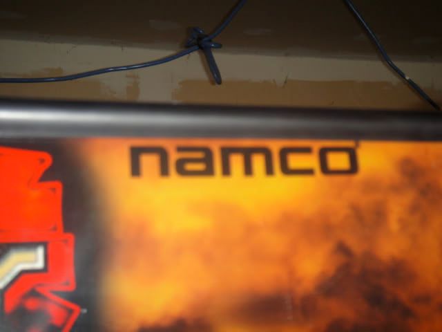

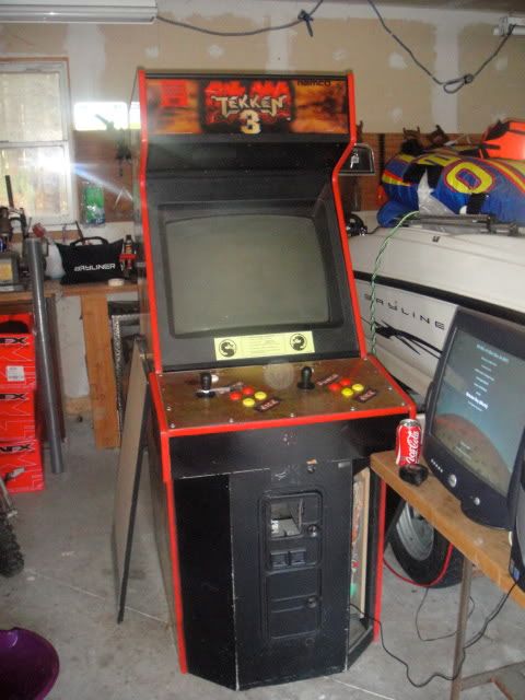

So I made a ton of progress and hit a brick wall at the same time this weekend.  It's OK though - got way more done than I thought I would.  Here is the Cabinet in the Garage in Tekken 3 Working condition.
The Cab was a Mortal Combat and converted to a Tekken 3.  All side art was Mortal combat and front art was all Tekken 3.
Jpac installed and Mala on the front end.  Thats where the snag came in.  The AGP Arcade VGA card I got won't work with my dell so I'm in search of a replacement that will allow me to use Soft15K.

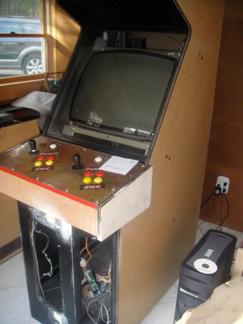

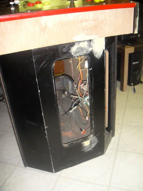

So it was strip time.  Got it in the house and spent the weekend stripping off the graphics and getting her all prepped for leather.
Heres the Tekken 3

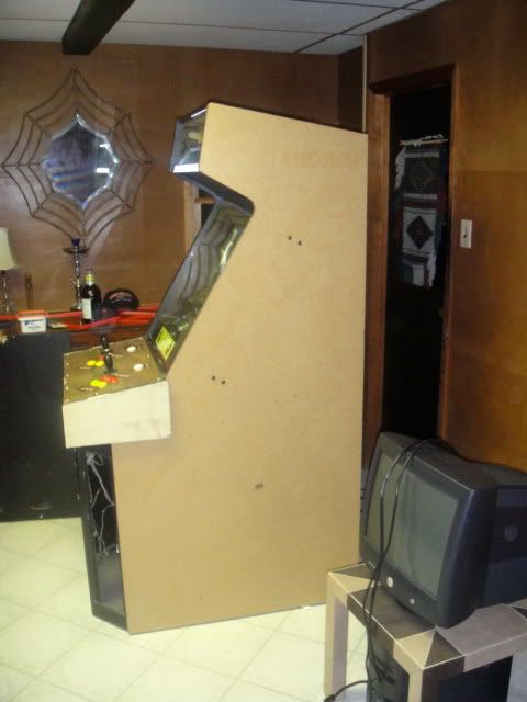

Managed to strip off all the graphics - Ordered everything else I need for the control panel.  Its Big.  The hides wont cover the sides in one piece so we will be getting creative.  All the t-molding grooves are filled and just need a final sanding waiting to be wrapped.

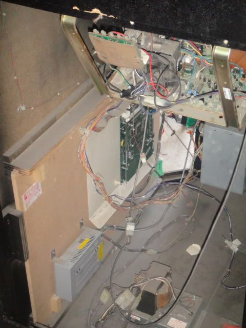

The inside was nasty.
Thats all cleaned up too.
Check this out LOL
So I'll be looking for a card to run soft 15k - the rest of the buttons etc are coming as well.
It might be 2 weeks for more pics because of Halloween but I'll keep it updated as I go.

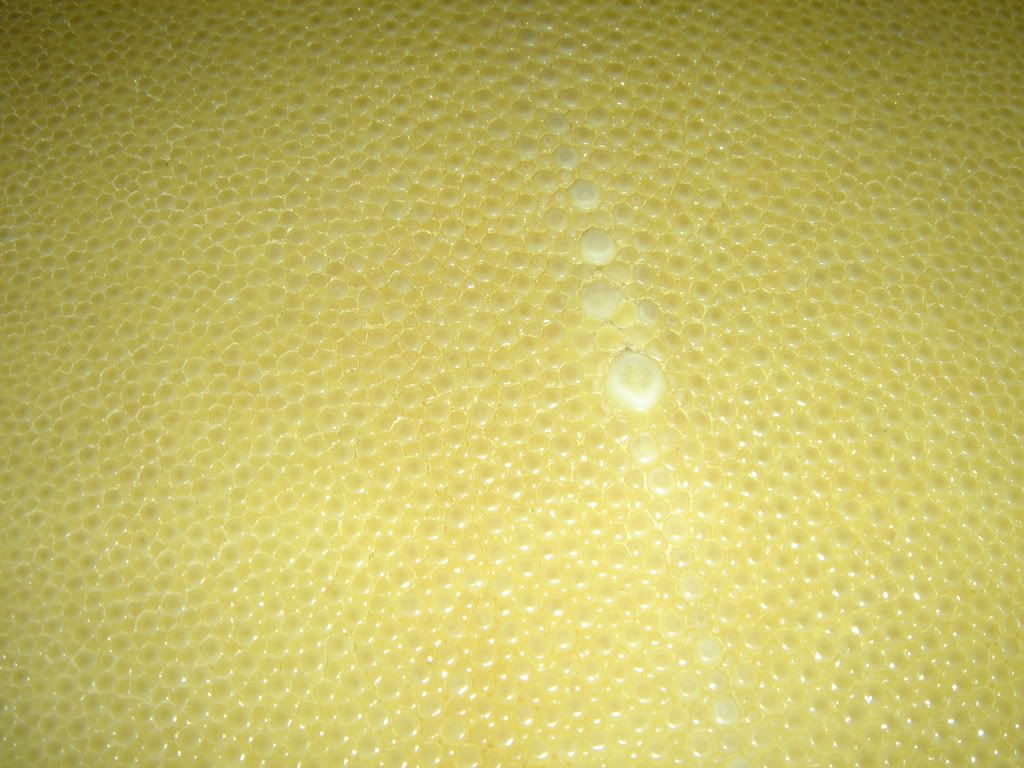

I got the Trackball and all the buttons today.  All black.  We decided to use #9 real brass nailheads, 23k gold tooling and all black controls.  All I need now is the video card that will work with this machine and soft 15k.  Next weekend the leather wrapping will begin.

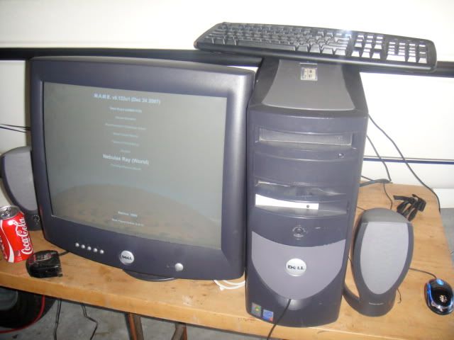

I'm still having video card issues with getting the cumputer to show on the arcade monitor and suspect I'll need help at some point.  Tried the Arcade VGA one more time and didn't work.  So, like I said before - I need to find a video card that will work so I can use soft 15K.

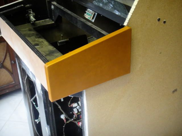

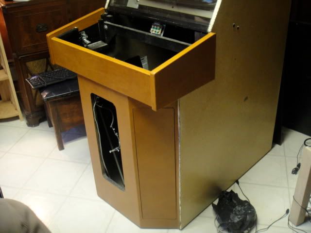

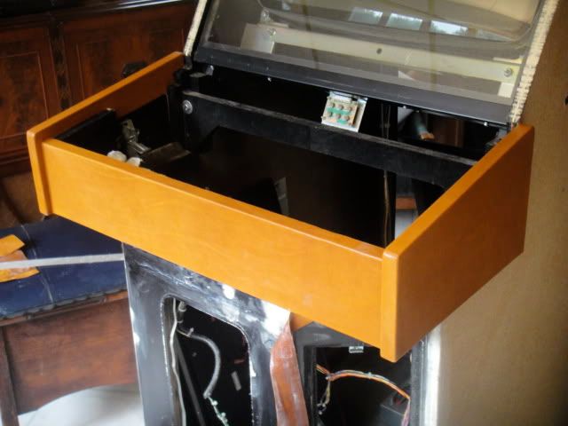

Anyway, we managed to get some leather on the cabinet today.  Went over the layout and began to cover some of the prepared parts.
Heres how it went:
It was a lot of work so far but my wife did an awesome job.  I'll keep you posted with more leather on the cab.  Then we will start with the 23K gold tooling and brass nailheads.  It will be pimped out.

Very nice. You using some kind of brown tmold or wrapping leather around the edges? The gold tooling and brass nails was very much like what I was going for on my CP (but it's formica laminate so I couldn't quite use leather tools on it)

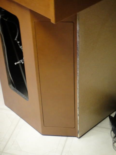

I filled and sanded all the T-molding areas and she completely wrapped the edges.  Almost feel like I shouldn't ruin it with the nailheads as the molding because it looks so nice, but the wife still seems to think we should go all out.  LOL - We are struggling with getting it to show up on the monitor and that is taking and has taken up all of our time.  Nightmare!!!!  We did the layout for the control panel this morning to get our minds off the monitor issues.  This is what the first draft sketch of the layout looks like.  It's kind of generic but we have limited space and this layout seemed to be the most comfortable even though its the least pleasing to look at.  We have to go to Home Depot to get a 1 1/8" hole cuter so we can make the first mock up.  Glad everyone likes the leather.  It's this custom made Italian leather that is amazing.  We had it leftover from a job.

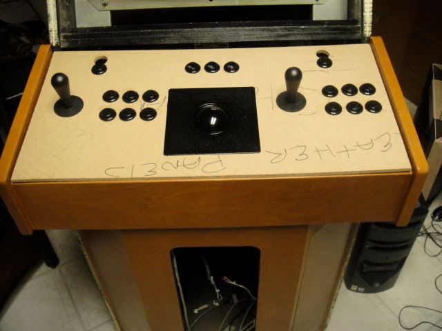

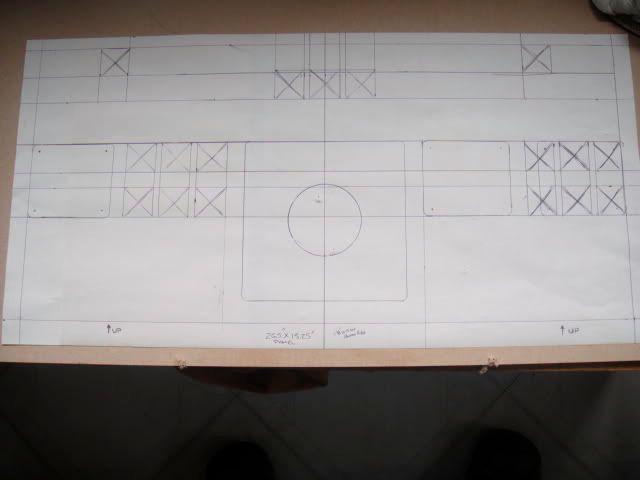

One last pic for the night - we're friggin' exhausted.  Here's the first mock up of the CP.  The CP should be done by next weekend.  Got the wood for it.  Just want to do a couple more templates etc. before we cut the final one to make sure its just right.  So, here's how the first mock up looks.

Good choice with the all black controls. Don't think I've ever seen a black trackball used!

OK I'm desperate - My machine has onboard graphics and the AGP arcade VGA card I got isn't compatible with the dell i have.  What other way can I get the games on the monitor?  I can't be sure what cards will work in my machine to use the soft 15K so I was wondering if anyone knew if I could use one of those video converters etc?  This is consuming 99% of my time - I kinda want to smash it.
Anyone help?

I have a Radeon X800 card working with Soft15Hz on a Dell Dimension AGP motherboard no problem - Having said that, I'm really not sure why you'd have problems with the Arcade VGA.

I just tried once more for the 60,0000th time and this is what happens. I uninstall the onboard graphics driver >> Power down and open the case >>> Plug in the Arcade VGA AGP 128 card (and make sure its seated properly), close case >>>> Hook everything back up but video out is going out of the new card to the Jpac.<  Once I press power I get the blue dell startup logo all jumbled up on the arcade monitor and then everything goes black.  The computer does not boot up.  I try the same with it all hooked up to the computer monitor and same thing - Black screen and computer doesn't boot - Even with no monitor connected and the card in - Computer doesn't boot.
If I get this fixed I could be done in 2 weeks but its about 2 months already trying to get it on the monitor.  My fear is that I'll buy another AGP card and it wont work either.  I'd like to know something will work before I buy something else. Sigh.
I made sure the AGP in the bios was set to 128 and that it was switched from onboard to auto.  The machine is a Dell Optiplex GX 260 full size tower. - Sigh again :(

« Reply #37 on: November 15, 2010, 08:44:49 pm »
Got my CP wood custom cut by an amazing cabinet maker today in the city.  He even took 1/32 of an inch off the thickness of the 3/4 substrate to compensate for the wrap.  Amazing!  Then he tells me - No charge, just let me know when you want to pick it up.
Please remind me to measure a million times and cut once.  I'll pick it up from him Thursday or Friday. Can't wait.  Just ordered 200 female quick disconnects and my buddy picked up a crimper to help out with the wiring.  Quick disconnects should be on the way.
Shame I can't sit down to work on it again until next weekend.  :banghead:

« Reply #75 on: November 24, 2010, 04:47:25 pm »

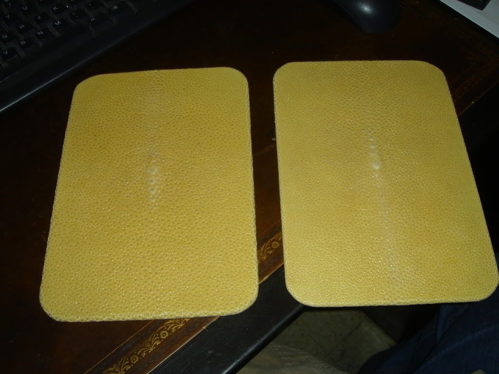

Took a break from the Marquee for now - I think I'm going to revisit it completely.  I like the LED/Burn Idea.  I have an artist that works for me that does amazing freehand burning into leather.  He makes amazing things using a burning tool and his painting skills.  We messed around with a few things at work today and he's gonna mock something up for me over Thanksgiving break.
I had some free time today (about 2 hours) and didn't want to start a new job so I had another idea...  This one I'm really excited about - everyone in the shop thought it would be a great idea.  I had 2 first grade shagreen skins (stingray pelts) in a cream color.  Not enough for a job, sitting on the shelf and begging to be used.  Yeah, I could have made a box with bone trim with them or any other decorative object but they screamed ARCADE!!!!  So, my assistant and I fabricated 2 coin door blanks and covered them with the most exotic skinz on the planet.  They came out perfect.  I cant wait to add them to the cabinet this weekend!!!!
Friggin swishy sweet!
Oh and you can see my desk pad underneath with Gold and Blind tooling.  I need a new one - it's old.  :laugh2:

hmmm. That is strangely awesome.

Stingray! That's pretty cool, I really am excited to see what you come up with for the marquee.. sounds like it's going to be pretty sweet.

BKD - Thanks for spotting the typo - I'll send the correction to the web guy first thing Tuesday morning - Nice catch.
For the marquee, I'm going with the LED lights mounted in small holes to spell out the name - Which I haven't decided on (since everyone hates leathercade).  Been watching youtube vids on how to wire individual LED's with resisters etc.
This hobby is the friggin BEST - Learning so many different new things.  Very gratifying.

Ok - Got the control panel cut and leathered.
Got the Shagreen mounted on the coin doors.
Got the controls and micro switches in the control control panel and mounted.
And got leather on one of the sides.  Took forever and got too dark to do the other side.
Tired - Gonna order Chinese...  More to come.

Nice work there skinz, but would it not look even better with the trackball mounting plate, mounted below the cp?  :applaud:
skinz
  • Posts: 81
  • Last login:February 24, 2013, 10:46:10 am
Re: Leather covered Cab
« Reply #94 on: November 27, 2010, 06:18:17 pm »
We tried it both ways and thought it looked better like this and would help protect the leather from everyones little greasy fingers.  I like it a lot. LOL  :afro:

So close yet so far away.  Could hardly believe we got the AGP Garphics card to work with soft15k.  Atleast to a degree.  Now projecting to Arcade monitor but in the wrong resolution.  The entire CP works perfectly after getting that all wired up.  I also did the soldering for the RGB, Sync and Ground to the old arcade monitor.  Works fine.  It was a great weekend of work.  Lots got done as you can see.  Thanks Skinz!  Always my pleasure to work on this project with you.  Its so darn cool....
